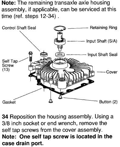

gwest_ca-(File Mod) 12,387 #4 Posted April 10, 2018 Found this in the service manual Page 2 and page 6 The only reference I can find. See nothing in the illustrated parts lists. Garry 1 Share this post Link to post Share on other sites
CountryRock 199 #5 Posted April 10, 2018 I have that manual and never noticed the part about the self tapping screw in the drain port. I think I'm just going to get one of those drill pumps and suck as much out as I can. Tractor manual says it has 1.75qt of sae 30 in it. Got 2 fresh quarts of sae 30 Pennzoil the other day for it. Share this post Link to post Share on other sites
