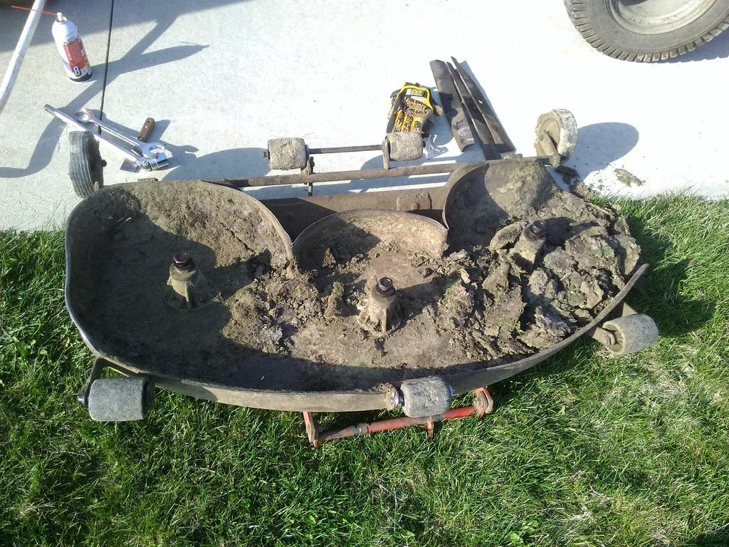

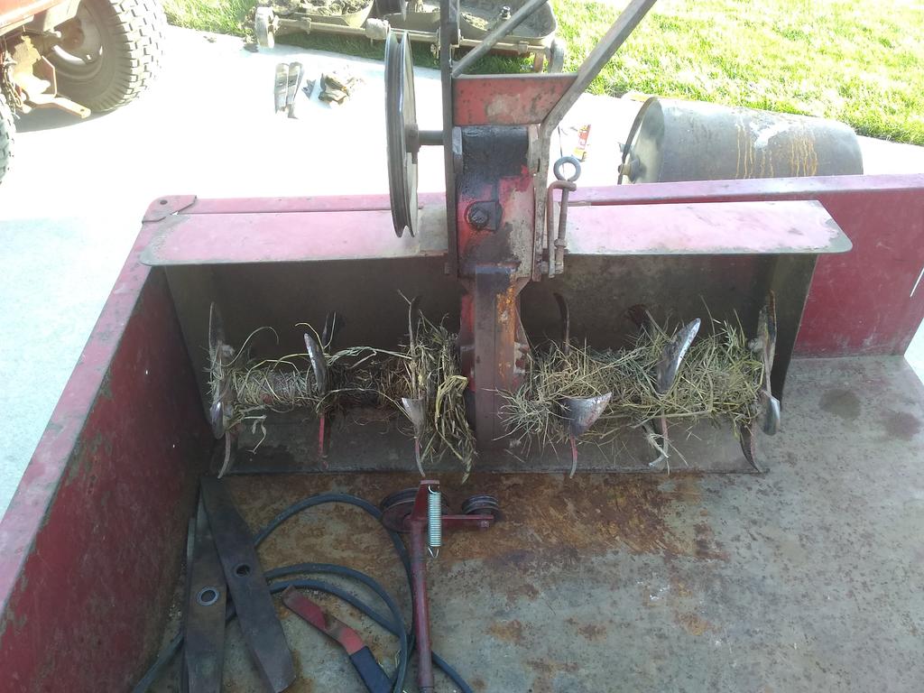

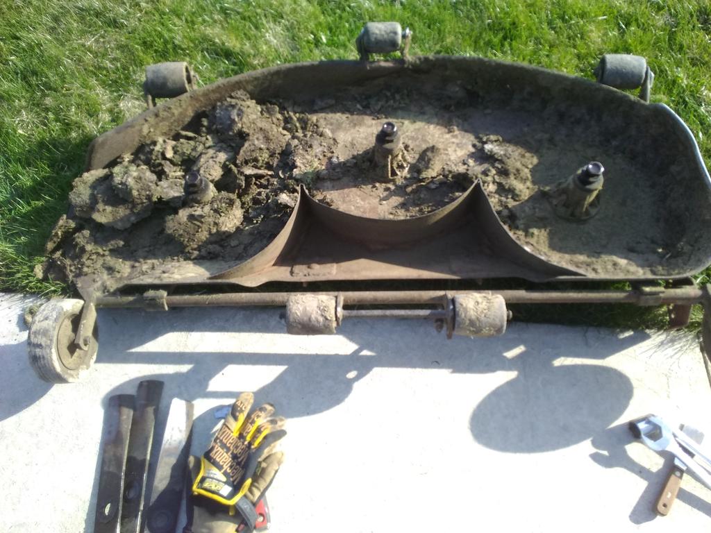

GREYGHOST 65 #20 Posted April 14, 2018 This deck is off off.my 417A that I picked up yesterday. I've just started my clean up. So far I think it will be fine once I give it some TLC. PO sure didn't. So far its just 3in 1 tool & the trusty power washer. PO didn't think much of the tiller either! 3 Share this post Link to post Share on other sites

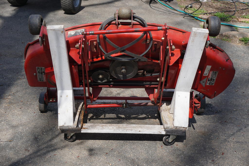

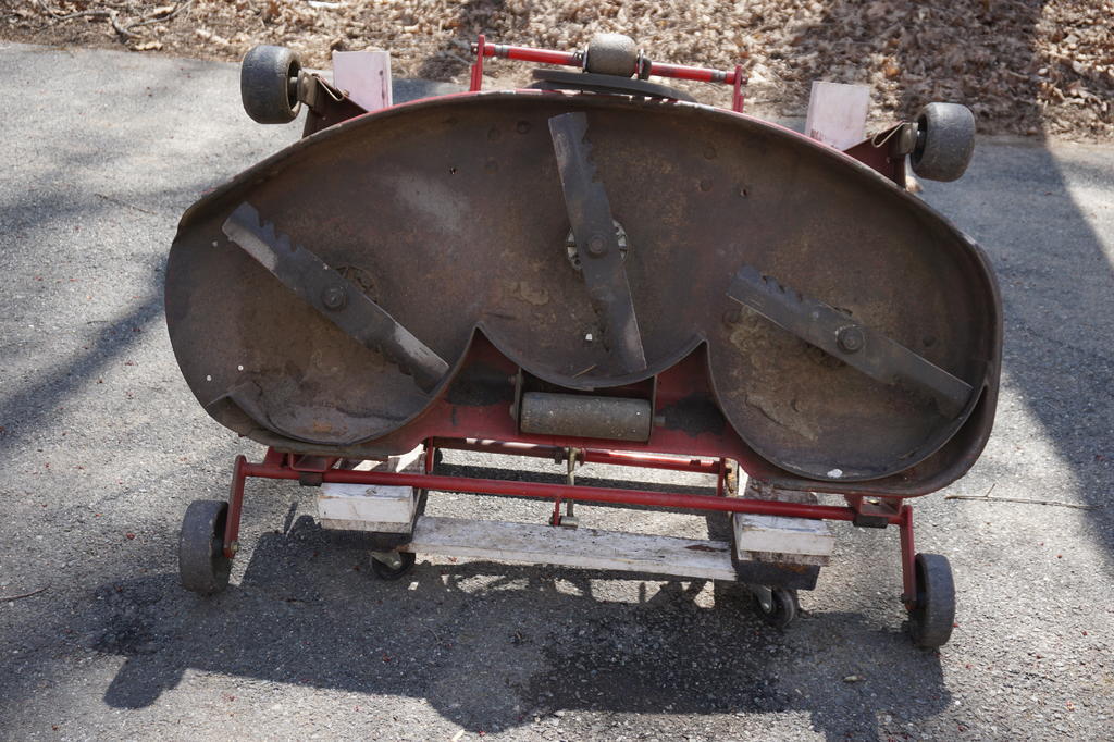

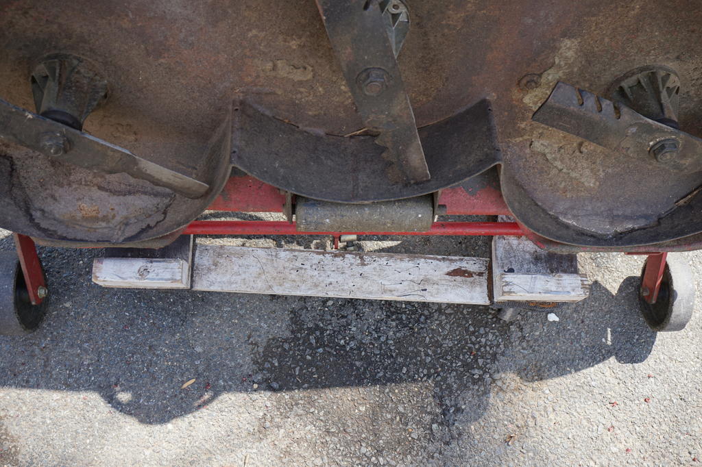

shallowwatersailor 3,222 #21 Posted April 14, 2018 I have posted photos of my mower deck rack before but thought I would do it again. It uses a HF moving dolly and dimensional lumber. The HF casters aren't that good but 99% of the time it is just sitting. It allows me to store the deck off season in a smaller footprint. The nice part is that I can easily clean and paint the underside with access to the blades. To swing the deck up I lay it on top of the deck and use the "feet" to steady the back of the deck.swing it up. 3 2 1 Share this post Link to post Share on other sites
cleat 9,384 #22 Posted April 14, 2018 Your holder looks great. I like the anti-scalp roller aa well. Toro must have added that, I could add that to my 48" decks. My 60" deck has a similar one. Share this post Link to post Share on other sites

Kurt-NEPA 756 #24 Posted April 14, 2018 (edited) 1 hour ago, shallowwatersailor said: I have posted photos of my mower deck rack before but thought I would do it again. It uses a HF moving dolly and dimensional lumber. The HF casters aren't that good but 99% of the time it is just sitting. It allows me to store the deck off season in a smaller footprint. The nice part is that I can easily clean and paint the underside with access to the blades. To swing the deck up I lay it on top of the deck and use the "feet" to steady the back of the deck.swing it up. Nice dolly. And an ingenious rack for maintenance and storage. I may steal that idea. Thanks Edited April 14, 2018 by Kurt-NEPA 1 Share this post Link to post Share on other sites
