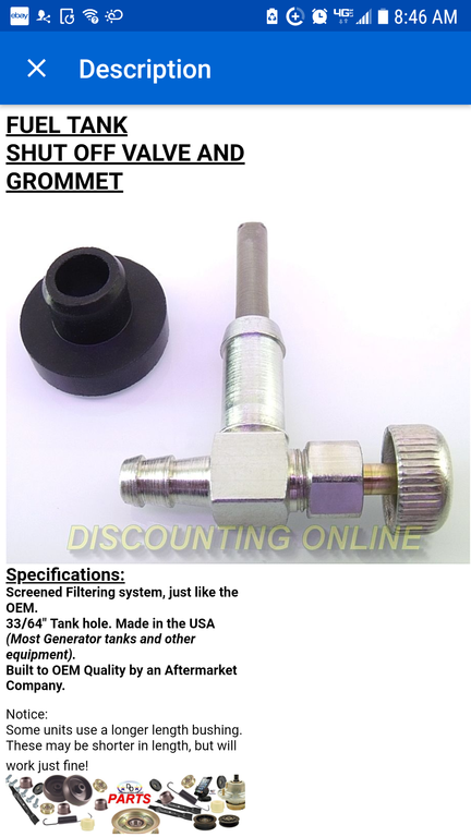

moe1965 774 #4 Posted April 7, 2018 There should be a filter in the tank as well even if you have a external filter. I just bought one that goes in the tank off eBay. It was about 10 bucks with the shipping. 1 Share this post Link to post Share on other sites
