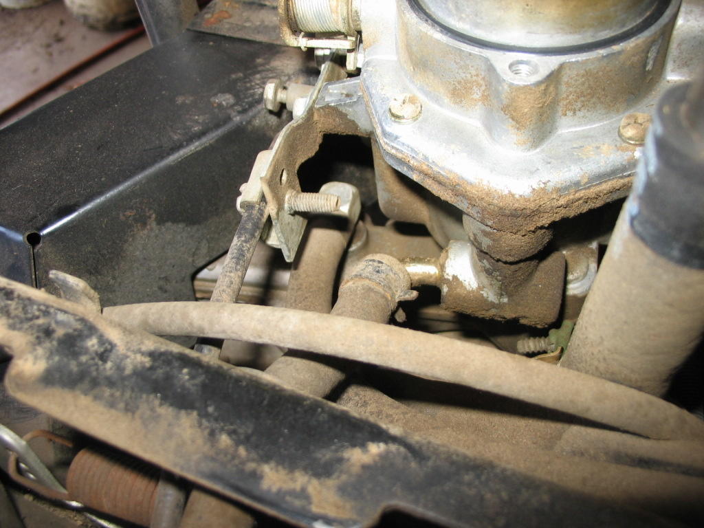

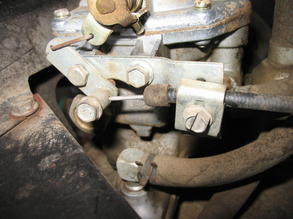

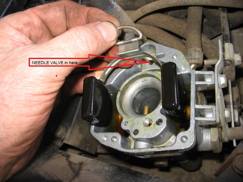

daveoman1966 3,884 #10 Posted March 27, 2018 I also had a surging problem with my 520. Carb cleaning resolved the issue. CAUTION... the NEEDLE VALVE is in a precarious position and is easy to lose track of. With the air cleaner off, here are a few pics of the carb and linkage. Use aerosol carb cleaner to flush out the float chambers. 1 Share this post Link to post Share on other sites

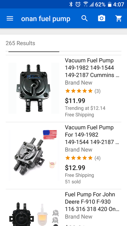

WVHillbilly520H 10,379 #12 Posted March 27, 2018 You can get aftermarket Onan pulse fuel pumps off Amazon or eBay rather cheap, IMO just one less power draw on the stator, Jeff. 1 Share this post Link to post Share on other sites
