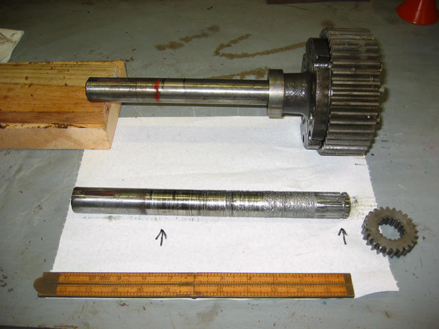

pfrederi 19,722 #14 Posted March 26, 2018 If you let the needle bearings go to long this can transpire...Took out the much more expensive inner 1533 bearing in the process. Keep a close watch on how much up down front rear play you have. 4 Share this post Link to post Share on other sites
