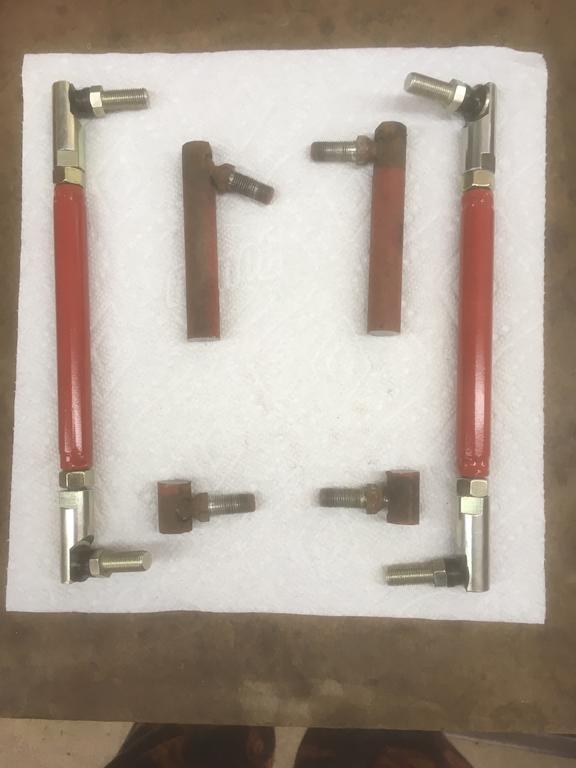

Crazy_Carl 254 #1 Posted March 20, 2018 Anybody on here ever upgrade their old worn out non-adjustable tie rods like this? These are for my '79 C-81. The beefy 5/8" diameter tie rods were worn out so I cut off the old ends, and squared up a piece that was 5" long. Then I welded some 1 1/4" 3/8-24 grade eight bolts to the ends of that so I could use these nice rod ends. It was a pretty easy small project. On another note if you looked closely in my C-125 First Start Video you would have noticed that the trans pulley my C-81 was sitting on the right floor board. That's because I'm trans pulley swapping it. The problem with my C-81 is that the trans input shaft if 5/8" diameter with and odd size 5/32" woodruff key slot. I have a 5/8" hub with a 3/16" keyway. I'm going to try to file a 3/16 woodruff key into an adapter key or find a machine shop locally that can broach a 5/32 keyway into the hub I have. I'm looking for other ideas though. 7 Share this post Link to post Share on other sites
Achto 32,096 #2 Posted March 20, 2018 Very nice work on those tie rods!! Share this post Link to post Share on other sites

Ed Kennell 46,606 #4 Posted March 20, 2018 Nice, are they from McMasters Carr ? Share this post Link to post Share on other sites

Crazy_Carl 254 #7 Posted March 20, 2018 43 minutes ago, 953 nut said: I have made a few tie rods by using 1/2" OD X 0.37" ID mechanical tubing with ends drilled out to 25/64" and tapped to 7/16-20 (NF) with rod ends from McMaser-Carr. What’s mechanical tubing? Is that like DOM tubing? That’s a good idea too though. I got the inspiration to make these from the newer style tire rods from Toro that are on my C-125 that have one replaceable end, but I wanted one where you could replace both ends if they wore out. I was going to buy them from McMaster Carr or find some cheapies on eBay but one day I was walking through my local hardware store and they had just added these to their stock for about $10 a piece and I couldn’t resist and while I was there I could conveniently pick up 3/8 fine thread nuts and bolts. 1 hour ago, Ed Kennell said: Step keys are easy peasy. Paint the sides of the 3/16 key with bluing of black magic marker. Clamp it tightly in the 3/16 slot with both ends at the same elevation and scribe along the side. Clamp the key in a vise aligned to the scribe line. File one side only until 1/64 is removed keeping the filed side parallel to the unfiled side using a Micrometer. File the other side to get the 5/32" thickness using the Mic to keep the sides parallel. That is really sound advice that I am definitely going to use. Thank You! 3 Share this post Link to post Share on other sites

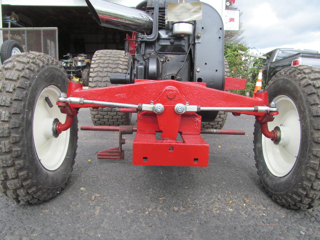

wallfish 20,225 #8 Posted March 20, 2018 NICE, Yes, believe he's referring to DOM tube but... Used threaded rod cut to the complete length, covered it with cheap small pipe and added a couple extra nuts with washers on each end to lock the pipe in place. That's what I already had so used that. No welding, crimping, filing or special tools needed, just a hacksaw. 3 4 Share this post Link to post Share on other sites

ebinmaine 79,712 #11 Posted March 21, 2018 8 hours ago, wallfish said: NICE, Yes, believe he's referring to DOM tube but... Used threaded rod cut to the complete length, covered it with cheap small pipe and added a couple extra nuts with washers on each end to lock the pipe in place. That's what I already had so used that. No welding, crimping, filing or special tools needed, just a hacksaw. I saved that in my notes. Thanks John! 1 Share this post Link to post Share on other sites

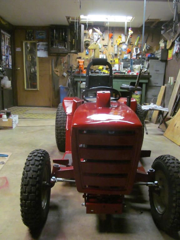

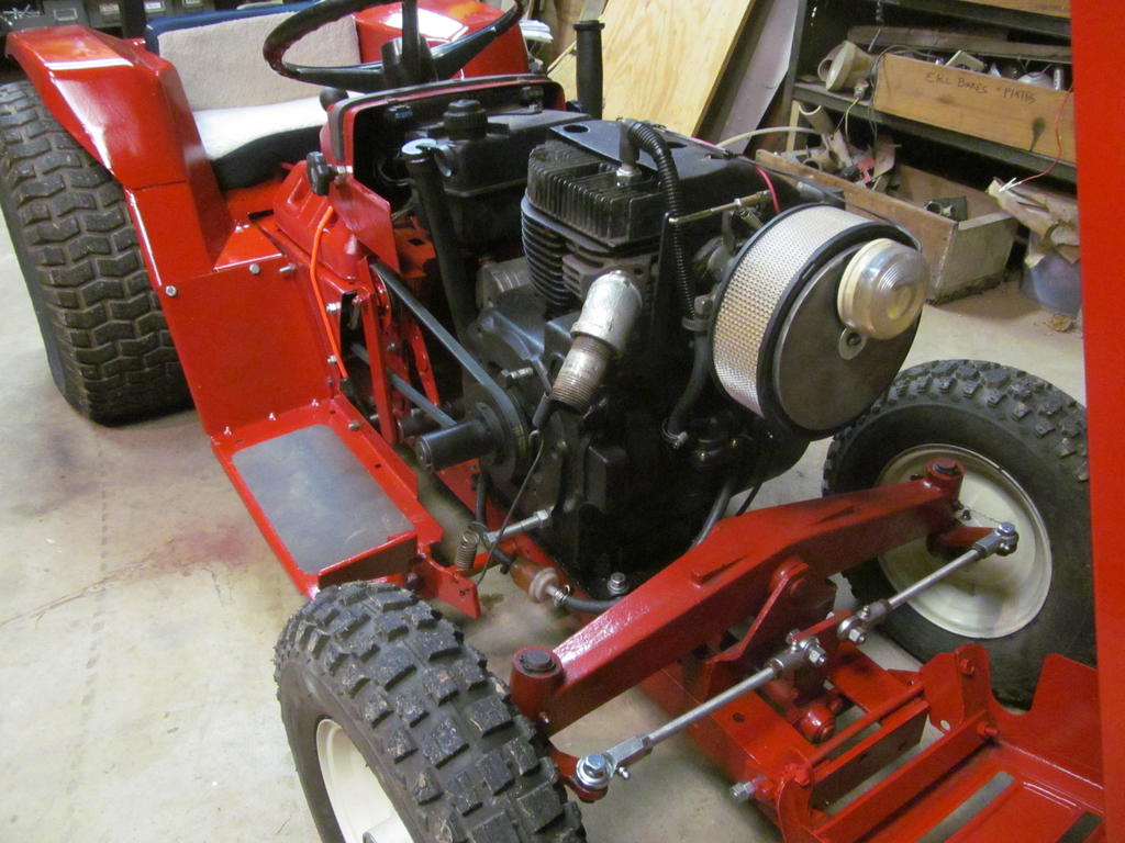

Ed Kennell 46,606 #12 Posted March 21, 2018 I used Johns threaded rod method on the Low Rider. I have polished aluminum tubing that I planned to slide over the rod, but never got it put on because the clearance got tight where the tie rods pass thru the sides of the hood. 2 5 Share this post Link to post Share on other sites
ebinmaine 79,712 #13 Posted March 21, 2018 @Ed Kennell thanks for the pics. A visual is always handy with a verbal. 1 Share this post Link to post Share on other sites
