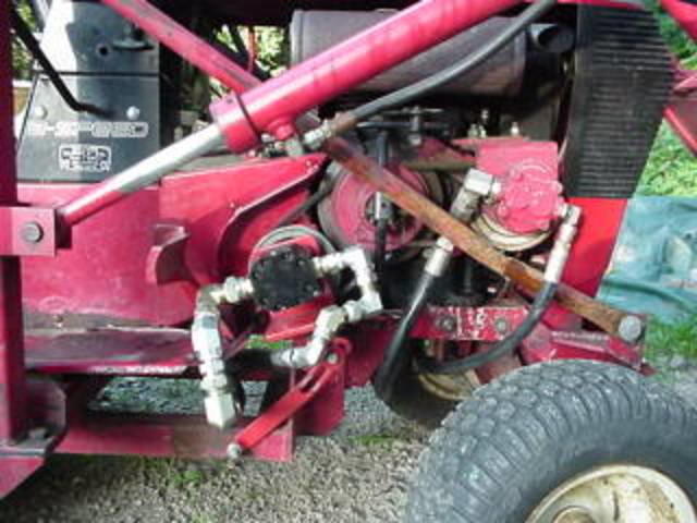

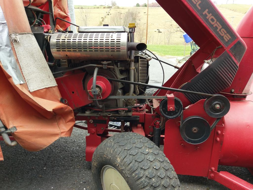

WVHillbilly520H 10,378 #6 Posted March 20, 2018 (edited) 5 hours ago, Walhonding520 said: Just realized I spelled hydraulics wrong lol. Guess I started typing hydro and just added to it. I am going to investigate both options depending on what I want to use the hydros for. Coming directly off the supply lines with a "T" is the cheaper and quicker option. Wallfish, or anyone who has used a separate pump, where and how do you "attach" the pump to the tractor motor to power it? I have some skill and a really well equipped Agri. Shop at school to utilize so my options are only limited by what the tractor can do. Power to separate pump would be coming from your PTO that runs the mower deck, snow thrower, or rear tiller, that separate pump would then need to be mounted most logically in the front attach-a-matic where the mower mule drive attaches, I suggest doing a search here on the forum for (FEL) front end loader builds for pump/mounting ideas, I have a smaller scale idea floating around in my head from the same JD remote system, without need for a separate pump just teeing off the existing fluid lines adding another spool valve and building a 4 way hydraulic snow/dozer blade on one of my 520s, also you might try "Surplus Center".com for hoses/fittings valves cylinders pumps ect for your build, Jeff (pic for reference of PTO) Edited March 20, 2018 by WVHillbilly520H 1 Share this post Link to post Share on other sites

Walhonding520 25 #8 Posted March 22, 2018 Now I’m just working out where to mount. Thank you for the pictures for reference. Not sure if I want it in permanent or if I want to put it on just when I need the splitter. I have seen a few things where people have used power steering pumps. Anyone tried this? Share this post Link to post Share on other sites
