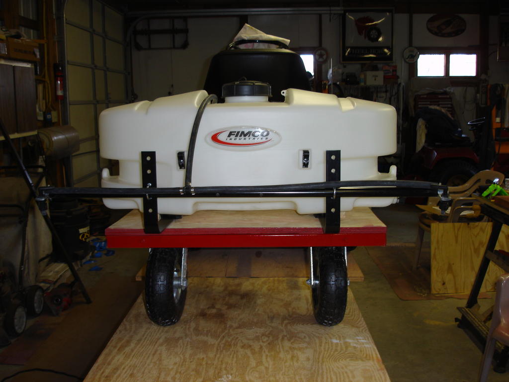

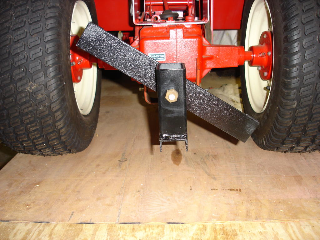

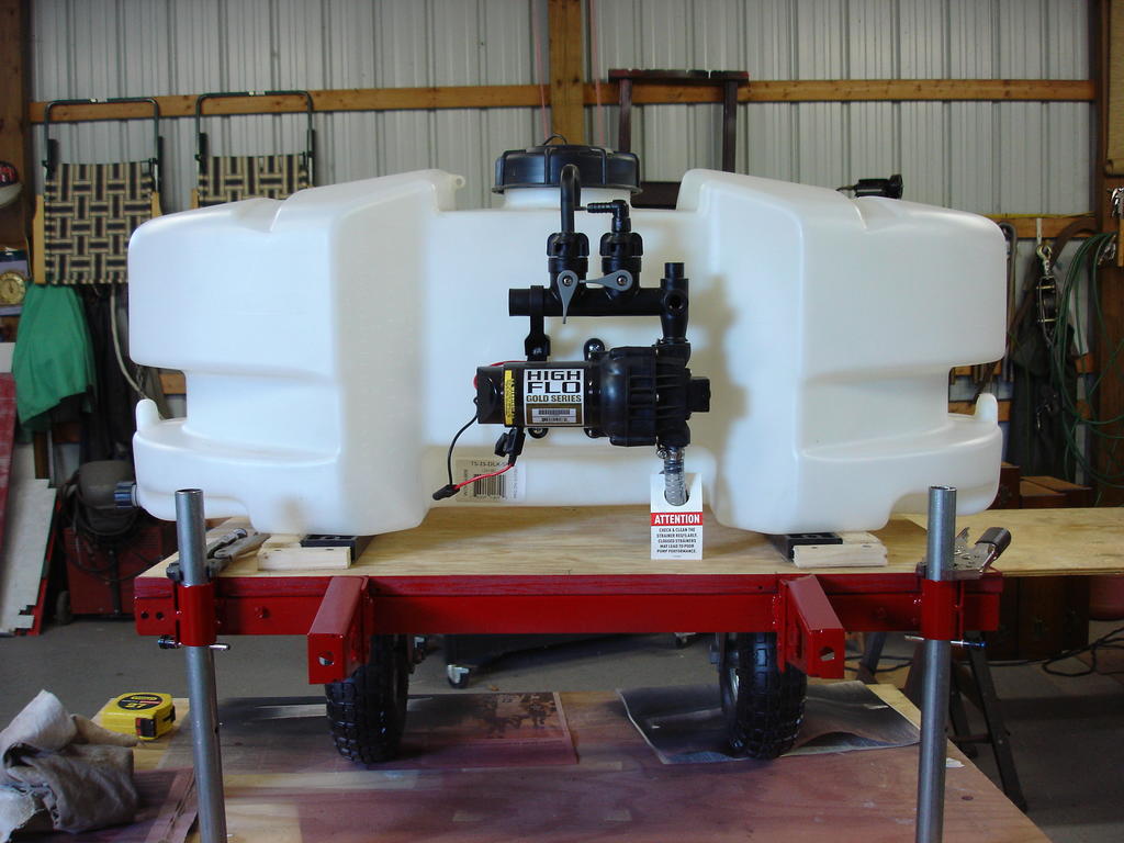

Marv 996 #1 Posted March 15, 2018 Getting ready for the season. Needed a dolly for my sprayer so decided to make one. Pictures (yes I know didn't happen if no pictures). Here they are: 5 6 Share this post Link to post Share on other sites

elcamino/wheelhorse 9,363 #4 Posted March 16, 2018 @Marv Man that is slick , can you provide some measurements ? I need by brother the welder to make me one. Share this post Link to post Share on other sites
Walhonding520 25 #5 Posted March 16, 2018 That's a pretty slick idea. I don't need a sprayer, but I have been thinking about making a type of basket for the back of my 520h. Something like a Carry-All on the back end of a full size tractor. Can put things like chainsaw, hand tools, chains, etc in it. I don't think I will add the wheels but I like seeing I'm not the only one thinking of something like this. Could even add weight for the new blade if necessary. Share this post Link to post Share on other sites
953 nut 69,840 #6 Posted March 16, 2018 I built a sulky somewhat like that years back that snapped into the snow plow bracket. It didn't have the swivel you have used though,. Well designed. Share this post Link to post Share on other sites
Tankman 3,528 #7 Posted March 17, 2018 (edited) Thanks for the post! Very nice project. Thank you, I now have another project. Did a project, not like yours but interesting. Installed a low max bulkhead fitting on the tank. Inside the tank an angled elbow. A bypass on the pump to return product to the tank. Run the pump bypass moving fluid out of the tank then back in, low max. made it easy to mix or keep mixed product in the tank. Looks almost done? Two outlets off the pump setup you have? Edited March 17, 2018 by Tankman Share this post Link to post Share on other sites
Marv 996 #8 Posted March 17, 2018 On 3/15/2018 at 7:40 PM, The Gman said: Truly professional work. On 3/15/2018 at 7:52 PM, slim67 said: Good old American ingenuity Thanks, I am just an OLD farm boy. We had to make do. On 3/15/2018 at 8:40 PM, elcamino/wheelhorse said: @Marv Man that is slick , can you provide some measurements ? I need by brother the welder to make me one. I will try to work up something for you. 22 hours ago, Tankman said: Thanks for the post! Very nice project. Thank you, I now have another project. Did a project, not like yours but interesting. Installed a low max bulkhead fitting on the tank. Inside the tank an angled elbow. A bypass on the pump to return product to the tank. Run the pump bypass moving fluid out of the tank then back in, low max. made it easy to mix or keep mixed product in the tank. Looks almost done? Two outlets off the pump setup you have? Yes two outlets. One for boom and one for wand. It does have a bypass system. 1 1 Share this post Link to post Share on other sites
