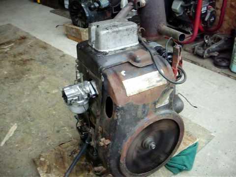

Sparky-(Admin) 26,686 #10 Posted March 13, 2018 Here's a poor quality pic I found. Definitly see a Wheel Horse hood clearance issue from the OHV set-up. 1 Share this post Link to post Share on other sites

eddiebunyan 24 #12 Posted March 13, 2018 Would the OHV .be considered a "K"?Talked to my local small engine dealer who's been in the buisness for 35 years and use to work for a dealer in the 70's that sold wheelhorse and Bolens. He said he's only seen one 18 and that was in a economy tractor.I asked the guy if he could get me the engine model number ,so we'll see. Share this post Link to post Share on other sites
ebinmaine 81,134 #13 Posted March 13, 2018 16 minutes ago, eddiebunyan said: Would the OHV .be considered a "K"?Talked to my local small engine dealer who's been in the buisness for 35 years and use to work for a dealer in the 70's that sold wheelhorse and Bolens. He said he's only seen one 18 and that was in a economy tractor.I asked the guy if he could get me the engine model number ,so we'll see. I poked around on the interwebs for a bit and it looks like it IS considered a "K". I see several references to the overhead valves being splash lubed with no actual oil pump which was a problem for the heads/seats. As near as I can figure in just a few minutes - I am NO authority - They were used mostly in 78 -80 or so economys but also a few others. I've never seen one that I can recall. The couple economys I've looked at were Kohler 14s. I see no online references to WH ever using one as OE but as others have stated it could be added in... though the hood clearance would really be an issue in most models. Still wicked curious..... Share this post Link to post Share on other sites
richmondred01 2,393 #14 Posted March 14, 2018 (edited) Like many have said, I dont believe the K361 would have the clearance to fit under the hood. K361 had several flaws too with lack of oil pressure to the valves. Years back I did a few rebuilds on the k361. Even back then, the parts were hard to get. But yes they were k block engines. Edited March 14, 2018 by richmondred01 1 Share this post Link to post Share on other sites
