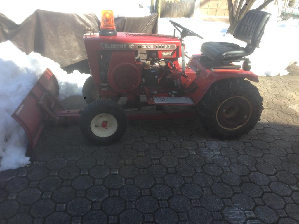

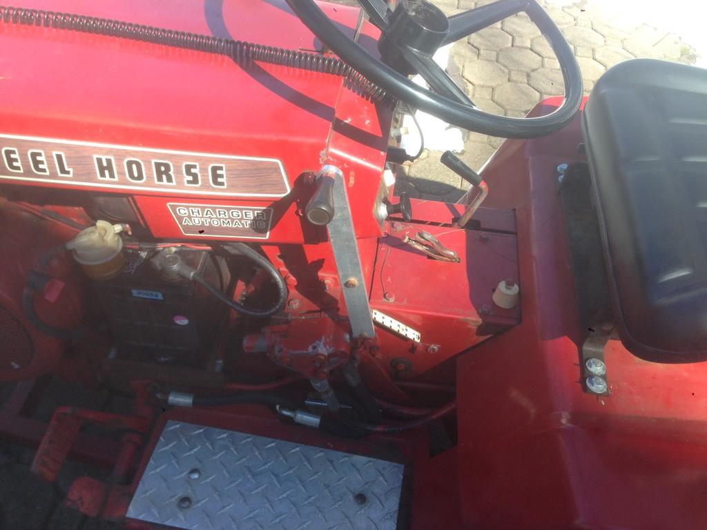

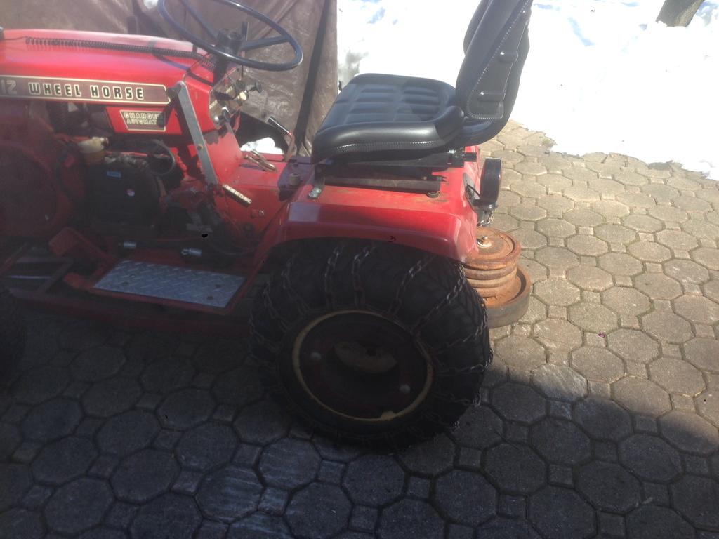

formariz 12,378 #5 Posted March 11, 2018 6 minutes ago, ericj said: I don't think I've ever ran out of power with my onan eric j You probably run out of traction much before that. Made a couple of improvements on it that have really made it easier to use. Th new seat is much higher making it much more comfortable for my long legs. Also made an extension for plow lift so I dont have to lean forward to operate it. I don't even have to take left hand off steering to use it now. 7 3 Share this post Link to post Share on other sites
pfrederi 20,675 #6 Posted March 11, 2018 Nice setup. Does the diamond plate help?. I have some slippage issues getting on and off mine. Tried the adhesive backed stuff in a tractor a few years ago but it seemed to get clogged up with snow. Also what are the vice grips for in the center slot? Share this post Link to post Share on other sites
ericj 1,580 #7 Posted March 11, 2018 2 minutes ago, formariz said: You probably run out of traction much before that. I see your running chains that will use more power before you loose traction, I only run chains on my snow blower tractors or if I take them somewhere and plow on a dirt surface, if I can find a pair that will work when I need them eric j 1 Share this post Link to post Share on other sites
formariz 12,378 #8 Posted March 11, 2018 3 minutes ago, ericj said: I see your running chains that will use more power before you loose traction, I only run chains on my snow blower tractors or if I take them somewhere and plow on a dirt surface, if I can find a pair that will work when I need them eric j I have an extremely steep driveway and don't want to take any changes with it. The almost stalling only happened with this storm for the first time. I had 18 inches of wet stuff on the top part. It was brutal on tractor but it pushed it. I need to get up to the top of it first and then plow downwards. However since I do not have a lot of spots where I can put snow, many times I just push it all to the street like this time. 2 Share this post Link to post Share on other sites
formariz 12,378 #9 Posted March 11, 2018 12 minutes ago, pfrederi said: Nice setup. Does the diamond plate help?. I have some slippage issues getting on and off mine. Tried the adhesive backed stuff in a tractor a few years ago but it seemed to get clogged up with snow. Also what are the vice grips for in the center slot? Diamond plate helps a lot. I don't have any problems going in or out. Vice grips are for throttle .Keeps creeping out of position. Was going to change cable years back but got used to using this way.At least I always know where vice-grips are. 2 1 Share this post Link to post Share on other sites
pfrederi 20,675 #10 Posted March 11, 2018 5 minutes ago, formariz said: Diamond plate helps a lot. I don't have any problems going in or out. Vice grips are for throttle .Keeps creeping out of position. Was going to change cable years back but got used to using this way.At least I always know where vice-grips are. Clothes pins one fast idle two full throttle 1 1 Share this post Link to post Share on other sites

formariz 12,378 #14 Posted March 11, 2018 7 minutes ago, SylvanLakeWH said: Nice set-ups! I went this whole season with no chains or added weight. Experiment. Lots of 3" - 5" snows and one big wet dump... 3 flat driveways each time and NO Issues! and my older asphalt driveway doesn't look like the bride of Frankenstein from chain scratches... I'm sold. Flat driveways are ideal however far from that here. Weight really makes a difference . I have 100Lbs on wheels, 90Lbs on rear hitch and about 25Lbs inside tool box. On my neighbors steep long driveway a 4 wheel drive pick up will not make it all the way up plowing. At the turn it slips and stops. I make it all the way up with tractor without one single slip. 1 Share this post Link to post Share on other sites
squonk 46,874 #15 Posted March 11, 2018 I did almost the exact thing Caz, but I cut up a hydro control lever so it looks kind of stock. 1 Share this post Link to post Share on other sites
formariz 12,378 #16 Posted March 12, 2018 (edited) @squonkI had not noticed yours but it was your seat that inspired me to change mine. The low seat mounted directly on the pan was terrible for my legs and hips. I would have to get off of tractor every 20 minutes or so to relieve the pain. Now I sit comfortably on it for hours with no problem. The lever height increase was a must after that.Not reaching for lever is also great. You never have to change position on seat.I just keep my thumb hooked on steering and move it with the rest of my hand. Edited March 12, 2018 by formariz 1 Share this post Link to post Share on other sites
squonk 46,874 #17 Posted March 12, 2018 Exactly the same for me. I could never understand why designed tractors with the seats on the pans. Like sittin in a bucket.I've outfitted at least 5 tractors with seat springs over the years Share this post Link to post Share on other sites
