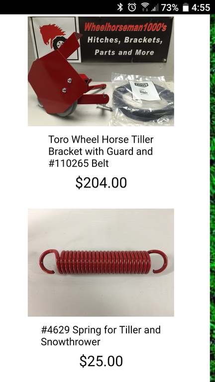

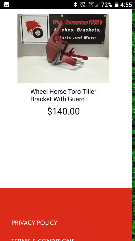

WVHillbilly520H 10,379 #3 Posted February 26, 2018 @wheelhorseman, I believe he has what you need, Jeff. Share this post Link to post Share on other sites

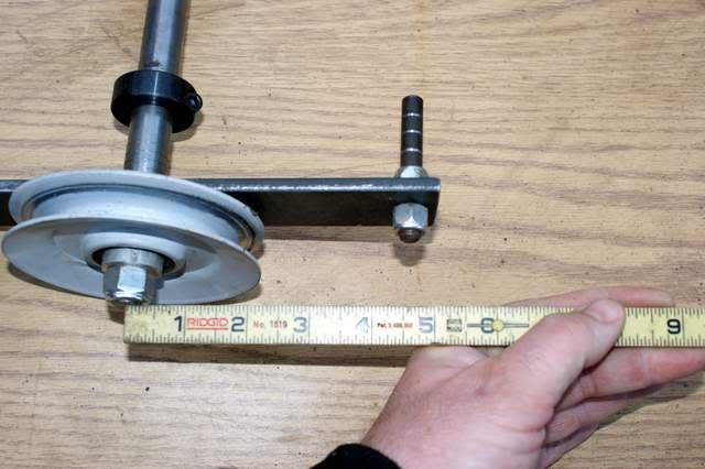

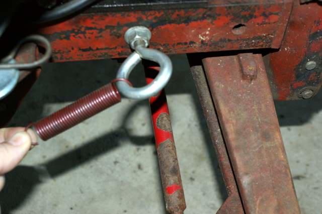

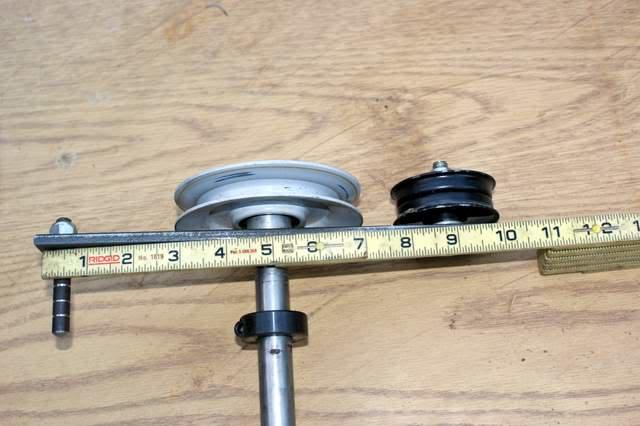

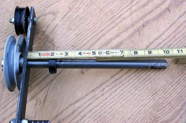

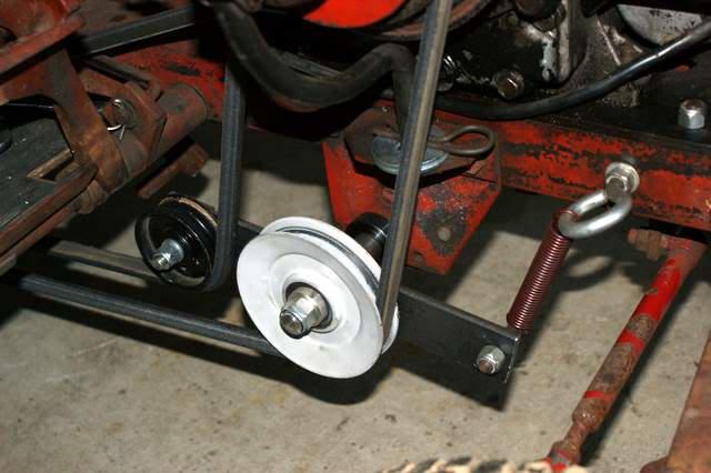

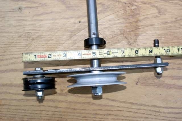

daveoman1966 3,884 #4 Posted February 26, 2018 Here is a option too... all parts from local hardware store and no welding needed. 3 1 Share this post Link to post Share on other sites
