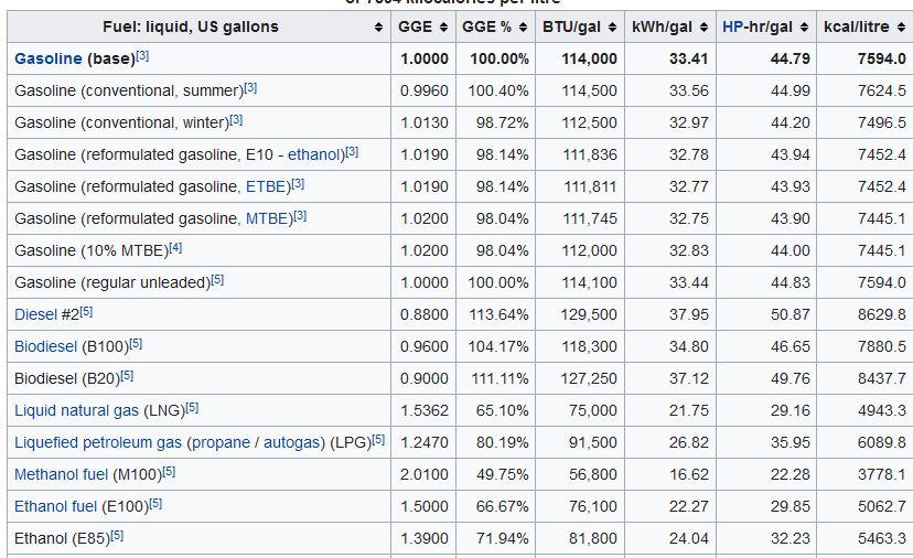

pfrederi 20,671 #10 Posted February 25, 2018 Even in vehicles designed for it Ethanol reduces gas mileage as there are fewer BTUs (or hp hours) per gallon. Note on this chart how much weaker the E85 stuff is and that is what some are pushing for....sad. 1 3 Share this post Link to post Share on other sites

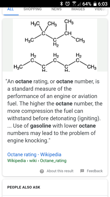

WVHillbilly520H 10,378 #18 Posted February 25, 2018 With my vague understanding the octane rating is how well the fuel will resist detonation (or pre ignition) before spark, and lower compression engines such as our little air cooled engines and most daily driven cars trucks (9:1 and under) now as we raise compression and/or force induction (turbo/supercharged) the need for higher octane fuels with normal (older) fuel delivery systems (carbs, throttle body injection, intake port injection) but as more sophisticated computer controlled ignitions and direct port injection are coming on board higher compression can be used with lower octane fuel like my '14 Silverado 11:1CR direct port injected tuned for 87 or E85 and when I do run E85 it definitely comes alive but goes from 18mpg to 12-13mpg, running 93 octane in a vehicle "tuned" for 87 won't run any better or give any better fuel mileage, supposedly higher octane fuels have higher levels of detergents ect for helping eliminate carbon deposits thereby helping prevent detenotaion along with the octane, here in VA a local farm related fuel provider sells non ethanol fuels in 87/89/ and 93 octane but I still buy the 93 only for its supposed better additive/detergent package, I really haven't noticed any difference between 87 and 93 for power but haven't had any of the carb issues since going nonE93 , the old saying pay me now or pay me later really stands for itself here, so there's my with a dollars worth of change, Jeff. 2 Share this post Link to post Share on other sites

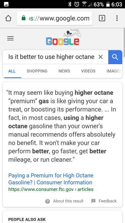

lynnmor 8,845 #20 Posted February 26, 2018 Pretty much the same cleaning additives in all grades of gasoline. Will higher octane gasoline clean your engine better? No, as a rule, high octane gasoline doesn’t outperform regular octane in preventing engine deposits from forming, in removing them, or in cleaning your car's engine. In fact, the U.S. Environmental Protection Agency requires that all octane grades of all brands of gasoline contain engine cleaning detergent additives to protect against the build-up of harmful levels of engine deposits during the expected life of your car. https://www.consumer.ftc.gov/articles/0210-paying-premium-high-octane-gasoline 2 Share this post Link to post Share on other sites
