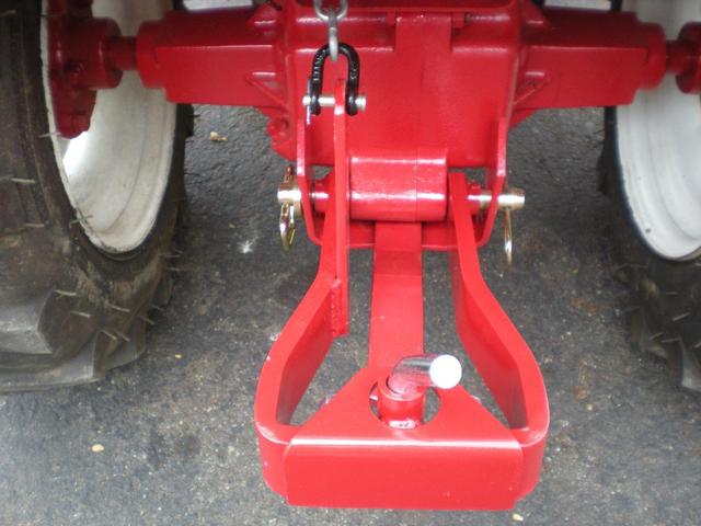

953 nut 66,614 #3 Posted February 25, 2018 8 hours ago, 12 hp Kohler said: someone will be along soon to help. @953 nut you are being summoned Did I hear my name being called. This interchange list will give you a starting point. WH Interchange 1955-2000.pdf In addition to the slot hitch implements you could consider changing over to the Clevis Hitch which will allow you to use all sorts of later model implements. Lowell sells them new or you can try to find a good used one on Ebay or elsewhere. https://www.wheelhorsepartsandmore.com/hitches-liftkits.html#!/Toro-Wheel-Horse-Brinly-Clevis-Hitch-Sleeve-Hitch-with-adjustment-plate-and-pin/p/84960091/category=235480 1 Share this post Link to post Share on other sites
