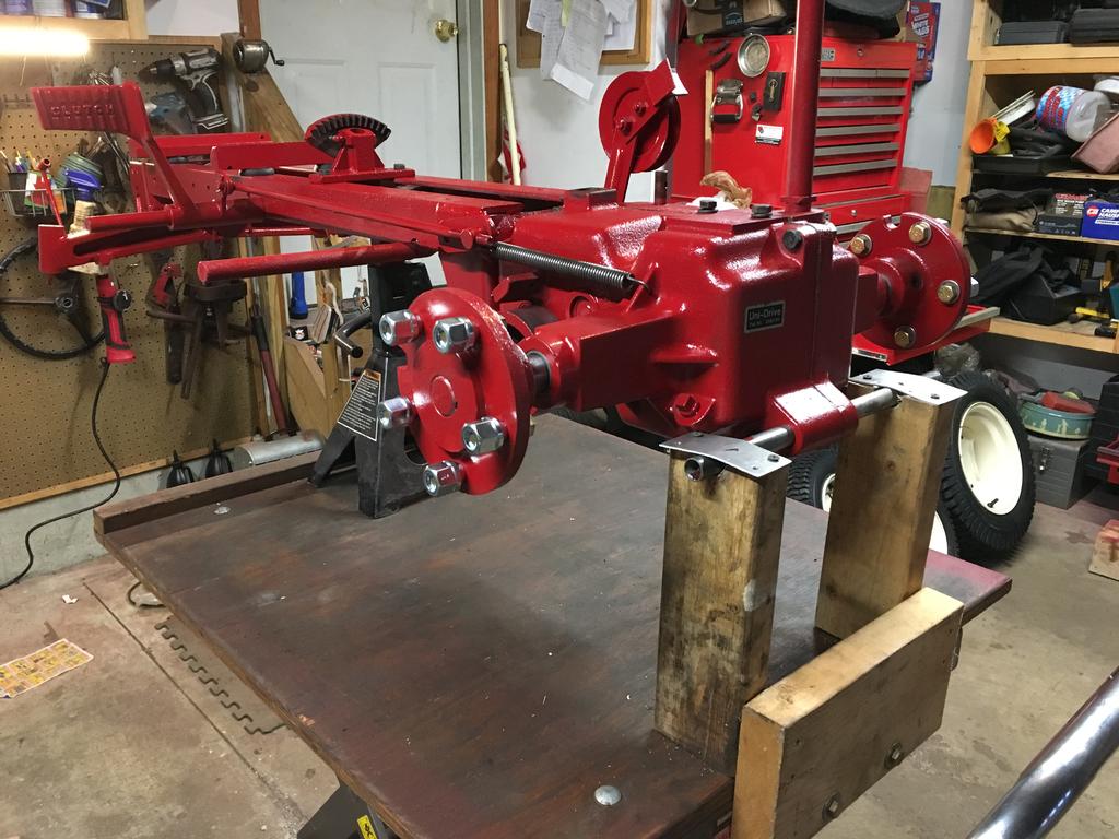

classiccat

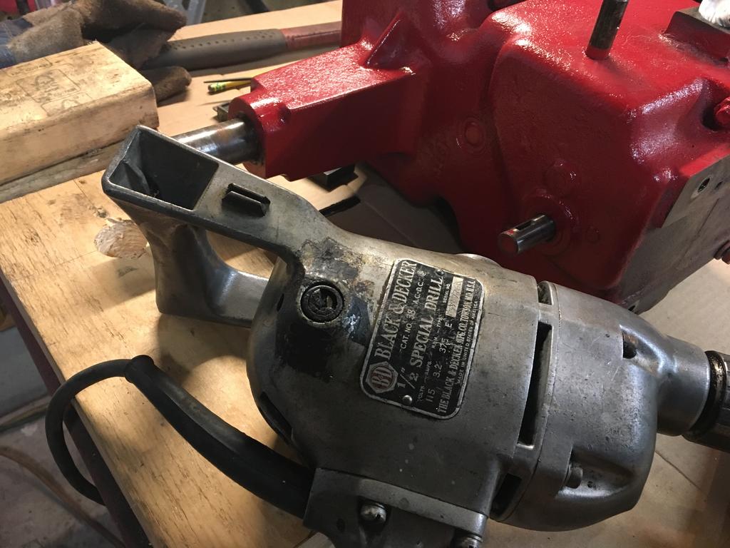

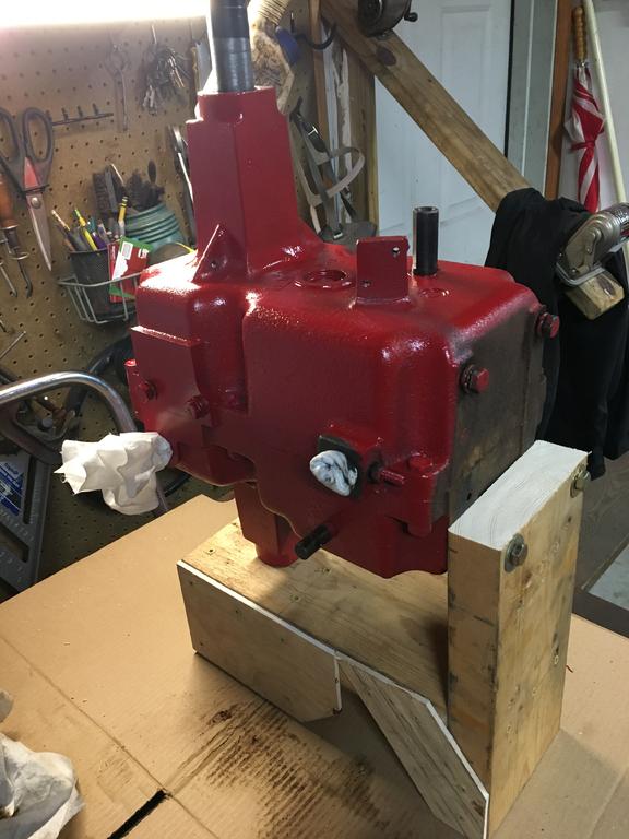

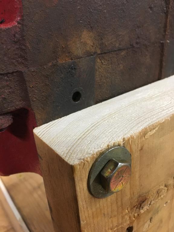

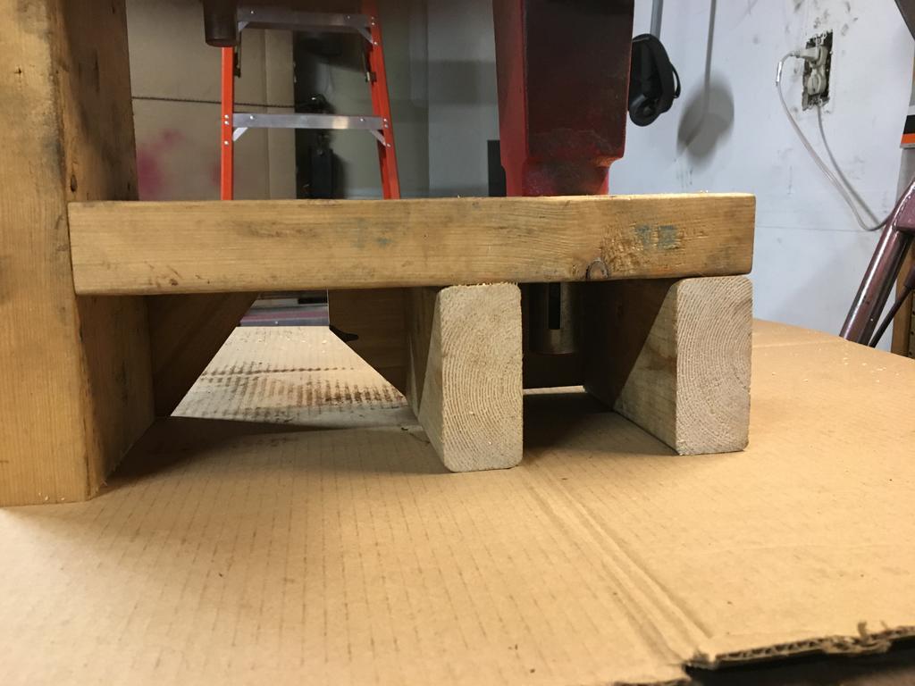

I'm sure there are a few tranny braces on here.
Here's my take using some scrap 2x6 and 2x4 lumber and some thin ply for gussets.
Using my late grandfather's black-and-decker wrist-snapper to bore out a 1 1/4" hole:
I left a little space to push-up or turn the axle/differential if needed:
I reckon I'm going to need to access that little plug for one of the detent balls:
  • Like 5

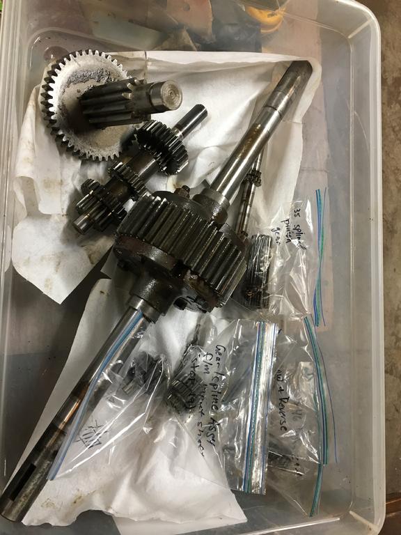

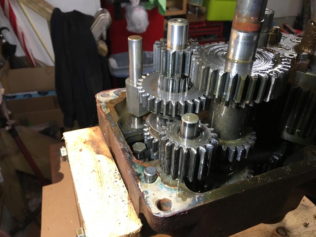

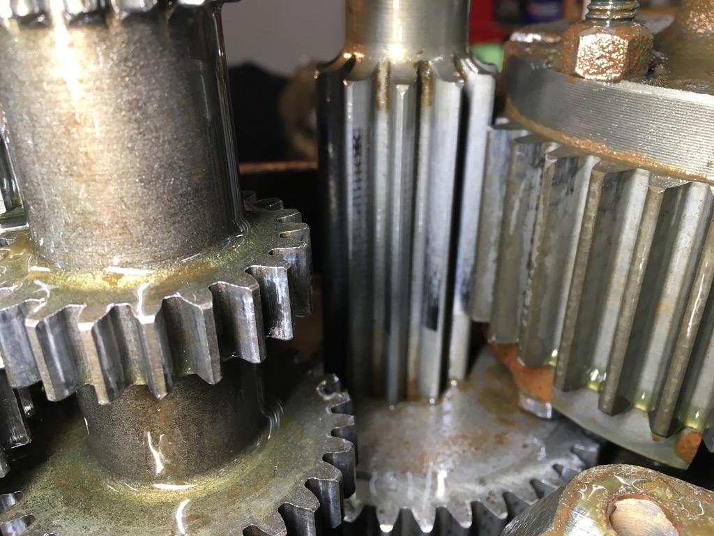

classiccat

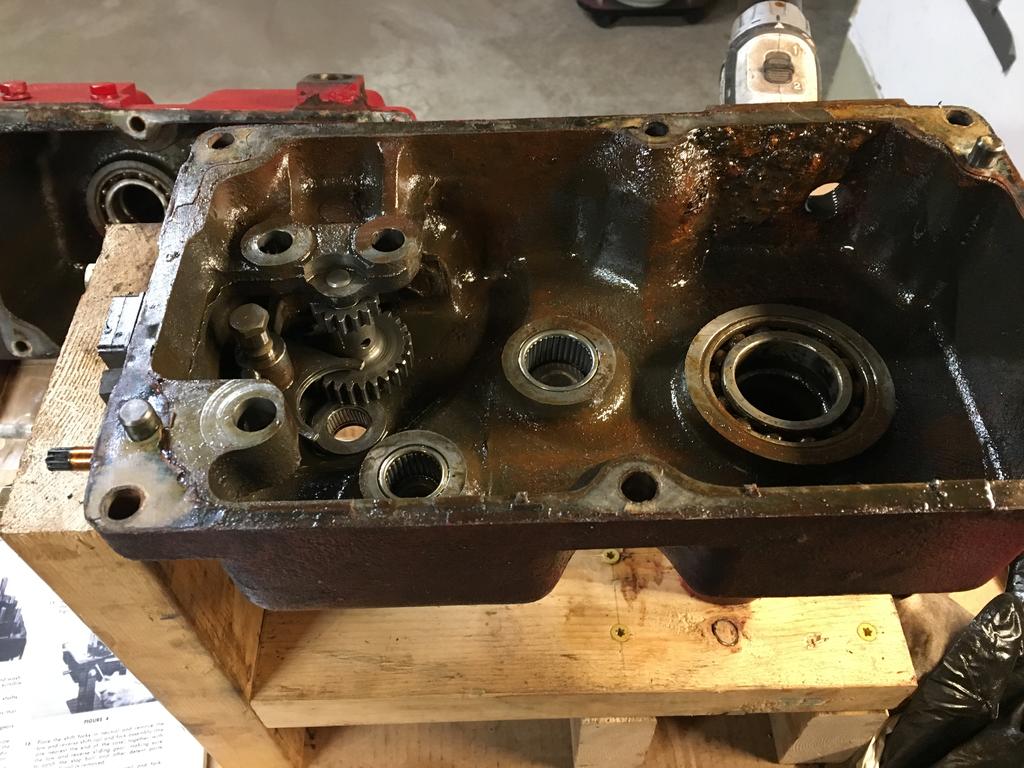

Once I removed the 6 bolts, I followed steve-o-saurus's recommendation of tapping on the seam with a wood chisel...after a lap or 2 around the assembly, it started to split.
Then I just grabbed the sucker, pushed-own on the brake shaft with my thumb and worked-it-off:
I was expecting much worse!  those main (expensive) axle ball bearings (1 1/2" ID) are intact and so far no needle bearings are out of place.
To my untrained eye, these gears look barely used.
A little pause to figure out the preferred order for taking the rest of this down.
Thanks for the support & encouragement folks!  :thumbs:

ebinmaine
Yo trans-massion internals looks right lovely.

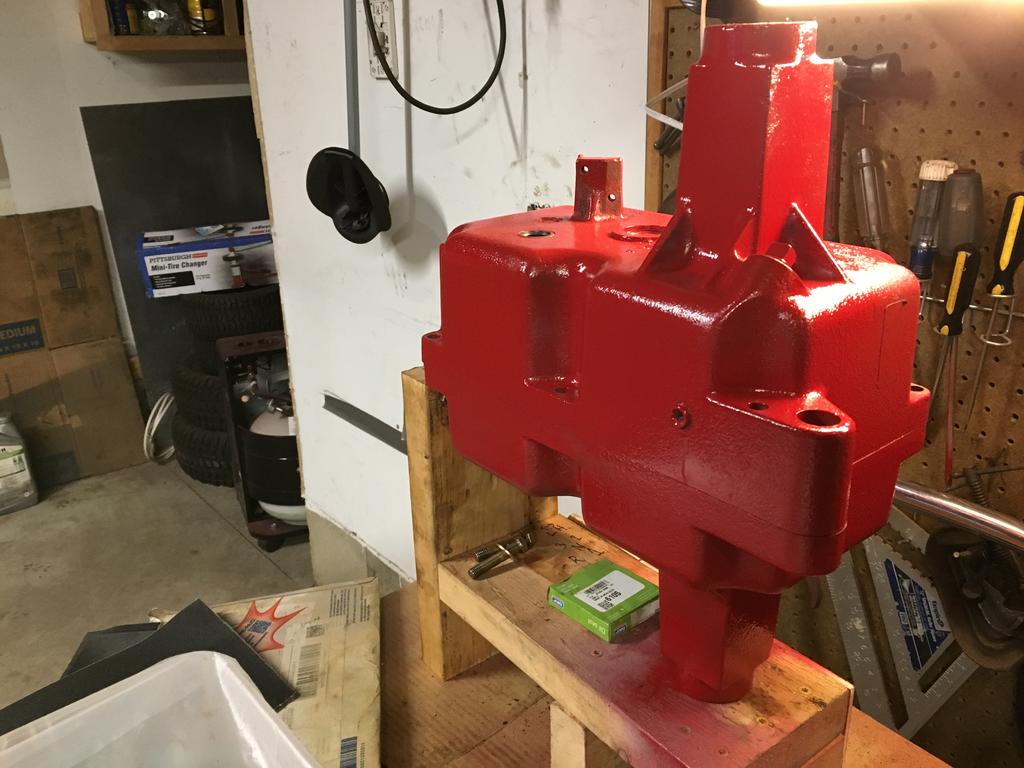

classiccat

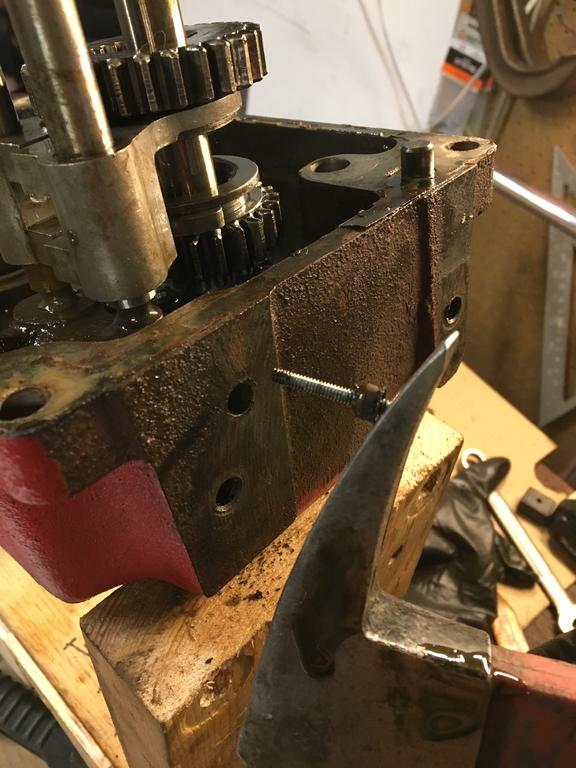

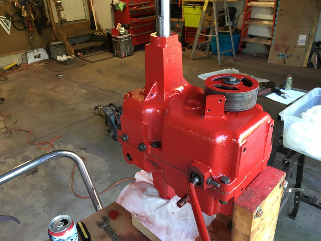

Finished tearing down the Trans waiting for an input shaft seal and case gasket.
I'm not sure how folks get this plug out, I drilled-tapped a 6/32 screw and popped it out with a claw hammer:
I also took the opportunity to do a more proper paintjob on the trans and frame.
Edited by classiccat
input shaft seal
  • Like 4

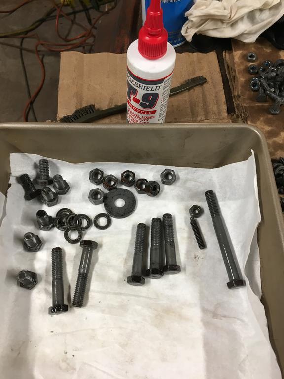

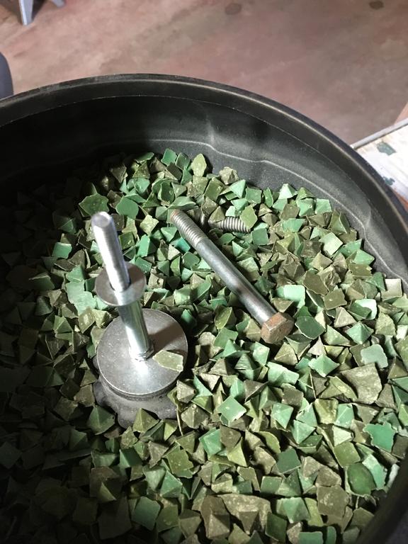

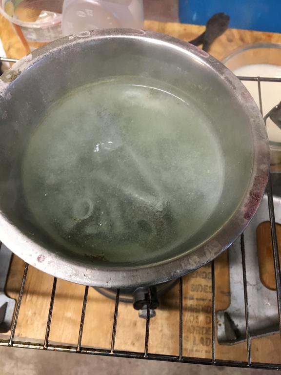

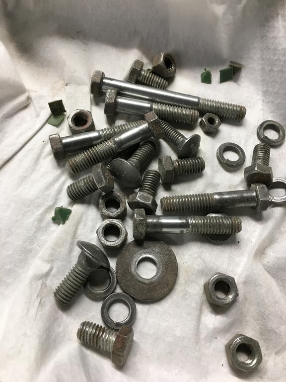

This weekend, figured I'd try my hand at restoring some fasteners and retain more of a natural finish rather than painting.
After a some 'Tube research, Parkerizing seemed to fit the bill.
I don't have a media blaster so I went back-and-forth between wire wheel, evaporust and a tumbler to clean-up the HW.
Once getting clean (they really should be spotless, mine weren't), I basically cook it in some manganese parkerizing solution for about 15min, I rinse off the parts in water then dunk them in a bath of WD40 (to get rid of the water).
Afterwards, they get a coat of Boeshield T-9 oil.
I probably should've keep these parts in the tumbler for a few hours longer but it's good enough for me!

Pullstart
I’ve never pulled that plug, no transmission I’ve had apart ever had it to begin with!  I read somewhere that you can plug it with silicone upon reassembly.
  • Thanks 1
classiccat
Being a uni-drive NOOB, I followed the service manual as much as possible.  With this 5091 transmission, I think it would be difficult to deal with the input shaft particularly during reassembly (detent: ball <--Spring/Rod --> ball).  Either way, it wouldn't be the 1st time (nor the last) that I created more work for myself!  :lol:
I'm thinking of keeping a stainless 6-32 screw in there along with some sealant in case it needs to be popped back off down the road.  The head just needs to sit flush with the case.

classiccat
Quick update on this... checked the fasteners before hopping in the truck for work this am and the parkerized coating soaked-up that Boeshield like a sponge; No wet/oily feeling.  :lol:

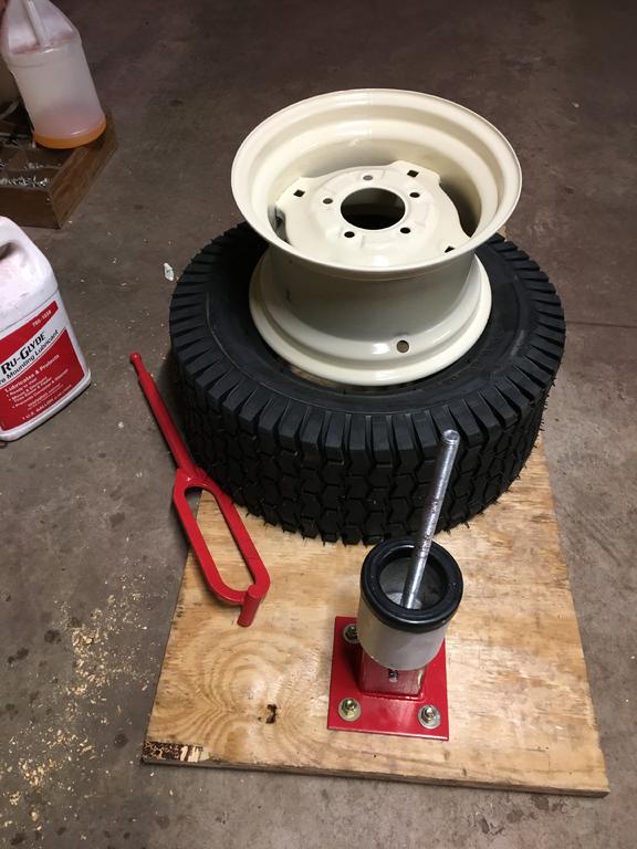

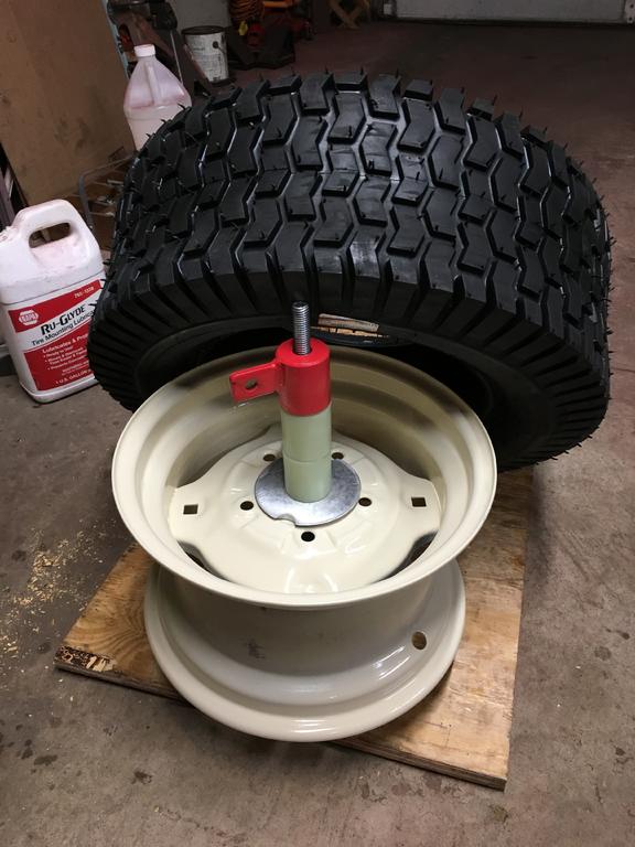

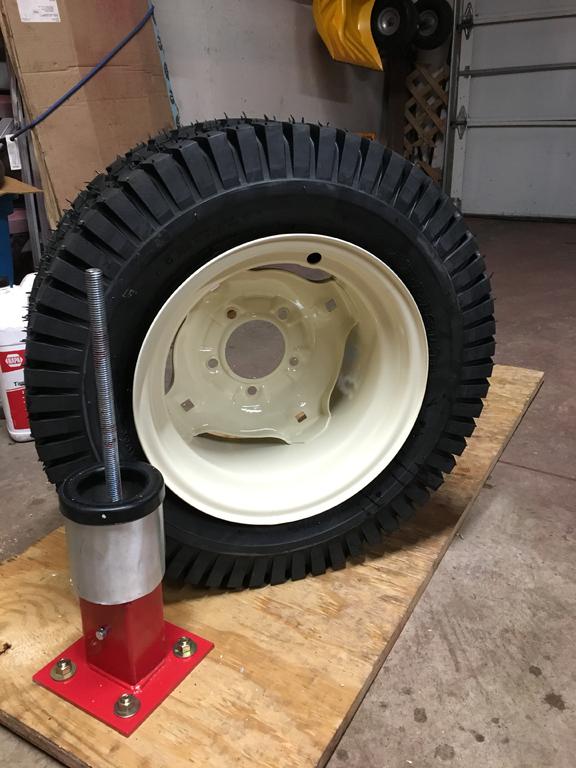

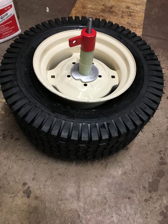

Tire mounting with the HF mini changer was a breeze; a few minutes per tire.   I actually thought the 8" fronts were a little easier than the 12" rears.
^^^ damage to the freshly painted rims was incredibly minimal... limited only to a portion of the "inside" rim edge; whatever side you mount "up" in the tool.
^^^ outsides were completely unscathed.
Before I set the bead (I need valve stems anyway), i'll wrap the tires in plastic and touch-up the edge damage.

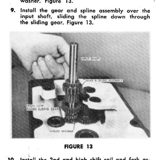

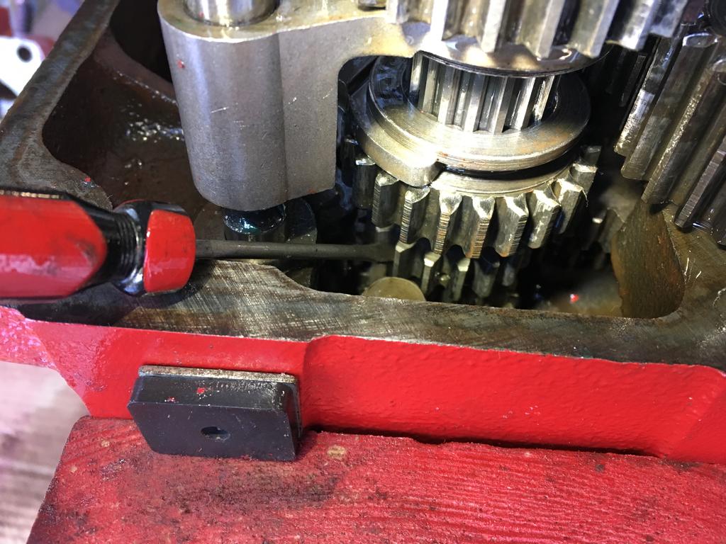

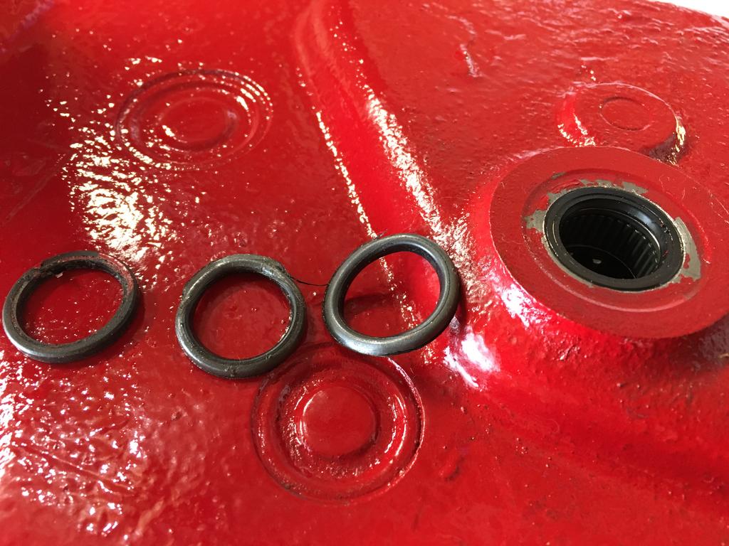

The C85's gearbox is finally back together.:eusa-clap:
I'm really digging the Parkerized HW; cooking-up a 2nd batch this weekend.
I was waiting on my 3rd input shaft seal.  :doh: (the 2 axle & brake-shaft seals installed without a hitch)
^^^ L->R: Original -> SFK-fail#1 -> SKF-fail#2 and Toro-FTW.
Which brings me to a few tripping hazards when reassembling a 5091.
1.) If installing the input shaft seal from the outside (not removing the needle bearing), carefully file a little chamfer on the case rim where the input shaft seal goes (protect the needle bearing from shavings if it's installed).. the sharp edge was catching the edge of the SKF seals and once you kink them, they're shot.  The Toro (100402) seal seemed more forgiving than the SKF 6105 seal in this case.
2.) Keep something in front of that shift-rail detent passage (I got the warning & "magnet" tip right here on Red Square :wh:).  I knew about this and STILL one of my detent balls got shot out into my driveway when I over-actuated the Low/Reverse shift rail.
3.) Pay attention to the orientation of that gear and spline assembly (screwdriver is pointing to it in the image above).  Everything will likely go back together but you will have a hard time turning the input shaft in neutral; glad I tested before buttoning-things-up!
Have a great St. Patrick's Day weekend folks!!!

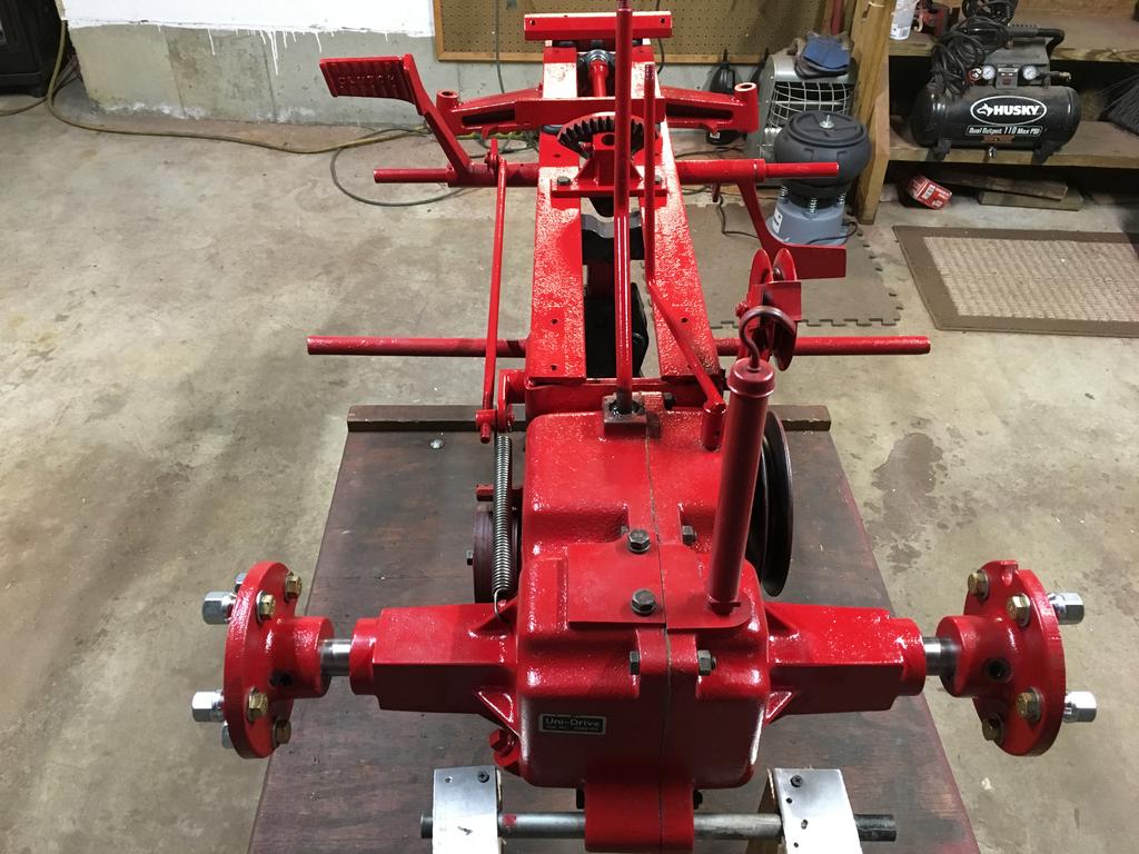

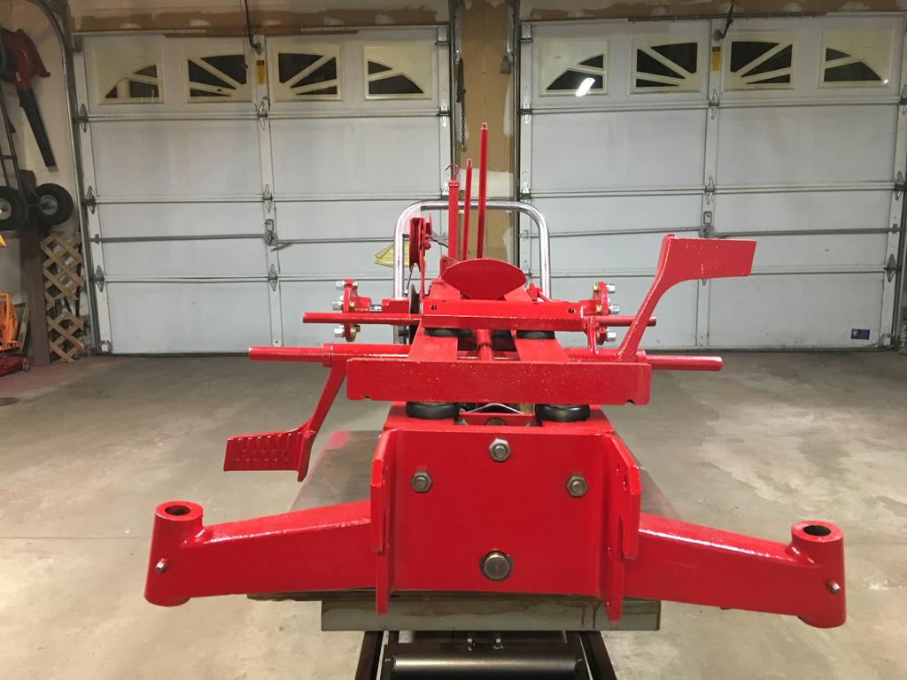

classiccat
She’s starting to look like a tractor again.
0A95BAC2-182A-4418-84F5-4268FCEDD823.jpeg.4376ad59fc84a0c0eb97c2fbd31cc040.jpeg73735A2A-4BA5-46A1-9186-A86DA296130D.jpeg.78285810aec04f703d94dbb60062f8fa.jpeg238109B8-E654-4BD0-AA6C-95905BA03EC3.jpeg.92903ca300b5f0d6de25588e4ecdbf8e.jpeg

Jim H
Absolutely beautiful
  • Like 1
  • Thanks 1
Pullstart
What a piece of work!  I like the stand, too :handgestures-thumbupright:
  • Thanks 1

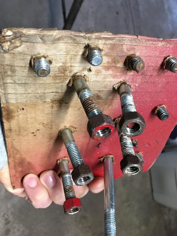

classiccat

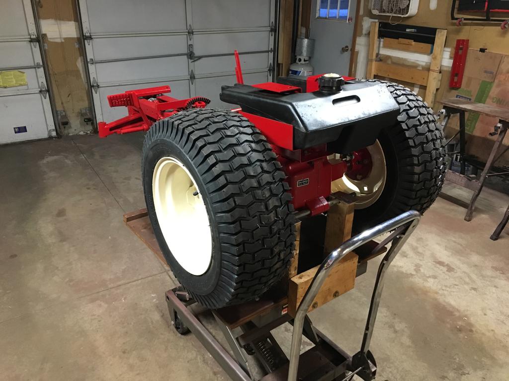

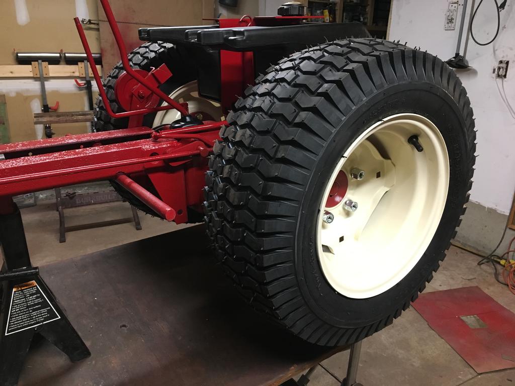

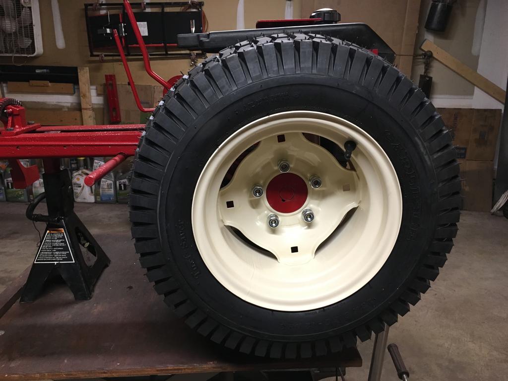

Got the new rear kicks mounted.
E2135B2B-D151-47FC-93E7-7B57D88FD995.jpeg.1d58243c027bf8eff6c10d2339d113a5.jpeg1FBB025C-A55C-4331-A04A-B4E97F9F0A72.jpeg.2bc3ca61c6e3e999f0619c99b0f51053.jpeg7CA69B28-6578-4323-BC04-42619E1DB6D9.jpeg.3fd3eca851f06c3269b8227d224d0ce1.jpeg
^^ went with installing 7/16-20 1-1/2” long studs & lug nuts (from MMC).  Clearing the keyway setscrew was tricky on 1 bolt.

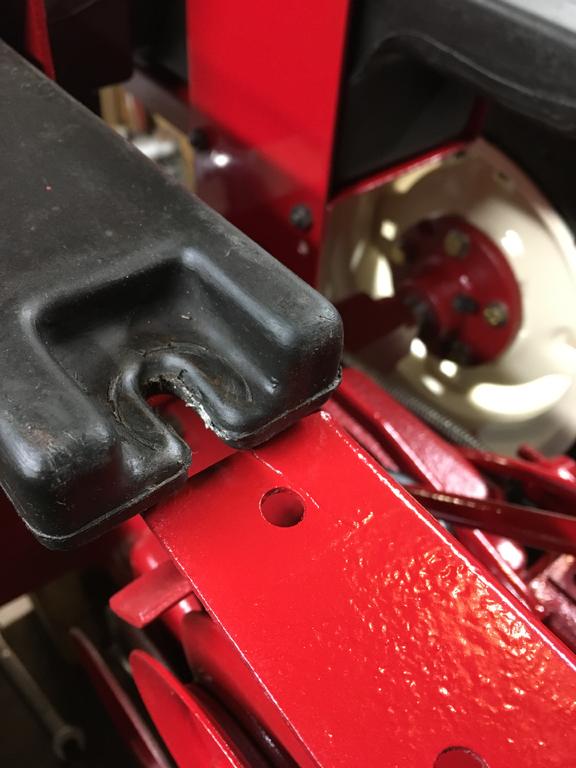

The body/tower is temporarily mounted to see what clearances we have for addressing these stress cracks and beefing things up here... it looks like simple angle iron will work below and clear the clutch pulley and side covers.
  • Excellent 2
ebinmaine
Trina and I have done this on all our Horses and will add them to every other one we build.  :greetings-clappingyellow:
Doesn't help you now :P but I've found I need to remove that set screw on mine while installing the closest stud bolt.
Keep up the good work!!
