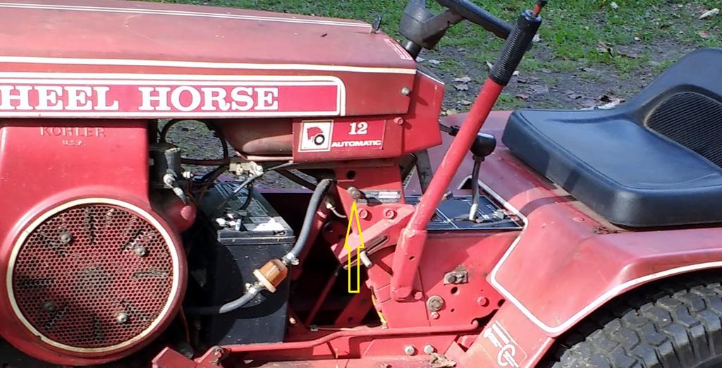

paxz71usa 173 #1 Posted February 18, 2018 Sorry to bring this up again. I know it's been on here before, but when I need the thread I can't seem to locate it. The metal gas shut off valve on my 1973 12 automatic decided to start leaking today while bringing in wood. I would like to repair it if I could, but of course I will replace it if needed. Anyone guide me in the right direction? I must caution though, when I go into my shop, my tool supply consists of my child hood HANDY ANDY tool kit. Anyone willing to show their age and admit they know what a HANDY ANDY tool kit is? The valve as shown in the photo is mounted on the left side dash panel, not under or through the tank as a couple of earlier threads that I've found. Thanks Gary 1 Share this post Link to post Share on other sites

paxz71usa 173 #7 Posted February 18, 2018 Thanks, pretty sure that would work, but I would like to keep it original if possible. Think I'll just drain the gas and take the old one out and see what make it tick. Maybe there is something replaceable in there. I may install there home depot one temporarily till I figure out what's what. Gary 1 Share this post Link to post Share on other sites
Thegearhead0324 1,873 #8 Posted February 18, 2018 (edited) I'm wondering if there's an O ring in it like the gas tank mounted ones. Just keep turning out the valve knob until it comes out and replace it. Edited February 18, 2018 by Thegearhead0324 1 Share this post Link to post Share on other sites
squonk 48,321 #9 Posted February 18, 2018 1 minute ago, Thegearhead0324 said: Nor really sure if it's the same as mine, but on my 1257 I took the shut off valve apart and there's an O ring on the little shaft that made mine leak. You just keep turning it out until it comes apart then take the O ring out. Yes that 's the way to do it. It's bolted to the hood stand if I remember right. Kind of a PITA to work on unless you remove a few things but just changing the o ring is easy as long as you drain all the gas out first. 1 Share this post Link to post Share on other sites
paxz71usa 173 #10 Posted February 18, 2018 Thanks Squonk, I'm a little slow on the up take. Took me a couple of minutes to figure out PITA . Kind of looked like that would be the case, but the O-ring was what I was hoping to find in there. Hope that's all it is. Gary 1 1 Share this post Link to post Share on other sites

R. L. Addison 300 #16 Posted February 18, 2018 (edited) Seems to me there is an o-ring, but I stopped the leak by wrapping Teflon around the stem & replacing the nut. Unscrew the packing nut, back out the valve knob, unscrew stem out of valve, change o-ring, slide nut to thumb knob, wrap Teflon around stem, & reinstall. If you tighten packing not too tight, you will not be able to turn knob to open or close valve. Edited February 18, 2018 by R. L. Addison 1 Share this post Link to post Share on other sites
