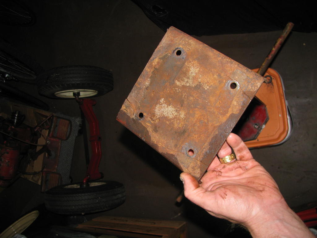

R. L. Addison 300 #7 Posted February 10, 2018 Might look at the frame while you are about it, where frame bolts to transmission, see if it may be cracked and belt starts slipping/chattering with weight shift. Ron 4 Share this post Link to post Share on other sites
AMC RULES 37,254 #8 Posted February 10, 2018 It should not look like this. Share this post Link to post Share on other sites
Sarge 3,470 #9 Posted February 11, 2018 Lol - that looks new compared to my 1277...it's shattered, again. Sarge Share this post Link to post Share on other sites
