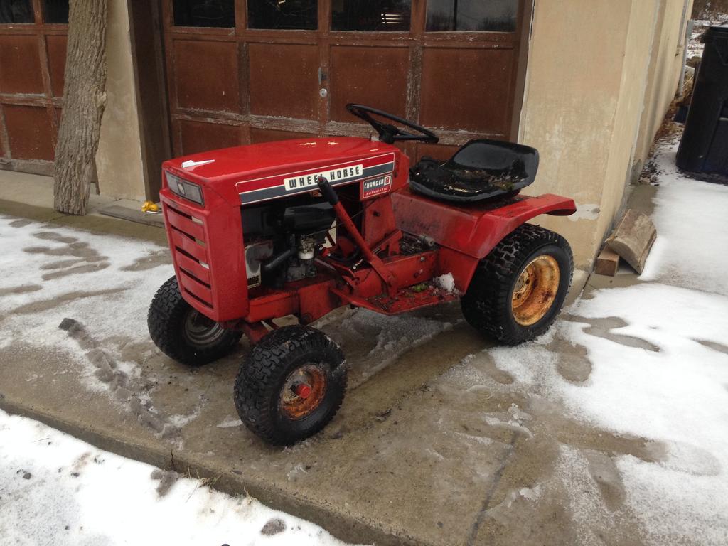

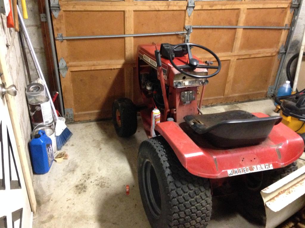

mrshaft696 131 #1 Posted February 6, 2018 So I picked this up for 40 bucks over the weekend..... this is one of the only places on the web that I can even find any reference to it at all. I assume it is because it is not the most popular and has a vertical engine... This one has a 8hp Tecumseh , looks to be in good shape. It hasn't ran in a while but the oil looks clean & hoses in good shape. Is there any info out there on these? I can find manuals for a commando 8 or a charger v8... I am really annoyed that I don't understand how to free wheel the hydrostatic trans yet, so its a problem to move around. When I jack it up the wheels spin opposite (open diff). Gonna try and start it this weekend after I hook up some new fuel lines. 5 2 Share this post Link to post Share on other sites
953 nut 70,667 #2 Posted February 6, 2018 This manual on your transmission should be helpful. 2 Share this post Link to post Share on other sites

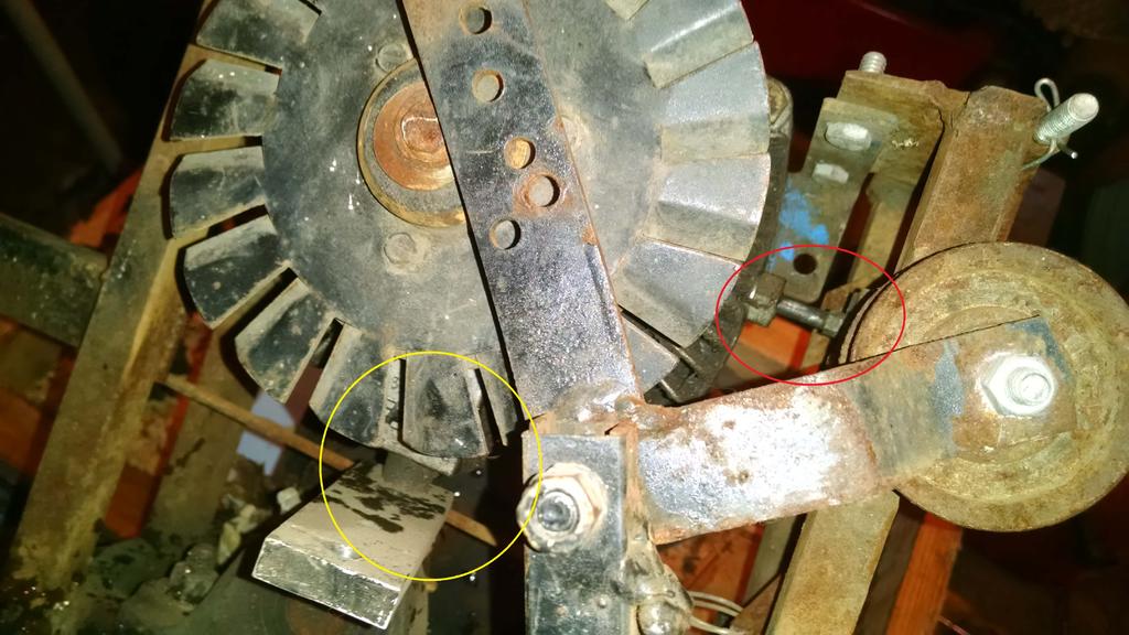

Achto 32,964 #4 Posted February 6, 2018 35 minutes ago, mrshaft696 said: I can find manuals for a commando 8 or a charger v8.. Yours is the Charger V8, the V Stands for vertical engine. As far as the release valve for the trans... the only Charger V8 that I have had experience with also had the no neutral issue. The T handle on the left side says that it will shift the trans into neutral, but there is no neutral pin installed on the Eaton trans from the factory. Share this post Link to post Share on other sites
WHX?? 58,388 #5 Posted February 6, 2018 While verticals are not on most bucket lists with the fellas here don't mean we don't know they exist. Yours looks pristine and for 40 clams I woulda bought it just for the hood ornament! You done real good and you came to the right place for any and others will be along to welcome you and tell you what they know about it. Share this post Link to post Share on other sites

Achto 32,964 #13 Posted February 6, 2018 To help you out with your neutral issue I took a pic of an Eaton trans that I had laying around. I'm not sure what the P.O. had it rigged up for. Circled in yellow is the speed/direction control lever. Circled in red is the neutral pin. It should be 90 degrees to the speed/direction control. This is the pin that was nonexistent on the transmission that was in the Charger V8 that I worked on. There wasn't even a place to install the neutral pin. If you do not have this pin on your tranny, then it is not equipped with a neutral/free wheel option. Hope this is helpful. 4 1 Share this post Link to post Share on other sites

mrshaft696 131 #15 Posted February 7, 2018 19 hours ago, Achto said: To help you out with your neutral issue I took a pic of an Eaton trans that I had laying around. I'm not sure what the P.O. had it rigged up for. Circled in yellow is the speed/direction control lever. Circled in red is the neutral pin. It should be 90 degrees to the speed/direction control. This is the pin that was nonexistent on the transmission that was in the Charger V8 that I worked on. There wasn't even a place to install the neutral pin. If you do not have this pin on your tranny, then it is not equipped with a neutral/free wheel option. Hope this is helpful. thanks, I didn't realize that it might not be an option, feel bad for folks that got them stuck out in a field... Might try and get it started tonight & hopefully drive it this weekend we will see, weather has been rough here....if not the weekend I can get into it. 2 Share this post Link to post Share on other sites

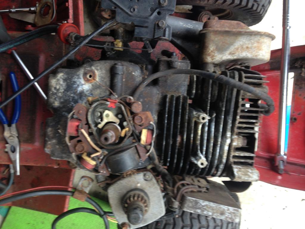

mrshaft696 131 #16 Posted February 11, 2018 Ok so I spent some on the tractor, ran new fuel lines and a few other things...threw in a battery and the tractor starting cranking... Last night i had spark but it was pretty weak, today i took the flywheel off and set the points and cleaned them etc... now no spark.... So i am not exactly sure the problem but last night i got a few back fire out the exhaust, now nothing at all. So the starter works, carb is clean, fuel lines are clear, this thing is old school with points and all. The points are clean looking so I dont know what happened, so I have to start researching parts for this engine because i got nothing... there was mouse nests etc in there, a few taps to the starter and it was working.... It would not fire off, but i can tell it is getting plenty of fuel, I am 99% sure the points/condenser etc are screwed up, so i have to find where to get parts for this... 2 Share this post Link to post Share on other sites

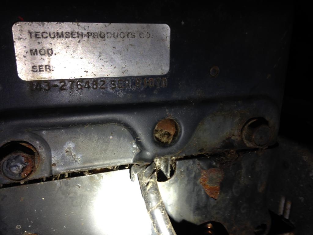

Howie 900 #18 Posted February 11, 2018 That engine is off of a Craftsman product. That 143 number tells you that. There is a list put out by Tecumseh that cross references it to the Tecumseh model number. Ok I went and looked it up, it is VM100-157015A. Believe that is a 10hp engine.Some of the aftermarket points I have had trouble with in getting a spark.from. Part number for the points is 30547A and the condenser is 30548B. 3 1 Share this post Link to post Share on other sites
Sarge 3,473 #19 Posted February 11, 2018 Did you clean the new set of points ? Sometimes they have a slight coating on them, just use a piece of paper with some brake cleaner on it , pull it through when they are closed. You can test them by using an ohm meter. Sarge 2 Share this post Link to post Share on other sites
mrshaft696 131 #20 Posted February 11, 2018 28 minutes ago, Sarge said: Did you clean the new set of points ? Sometimes they have a slight coating on them, just use a piece of paper with some brake cleaner on it , pull it through when they are closed. You can test them by using an ohm meter. Sarge They are not new, I was not getting a good spark ( I think) so i took the flywheel off to see what was going on. It was sparking last night but after i cleaned and set the points to .020 gap I got nothing at all. I tried a ton of other gap settings just for the heck of it but still no go....There was tons of mouse crap and junk in the head & everwhere, so now everything is clean but no spark. Share this post Link to post Share on other sites
Sarge 3,473 #21 Posted February 11, 2018 Need to use an ohm meter and check continuity between the points and ground - if the engine block is not grounded tight it can cause a no contact/spark issue. Teckky's are touchy as it is...lol. Sarge 2 Share this post Link to post Share on other sites
Howie 900 #22 Posted February 11, 2018 Clean them good and set to .020. That condenser has been in there a looong time also. 2 Share this post Link to post Share on other sites
mrshaft696 131 #23 Posted February 11, 2018 (edited) 10 minutes ago, Howie said: Clean them good and set to .020. That condenser has been in there a looong time also. thanks, yeah im just annoyed since it was sparking a little bit, but now that i took it out to inspect & check nothing is happening. Very annoying.. the condenser is rusted so I can try replacing... The points look fine & are shiny & clean. I wire brushed all the exterior of the parts, figured it would help. I am going big tires with it... 23x9.5x12 barely fits...... Edited February 11, 2018 by mrshaft696 4 Share this post Link to post Share on other sites
Howie 900 #24 Posted February 11, 2018 Have had brand new ones do the same. I clean them and avoid touching the contacts because even that can affect them. Always like new condensers also and that one is old. They can get weak and not hold the charge that is generated. Holds less and will allow a weak spark. I have a tester here that puts current in the condenser to test and if not discharged will give you a good jolt on a good one! Share this post Link to post Share on other sites
mrshaft696 131 #25 Posted February 11, 2018 3 minutes ago, Howie said: Have had brand new ones do the same. I clean them and avoid touching the contacts because even that can affect them. Always like new condensers also and that one is old. They can get weak and not hold the charge that is generated. Holds less and will allow a weak spark. I have a tester here that puts current in the condenser to test and if not discharged will give you a good jolt on a good one! so I guess i can only buy the points and condenser, not the entire assembly? Share this post Link to post Share on other sites
