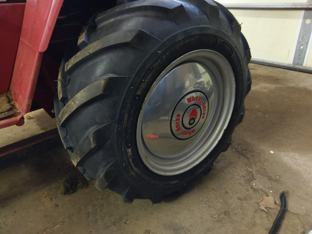

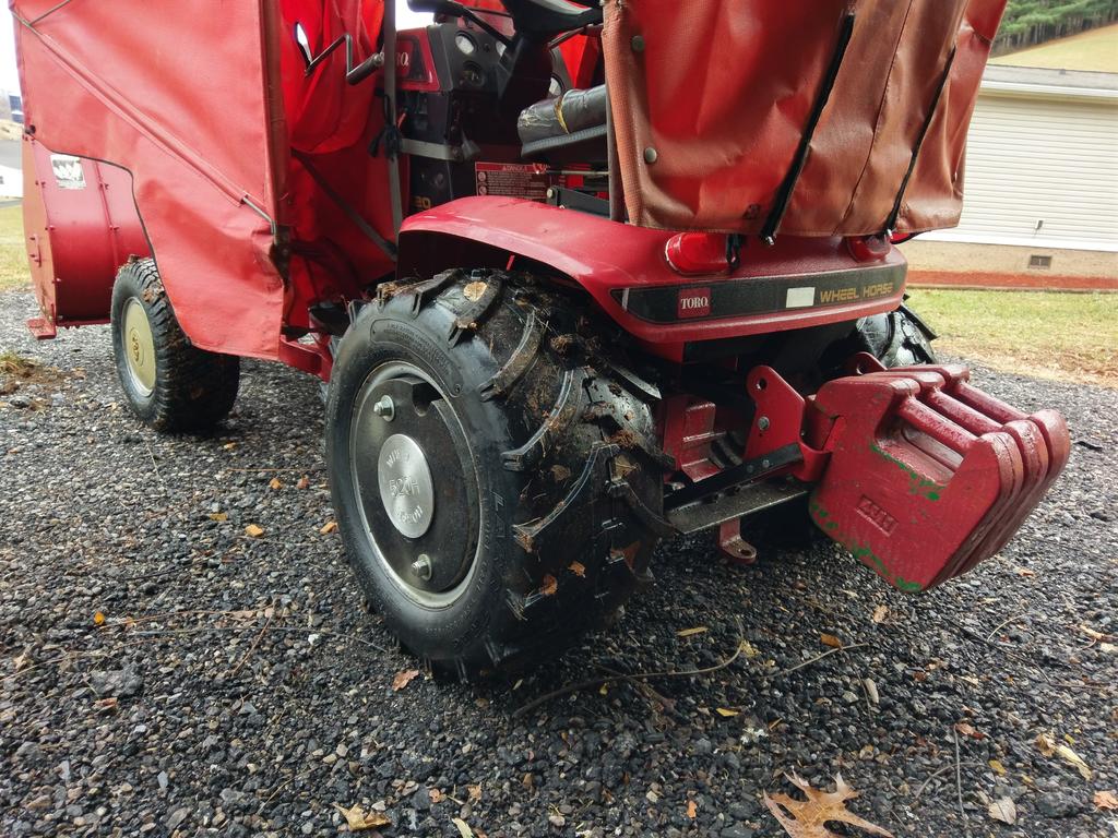

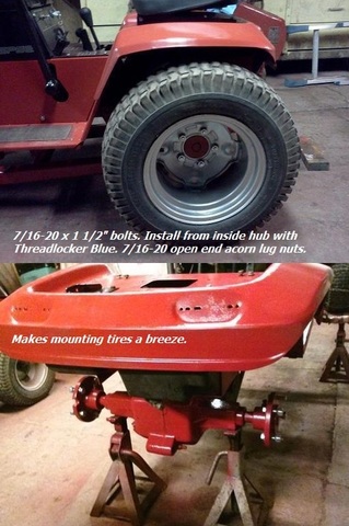

Tankman 3,528 #5 Posted February 4, 2018 (edited) I have, and still do, use 23x10.5x12's. Never had any problem. You did say, "wider". http://www.millertire.com/categories/lawn-garden-tires/23x10-50-12/ Another change, for me always, lug nuts. Shown below on my '90 520-8. Also on my 416-8. Edited February 4, 2018 by Tankman 1 Share this post Link to post Share on other sites

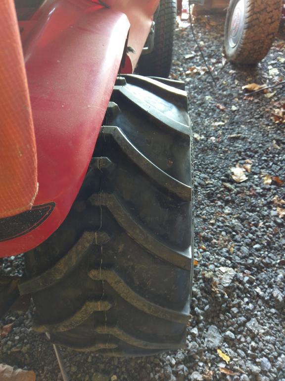

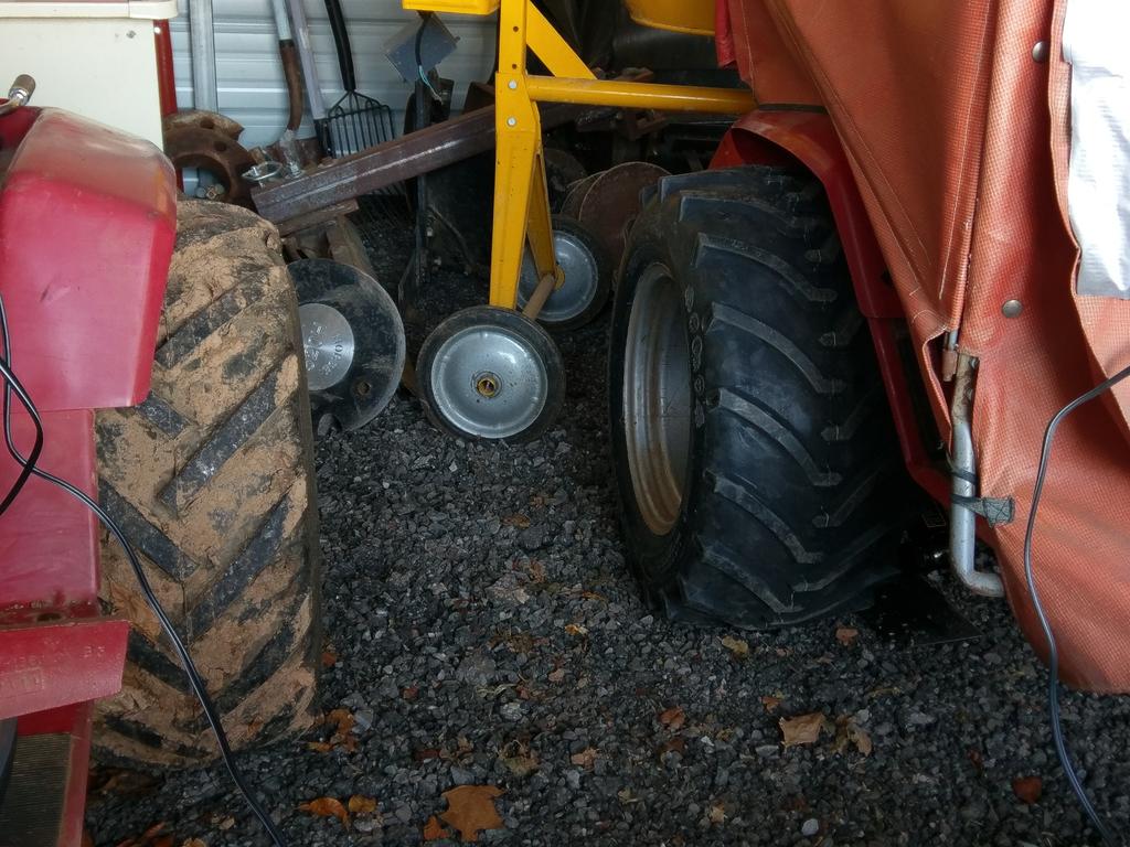

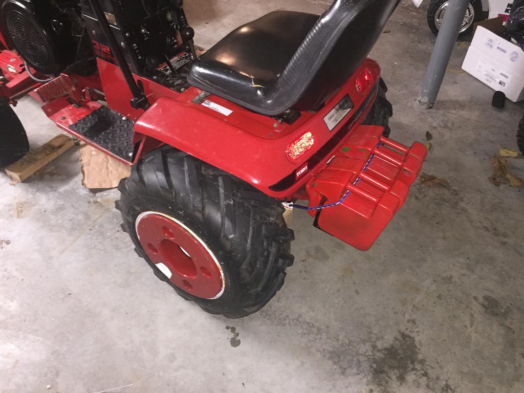

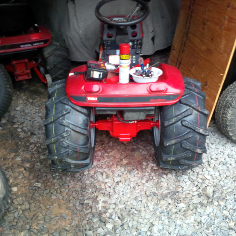

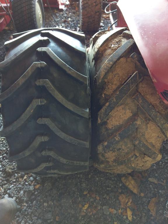

littleredrider 409 #6 Posted February 4, 2018 I put Firestone 23x10.5s on my 520, and IMO aren't wide. Rims are 8.5" wide, and when looking down the side, the tread is the same width as the rim. I dunno how/why people run these on 10" rims. I put a set of ATV tires on the 518, 8.5" rims, tires are 25x12x12 Super swamper vampires. They fit under the seat pan and foot board, but is close. I had to move the hubs out cause the side lugs stick waaaaaaaayyyyyyy out, and hit the brake band. I've been trying to snap a pic, but time and weather won't let me. I want to try the 24x12x12s... 2 Share this post Link to post Share on other sites

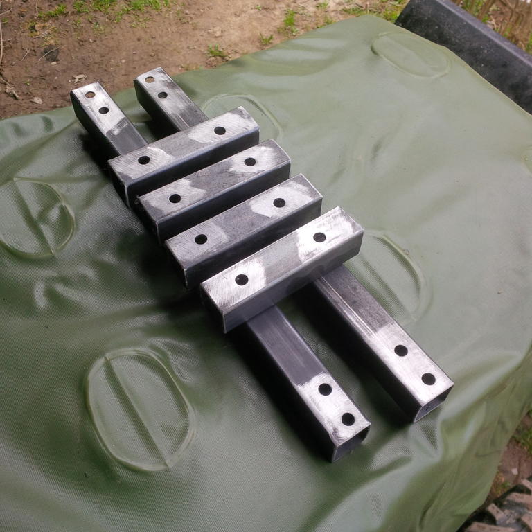

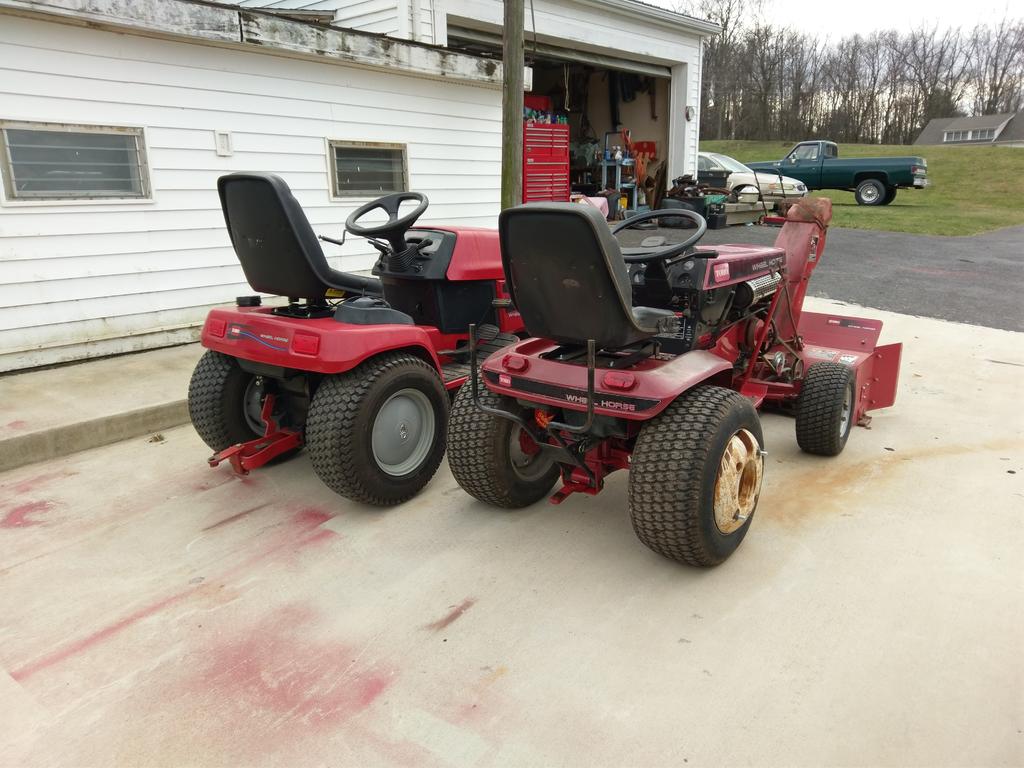

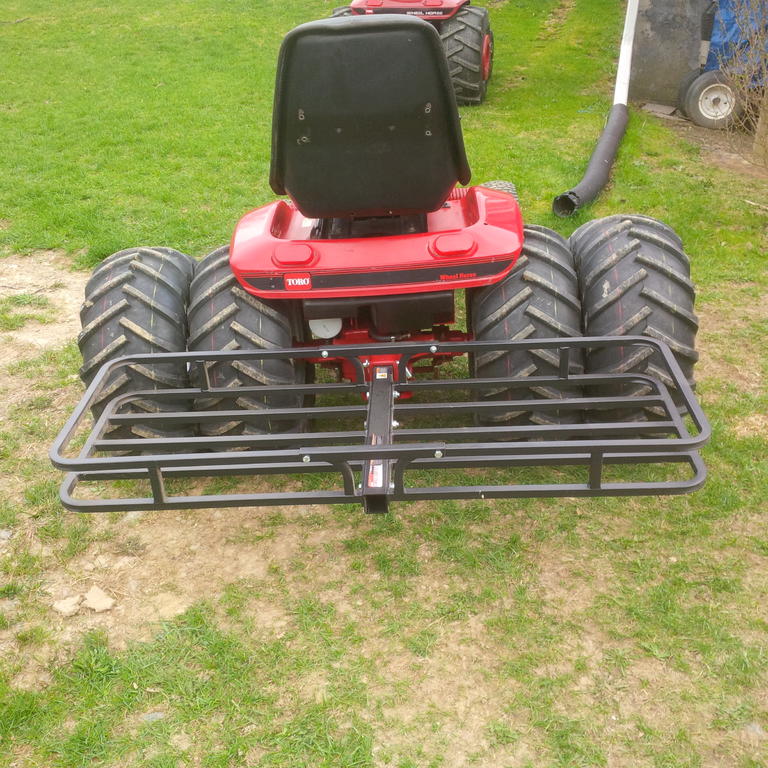

fast88pu 3,402 #7 Posted February 4, 2018 Space fenders up 1.5" and run 26x12x12. And a photo of the spacers 4 2 Share this post Link to post Share on other sites

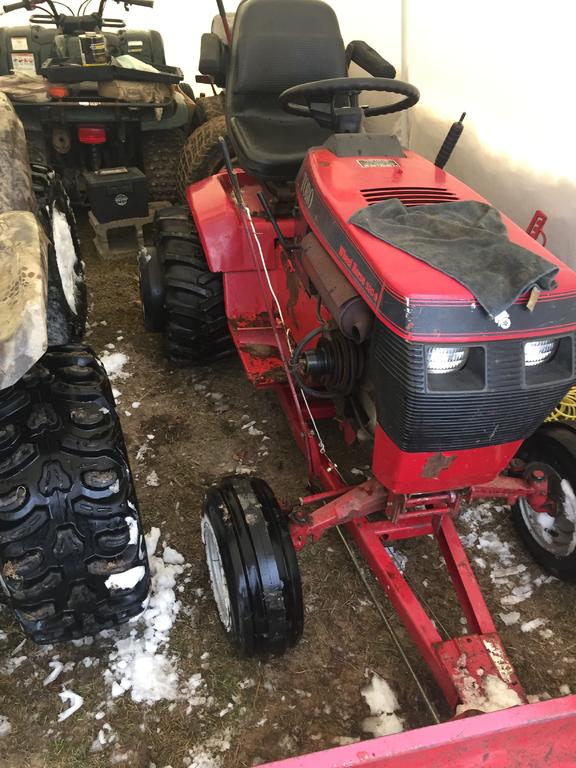

fast88pu 3,402 #10 Posted February 4, 2018 Use spindles from a 310 with 6" front wheels. But put the 8" combo on 3 Share this post Link to post Share on other sites
SteveK440 30 #11 Posted February 4, 2018 4 hours ago, 953 nut said: The fender pan could be spaced up a little higher and the running boards could be moved forward if needed. Good Idea on the floorboards! Have an issue in my mind and went to Parts tree website to confirm the two issues which are re-drilling floor support brackets and notching the drive belt cover and the cover on the other side. The seat pan would seem to be needed to move forward as well as raised but this is not an issue for my mods. So let me pick your brain on another Idea. What is the possibility of moving the Mower deck forward with some make shift brackets and smaller belt if my back tires are too close? Share this post Link to post Share on other sites
fast88pu 3,402 #12 Posted February 4, 2018 As long as no ice chains are not needed with loaded tires. 2 minutes ago, SteveK440 said: Good Idea on the floorboards! Have an issue in my mind and went to Parts tree website to confirm the two issues which are re-drilling floor support brackets and notching the drive belt cover and the cover on the other side. The seat pan would seem to be needed to move forward as well as raised but this is not an issue for my mods. So let me pick your brain on another Idea. What is the possibility of moving the Mower deck forward with some make shift brackets and smaller belt if my back tires are too close? 26x12x12 on 7" rims clear the 48"sd deck. But not a 42" sd or rd Share this post Link to post Share on other sites

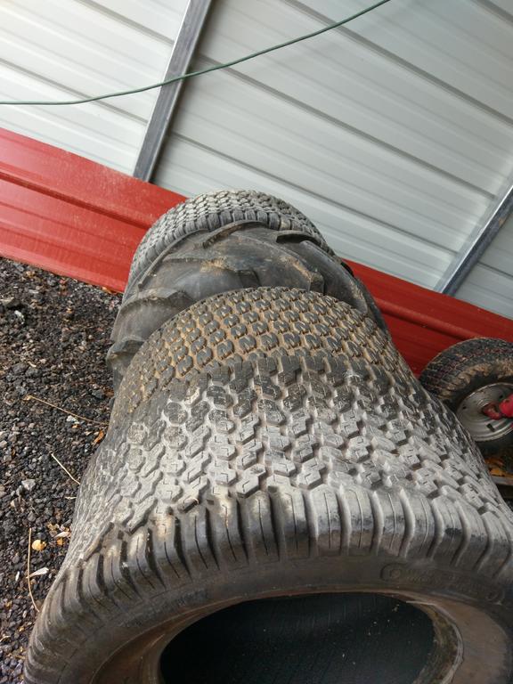

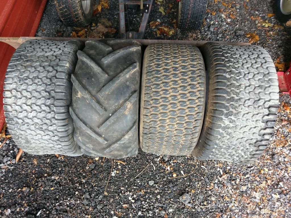

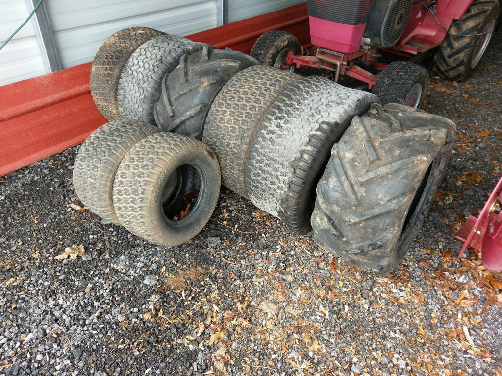

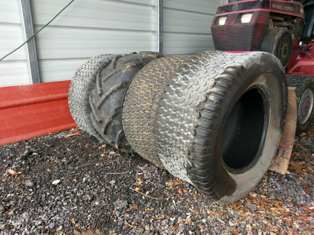

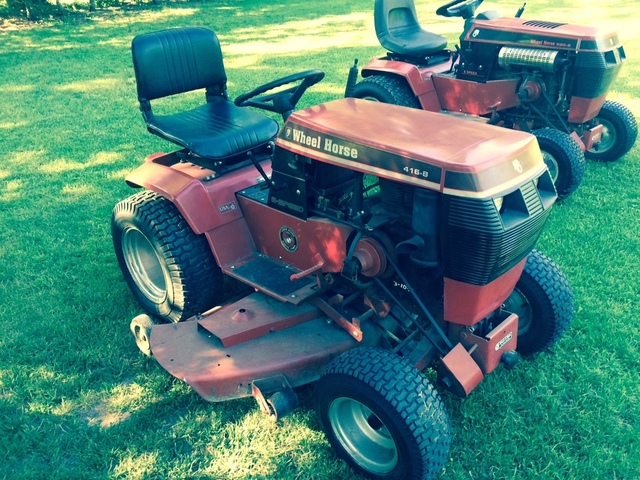

WVHillbilly520H 10,379 #13 Posted February 4, 2018 Here's 23x10.50-12 of various manufacturers on 520's (8.50" wheels)...brand , style (turf AG all trail), variations galore it's hard to say that 23x10.50 or 24x12 is all same size just by what's on the sidewall, turf tires seem to be the truest to size while AG are all over the size map just my personal experiences, Jeff. 1 Share this post Link to post Share on other sites
Sarge 3,473 #14 Posted February 4, 2018 I wish brands ran more true to size - especially in the ag patterns. I hate how my D sits butt-low now due to the tires being quite a lot shorter than the advertised height versus the Carlisle front ags - it's no a gasser from the 60's..lol. I prefer it level, or just slightly higher in the rear but not totally to the "jackrabbit" look. Do your research when you pick a size and the actual listed height as installed - some brands it's hard to find the specs on them but just be aware of it and their return policies. Mine were American Farmer, bought locally but once mounted you own them, period. Keep in mind too , running a wider tire can put more stress on the rear axle depending upon how you use it , so keep that in mind and don't abuse your new-found traction. Hubs, keyways and bearings all come into play. Front tire height can be the biggest problem in clearing implements and steering parts, so watch out for that if you want to keep it level. Most will handle a slightly taller front tire but rarely much wider than stock without causing other issues as well as accelerated steering parts wear - it all adds up. I do prefer a more "fat" look, but sometimes the old tried and true skinny and tall works wonders. It's by far the best option for my old Land Cruiser - it's a tank that doesn't stop. Sarge 2 Share this post Link to post Share on other sites
elcamino/wheelhorse 9,363 #15 Posted February 4, 2018 @WVHillbilly520H Looks like a used tire store. 1 Share this post Link to post Share on other sites
WVHillbilly520H 10,379 #16 Posted February 4, 2018 1 minute ago, elcamino/wheelhorse said: @WVHillbilly520H Looks like a used tire store. Yep, can't seem to let 'em go, might need a spare ... 1 Share this post Link to post Share on other sites

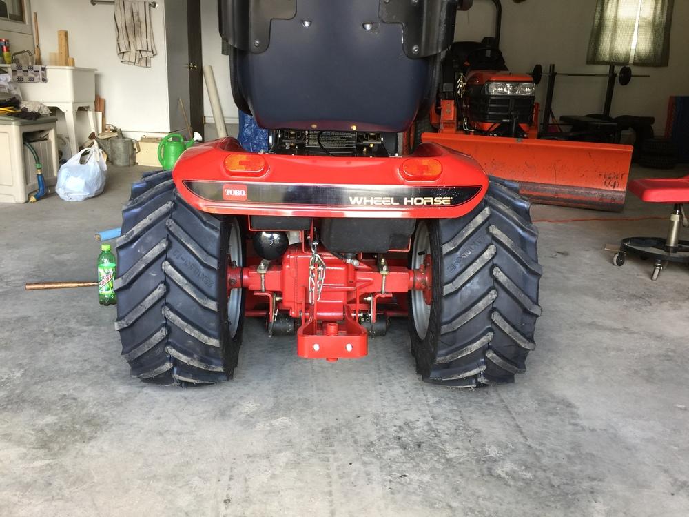

SteveK440 30 #17 Posted February 5, 2018 8 hours ago, WVHillbilly520H said: Here's 23x10.50-12 of various manufacturers on 520's (8.50" wheels)...brand , style (turf AG all trail), variations galore it's hard to say that 23x10.50 or 24x12 is all same size just by what's on the sidewall, turf tires seem to be the truest to size while AG are all over the size map just my personal experiences, Jeff. Jeff I like the eighth photo down with the rear shot of the tires and mower deck. What is the setup of name brand tire, plus the size and size of rim and what size mower deck? Share this post Link to post Share on other sites

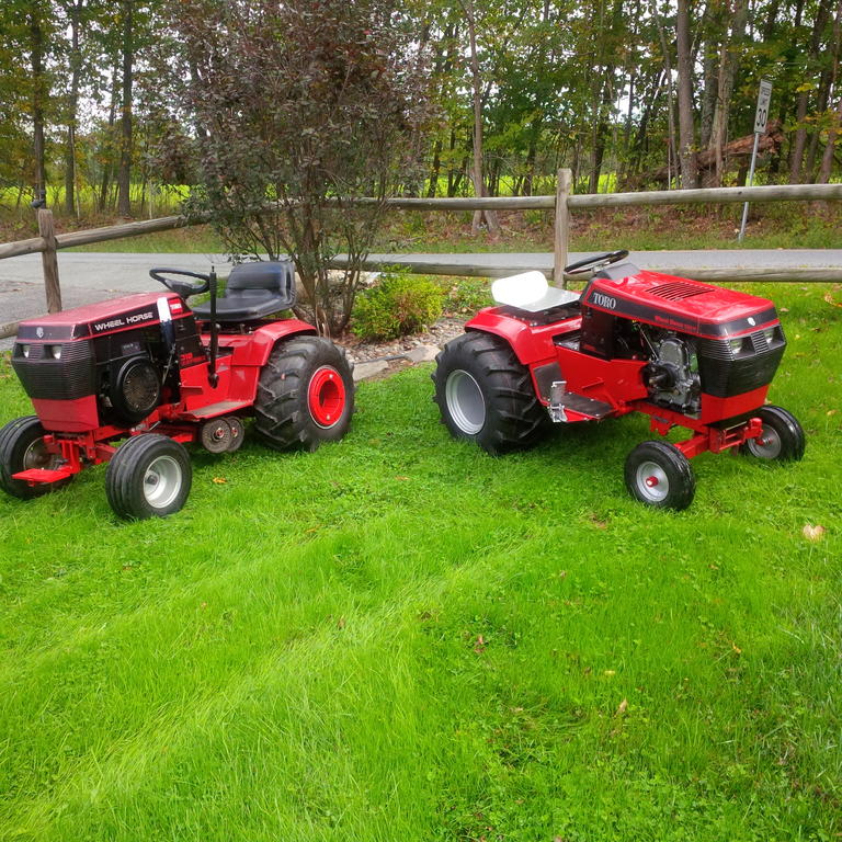

WVHillbilly520H 10,379 #18 Posted February 5, 2018 4 minutes ago, SteveK440 said: Jeff I like the eighth photo down with the rear shot of the tires and mower deck. What is the setup of name brand tire, plus the size and size of rim and what size mower deck? 520H 48" deck with Carlisle Tru-power 23x10.50-12 on the 8.5" wheel, not my tractor was another RS member on here a few years back, the 3rd pic down is mine with OTR Lawn Trac R1 same size tire/wheel on my 520H, check out my "new shoes" thread as they also come in 24x12-12, Jeff. Share this post Link to post Share on other sites

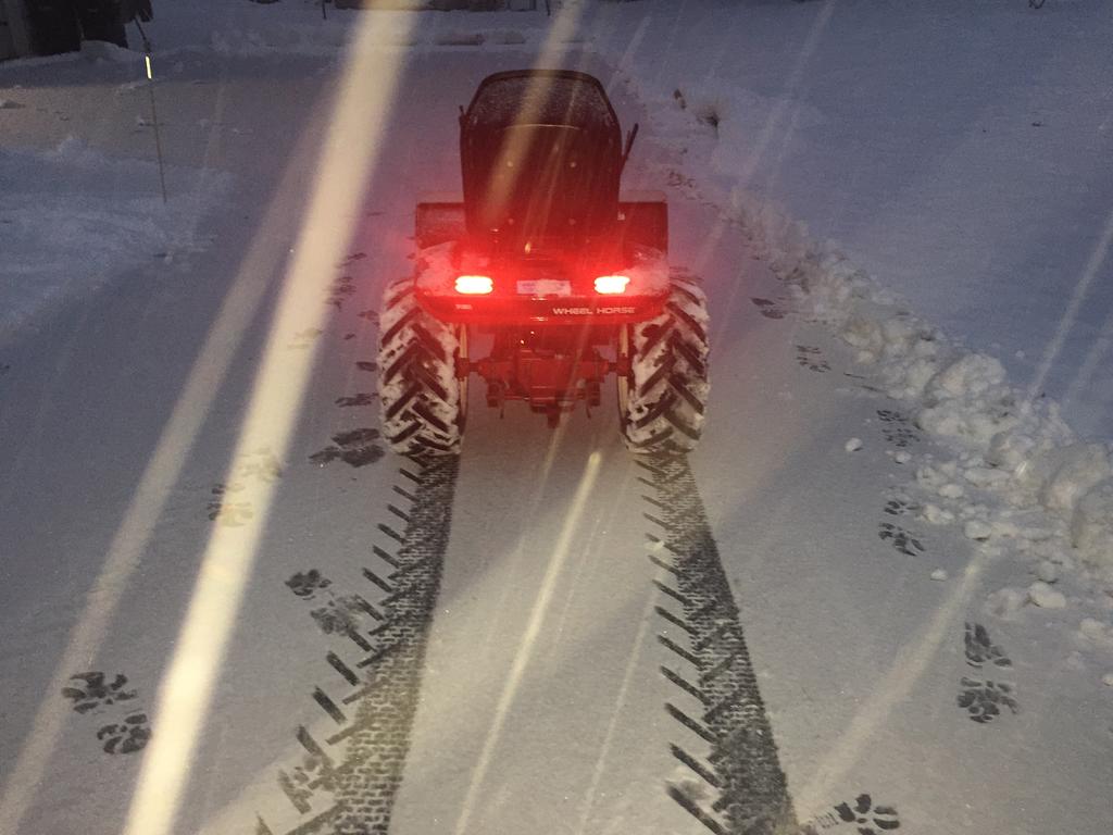

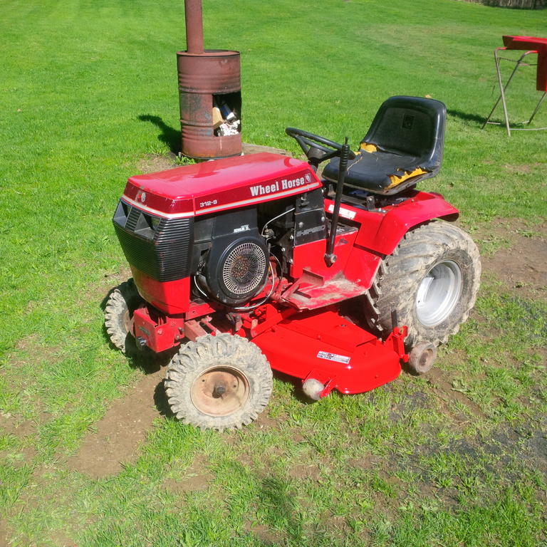

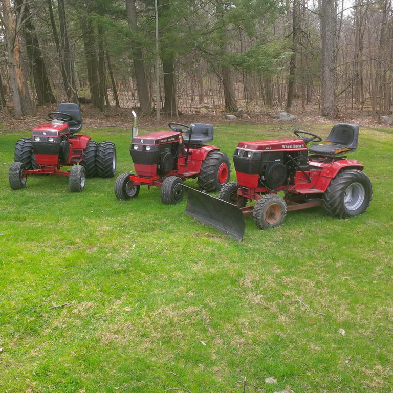

Red144runner 659 #19 Posted February 5, 2018 Here's my 3/12 on 23x10.50 ags on 8.50 wheels. They are more round than the Carlisle ags. Great traction in the dirt and snow. Haven't needed chains yet. But it's loaded pretty heavy 2 Share this post Link to post Share on other sites

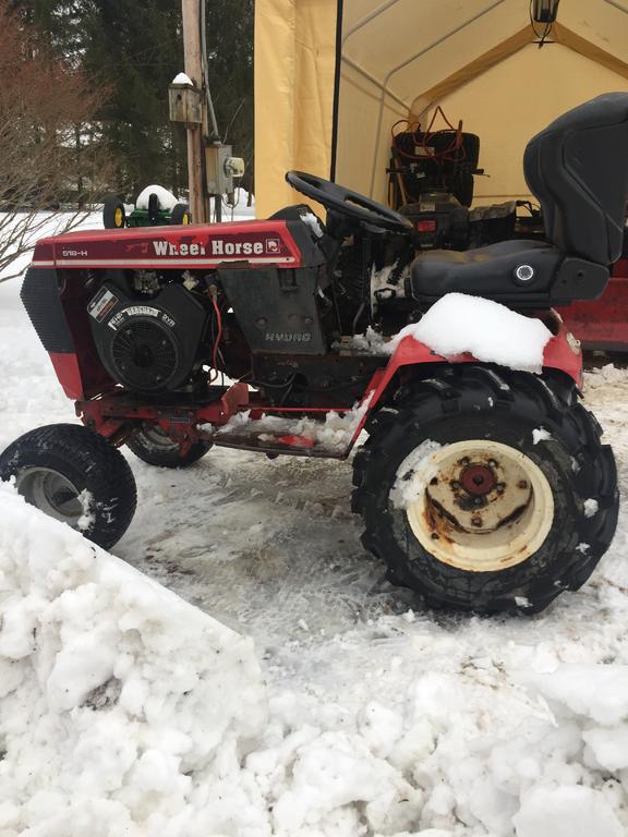

SteveK440 30 #20 Posted February 10, 2018 Not to come off sarcastic but thank you for photo bombing my topic and helpful advice on selecting tires. You guys have gave me a rough draft Idea on one page of what clearances I need to pay attention. My only question I can't picture is fast88pu. Does his tractor have 12" wide tires on a 8" wide wheel? Share this post Link to post Share on other sites
littleredrider 409 #21 Posted February 10, 2018 Dunno what pic ur talking about, but if its the last one, it looks like 8.5" wheels. I haven't seen a tire yet that measures what the sidewall says. Tractor, ATV, car or truck. I will get pics of the tires on the g/f's 518, they are a big tire, and tho sidewall says 12" wide, they aren't. Share this post Link to post Share on other sites
fast88pu 3,402 #22 Posted February 10, 2018 1 hour ago, SteveK440 said: Not to come off sarcastic but thank you for photo bombing my topic and helpful advice on selecting tires. You guys have gave me a rough draft Idea on one page of what clearances I need to pay attention. My only question I can't picture is fast88pu. Does his tractor have 12" wide tires on a 8" wide wheel? The one with the deck has 12x7 rims to clear deck wheels. The other has 12x10.5 on the puller. And the duals are 12x8 520 rims 1 Share this post Link to post Share on other sites

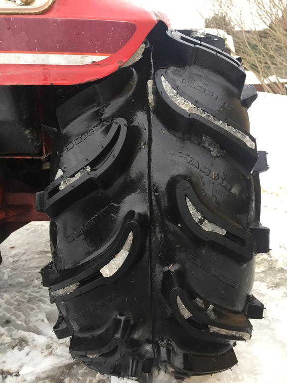

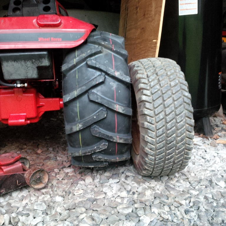

littleredrider 409 #23 Posted February 10, 2018 The tires on the 518 dig like crazy!! The lugs are 1 1/2” I think, and will dig till get hi centered. Drove thru yard with 6-7” or more of heavy wet snow, pushed it quite easily, but doesn’t wanna steer hardly at all. But they fit under the seat pan, and just had to move hubs out to clear brake band. Only cost $30 a piece. 2 Share this post Link to post Share on other sites
SteveK440 30 #24 Posted February 11, 2018 1 hour ago, littleredrider said: The tires on the 518 dig like crazy!! The lugs are 1 1/2” I think, and will dig till get hi centered. Drove thru yard with 6-7” or more of heavy wet snow, pushed it quite easily, but doesn’t wanna steer hardly at all. But they fit under the seat pan, and just had to move hubs out to clear brake band. Only cost $30 a piece. $30 a tire!? What brand and are they and are they a soft compound?They do look like swampland tires. You claim though they make hard to steer, would adding weight to the front help? I like the seat on your gfs tractor, thinking of adding one similar but retro my pan seat and moving the seat mount back two inches Share this post Link to post Share on other sites
littleredrider 409 #25 Posted February 11, 2018 They are Super Swamper Vampires. Same super swamper that makes truck tires. They are a soft compound, so need to keep road riding to a minimum lol. It has the turfs on the front, and weight would prolly help tremendously. Not sure what tires gonna put on it, maybe tri ribs, since this doesn't have steering assist. I'd like to put a loader on it, so the ribs would help.....seat is off a fork lift... Share this post Link to post Share on other sites
