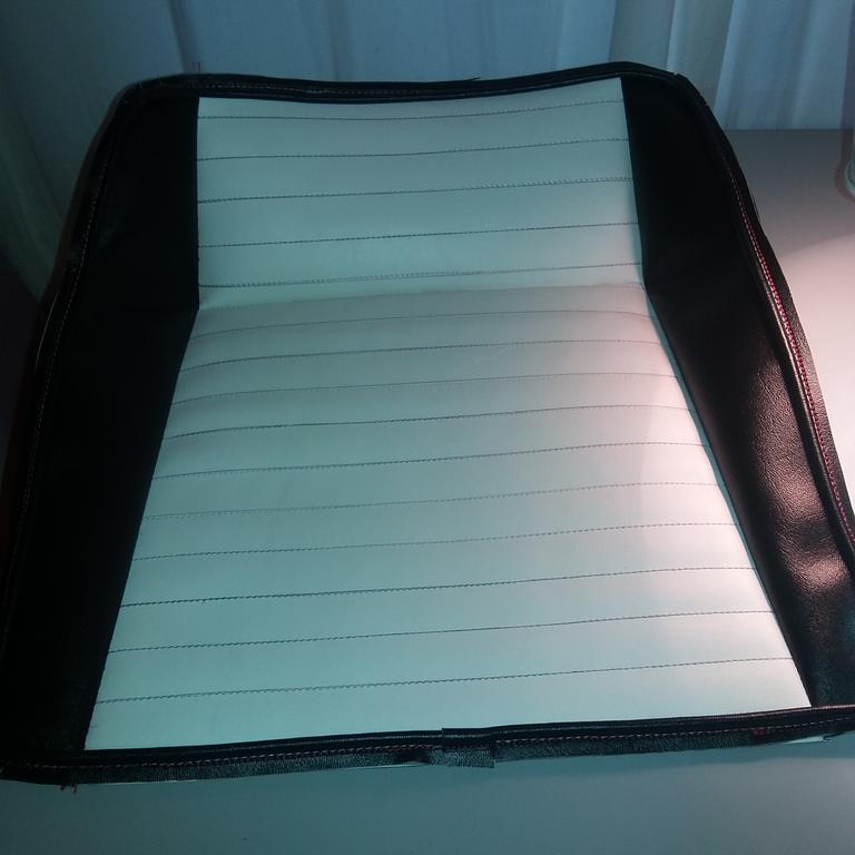

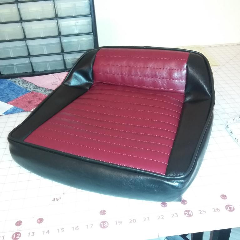

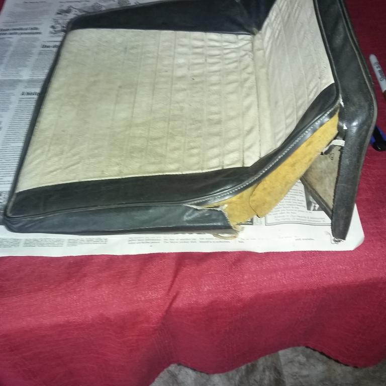

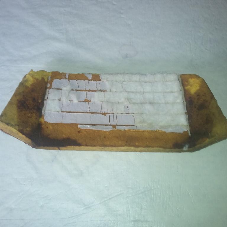

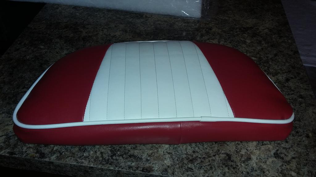

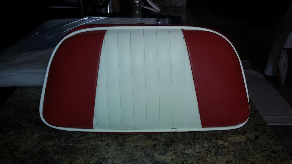

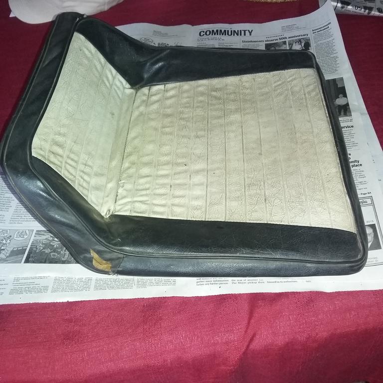

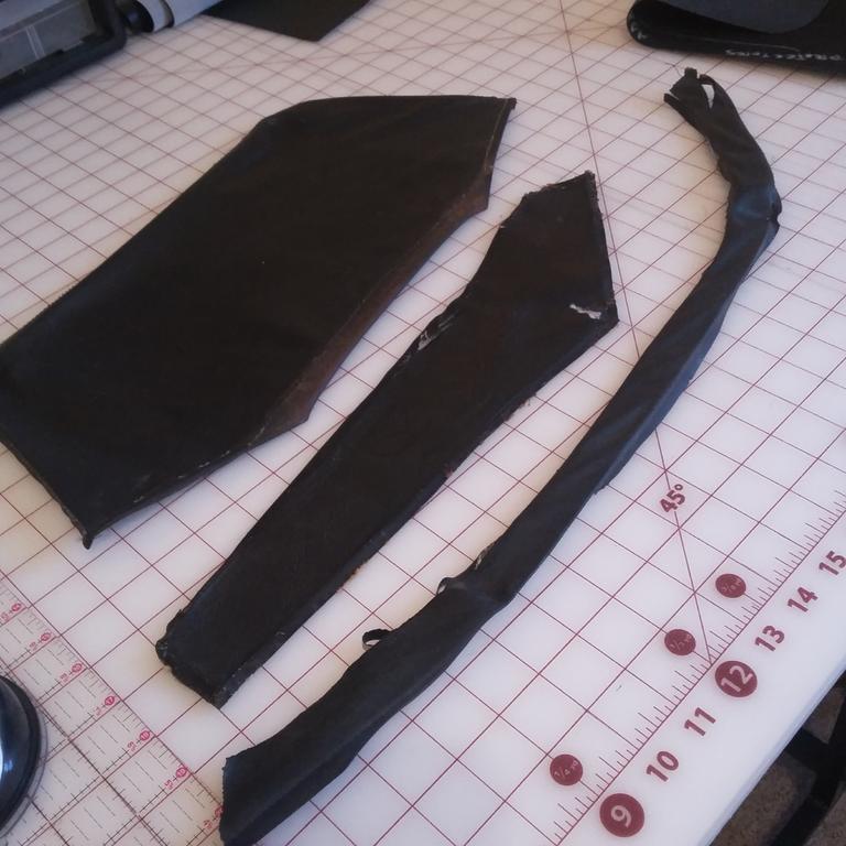

BOB ELLISON 2,981 #1 Posted February 3, 2018 (edited) Decisions , Decisions Well I started making my seat for the little Long Ranger and I haven't made up my mind yet. I think I like the red and black better then the white and black. I literally had to disassemble the old seat to take measurements of all the pieces that go into making a seat. I even had to buy a heavy Industrial sewing machine that would handle the fabric thickness. I've already made the seat for my 1054 and it really came out nice. The material is all UV anti fade and the thread is all UV poly thread. I'm trying to find the right density foam for the seats, not only is it hard to find but it's quite expensive. The pleats in the seat I've had to sew in 1 inch spacing but I'm looking into buying pressed pleats to make it look more natural. I'm in the experimental phase right now. Trying to see what I can do to make these old seats, But trying to make them look natural or original is impossible because the fabric is no longer available. The old seats where embossed pleated vinyl fabric. there is no foam in the lawn ranger seats yet. That's why there sort of flat. But they were made to last. The last pictures are my 1054 Edited February 3, 2018 by BOB ELLISON 3 12 Share this post Link to post Share on other sites
AMC RULES 37,250 #2 Posted February 3, 2018 Looks so good... I can tell you're going to get lot's of requests for them. 7 1 Share this post Link to post Share on other sites
The Gman 476 #3 Posted February 3, 2018 Now that's talent I must say :wow: 2 1 Share this post Link to post Share on other sites
953 nut 63,031 #4 Posted February 3, 2018 1 hour ago, AMC RULES said: you're going to get lot's of requests for them. You could stay busy for a few years filling the needs of all of us who own older with raggedy seats. 5 Share this post Link to post Share on other sites
rjg854 12,626 #5 Posted February 3, 2018 Really fine work, looks wonderful I'm partial to the red and black myself. 7 2 Share this post Link to post Share on other sites
elcamino/wheelhorse 9,362 #6 Posted February 3, 2018 I like the red and black it shows better. Now we know you can handle new seat covers but do you wash windows? 3 4 Share this post Link to post Share on other sites

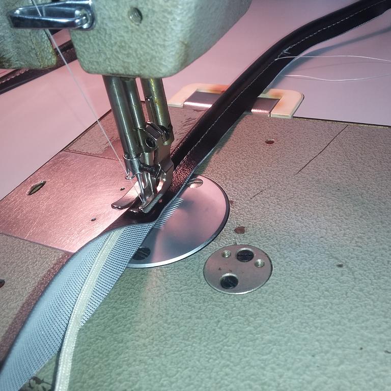

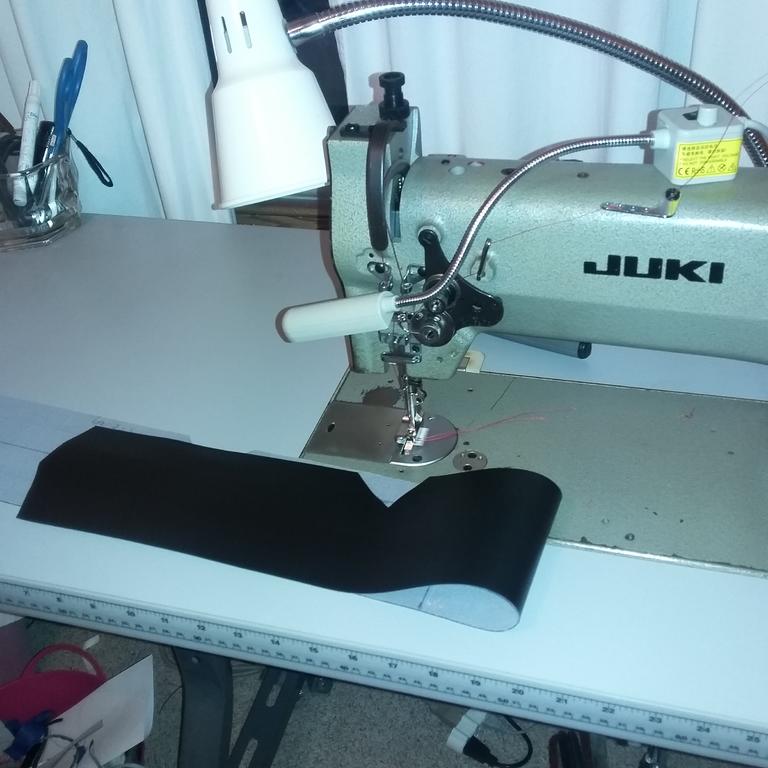

BOB ELLISON 2,981 #13 Posted February 4, 2018 @Sarge it a JUKI dnu_241h it has a 5/8 lift and a servo motor that I got for my consew .I can make it sew so slow or run like lighting. That's what you got to have to sew tight curves. It will go through 1/2 inch leather. I got a great deal for this one. This one sells for $950.00 but I got half that in it. 1 Share this post Link to post Share on other sites

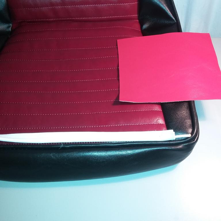

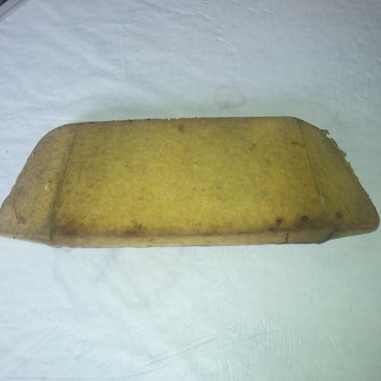

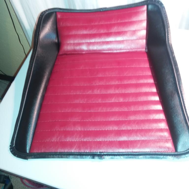

BOB ELLISON 2,981 #14 Posted February 4, 2018 (edited) Well I got my second one finished and it is much better than the first one. It's a lot tighter I had to make some adjustments on my masters. I think I'll try some with black seat instead of white and darker red sides and red back Panels. Maybe some black piping. I did put the old seat foam in just to see if I was close to the original size and it looks like a good fit. I'll still replace with new foam before I put it on the lawn ranger. Last picture I'm trying to see if white or brighter red works. Edited February 4, 2018 by BOB ELLISON 4 1 Share this post Link to post Share on other sites
Sarge 3,470 #15 Posted February 5, 2018 That's great - I hate trying to do piping but your's is spot on, nice. I did put a different motor on the Singer - it's way too fast but I needed more torque to punch the heavier stuff. Max capacity is around 3/8" or so , depends on density of the material. Bad part of the old Model 66 machines is bobbins - unless you get correct period built ones they don't work correctly due to a dome shape in them, all the newer ones are flatter and they don't run smoothly. Have you tested a cover over the top of the metal frame yet? Sarge Share this post Link to post Share on other sites
BOB ELLISON 2,981 #16 Posted February 5, 2018 1 hour ago, Sarge said: That's great - I hate trying to do piping but your's is spot on, nice. I did put a different motor on the Singer - it's way too fast but I needed more torque to punch the heavier stuff. Max capacity is around 3/8" or so , depends on density of the material. Bad part of the old Model 66 machines is bobbins - unless you get correct period built ones they don't work correctly due to a dome shape in them, all the newer ones are flatter and they don't run smoothly. Have you tested a cover over the top of the metal frame yet? Sarge Sarge I had to buy a set of piping feet for it. I did buy piping for the 1054 seat but that gets to expensive. I thought of buying a Singer 66 from a guy here in town but held out for a walking foor. I did the 1054 seat with my consew industrial cn2230. It had no problem with heavy vinyl but not a high enough lift. I was maxed out with piping and 3 layers of fabric. And the bobbins in my Juki are the oversized ones. I love the servo motor it has all the tourque I need at slow speed. 350 -3000 stitches per minute. I'm thinking of making another 1054 seat to perfect that one also. It's all about making a good set of masters to cut the fabric the correct size for sewing. I didn't think of a cover for the frame . My old cover had corner pieces sewn in for protecting cover from frame. But a cover would make it slippery I think. My lawn ranger did have a white cover on the seat and that's why it looked somewhat better then most. 1 1 Share this post Link to post Share on other sites

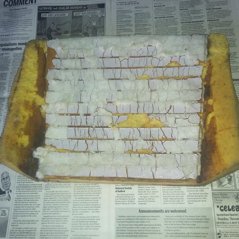

Sarge 3,470 #17 Posted February 6, 2018 There really is no substitute for a walking foot machine for this type of work, it's just the cost of them is prohibitive for most folks. The old model 66 is a rugged and very heavy cast machine - they weigh almost 50lbs with the motor. The new servo types are so cool in how they can put out the torque at such low stitch speeds - sort of like a well-tuned Kohler engine, lol. It's so tough to find good examples to make patterns off any old object with a vinyl cover - the stuff became so brittle and shrunken over time. If it spent much time in the sun it was never really protected from UV rays. I was always surprised by the cost of piping - they treat that stuff like gold for whatever reason - ouch. If you can get those patterns perfected I'm sure you could easily start selling covers - anyone that has done them in the past doesn't seem to stay in it for long, probably due to the cost of investment and so much labor time for the return, not a lot of profit in it when you try to stay at a reasonable price point. Folks that have paid an upholstery shop to make a new cover have had some sticker shock, but if you add up their time it makes sense, this stuff is not as easy as it looks. From your pics , you've got the right eye for keeping the lines straight and true - you would have no issues selling these - is that the plan or just for personal machines ? Sarge 1 Share this post Link to post Share on other sites

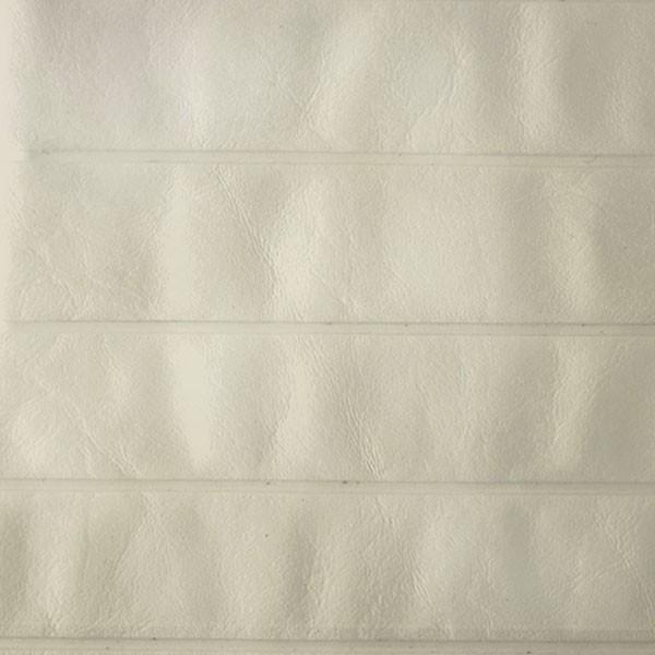

ACman 7,675 #18 Posted February 6, 2018 I’m sure you’ve done your homework trying to find upholstery but just in case I came across this place http://www.1800boattops.com/marinevinyl . The black 1” spaced pressed pleated vinyl looks like a good match to my all black original 1057 seat material . They say they offer white too but what it looks like ? As sarge puts it these seat covers look to be a labor of love to make . If you do decide to make a few to sell I’d definitely interested in a few . Would it help you out anyway if a person could supply you with the materials (with your pre-approval of course) and extra so your basically just out labor ? As far as foam have you considered stacking carpet foam as @Achto has done . You probably could come up with some free stuff if you could hookup with a carpet installer doing new subdivisions (it’s crazy what goes into the dumpsters at these job sites) . I’m just thinking out loud here . 2 Share this post Link to post Share on other sites
Sarge 3,470 #19 Posted February 6, 2018 Hmmm - you might have something here. The originals were 1" apart, 1/8" wide embossings - that looks really close although the padded pleats would make it look pretty different. I wonder, might want to contact them and see if they can offer it with no padding on the back, just the flat material ? I'd imagine the pleating pad is bonded to the vinyl - it would be nearly impossible to remove and probably affect spacing as well. I'm dead certain in years past I remember that pattern being used on other things such as cars/trucks in the auto world and my local upholstery guy remembered it immediately when I showed him an original cover from a 1277. But, as we all know too well - it's long gone and he said he's searched for it in his suppliers, no luck and he's never been able to duplicate it . Hope you don't mind - I did fill out a contact form at 800boattops and included links to your pic of the original, we'll see what they say...? Not sure if they'll call or email me... Sarge 1 Share this post Link to post Share on other sites

Sarge 3,470 #22 Posted February 7, 2018 I had found some makers that have embossed patterned marine grade vinyl - but none sell small cuts and want you to buy full rolls that are around 300' long and weigh as much as a Horse. Some will even do the pattern you want or duplicate an old pattern that is NLA - it's just a cost thing. If I ever hit the lottery the material would be available, as many other things as well - I love these old machines that much. I think the original color was not quite a dead white - maybe an antique or maybe even a linen color like the wheels. I have some of the old original brochures for some of these tractors and the one from '67 for those models shows a fairly white seat - but I agree that bright white is too much and finding something a bit softer would probably help make it look correct. Btw - I'm not knocking the heated pleat material - it's pretty cool and honestly it's probably as close as we'll ever get. Perhaps with a more stout padding density under it that may remove some of the pucker from the stuff and make it look more like the original - maybe ? One thing I haven't seen of that material type is how the back side is made....??? i believe heat pleating is made with various layers or something ? I have the same issue with the old Singer - the model 66 will easily punch well over 1/2" of whatever is under the foot if the needle can stand it . But, not being a walking foot you start having too many issues with the material in the feeder feet, bunching it up or constantly changing the tension on it trying to compensate. I almost spent the coin on a newer but used Sailright machine - it went out of sight on the auction site and I got out before things got stupid - almost went for the price of a new and better improved model, wow. Buying all the material and required heavy gauge upholstery thread gets expensive really fast - I've got a lot invested just in the canvas and ballistic nylon work I've done for myself but it passes the time in the winter when it's too cold to work outside or when I'm in the off season with work. My other favorite machine is a 60's Singer Rocketeer 500A slant-needle machine. That thing is so smooth but it's only built for maybe 5 layers of jean material due to the needle design on it - but it is a very nice machine to work with. For their age, both Singers almost look new - almost feels wrong to put them to work. You're doing an amazing job - look forward to what you get with more practice, you're way ahead of me in getting them right, lol. Sarge 2 Share this post Link to post Share on other sites
ACman 7,675 #23 Posted February 7, 2018 19 hours ago, BOB ELLISON said: ACman I've already been to that same Web site. And I'll email them to see if they carry 1in heated pleats. But I must have marine grade uv ,sun resistance fabric. I'm not going cheap stuff for seats. As of now all my material I order is from Sailrite because of there Quility even thought it's a little more expensive. But they only have 1 1/2in pleated white. So I'm looking over the Web for 1in black and off white marine grade. I'll keep posting as I make progress. I hope they get back with you as it is listed under marinevinyl and isn’t Corvette a brand of boat too ? Do keep us posted on your progress as your work is not going unnoticed ! 1 Share this post Link to post Share on other sites
BOB ELLISON 2,981 #24 Posted February 8, 2018 Well @ACmanand @Sarge I did get an answer from one vinder and this is there reply. Hello, i have 1 inch in black and white, and i have 1 1/2 inch in off white. Black and white 1 inch will cost $30.00 per yard it is 32oz vinyl heat sealed double backed rolling pleat with a Dacron filling. Extremely durable and versatile marine/automotive grade vinyl. If you have any other questions let me know, we ship out same day! -Bristol Upholstery I have another vinder that has a off white pleated but it's 1.5inch pleat. So finding the correct material is a problem. I'll keep looking but it's not easy finding correct fabric or color and style. 2 Share this post Link to post Share on other sites
