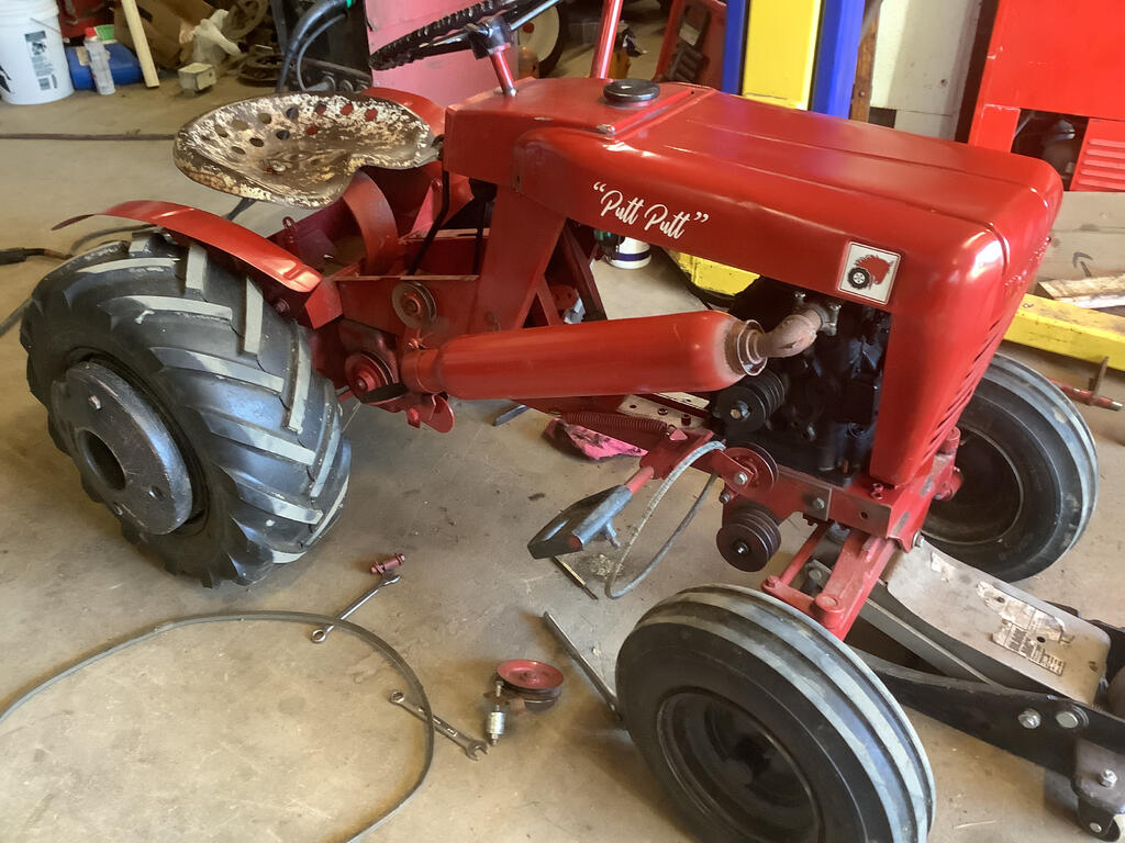

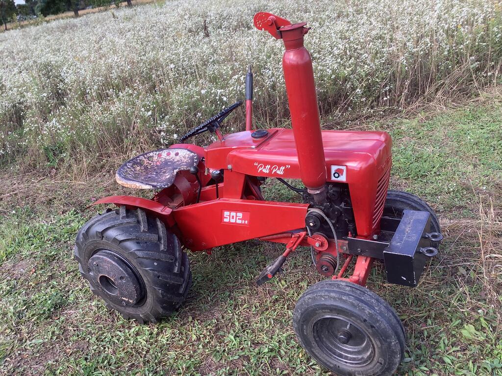

Pullstart 71,233 #128 Posted September 29, 2022 I did a little tear down. The exhaust needed to be tightened another turn. When I built this, I never ran many heat cycles before hitting the road for my 2018 Big Show. So, the engine needed to come loose to run another turn into the head. I lightened up the counterweight on the tink tink flapper. Got a little creative with the drill bits. I kind of see it… 1 1 1 Share this post Link to post Share on other sites

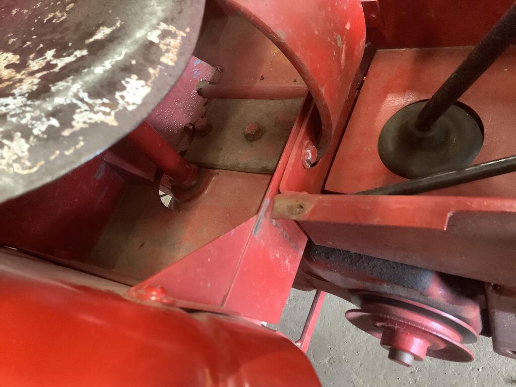

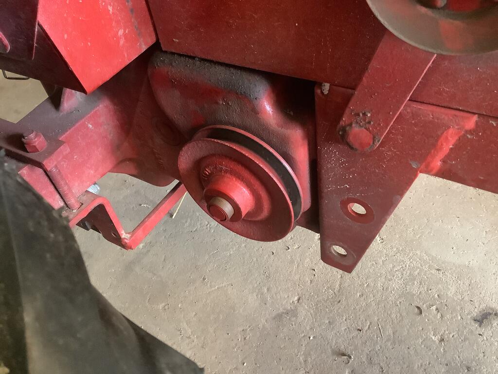

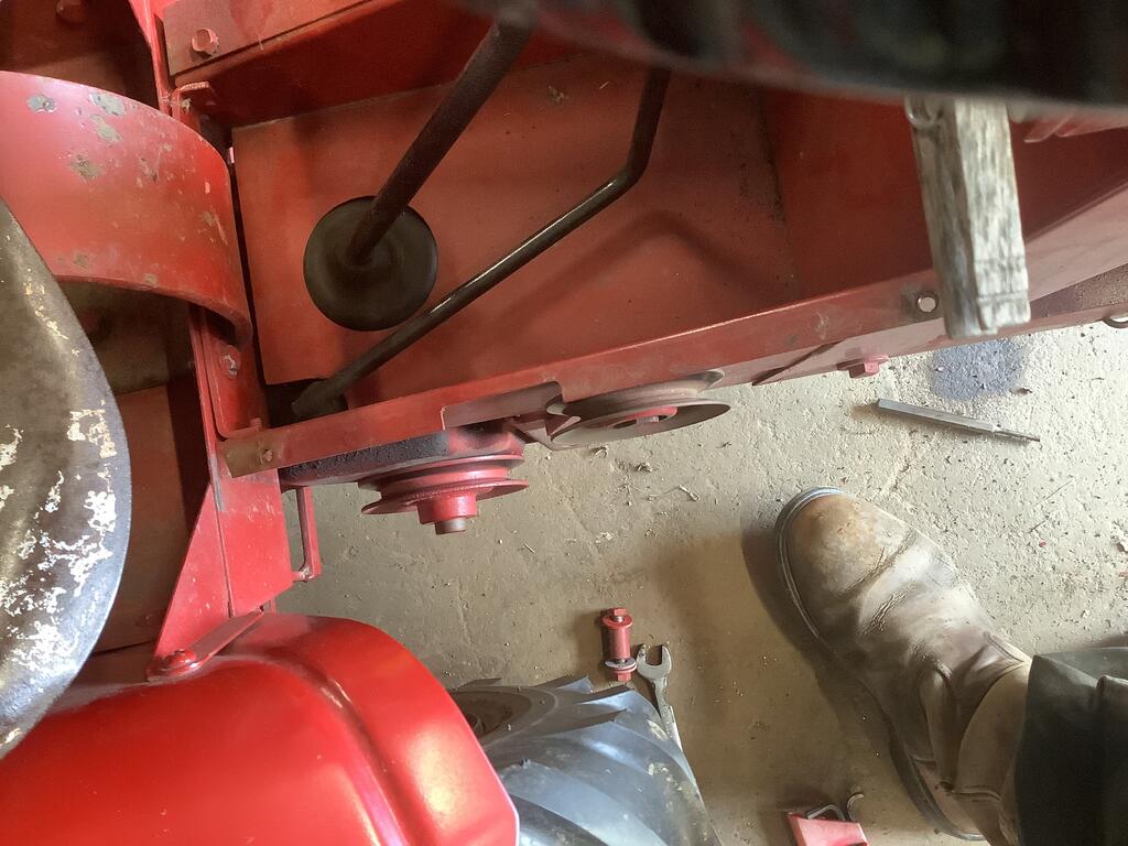

Pullstart 71,233 #131 Posted September 29, 2022 I figured I should snap some pictures of my 8 speed swap details. I used a 5/8”x3/4” pulley sleeve to run the stock pulley from the 3 speed. 2 Share this post Link to post Share on other sites

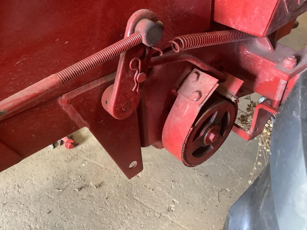

Pullstart 71,233 #132 Posted September 29, 2022 And the brake side. I believe I bent the brake rod to fit. This was a C-101 8 speed transmission. I am not sure what 502 and what C-101 parts I used any more. Note. There is no parking brake lever still. 2 Share this post Link to post Share on other sites

Pullstart 71,233 #138 Posted September 30, 2022 (edited) 17 hours ago, ebinmaine said: This is just wicked cute... like that? I wanted to lighten up the back weight and was thinking of different patterns. I tossed some masking tape on and rudely ( not crudely @ebinmaine) sketched the horse head and started drilling Edited September 30, 2022 by Pullstart Auto correct at it’s finest 1 Share this post Link to post Share on other sites
