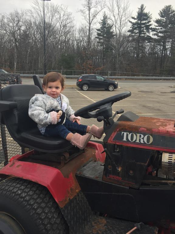

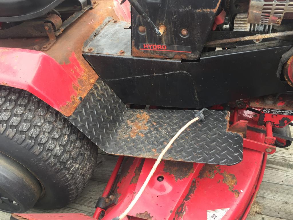

Red144runner 659 #6 Posted January 28, 2018 She's a rustyyy girl. Why people spend thousands on a great tractor and leave it outside I'll never know. Luckily it runs beautiful. All gauges work except tach. 25" of vaccum at idle? I think that's good. No smoke fires, right up cold. Hydro seems good, moves quick no hesitation drove it up trailer ramp at idle. Lift works nice and fast. But the tins are bad. At this point I need a donor tractor. It's not worth the time sanding and filling. And I'm not against the "patina" look but that won't work with the stuff 1979 and on for me. So it will be stored till I round up parts and time to do it right. 6 3 Share this post Link to post Share on other sites

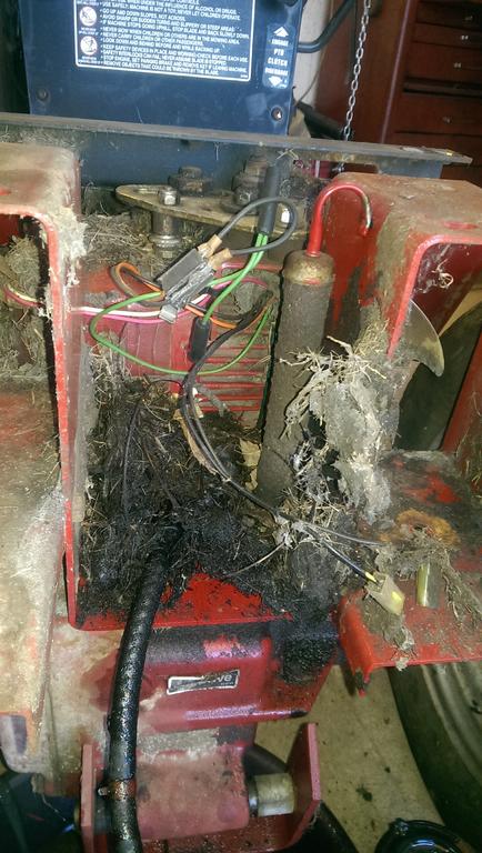

953 nut 70,343 #10 Posted January 28, 2018 2 hours ago, Red144runner said: spend thousands on a great tractor and leave it outside I'll never know. Hard to imagine that perfect hubcap was on the rusted tractor. 1 hour ago, BOB ELLISON said: f it's been outside it might have mouse nest in and around the engine. Remove the rear fenders and clean the grass clippings from the transaxle too. 2 Share this post Link to post Share on other sites
WVHillbilly520H 10,379 #11 Posted January 28, 2018 7 minutes ago, 953 nut said: Hard to imagine that perfect hubcap was on the rusted tractor. Remove the rear fenders and clean the grass clippings from the transaxle too. Yeah it could look like this... 1 Share this post Link to post Share on other sites

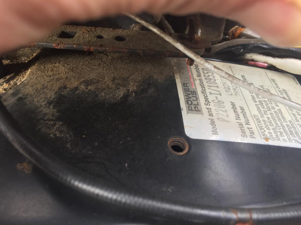

onanparts.com 185 #22 Posted January 31, 2018 Nice score on the 520-H! Here is the Onan factory production order for it. 3 Share this post Link to post Share on other sites
Red144runner 659 #23 Posted February 1, 2018 3 hours ago, onanparts.com said: Nice score on the 520-H! Here is the Onan factory production order for it. That's awesome! Thank you that also confirms what I suspected, that is a '94 1 Share this post Link to post Share on other sites
onanparts.com 185 #24 Posted February 1, 2018 7 minutes ago, Red144runner said: That's awesome! Thank you that also confirms what I suspected, that is a '94 You're welcome! The production orders were reissued over and over. Hey Onan! Wheelhorse calling, We need another 500 of the P220G with spec of 10955D. Thanks, WH. Your Onan engine was made Dec 1992. First digits in the serial, L92. Letter is the month. A=Jan, B=Feb etc. 2 Share this post Link to post Share on other sites

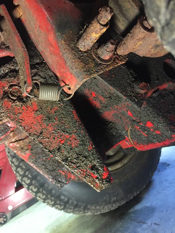

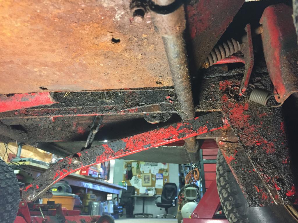

Red144runner 659 #25 Posted February 2, 2018 Well boys I couldn't help myself and I took it to work today. After we salted the campus I had some time. First I took the 48" deck off. Aside from surface rust the deck is solid. The bearings and tight and super smooth. Next I looked under neath. Real grimy but not obvious leaks. Frame lols good and solid. Finally I did a compression test. I did the rear jug first and removed the battery. Maybr you don't need to for plug access but it made it easier. While it was out I got a good look at the wire harness all looks good. There is one random switch but I suspect it's for the lights, yet to confirm. I jumped the battery to the leads, didn't turn over as fast as I'd like but the result was good, 120psi. The front was easy and I put the battery back, it spun much faster and showed around 125psi. I'd say they both are. So the engine is nice and tight, the 422 hrs now seems likely. 3 1 Share this post Link to post Share on other sites
