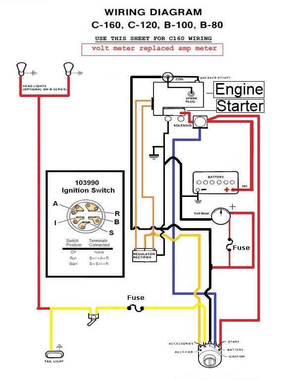

ebinmaine 78,376 #151 Posted March 14, 2018 51 minutes ago, oldredrider said: Fuses should be rated by wire size. Google is your friend. 1 minute ago, BOB ELLISON said: @ebinmaine @oldredrider is right. wire size does determine fuse size. So if you wired your tractor with 14 gage use the 15amp fuse. 16 gage 7.5amp 14 gage wire needs 15amp 12 gage needs 20amp Thank you gentlemen! I saved this little chart to my email so as to put it in the tractor info file. 2 Share this post Link to post Share on other sites

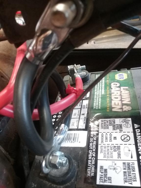

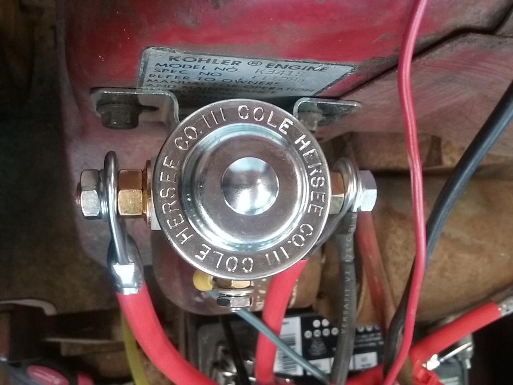

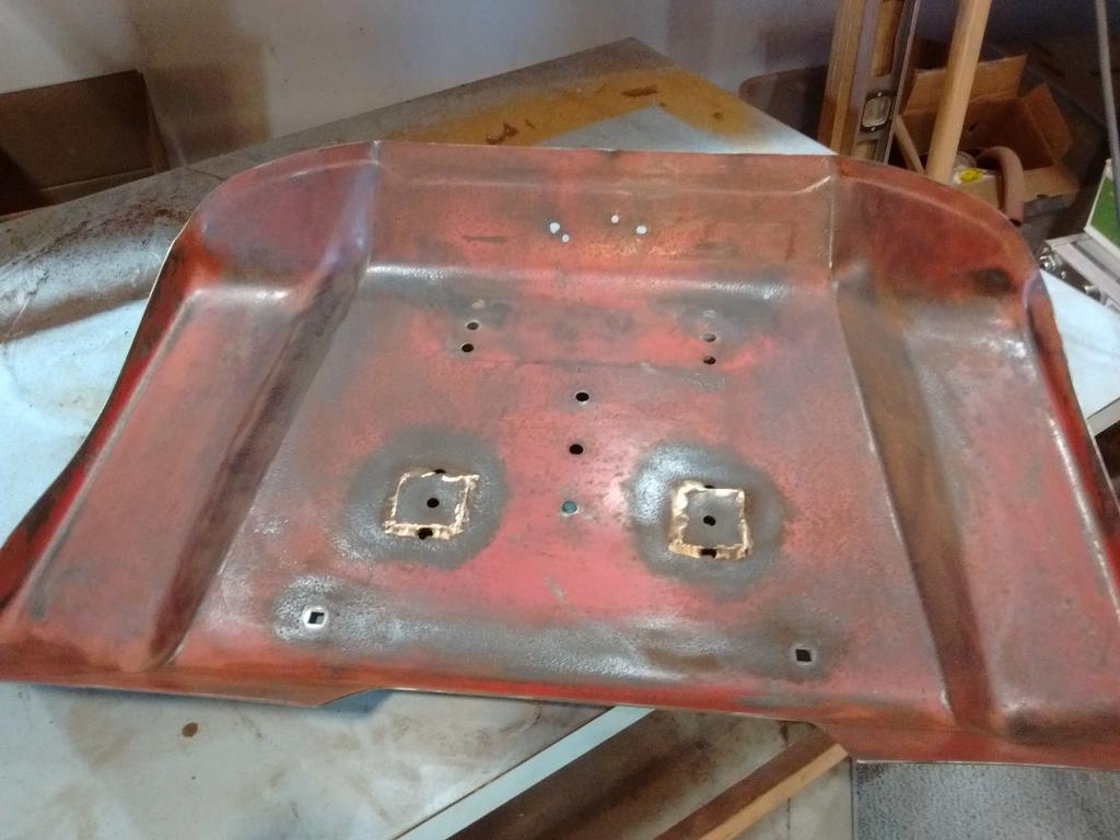

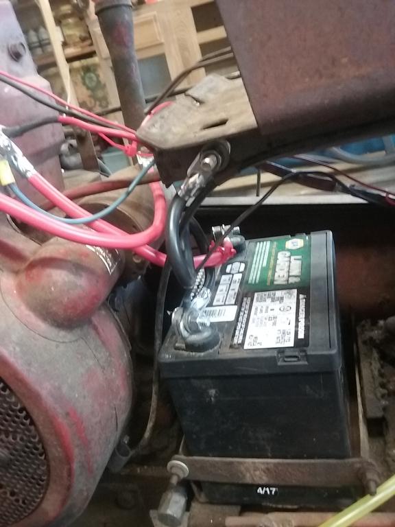

ebinmaine 78,376 #155 Posted March 18, 2018 Well buoys and gulls... We've got some top shelf Show-n-tell for ya today !! I write "we" because my amazing honey helped out A LOT today!!! Have I mentioned how awesome she is ?!? Worked on the wiring a bit more. Hoping that's done for now. The other day I was fiddlin' with the ground cable and the upper end came unpastedized. Not a huge shock (see what I did there...) considering it was a badly done home-made piece. Sooo... 3 new battery cables went in... The double zip-tie between + & - is to keep them from moving and also keeps a piece of plastic between them. Scored a name brand solenoid for about 25 bucks Right front tire had a gash big enough to throw a cat through so I changed that out today. Super cool part was I had an original front wheel from the B80 on hand that had the same tire. Spindle has a fair amount of wear just like every other thing on this rig. You can see here that I drained the ummm... stuff... out of the rear axle/transmission. I did refill with about 1- 1/2 quarts of diesel and spun by hand a bit in each gear and drained it again. Same color but much thinner like diesel shoulda been. I'll likely repeat this a couple more times.... minimum. Other concerns there though. One hub is floppy loose and the other you can see in the next pic has been beaten by a PO. so ya' know that ain't comin' off easy. And... the wheel with the tight hub won't come off. Sprayed Penetrating oil all over the place and closed the shop up. I'm thinkin' I'm gonna need to split the trans soon and replace the wheel bearings. The contents of the following are self descriptive as each before and after. ALL done by my honey... And... She worked on the seat cover some more too !! Cut the whole seat piece. Then cut it in the middle and spray glued it. Then trimmed around the edges to shape it. 2 8 Share this post Link to post Share on other sites
ebinmaine 78,376 #156 Posted March 18, 2018 On 3/13/2018 at 3:51 PM, BOB ELLISON said: @ebinmaine your not going to use a fuse ???? You need a fuse for the lights and the voltage gage. That's why I use the A terminal on the switch that's for accessories. A fuse or 2 never hurts and it will help stop cooked wires. My honey showed me how to add stuff to "paint" files. How's this? 1 2 Share this post Link to post Share on other sites

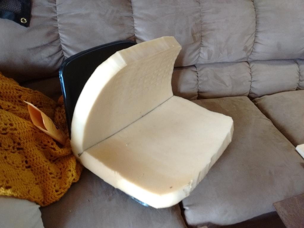

cpete1 332 #166 Posted March 19, 2018 "Shaping Foam for seat" Electric carving knife works good too, (Notice picture of custom truck I built long time ago) (Especially the knife your family would use for Thanksgiving carving) I went 3 years without telling anybody. I'd just sit and think about it when we were having turkey... until I finally dropped the knife once into gear oil by mistake, then I had to come clean...still have the knife... Your honey is AWESOME..... Thanks for the electric schematic also. Progress is looking great, That much snow looks scary... Keep posting Eric!! Chris 1 4 Share this post Link to post Share on other sites
ebinmaine 78,376 #167 Posted March 19, 2018 11 minutes ago, cpete1 said: "Shaping Foam for seat" Electric carving knife works good too, (Notice picture of custom truck I built long time ago) (Especially the knife your family would use for Thanksgiving carving) I went 3 years without telling anybody. I'd just sit and think about it when we were having turkey... until I finally dropped the knife once into gear oil by mistake, then I had to come clean...still have the knife... Your honey is AWESOME..... Thanks for the electric schematic also. Progress is looking great, That much snow looks scary... Keep posting Eric!! Chris Electric carving knife is exactly what she used! I'll show her the video later and maybe she'll try out the method shown. I don't think I'd get too worried about the gear oil in the turkey. All natural petroleum distillate products are probably better than some of the interesting stuff that is in much of our food anyways. Just tell them it is your method of "distribution and division and incision tool" maintenance. Thanks! 2 Share this post Link to post Share on other sites

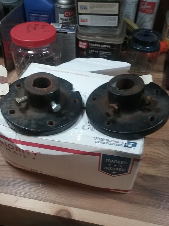

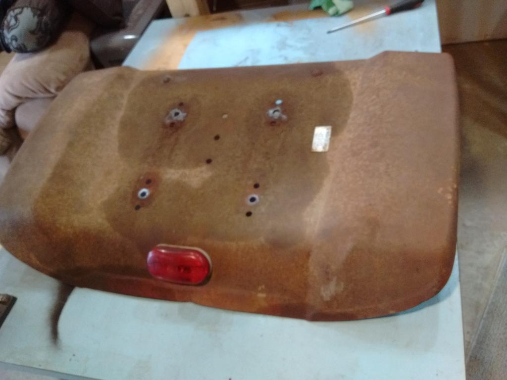

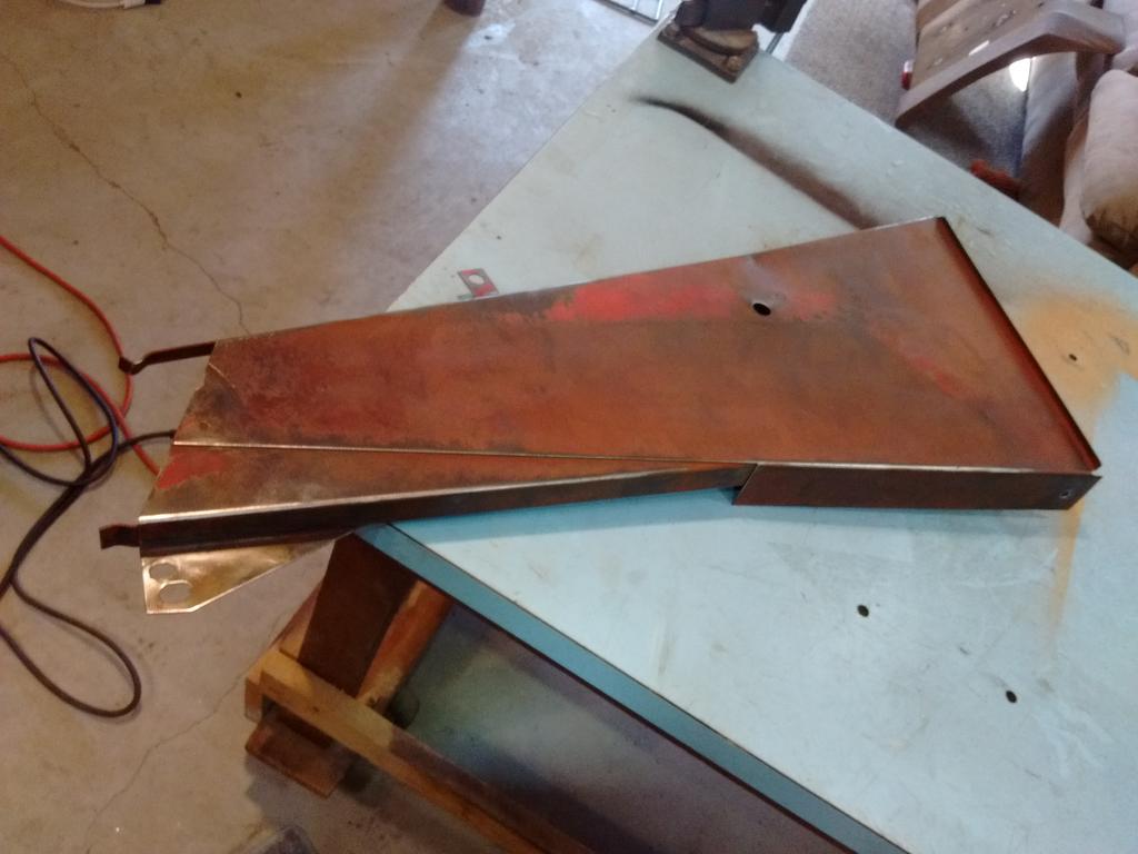

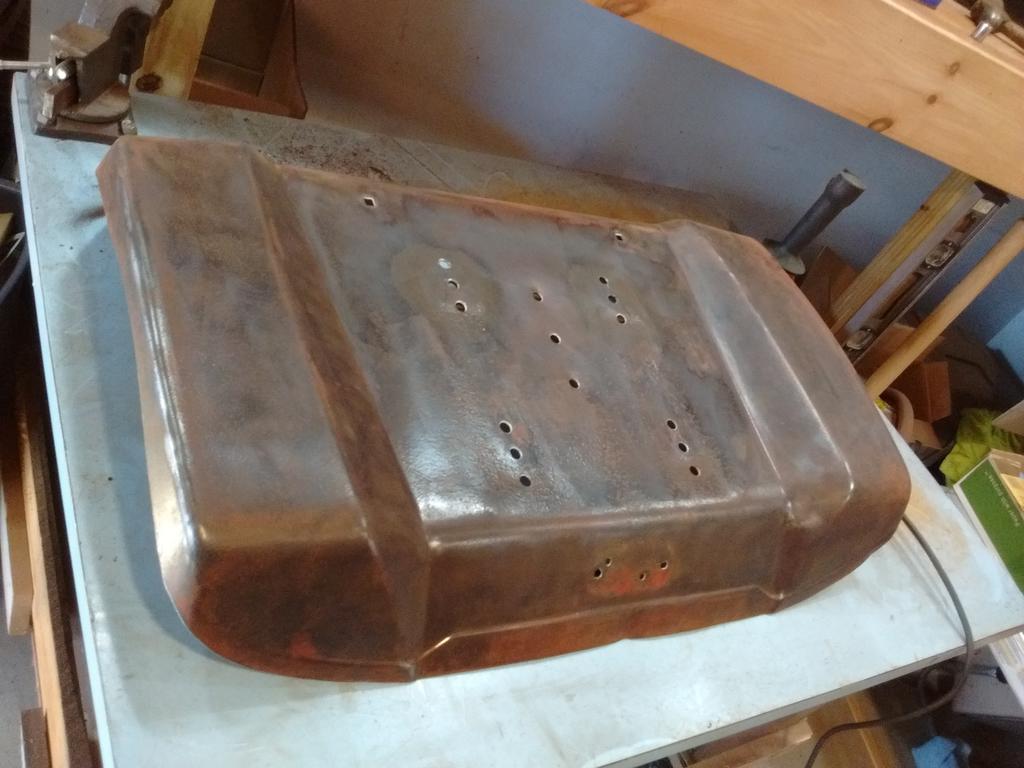

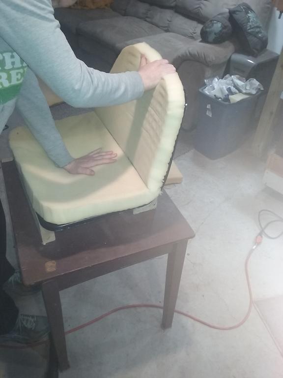

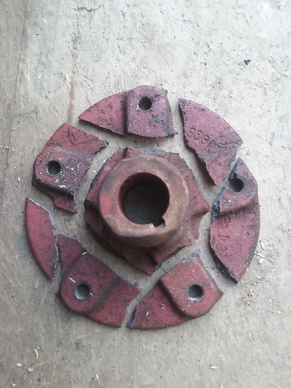

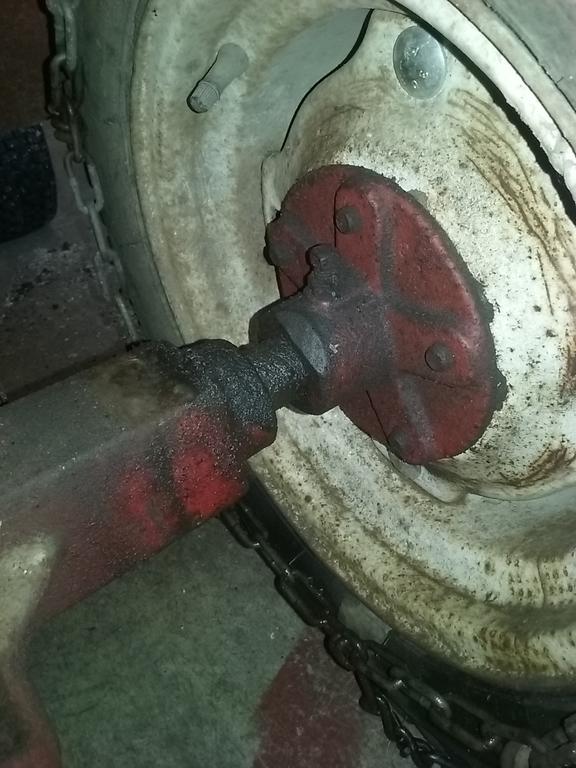

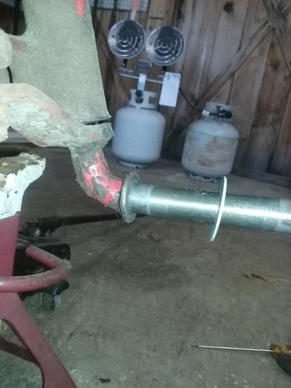

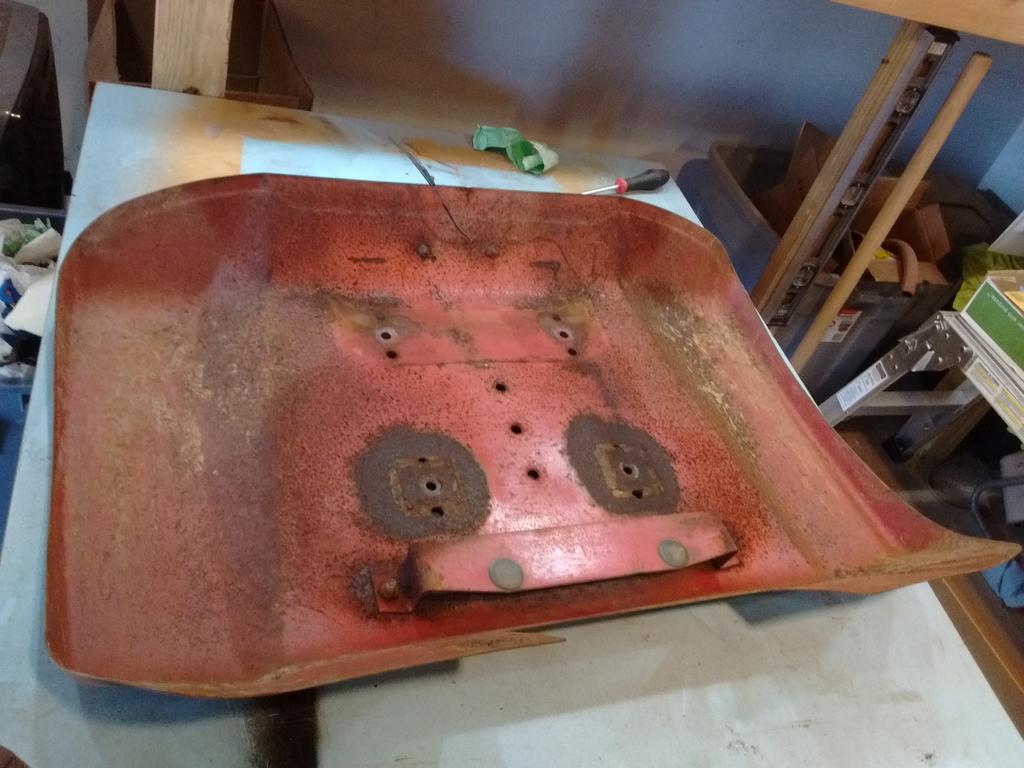

ebinmaine 78,376 #169 Posted March 26, 2018 Well, We did a bit of work on the C the last few days. A few coats of primer on the de-rusted sheet metal. I ordered a metal gas tank from @A-Z Tractor. Thanks Lincoln!!!! That came in and we sanded and began priming it. My honey glued the seat foam on to the frame. She'll finish trimming that up at some point and begin covering it. Me? Oh, I had all KINDS o' fun with hubs !!! Lemme just start by stating that I'm perfectly fine with the multi-piece unit in the next pic... then I'll explain. OK so if you look at the outer edge of the inner portion, right next to the key slot, you'll see where some person in the past (not me, I'd admit it) beat the living stuffing out of the hub trying to make it fly off. Or to the moon ... or whatever. I do not believe they were successful because the other side did not leak much oil and this side has NO visible seal even left in there and this is a different style hub than the other side. (See my post earlier today in Wheelhorse main section) There are similar marks on the outside of the hub as well. So... I was not super happy leaving this hub on when done knowing it may already be cracked and I wanted to do an experiment to see how much it takes to snap one of these infamous brittle hubs. 1/4" impact driver set on high broke it with my large 3 jaw puller. Then I smacked off the rest of it and heat/cool/oil/repeat/etc for awhile and off it came... very reluctantly !!! The axle shaft has some roughness from this one being so rusted on there. The other side looks great and slid off with minimal resistance. Also on the plus side - the keyways look great ! 5 Share this post Link to post Share on other sites
PeacemakerJack 10,937 #170 Posted March 26, 2018 I’m pretty sure Eric that you could make a Picasso piece of garage art out of the pieces of that hub if you arranged them and glued them randomly on a metal back plate in a contrasting color! I’m glad you were able to finally get that thing off of there—even if it was in pieces... The project is looking good 1 2 Share this post Link to post Share on other sites
cpete1 332 #171 Posted March 28, 2018 Wow Eric, That thing fought you that bad??? How much rust was on the shaft to hold it like that? Just asking for my own info so I know what to anticipate... Chris Share this post Link to post Share on other sites

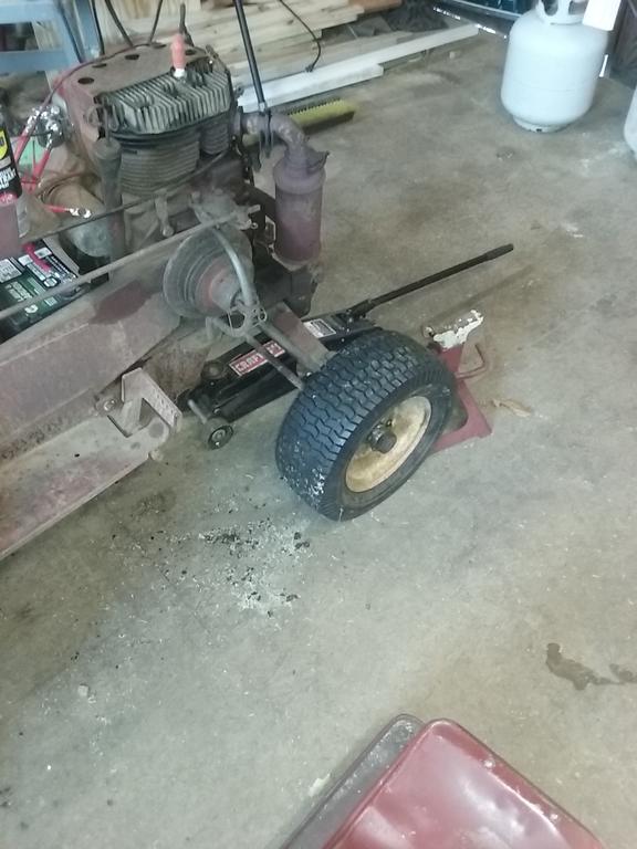

ebinmaine 78,376 #172 Posted March 28, 2018 17 minutes ago, cpete1 said: Wow Eric, That thing fought you that bad??? How much rust was on the shaft to hold it like that? Just asking for my own info so I know what to anticipate... Chris On the record. I I really did treat this as kind of an experiment for my own future knowledge. Like I posted earlier, this Hub already had significant denting damage on both sides so I had very low confidence that I was going to be willing to use it at all, much less actually get it off in one piece without immense patience. I'll try to clean up the axle shaft and show the rust if I can. If I really did want to save this hub, I'm sure I could have. I say that because the penetrating oil was definitely doing its job by coming out the bottom when it was being sprayed into the top. Only two of those chips came off with the 3 jaw puller. The rest I used the hammer simply to get them out of the way so I could get to the small heavy duty Center Circle which I knew the puller would be able to manage. If I was going to take the time to remove this Hub I would have parked the tractor in such a position as to put the set screw at the top and began several weeks ago by spraying penetrating oil into the set screw hole. There are multiple different methods that could have been used that are in posts on this forum. 2 Share this post Link to post Share on other sites

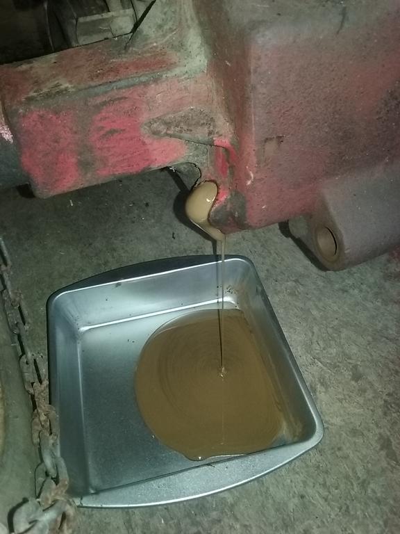

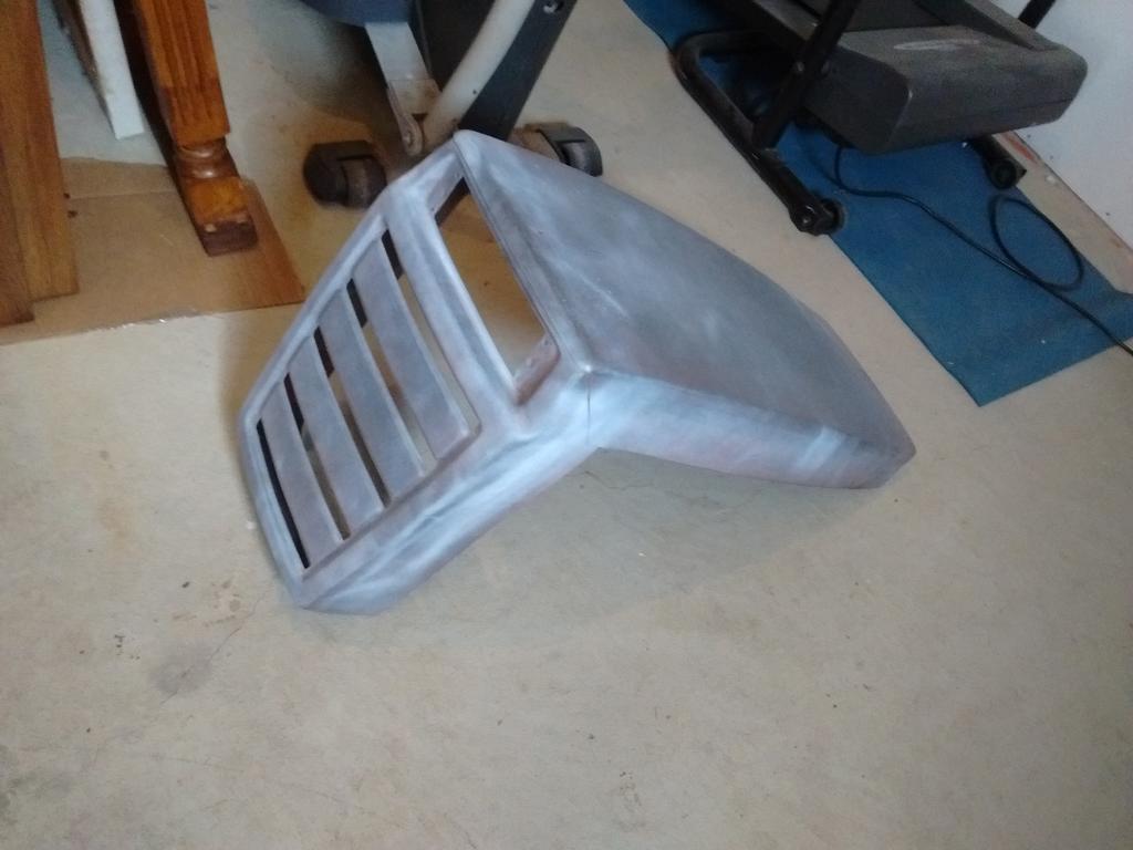

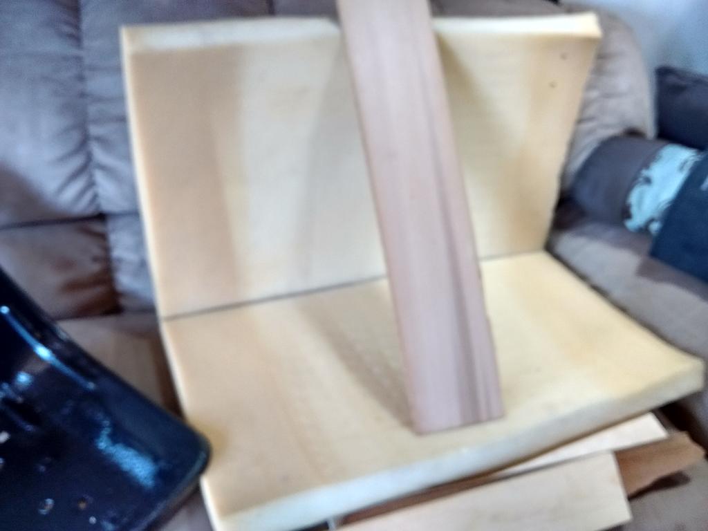

ebinmaine 78,376 #173 Posted March 31, 2018 Changed the trans fluid for the 4th? time today. Looks acceptable for the season. Need to get some wheel seals in from Lowell S. for that. Hubs arrived from @A-Z Tractor. They'll be painted soon and installed. My honey trimmed the foam for the seat and layed out the vinyl. Anndd....... I did a bit of painting !!!! * * I'm going to warn the color purists. It isn't red. But it's a color no other manufacturers use that I know of. I chose a satin to be more forgiving of the rough surface. Tank and wheels will be Navajo white. 5 Share this post Link to post Share on other sites
