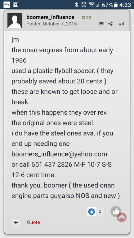

mgk20181 1 #11 Posted February 14, 2018 On 1/25/2018 at 9:18 PM, WVHillbilly520H said: Yup yes it definitely was a governor problem. it had a plastic fly ball spacer which loosened up on the shaft so it was allowed to spin. got it fixed with the help of boomer. thanks for all the great replies and info mgk 1 Share this post Link to post Share on other sites
