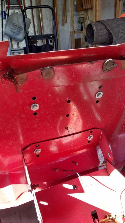

paxz71usa 173 #11 Posted January 25, 2018 (edited) Just looked under mine a few minutes ago and there are four sets of holes for adjustment already there and they sure appear to be factory. Gary Edited January 25, 2018 by paxz71usa 3 Share this post Link to post Share on other sites

ebinmaine 77,376 #13 Posted January 25, 2018 1 hour ago, paxz71usa said: Just looked under mine a few minutes ago and there are four sets of holes for adjustment already there and they sure appear to be factory. Gary My b80 is also set up like that with multiple holes. Unfortunately some other owners have added multiple other holes... and I've drilled two more myself So it's beginning to look a bit like Swiss cheese 3 Share this post Link to post Share on other sites
Racinbob 12,773 #14 Posted January 25, 2018 I did this when I restored a Commando 800 for my grandson. The slots in the pan give you quite a bit of adjustment. The back of it is bolted directly to the fender pan since there's so need for it to flip up. I'm doing the same thing on my 500 Special. I was also concerned about the fender latch so I spring loaded it latched closed. 5 2 Share this post Link to post Share on other sites
