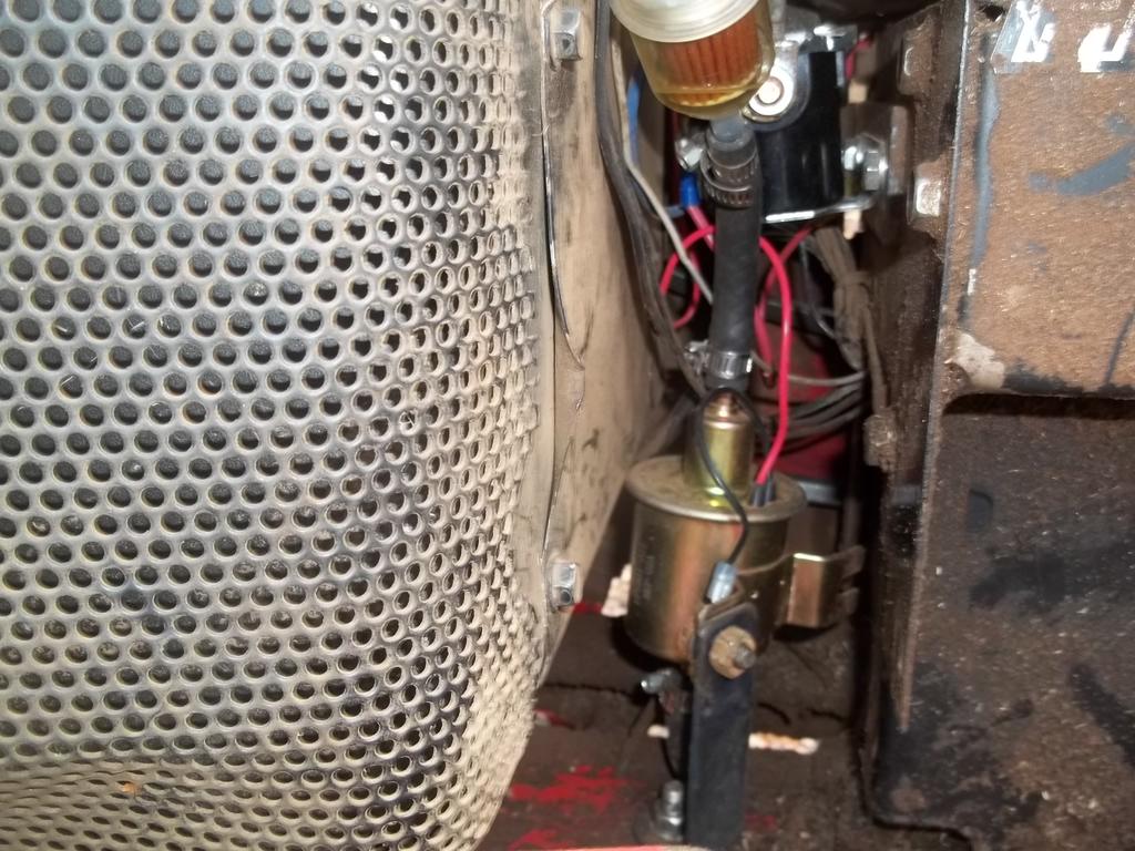

953 nut 63,916 #5 Posted January 23, 2018 The mechanical pump is located above the tank and has a hard time drawing fual up to it. Mount your electric pump low and connect the wire to your accessory (lighting) fuse so it is protected. 2 Share this post Link to post Share on other sites

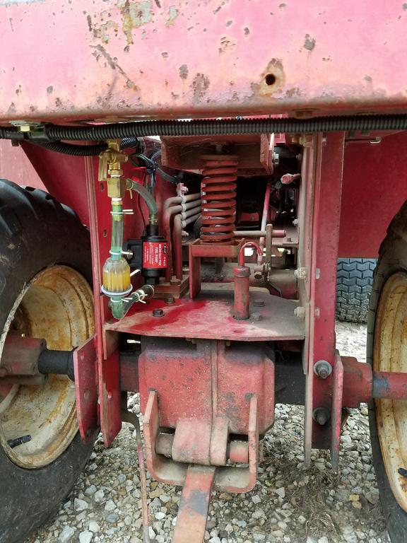

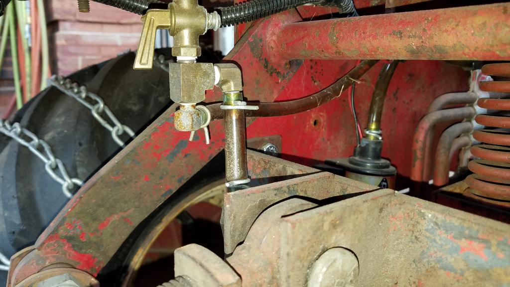

Racinbob 12,648 #6 Posted January 23, 2018 That's a common issue with the fuel tank under the seat and lower than the fuel pump. I had the same problem with my low hour 2005 Classic. I picked up the two for <$20 electric pumps but then decided to try a check valve first so I picked up a couple of them. Before I got one installed @stevasaurus suggested this simple test to see if it helped. Simply park the tractor with the back end raised and the tank full. So I parked it with the rear up on ramps. Normally I could go one day, maybe two but after that I would have to crank it a bit. After sitting over a week on the ramps it fired up immediately. Cool! Of course i didn't want to park it on the ramps all the time so I went the easy and fast route (call that lazy) and put a check valve in line. That proved to be about a 90% fix. Since I'd been using a different tractor with a blade to move snow it sat for about a month with the blower mounted. Starting was better but I still had to crank more than I liked. It could have been the single digit temps or the valve leaks back slowly. In any case, I'll be putting one of the electric pumps on it when things warm up. That should solve the issue for good. 2 Share this post Link to post Share on other sites
