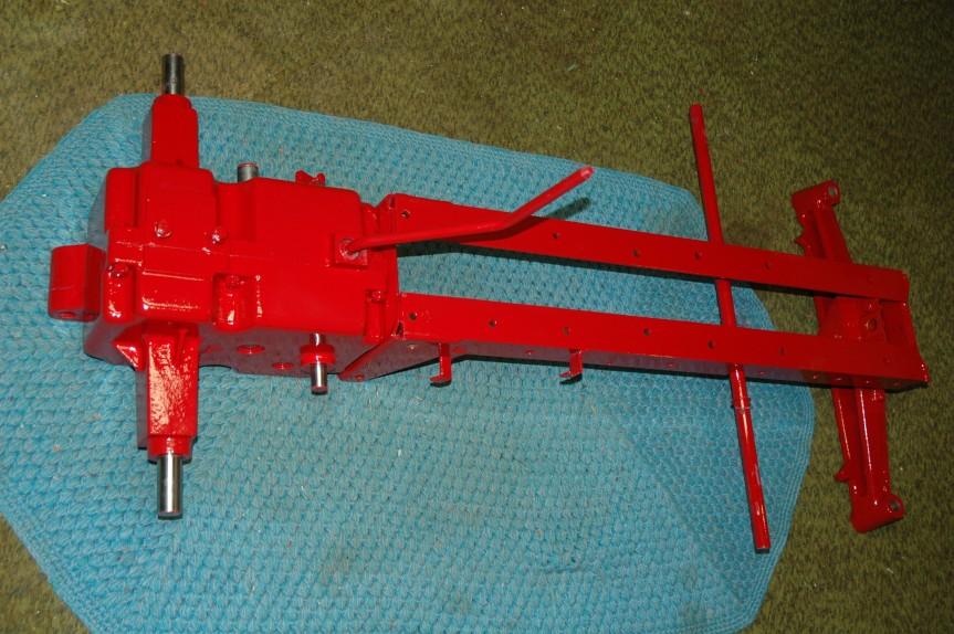

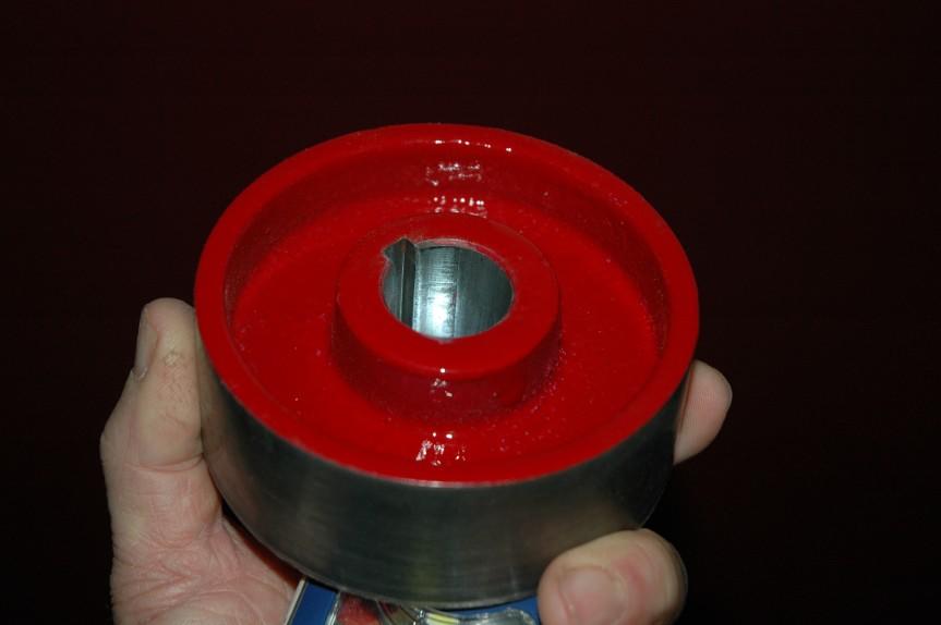

jebbear 386 #128 Posted November 9, 2018 OK, while I'm patiently waiting for the proverbial paint to dry , back to the tractor. Again, I am looking for some help or a suggestion on something I didn't catch earlier on but hoping there is an easy fix. Since it is transmission related, @stevasaurus this may be a good one for you to comment on. After getting everything painted, I started playing around putting a few loose parts back together. My issue is with the brake drum on the tranny, there seems to be a slight amount of excessive play where it mounts on the shaft. I read on here where others have had problems removing this thing, mine is just the opposite. I installed a new woodruff key, but it still just slides on with no resistance and even has an ever so slight "wiggle" on the shaft. I miked both the shaft and the drum, the shaft is dead on at 1.000", while the drum varies slightly at different cross-sections in the hole with the worst being out 1.003". Not very much but still not a tight fit. The new woodruff key also does not fit perfectly snug in either piece. Without any set screw holding this thing other than the retaining ring, the drum is able to slide back and forth on the shaft between the case and the retainer. I wish I would have caught this earlier when working on the tranny, but not seeing any visible sign of wear at the time no flags went up. So my question, is there some type of material (loctitie, etc.) that can be used to "tighten" this up, but has to be something I can remove later if need be? If I knew for certain that a new brake drum would help, I would go that route, but the ever so slight wiggle in the woodruff key concerns me if it happens to be coming from the shaft slot. Also thought about placing a machine bushing washer between the case and the drum to limit the side travel and still maintain a few thousandths end play, but that still won't address the keyway wiggle. Looking for recommendations, Thanks! Share this post Link to post Share on other sites
stevasaurus 23,861 #129 Posted November 9, 2018 I think just last week, I was reading a thread where the member talked about the brake drum being out of round and some other issues. I tried looking for it, but was not successful. Maybe someone else here read it and knows where it is. Anyway, I am not sure if what you have is a big deal...I am inclined to think the tolerance of this from the factory was not one of the major things they worried about. The only place I actually use the brake is on a hill, and there are no hills in Illinois. Seriously, you could get a different key, that is a little larger, and file it down to a snug fit. That could help the wobble. A brass shim would take out the in and out slack. Are you sure the bearing is good...no up and down and side to side?? You could drill it out and use a brass bearing that is slit for the key. If you have other horses, or know someone around you...you could try different brake drums and see if that makes a difference. I am no machinist, maybe @buckrancher can help you here. 1 Share this post Link to post Share on other sites
jebbear 386 #130 Posted November 9, 2018 Thanks Steve, I'm not sure it's a real big deal either because it has probably been this way for some time now. I just figured it would only get worse in time with the thing constantly moving back and forth from braking because unfortunately here in PA we do have hills . The bearing is brand new along with all others from rebuilding the transmission (with a lot of thanks to you for your prior assistance) so that should not be the issue. I have even heard of others that have used J-B Weld for keyway and shaft issues and thought about maybe trying to just putting a thin coating inside of the drum hole and just sanding it until I get a snug fit on the shaft. I just don't want to glue the drum to the shaft though since removal would be impossible, so I could only apply it to one of the surfaces then try to wedge it on to a snug fit. I think I may still add a machine washer between the case and the drum because there is currently approx 1/8" side travel as is, so I can at least get this down to a few thousandths of end play which should help alleviate some of the movement. 1 Share this post Link to post Share on other sites

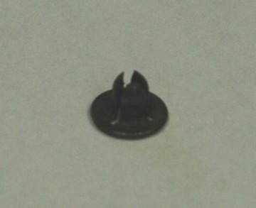

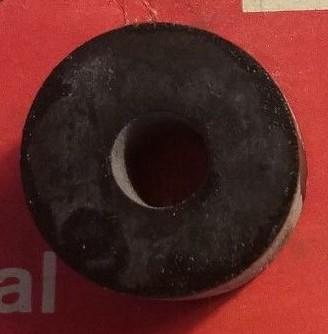

jebbear 386 #131 Posted November 9, 2018 While I'm on here, I also want to throw out there a couple of "in search of" things that someone may have a source for. I am looking for one of the original little rivet thingys that holds the serial # tag on the Kohler engine... I am only missing one and would prefer to keep it looking as original as possible. Anyone know where to find ONE of these? Also, looking for ONE of the rubber rollers (OEM Part #5505) that goes on the hood latch rod mechanism. There are (2) and one of mine looks perfect, however, the other is kind of worn down smaller diameter and egg shaped. May not even be a big deal since the hood seemed to latch OK, but since it looks worn I figured now is the time to replace it. Found one on Fleabay for 5 bucks, but he wants 8 more bucks to ship it. Seems a little steep for something that could be thrown in an envelope with a stamp. 1 Share this post Link to post Share on other sites
ebinmaine 81,046 #132 Posted November 9, 2018 32 minutes ago, jebbear said: may still add a machine washer between the case and the drum because there is currently approx 1/8" side travel as is, so I can at least get this down to a few thousandths of end play which should help alleviate some of the movement. I don't know that I would want to try the J-B Weld trick in this particular situation. I don't think the pulley being loose on the shaft is too serious of an issue. The end play would bother me a bit. I like the idea of getting rid of that. I also like the idea that Steve had about getting a slightly larger key and machining it down to get a tighter fit. Share this post Link to post Share on other sites
Pullstart 71,482 #133 Posted November 9, 2018 Maybe lock tite medium, but not jb weld... 1 Share this post Link to post Share on other sites
stevasaurus 23,861 #134 Posted November 10, 2018 You know, and this is pretty Polish (no offense intended)...Maybe a little flux, some heat on the end of the shaft and melt a little solder with the drum on. The solder should not meld with the steel, but it might work to shim it tight and you could still get the drum off. don't heat it too much...not good for the seal. Share this post Link to post Share on other sites
oliver2-44 11,791 #135 Posted November 10, 2018 Lock-Tite 660 Is made for “Cylindrical Gap Filling” applications like this. I have used it and the part is removable with a little heat. 3 Share this post Link to post Share on other sites
jebbear 386 #136 Posted November 10, 2018 (edited) 1 hour ago, stevasaurus said: Maybe a little flux, some heat on the end of the shaft and melt a little solder That's an idea. Wonder about just the opposite, apply just a thin layer to the inside of the drum then get the old reamers out to dress the solder. Then heat wouldn't be a factor with the seals but it would destroy my paint on the drum center . Could actually even do the key slot lightly then dress with a file. One good thing with solder, as long as I can keep it thin and get it started onto the shaft, the solder would be "self dressing". 16 minutes ago, oliver2-44 said: Lock-Tite 660 Is made for “Cylindrical Gap Filling” I saw mention of this stuff when I was doing my own research on the net. Also sounded like a viable option, just wasn't sure about how much heat is required for removal. Same concern as above with the seals & such when applying heat. Thanks, both of you for the input. Not sure yet what route to take. Wish I knew someone close that had a different drum just to try before actually buying one because that would be the simple fix. Edited November 10, 2018 by jebbear 1 Share this post Link to post Share on other sites
stevasaurus 23,861 #137 Posted November 11, 2018 There will be a ton of brake drums at the big show in June. You should be able to try them all day and switch with the one that works. 1 Share this post Link to post Share on other sites
jebbear 386 #138 Posted November 11, 2018 1 hour ago, stevasaurus said: There will be a ton of brake drums at the big show in June That is probably what I'm going to end up doing, just hope I can make it this year. Had every intention of going to the show last year but my summer didn't quite turn out the way I planned. Upon deeper inspection it does look like my drum is the culprit. As I had mentioned, I'm only looking at only about 0.003" wear and and the shaft is dead on at 1.000" diameter. If you can see it in the photo, there is a distinct wear area adjacent to the keyway on both sides. Not really sure how it wore this way so uniformly on both sides of the keyway other than it has probably been loose for some time and from the constant sliding, but I can feel the offset along that little rib. So I believe replacement is in the stars. For now just as an experiment, I might just try my idea of putting a little J-B Weld on my finger and putting a skin coat over this area, then maybe take a brake hone or something similar to dress it back to where it will slide on the shaft. Nothing to lose I guess but I probably will still look at replacement. Share this post Link to post Share on other sites

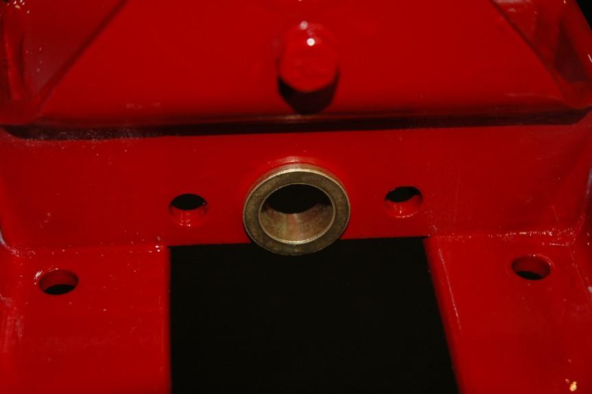

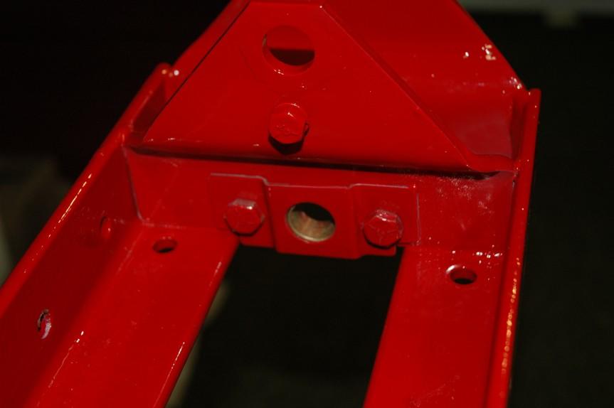

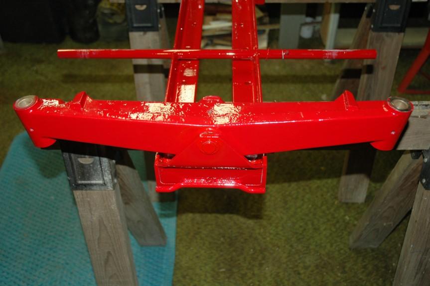

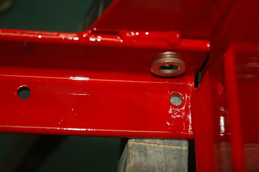

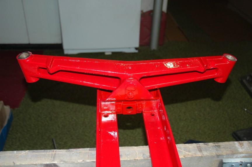

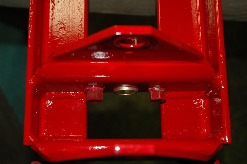

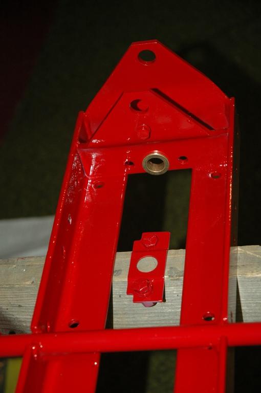

jebbear 386 #139 Posted November 11, 2018 So, between the paint issue on the rims and the unexpected glitch with the brake drum, I still have a tractor to reassemble. So here goes: Started with the frame and the new retrofit bronze flange bearing in the lower steering shaft (front). Since this cross member on the frame is only about 1/4" thick, I added a little extra bracket that I had fabricated as a retainer just to make sure the bearing stays in place. I used the (2) existing holes that were already in the frame that were not being used on my tractor (some other model/application?) and attached with two bolts: Next was the front axle with the new pivot pin that I had previously fabricated (see earlier in this post): Then bolted up the transmission to the frame: One noteworthy item. You may notice that I'm building this in a carpeted area which happens to be in the basement. Due to my late start ( or should I say "re" -start) with this project, this is the only heated area that I have to work in. I originally planned on completing this project out in the large storage building/garage where the tractors are kept, but since in my older age I enjoy HEAT, this is the improvised assembly line. I did a lot of measuring and I "THINK" I can get it out the basement door when done. Worse case, I know it will fit if I have to remove the wheels/tires, but will then need to improvise some type of sled or dolly to roll the thing. I guess if the Egyptians could build the pyramids, I can figure out a way to get this thing through a door! Anyway, still moving slow just doing a little bit at a time, but at least a few bolts are going back ON now instead of coming OFF!! 2 3 Share this post Link to post Share on other sites

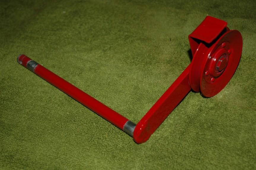

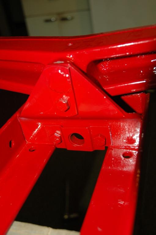

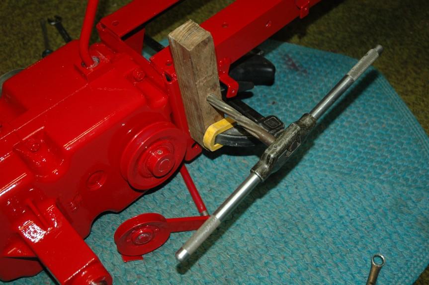

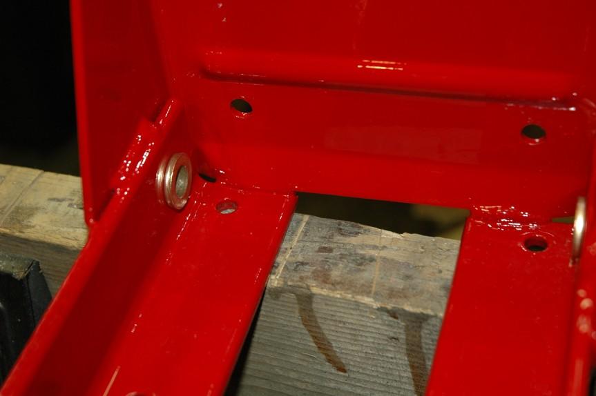

jebbear 386 #143 Posted November 12, 2018 A couple more updates on the frame & related. Pressed in my retrofit bronze flange bearings for the clutch idler shaft at the rear of the frame. Had to make a little jig out of a block of wood to keep the reamer in alignment when reaming the bearings to 0.500" for the shaft. ...And the idler shaft. Fits like a glove, but I have not permanently installed yet as things still need a little tweeking on the pivot arm, parking brake assembly, and brake linkages opposite the pulley end. Installed a new idler pulley on the shaft that I found on fleabay since the old one had a lot of slop in the bearings. I had originally tried to repair my old pulley by separating and just replacing the ball bearings, but nobody including McMaster Carr or Motion Industries seemed to have the exact fit to what I had measured from the original bearings which were Nice 7277-3 bearings. Found a couple that were very close & may have worked, but this NOS complete pulley popped up so I went for it. 1 2 Share this post Link to post Share on other sites
