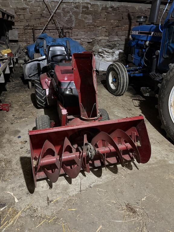

Desko 687 #24853 Posted November 6, 2025 Took the 60” off and cleaned/oiled it and wrestled my new to me 44” two stage on now just gotta weight the rear down and hope it wards off any snow lol 5 7 Share this post Link to post Share on other sites

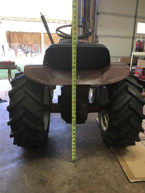

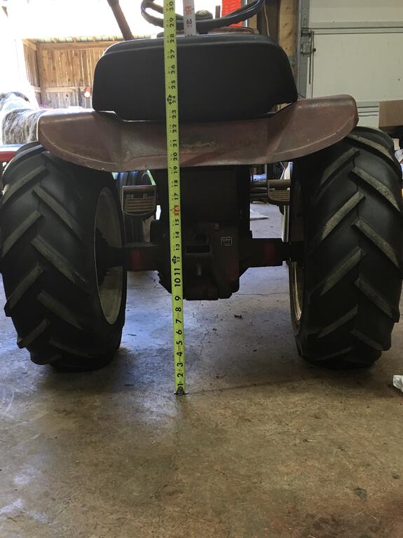

Treepep 1,151 #24854 Posted November 6, 2025 On 10/25/2025 at 7:39 PM, sqrlgtr said: Done small mod to the 1257. First Picture, with plow behind, was when it was still in the hands of the infamous @WHX??. Next pic is after modification that I got done today. Thought it would be fun to see who could spot mod first. ya bent yer shifter? 2 Share this post Link to post Share on other sites
sqrlgtr 4,155 #24855 Posted November 6, 2025 swapped some Deestone 8.50's for some Carlisle 8.50's raised rear of tractor a little over an inch. 6 2 1 Share this post Link to post Share on other sites

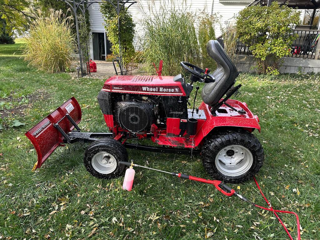

Andy N. 2,881 #24856 Posted November 6, 2025 Weatherman says there may be snow this weekend. Not sure I believe hime, but figured since it was close to 60 degrees today, it was a good day to clean the snow pusher! 9 1 Share this post Link to post Share on other sites

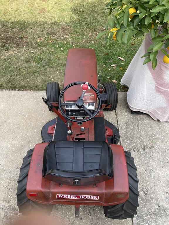

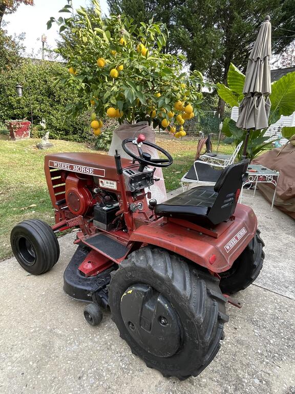

Wheelhorse#1 1,998 #24857 Posted November 7, 2025 (edited) Too much wind today to do leave patrol again so decided to clean up the B80 and to finally put on the anti skid I had laying around . She cleans up pretty nice I think Edited November 7, 2025 by Wheelhorse#1 8 2 Share this post Link to post Share on other sites

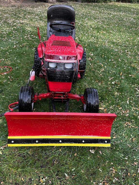

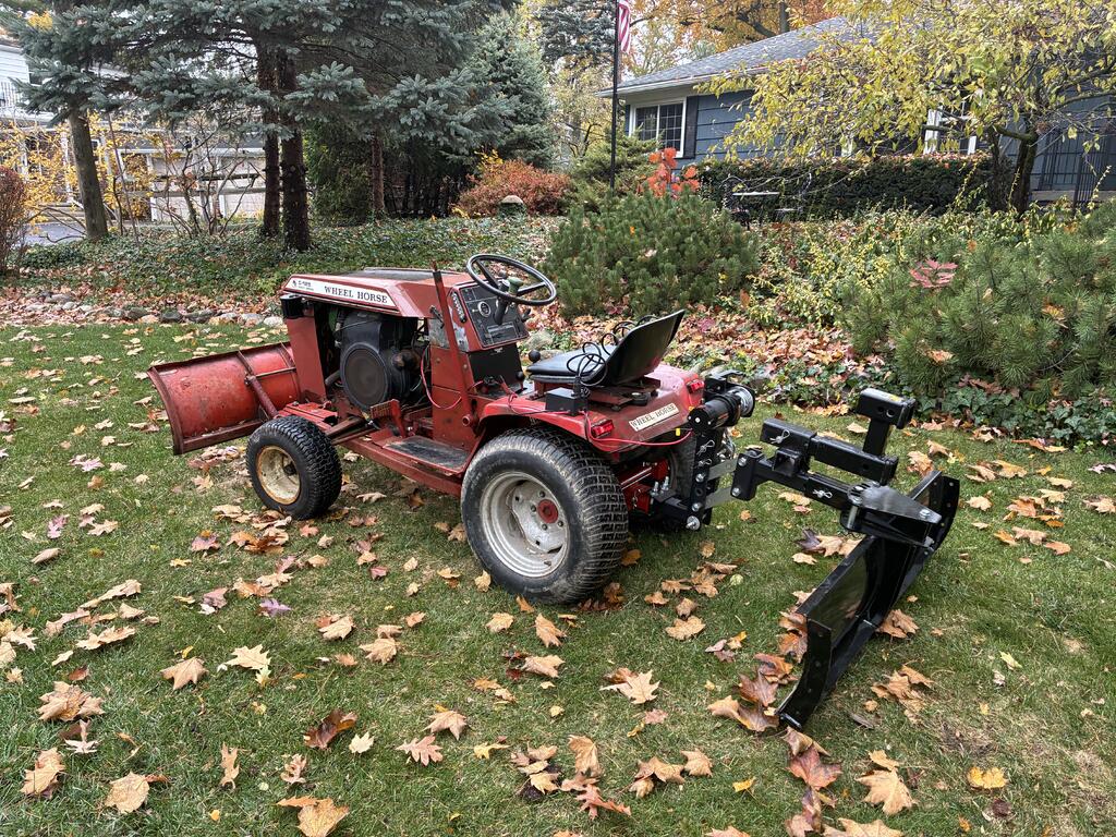

SylvanLakeWH 32,774 #24858 Posted November 7, 2025 Finished fitting new to me front blade on the C-125. With back blade it's my secondary and touch up snow rig. 4 4 Share this post Link to post Share on other sites
Handy Don 17,634 #24859 Posted November 7, 2025 2 hours ago, SylvanLakeWH said: Nice that you have room to park that big ‘un. 1 1 Share this post Link to post Share on other sites

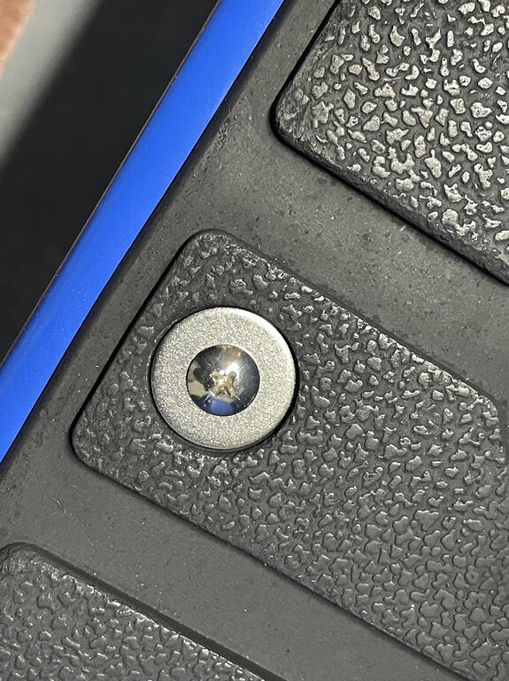

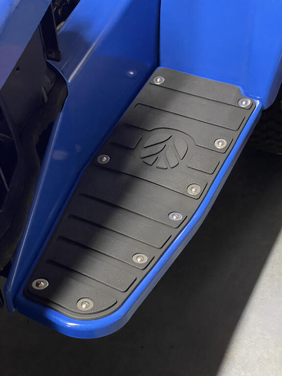

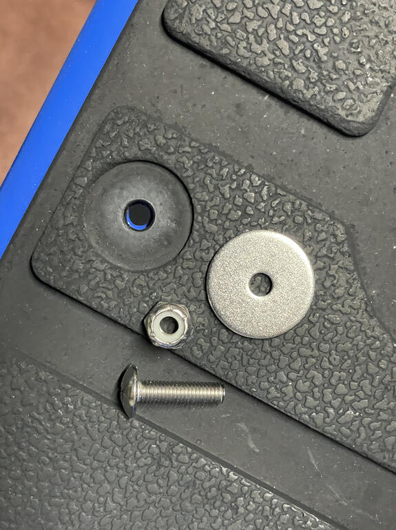

Blue Chips 881 #24860 Posted November 8, 2025 (edited) Yesterday, I reinstalled the rear fender assembly on the GT18 (more on that later), and I did another small job today: I cleaned and reinstalled the GT18's rubber foot rest mats. I had some plastic 'variable-depth push pins' that I thought would be a good match to the originals, but it turned out they weren't quite long enough to get a good grip, and I didn't want to pay the crazy price for OEM plastic push pins, so I used 7/8" OD stainless washers and 10-32 stainless truss-head screws, with stainless lock nuts. They were cheaper than the OEM plastic push pins. The washers fit perfectly down into the 7/8" diameter recesses in the rubber mats, and the truss-head screws are low-profile, so when they're all tightened down, the tops of the screws are at roughly the same level as the surface of the mat. They might not match the original black plastic push-pins, but I kind of like their heavy-duty appearance, and they're certainly stronger than the plastic pins. Edited November 8, 2025 by Blue Chips 5 7 Share this post Link to post Share on other sites
kpinnc 19,036 #24861 Posted November 8, 2025 21 minutes ago, Blue Chips said: They might not match the original black plastic push-pins, but I kind of like their heavy-duty appearance, and they're certainly stronger than the plastic pins. I use alot of stainless fasters on my builds. They definitely add some bling to the look. Excellent work! 2 1 Share this post Link to post Share on other sites
MainelyWheelhorse 3,170 #24862 Posted November 8, 2025 8 hours ago, kpinnc said: I use alot of stainless fasters on my builds. They definitely add some bling to the look. Excellent work! @kpinnc Same here, and the anti rust quality of them, especially up here, is a plus. Nice work @Blue Chips. 1 1 Share this post Link to post Share on other sites
Handy Don 17,634 #24863 Posted November 8, 2025 13 hours ago, Blue Chips said: The washers fit perfectly down into the 7/8" diameter recesses in the rubber mats, and the truss-head screws are low-profile, so when they're all tightened down, the tops of the screws are at roughly the same level as the surface of the mat. Another option: elevator bolts like these. I got some of these for when I re-deck my utility trailer. 1 Share this post Link to post Share on other sites
Blue Chips 881 #24864 Posted November 8, 2025 2 hours ago, Handy Don said: Another option: elevator bolts like these. I got some of these for when I re-deck my utility trailer. It's a good suggestion. I've had several applications for elevator bolts on past projects. Their flat, low-profile heads can be VERY useful. However, for the foot rest mats on the GT18, I couldn't find any elevator bolts with the right combination of head OD (7/8") and thread size that wouldn't require drilling all of the mounting holes to a larger size, like 5/16", which admittedly I could have done fairly easily, but to get them in stainless steel they were quite pricey. 1 Share this post Link to post Share on other sites
peter lena 10,103 #24865 Posted November 8, 2025 @Wheelhorse#1 like the retention of original paint , with the oiled patina look , think it just fits , there is avery fine line , at saving / recovery , thats why I regularly suggest to another horse owner , to get some oil soaking going on , as soon as you get another horse . gone on to the next level , of paint shine , with stages of oil buffing . Share this post Link to post Share on other sites

ranger 1,862 #24867 Posted November 8, 2025 (edited) 17 hours ago, Blue Chips said: Yesterday, I reinstalled the rear fender assembly on the GT18 (more on that later), and I did another small job today: I cleaned and reinstalled the GT18's rubber foot rest mats. I had some plastic 'variable-depth push pins' that I thought would be a good match to the originals, but it turned out they weren't quite long enough to get a good grip, and I didn't want to pay the crazy price for OEM plastic push pins, so I used 7/8" OD stainless washers and 10-32 stainless truss-head screws, with stainless lock nuts. They were cheaper than the OEM plastic push pins. The washers fit perfectly down into the 7/8" diameter recesses in the rubber mats, and the truss-head screws are low-profile, so when they're all tightened down, the tops of the screws are at roughly the same level as the surface of the mat. They might not match the original black plastic push-pins, but I kind of like their heavy-duty appearance, and they're certainly stronger than the plastic pins. One very important thing to remember when using stainless bolts and stainless nuts together is to always apply a drop of oil on the threads before assembly. If you don’t, there is a very real chance of ‘Galling’, you can literally screw a nut onto a bolt, finger tight, and then find that it’s virtually impossible to unscrew, even with spanner’s. The threads ‘pick’ up. I have come across this numerous times on winter maintenance equipment, snow blowers, salt spreaders, etc. A drop of oil, WD40, or Loctite if using plain nuts instead of self locking, in fact anything liquid, or semi liquid which, ‘Contaminates’ the threads seems to work. As a last resort, ‘Spitting’ on the threads also works! Saliva, apparently, is quite a good lubricant? Edited November 8, 2025 by ranger 4 Share this post Link to post Share on other sites
ebinmaine 81,046 #24868 Posted November 8, 2025 2 minutes ago, ranger said: Galling That's actually the reason we use nearly zero stainless and nearly all Grade 8. Zinc coating isn't as good as a true stainless bolt but they'll do for our usage. 3 Share this post Link to post Share on other sites

ranger 1,862 #24871 Posted November 8, 2025 2 minutes ago, ebinmaine said: That's actually the reason we use nearly zero stainless and nearly all Grade 8. Zinc coating isn't as good as a true stainless bolt but they'll do for our usage. If you want the appearance of stainless, but don’t want galling issues, just use the zinc plated nuts with s/s bolts? Personally, I’ve had no problems using s/s bolts and s/s nuts together. I just remember to apply a drop of oil, grease, whatever before I assemble 4 1 Share this post Link to post Share on other sites

Blue Chips 881 #24875 Posted November 9, 2025 (edited) 5 hours ago, ranger said: One very important thing to remember when using stainless bolts and stainless nuts together is to always apply a drop of oil on the threads before assembly. If you don’t, there is a very real chance of ‘Galling’, you can literally screw a nut onto a bolt, finger tight, and then find that it’s virtually impossible to unscrew, even with spanner’s. The threads ‘pick’ up. I have come across this numerous times on winter maintenance equipment, snow blowers, salt spreaders, etc. A drop of oil, WD40, or Loctite if using plain nuts instead of self locking, in fact anything liquid, or semi liquid which, ‘Contaminates’ the threads seems to work. As a last resort, ‘Spitting’ on the threads also works! Saliva, apparently, is quite a good lubricant? Yes, galling can be rather 'galling.' I've rarely had a galling issue with fasteners as small as 10-32 screws, but the chance of galling certainly increases rapidly as screw diameters and torque values increase. Thread pitch can also be a factor. I have four or five different types of anti-seize lubricants, a couple of which I use for stainless, such as Blue Moly, which works well, but it's very blue and very messy to use (wear rubber gloves). I have a couple of general-purpose anti-seize compounds that I often use on fasteners that will be exposed to weather or other harsh conditions, partly because it helps to seal the threads. When installing spark plugs, I use an electrically conductive copper-containing anti-seize compound, which also has good heat transfer characteristics (be careful not to get it on the insulator of the plug). One 'gotcha' with anti-seize compounds is that they have a torque factor that should be applied when tightening a fastener because the lubricity of the compound will typically reduce the amount of torque required to obtain the correct stretch or clamping force for a bolt, whether it be a reusable bolt or a one-time-use torque-to-yield bolt. The torque factor for a specific anti-seize compound is generally found in the technical data sheet for that product. Some typical values might range anywhere from a 10- to 30-percent reduction in required torque...give or take. 5 hours ago, ebinmaine said: That's actually the reason we use nearly zero stainless and nearly all Grade 8. Zinc coating isn't as good as a true stainless bolt but they'll do for our usage. The yellow, green, and blue chromate passivation treatments (conversion coatings) on zinc plating provide a good increase in corrosion protection over plain zinc plating. Most grade 8 fasteners have yellow-chromate treatment. Zinc-flake-coated steel is even better for corrosion protection than the chromate treatments, although I've found that the thickness of the flake coating sometimes makes the bolt-to-nut fit a bit on the snug side. I'm set up to do my own electroplating, which can be handy for restoring special fasteners that are not easily replaced, such as the script-head bolts for my Dodge M37 project. It's a bit time-consuming, and some of the chemicals can run up a bill, so it really doesn't save me any money, but it's nice to be able to control the process, especially making sure that all steel parts are baked immediately after plating to help prevent hydrogen embrittlement, which is even more important for harder, alloy, high-strength, etc., steels. Here's a photo of part of my plating bench setup (more has been added since this photo was taken): As an example, here are some of the shoulder bolts used for mounting the headlights on my Dodge M37 after glass bead blasting and before plating: And after plating and a chromate passivation treatment: I may be getting carried away here. This could easily expand into a whole new discussion of what type or grade fastener is best for certain jobs, but that should probably be left to its own thread. Edited November 9, 2025 by Blue Chips 3 5 Share this post Link to post Share on other sites
