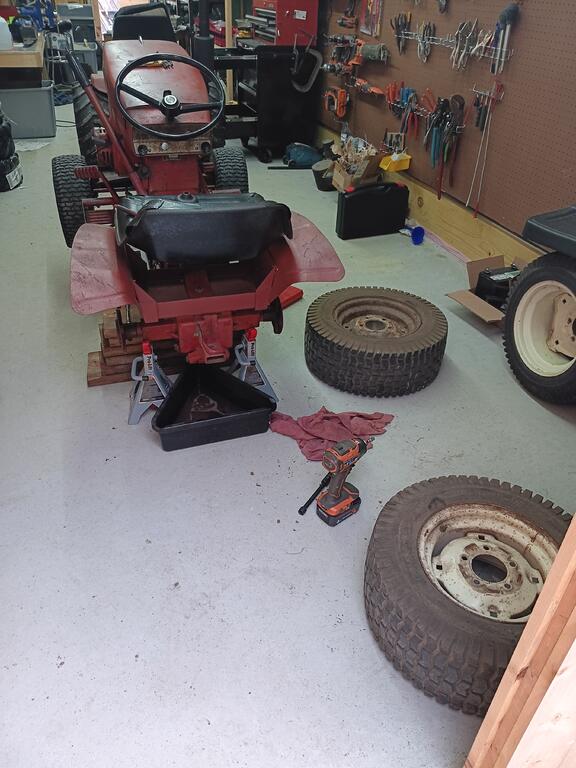

ebinmaine 81,047 #24226 Posted August 5, 2025 A little maintenence on the "Sparky" tractor. @Sparky The new owner has decided that new more aggressive shoes are acceptable. Needed a new shifter boot. Also doing a transmission fluid change. Our workshop smells like old gear ⚙️ oil 🛢 4 4 1 Share this post Link to post Share on other sites
Sparky-(Admin) 26,621 #24227 Posted August 5, 2025 21 minutes ago, ebinmaine said: A little maintenence on the "Sparky" tractor. @Sparky The new owner has decided that new more aggressive shoes What kinda new rubber? 1 Share this post Link to post Share on other sites
ebinmaine 81,047 #24228 Posted August 5, 2025 Just now, Sparky said: What kinda new rubber? She went with exactly what's on Millie. I believe those are the wheels we bought from you as well. Deestone 23 x 8.50 x 12 AG rears with Deestone 4.00 x 8 tri ribs up front. I'm still workin' on talking her into changing the seat. 💺 🪑 😀 1 2 Share this post Link to post Share on other sites

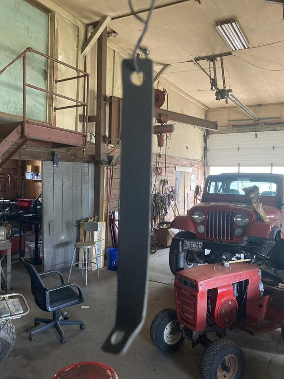

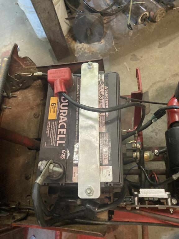

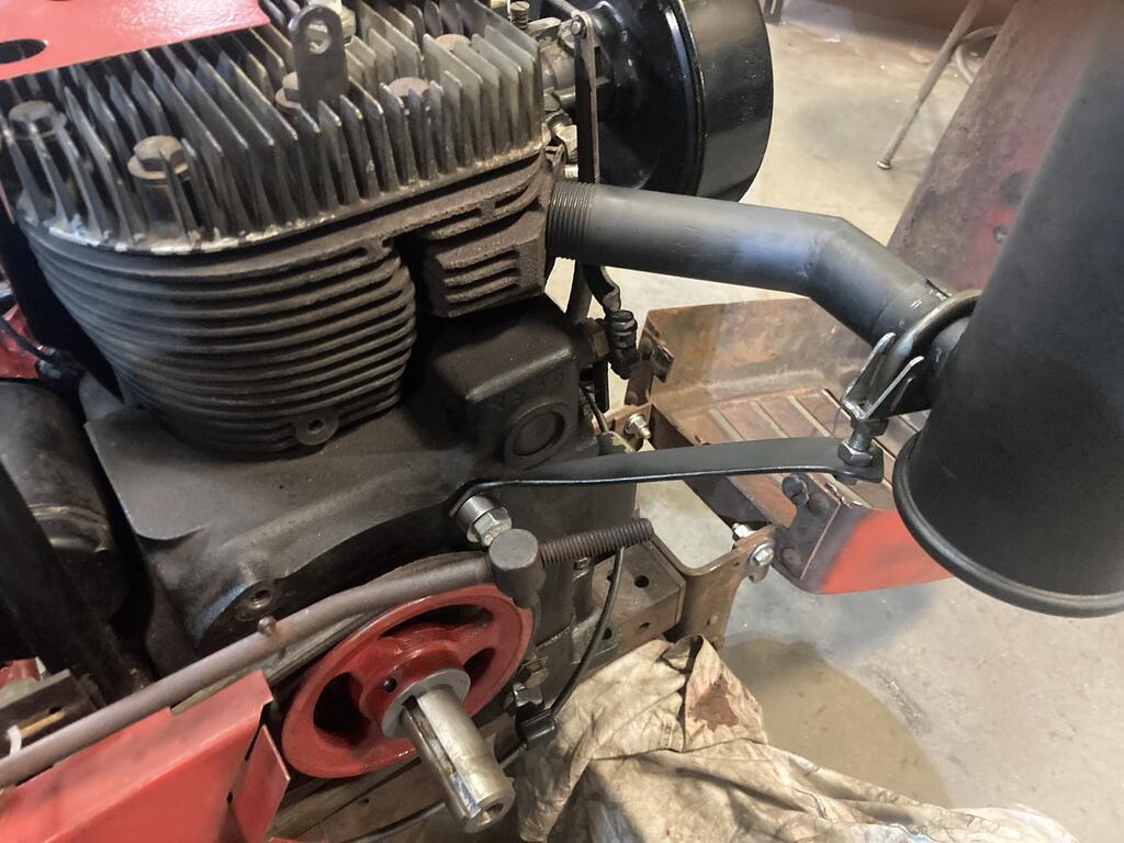

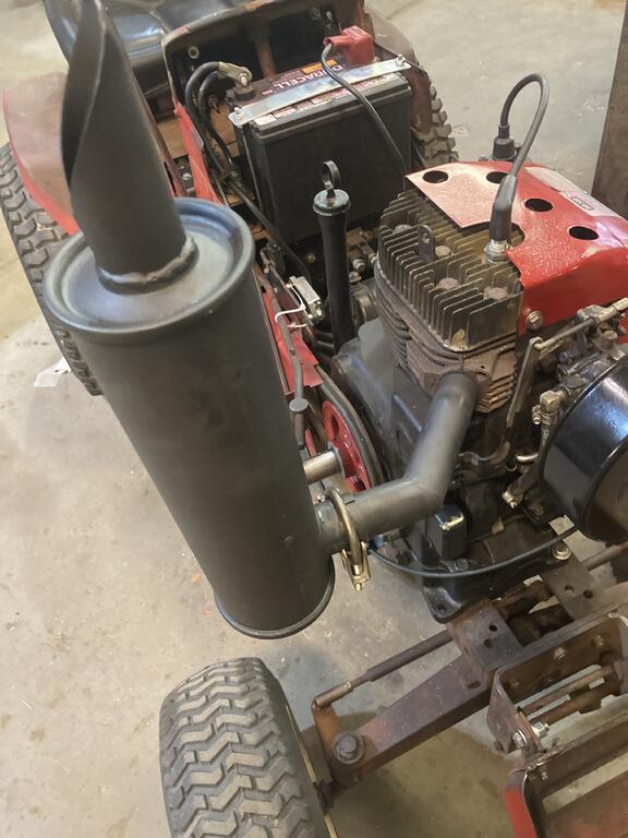

MainelyWheelhorse 3,170 #24230 Posted August 6, 2025 (edited) Today was buttoning things up after work on the C-141. It’s coming together. The hood hinge was loose and the bolts didn’t stay tight. It was temporarily put together today I finalized it. The exhaust pipe was reattached. I also cut an unneeded bracket off the muffler and painted it. I also built a battery hold down. It’s safe now @ebinmaine no bungee cord here now. The last major thing is painting the bodywork. I also have to put the handles on the throttle and choke. Possibly more progress tomorrow. Edited August 6, 2025 by MainelyWheelhorse 1 3 Share this post Link to post Share on other sites
Handy Don 17,634 #24231 Posted August 6, 2025 (edited) 31 minutes ago, MainelyWheelhorse said: Great progress, there. Very satisfying, I’m sure. Maybe it's the camera angle hiding it, but you’ll definitely need a brace to hold the weight of that muffler stack Edited August 6, 2025 by Handy Don 3 1 Share this post Link to post Share on other sites
953 nut 70,060 #24232 Posted August 6, 2025 11 hours ago, MainelyWheelhorse said: The exhaust pipe was reattached. 11 hours ago, Handy Don said: need a brace to hold the weight of that muffler stack @Handy Don beat me to it. The weight of the muffler may not seem like much but with engine vibration it will take a toll on the pipe or the threads in the engine block if you don't support it. 2 Share this post Link to post Share on other sites

ebinmaine 81,047 #24235 Posted August 6, 2025 The rear tires that were on Sparky are VERY resistant to be removed. My HF Manual Tire Changer won't do it. I found some other rims from stock. That'll be addressed later. The front wheels are the correct narrow types. The tri ribs will work great on them. I started adding some of the transmission fluid. I even remembered to install the drain plug!!! 3 1 Share this post Link to post Share on other sites

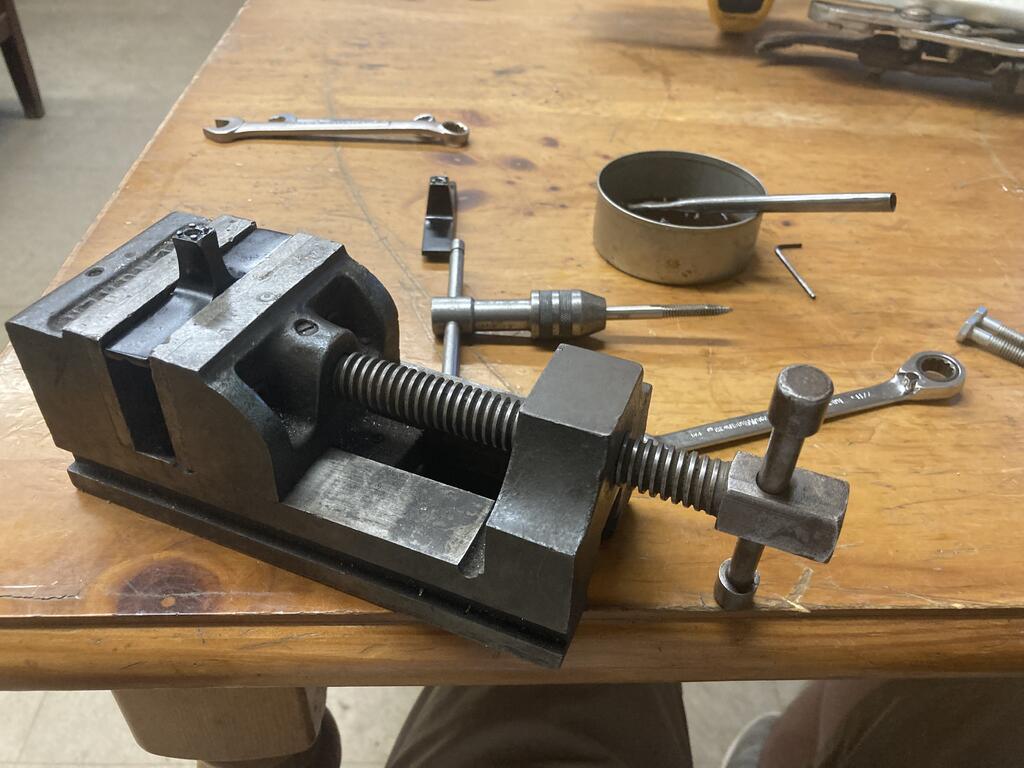

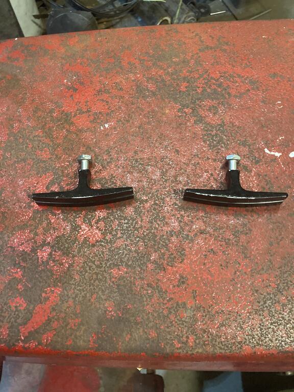

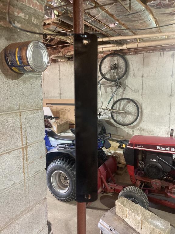

MainelyWheelhorse 3,170 #24236 Posted August 7, 2025 Today like I said the plan for today was yesterday, progress was made. I took @Handy Dons and @953 nuts advice and built a brace for the exhaust on the C-141. I also drilled and tapped the Throttle and Choke handles to 1/4-20. All that has to be done now, is cutting the heads off the bolts and welding them to the levers. Definitely a job for tomorrow. 2 4 Share this post Link to post Share on other sites

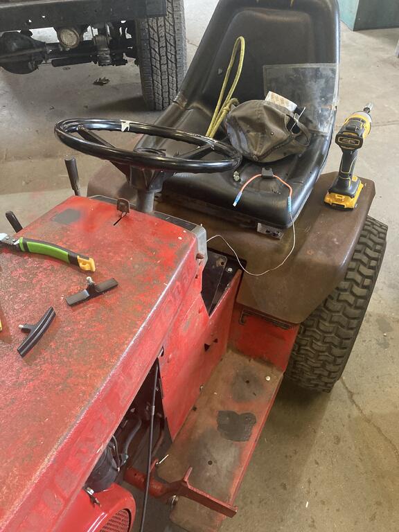

MainelyWheelhorse 3,170 #24241 Posted August 7, 2025 Today started off with cutting the bolt heads off the Throttle and Choke bolts to be welded to the levers. Then, it was wiring the headlights in up to the connector from the switch to the two headlights. After that it was painting the battery hold down strap then doing a color change on the Wheel Horse tire for the hat project. It’s been busy today. 2 Share this post Link to post Share on other sites

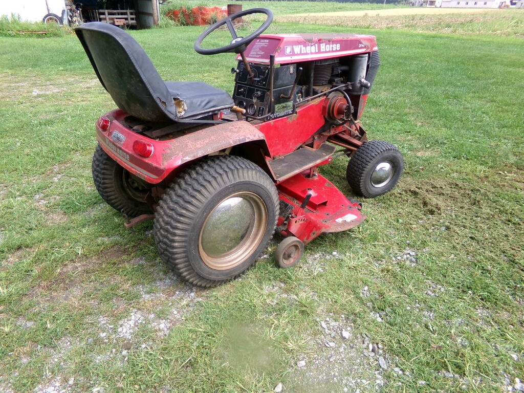

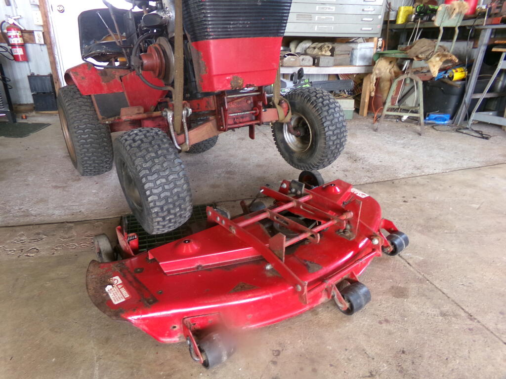

Ed Kennell 47,750 #24242 Posted August 7, 2025 Put the deck on the 314A project made a test run. She's not purdy, but she starts, runs, drives, and mows.- 6 4 Share this post Link to post Share on other sites

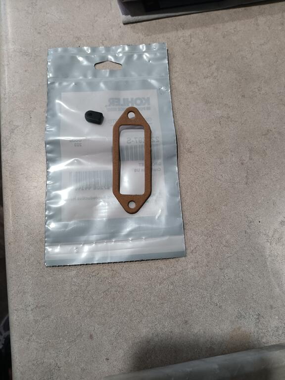

adsm08 5,231 #24243 Posted August 7, 2025 Drove it across the garage and found out why the points cover has a gasket. On a totally unrelated note, what's a good source for a points cover gasket for a K181? 1 Share this post Link to post Share on other sites

ebinmaine 81,047 #24246 Posted August 7, 2025 12 minutes ago, adsm08 said: Drove it across the garage and found out why the points cover has a gasket. On a totally unrelated note, Really?? Not related? Like at all? 13 minutes ago, adsm08 said: what's a good source for a points cover gasket for a K181? Got a measurement? Mebbe I got one here... Share this post Link to post Share on other sites
adsm08 5,231 #24247 Posted August 7, 2025 6 minutes ago, ebinmaine said: Really?? Not related? Like at all? Well.... maybe a little. I wasn't thinking about it and left the cover off when I moved it. The gasket came out in two pieces the other day when I removed the cover to check the points. And I do not have measurements. 1 Share this post Link to post Share on other sites
ebinmaine 81,047 #24248 Posted August 7, 2025 3 minutes ago, adsm08 said: Well.... maybe a little. I wasn't thinking about it and left the cover off when I moved it. The gasket came out in two pieces the other day when I removed the cover to check the points. And I do not have measurements. PM me wit' yer mailin's address. I'll send these. 1 3 Share this post Link to post Share on other sites
