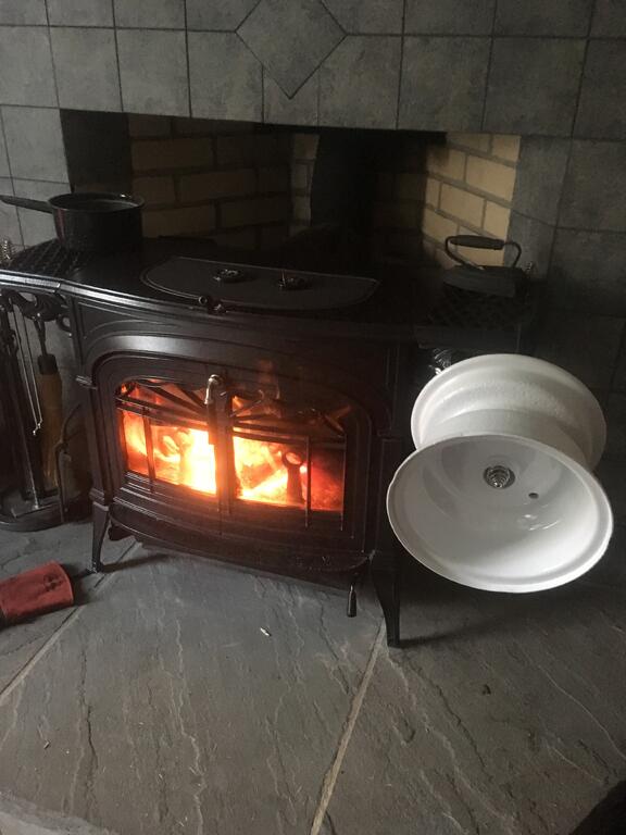

c-series don 12,363 #23883 Posted June 10, 2025 @Ed Kennell you mean like this Ed? 5 3 3 Share this post Link to post Share on other sites
Ed Kennell 47,004 #23884 Posted June 10, 2025 2 minutes ago, c-series don said: @Ed Kennell you mean like this Ed? Yep, I don't understand why they don't appreciate that sweet intoxicating aroma drifting thru the house. 1 5 Share this post Link to post Share on other sites

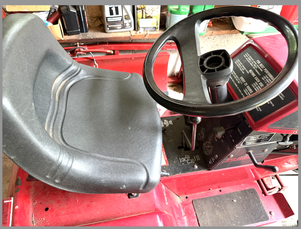

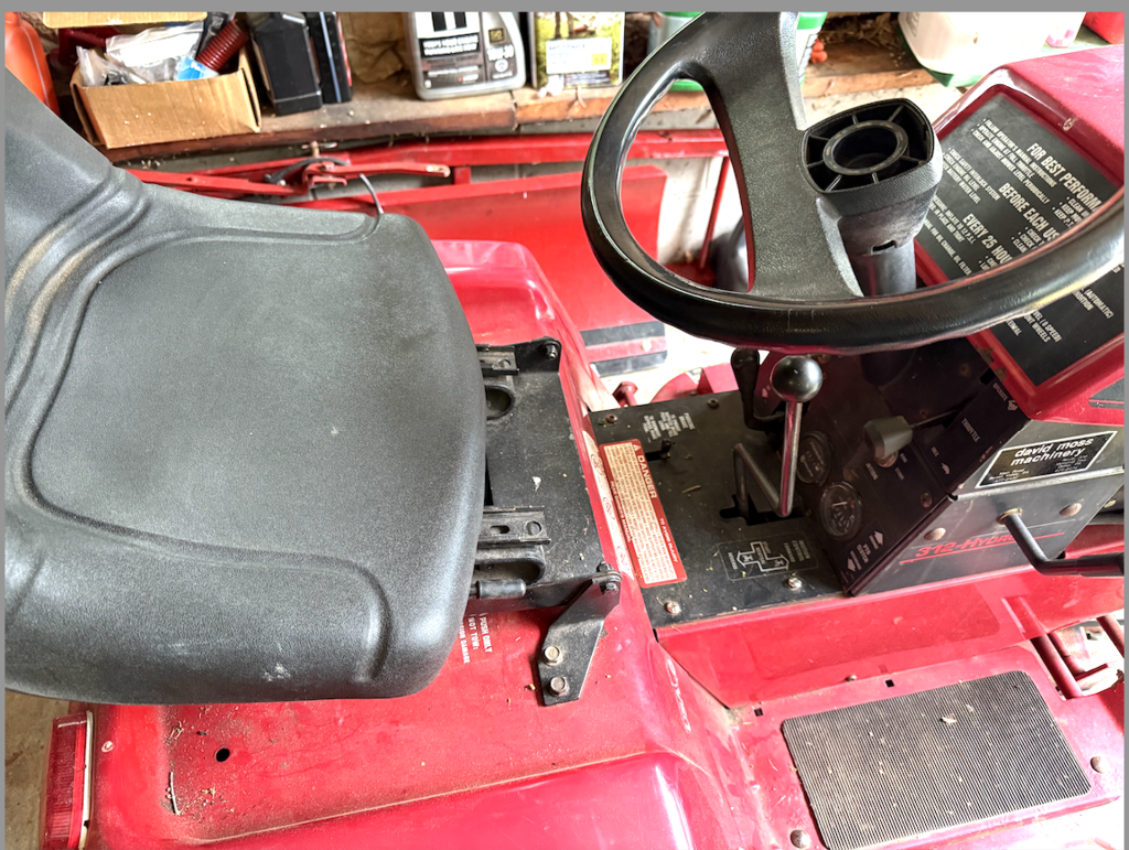

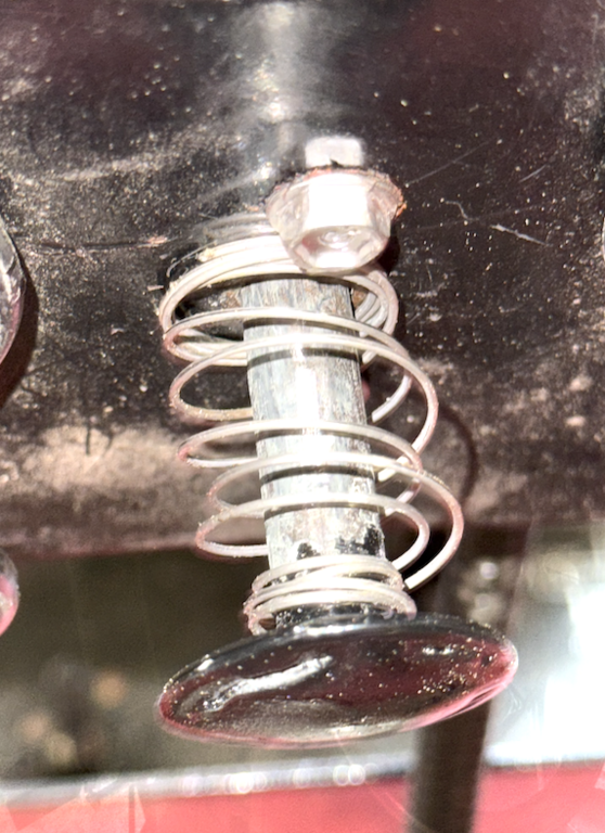

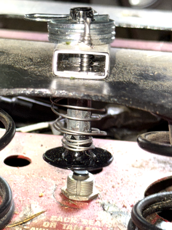

Handy Don 17,316 #23896 Posted June 10, 2025 (edited) Not sure I ever posted the addition of Simplicity sliding seat rails to our 312-H and 518-H++. The WH rails had a paltry 2.5” of travel. These have 6”. These pics show the fore and aft range on the 312-H. This has made it much safer for operators from 5’0” to 6’2” to conveniently reach the brake and controls. The last part of the seat upgrades was to make the seat safety switch properly handle a 100 lb operator (shutting down the tractor when they dismount but not every time they lean forward to get better leverage on a turn). This required a longer, shallow-topped plunger for activating the switch, a piece of rectangular tubing to keep it aligned, and a spring with sufficient strength but minimal compressed length. The washers on top allow for adjusting the “engagement height” (more washers=more weigh needed to engage). Importantly, big springs on the seat frame fully compress under a 175 lb operator leaving only about an inch between the seat frame and the switch collar so the plunger/spring combo must compress to less than that to avoid breaking the switch but still be long and strong enough to “click the switch” with only 100 lbs in the seat. The final step will be to replace the temporary self-tapping screws with some small bolts and nuts. (And yes, I know that newer seats have internal safety switches!) Edited June 10, 2025 by Handy Don 4 Share this post Link to post Share on other sites

Wayne0 1,624 #23899 Posted June 10, 2025 3 hours ago, c-series don said: @Ed Kennell you mean like this Ed? Nice stove BTW! Resolute? 1 Share this post Link to post Share on other sites
JCM 11,399 #23900 Posted June 10, 2025 Vermont Castings Defiant Encore @c-series don 1 Share this post Link to post Share on other sites
