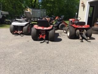

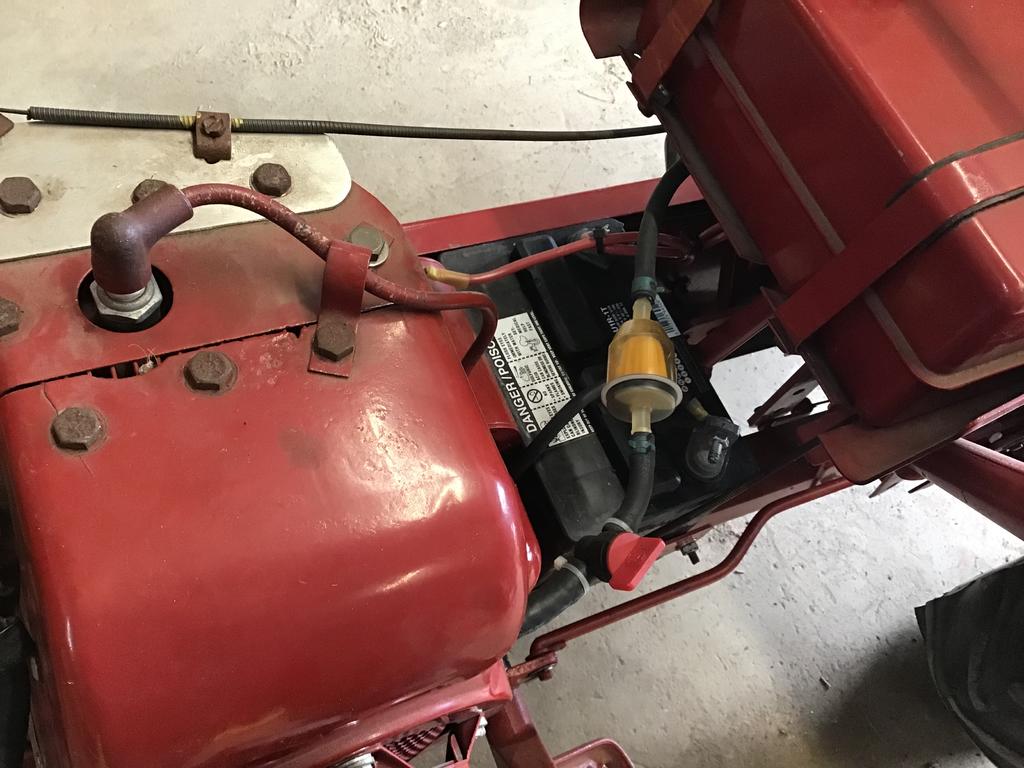

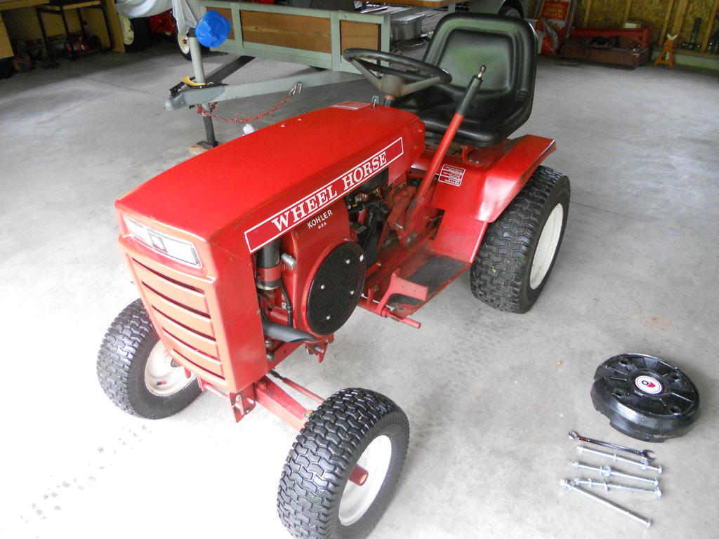

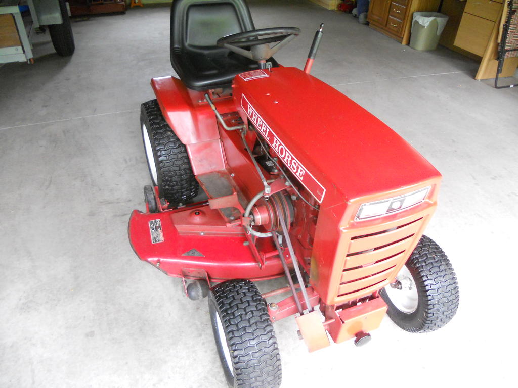

Racinbob 13,213 #2301 Posted May 17, 2019 Had a little fuel issue on my B-160. Turns out it was something in the line. It sat for a spell disconnected last summer as it waited for the fresh engine and I'm guessing that caused it. She purrs like a kitten again. Removed the weights for the summer and put the deck on. I put the 48" deck on the 2005 since it's my main mower and the 42" went on this one. Greased everything up and I'm good to go. Well, almost. I just ordered a new ignition switch. The original works fine but is so worn the key won't stay in. 7 5 Share this post Link to post Share on other sites

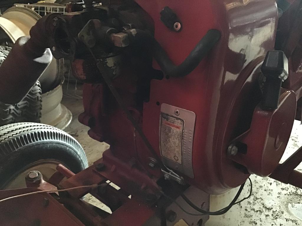

adsm08 5,194 #2303 Posted May 17, 2019 (edited) New muffler, and adjusted the governor that I knocked loose getting the old one off. Next up, is probably a bath. Edited May 17, 2019 by adsm08 3 Share this post Link to post Share on other sites

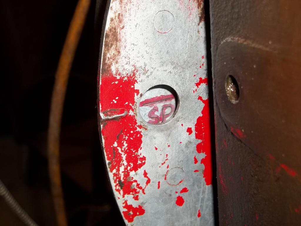

pfrederi 21,217 #2305 Posted May 17, 2019 (edited) Gave my towing/backup chore tractor a tune up. 310-8 with 10 pinion differential and ags. She has gotten lot of work as it is to soggy to use the big tractors. Spent a fair amount of time cursing the Kohler employee who stamped the timing marks on flywheels. I think he had a second job as the before model in Charles Atlas ads. Just once I would like to be able to find the marks with out having to pull the shroud (and coil and throttle linkage etc) get a wire brush to clean the wheel enough to find them then paint them then reassemble. Just getting all the little bolts holding it on aligned and started is a real pain. All of which takes a lot longer than actually adjusting the timing.... Edited May 17, 2019 by pfrederi 8 1 Share this post Link to post Share on other sites
953 nut 69,793 #2306 Posted May 17, 2019 55 minutes ago, pfrederi said: Spent a fair amount of time cursing the Kohler employee who stamped the timing marks on flywheels. I think he had a second job as the before model in Charles Atlas ads. A little notch on the flywheel would have been much too hard to do! If it was one of the older S/G model you would have had to pull the flywheel too. 3 Share this post Link to post Share on other sites

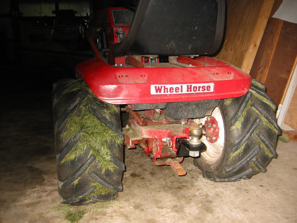

chip61 666 #2307 Posted May 18, 2019 Moved the trailer hitch from my hydro tractor to the 314-8. I hate backing a trailer with the hydro. 2 Share this post Link to post Share on other sites

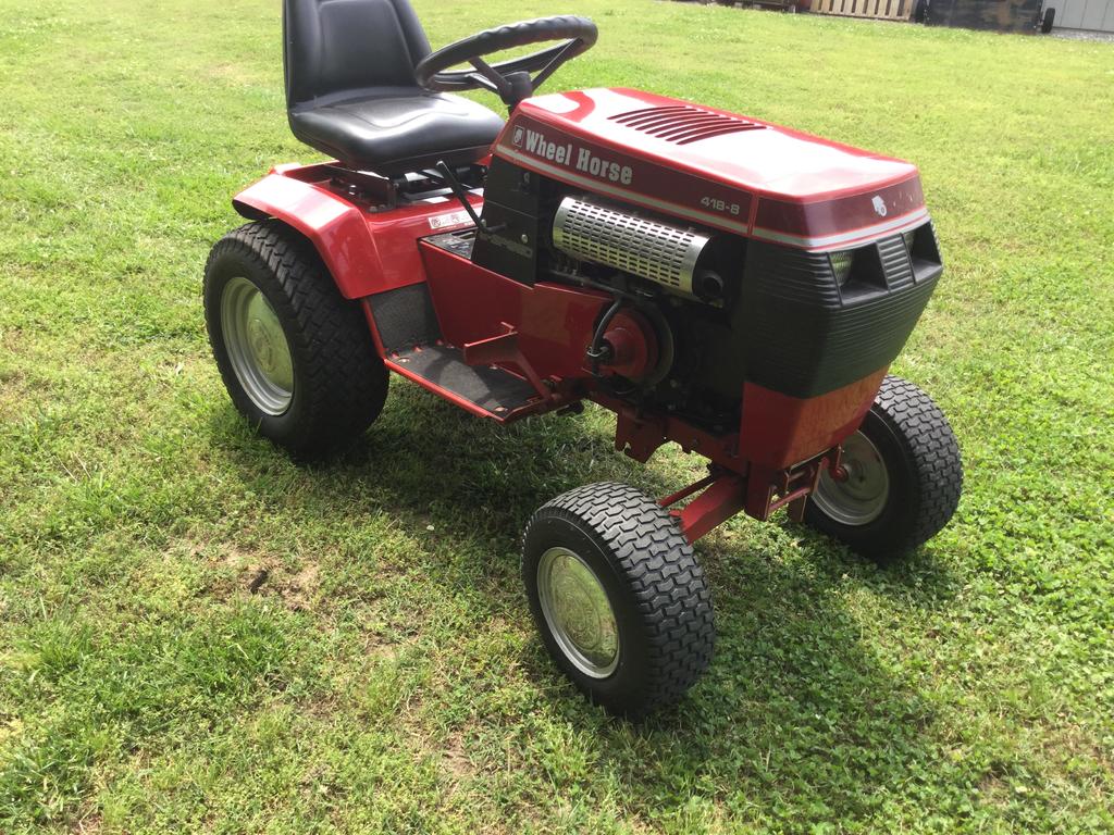

richmondred01 2,393 #2308 Posted May 18, 2019 (edited) Swapping the Ag tires for turf tires on the 418-8 and cleaning it up preparing to sell her. Hate to let such a low production rare model go but, I’m down sizing to just one wheel horse and one IH cadet. I will most likely regret it because they are harder to find for me then the 520-8 but......got to put the big boy pants on and say good by. Edited May 18, 2019 by richmondred01 4 1 2 Share this post Link to post Share on other sites

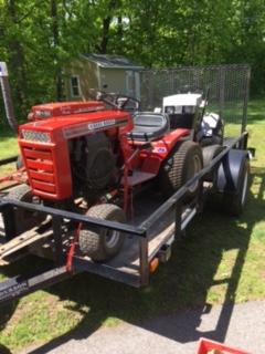

TonyToro 1,190 #2309 Posted May 18, 2019 Getting the herd ready for the first pull of the season. 4 Share this post Link to post Share on other sites
Daron1965 644 #2310 Posted May 18, 2019 18 minutes ago, TonyToro said: Getting the herd ready for the first pull of the season. Good Luck. Remember to post pics of the horses in action. 1 Share this post Link to post Share on other sites

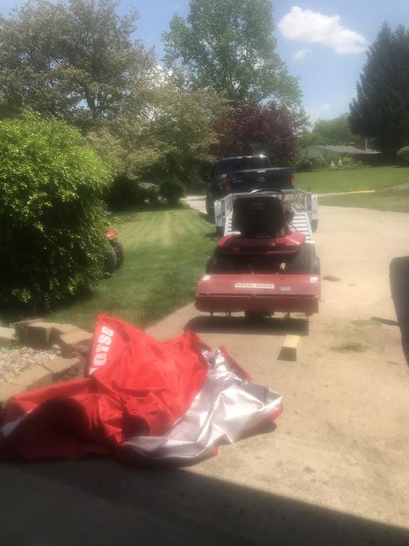

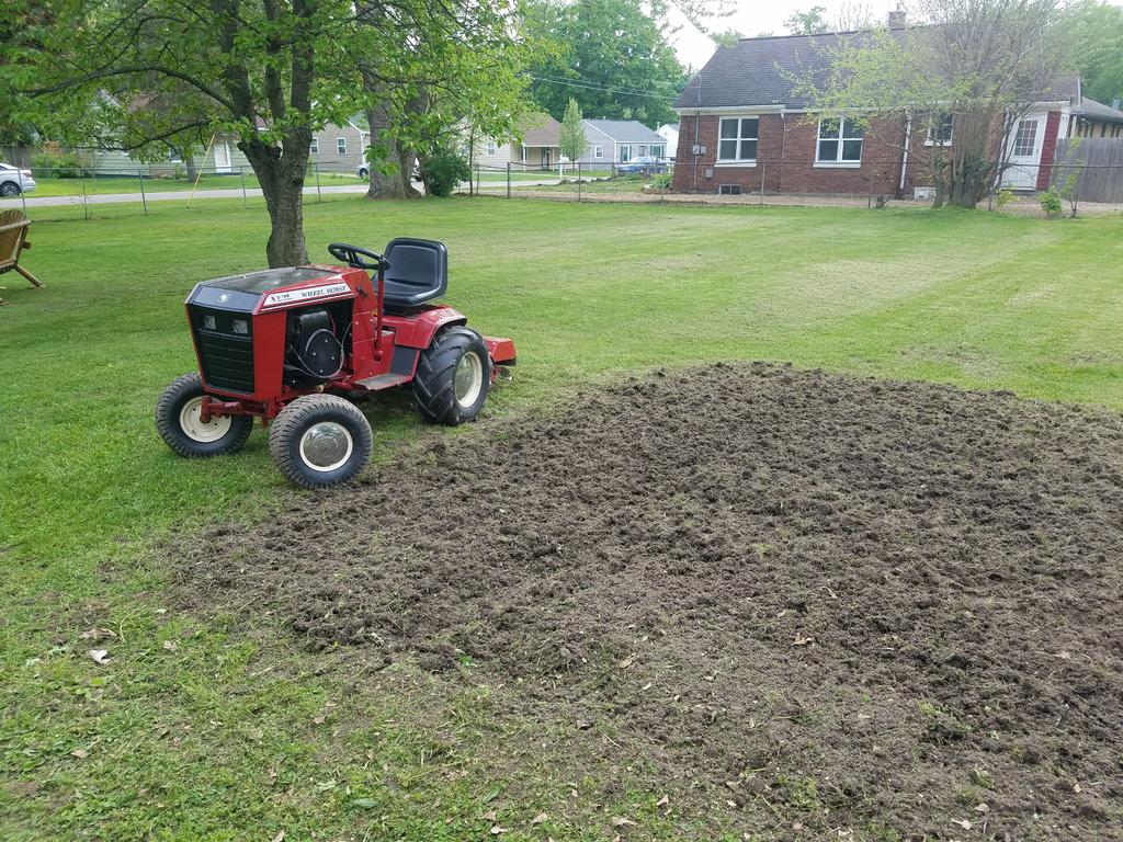

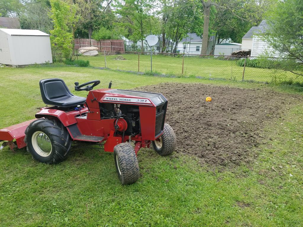

bds1984 1,519 #2311 Posted May 19, 2019 I finally got to use the rototiller I inherited from my grandfather for the first time today with my C165 at my first house I bought. The K341 purred along without breaking a sweat! 3 5 Share this post Link to post Share on other sites

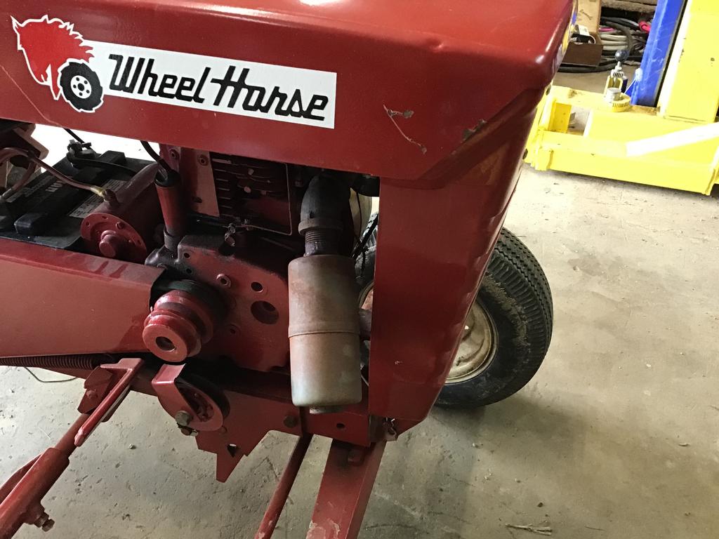

Pullstart 71,360 #2320 Posted May 21, 2019 Fixed the exhaust on the Commando 6 so it won’t hit the hood, tightened up the super loose backing plate for the engine shroud and borrowed Frank’s battery for a bit. This baby starts and purrs! Oh, I also put a functional choke cable and new fuel line on to fix the small amount of seepage under the tank. Next order of business is fitting an air cleaner! 5 Share this post Link to post Share on other sites

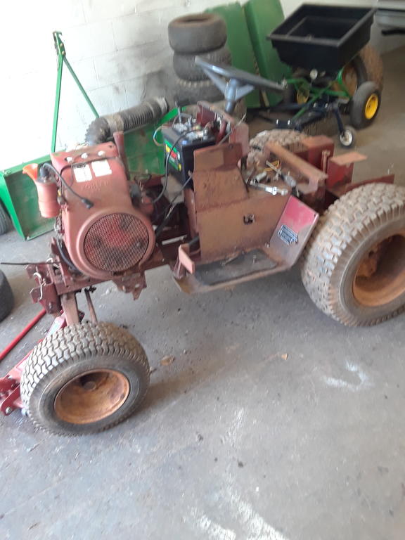

Goldann520 242 #2321 Posted May 21, 2019 (edited) Part 3, "the bomb" well I'm back again after another 8 mo. Hiatus. Sold out all my wh and green stuff over the winter. Had nothing to play with so picked up this c 161 automatic for not much. Was outside for 10 years probably. Hood pitted so bad would need bondo to fix it. Flywheel cover rotted out at bottom, every nut and bolt stuck, you know, FUN! No compression so pulled head and exhaust valve was stuck and intake valve was bent! No bolt marks on head like I've seen a lot of from air cleaner assembly bolts. Any ideas on how it got bent would be appreciated. Valve guide and head fine. Hello to all again, Terry Edited May 21, 2019 by Goldann520 4 Share this post Link to post Share on other sites
Goldann520 242 #2322 Posted May 22, 2019 Sorry, didn't mean to bust in on your topic. Im rusty like this tractor 😆 1 Share this post Link to post Share on other sites
Pullstart 71,360 #2323 Posted May 22, 2019 4 minutes ago, Goldann520 said: Sorry, didn't mean to bust in on your topic. Im rusty like this tractor 😆 This is a perfect place to update, unless you want to start a build thread! Welcome back! 3 Share this post Link to post Share on other sites
PeacemakerJack 11,068 #2324 Posted May 22, 2019 Welcome Back Terry! You picked the perfect spot to reconnect with the forum. If you are going to do a refurbish/resto on this tractor—open a thread in restorations and I’ll follow along. Looks like a fun tractor to bring back to life... 2 Share this post Link to post Share on other sites
Goldann520 242 #2325 Posted May 22, 2019 @PeacemakerJack ya they're quite desirable down Charlotte way here. Have had a few people asking to find these. I like it cause its only 2 years made, hydraulic lift (i dont do lift handles anymore), 16 hp, kohler, old style hood and dash, it was complete, whats not to like. The tricks gonna be doing all this work on the cheap. 😀 it needs a lot. So far ive had parts in stock. Got the intake valve, had the starter solenoid it needed. And came with a solid 42 deck. 4 Share this post Link to post Share on other sites
