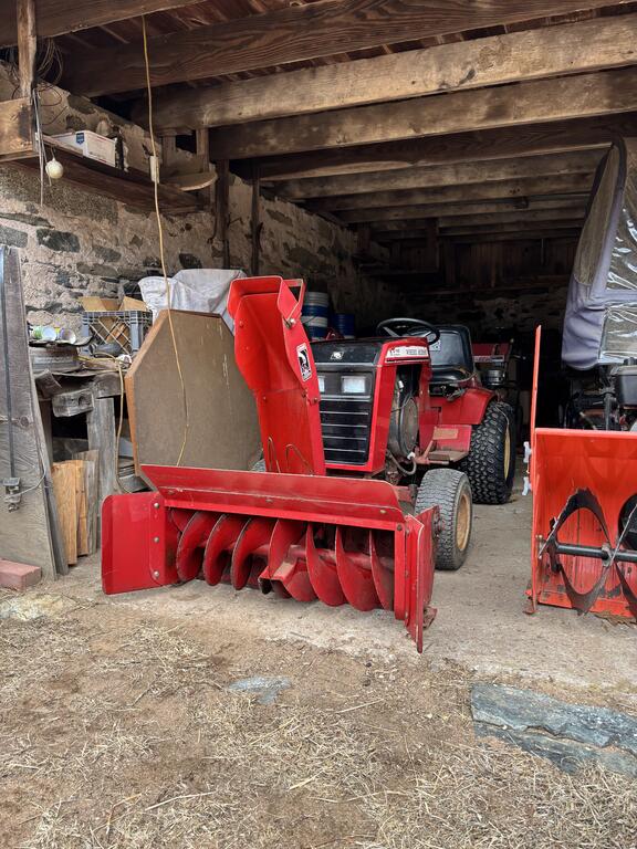

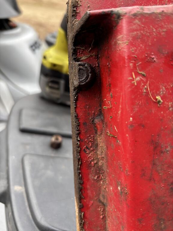

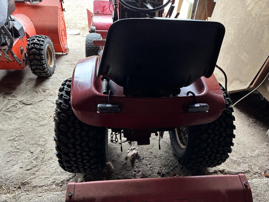

TonyToro Jr. 2,523 #22776 Posted January 18, 2025 Between 5-10” of snow tommorow into Monday morning, this week got the c-145 mechanically ready. Replaced the belt, hydro fluid, hydro filter, pto bell and bearing got fully greased. And got some new tires for it. Also flipped the scraper blade on the 48” plow on my C-121(Which really needed it just see the picture ). Then today hooked the blower to the C-145. Lubed that. Fueled up. Then C-121 fired it up sprayed the blade as well as the blower with silicone lubricant. Fueled that up. And we are ready! Bring it on snow! We will see what we get. 4 10 Share this post Link to post Share on other sites
SylvanLakeWH 32,152 #22777 Posted January 18, 2025 @TonyToro Jr. that wear bar is just flesh wound... Sounds like you are ready to go!!! 3 Share this post Link to post Share on other sites
TonyToro Jr. 2,523 #22778 Posted January 18, 2025 19 minutes ago, SylvanLakeWH said: @TonyToro Jr. that wear bar is just flesh wound... Sounds like you are ready to go!!! 😂 As ready as I will ever be!! 1 Share this post Link to post Share on other sites

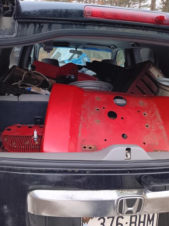

MainelyWheelhorse 3,044 #22779 Posted January 19, 2025 (edited) Today, after work, I’m waiting on parts for the engine project. So, I installed the 312 gas tank I got from @ebinmaine on my 308. As any of you who deal with the 300/400/500 series know it was a plug and play deal, and looks like it belongs there. Now just to plumb it. Edited January 19, 2025 by MainelyWheelhorse 3 2 Share this post Link to post Share on other sites

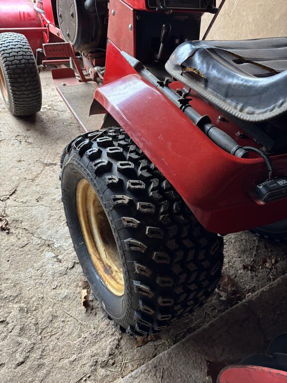

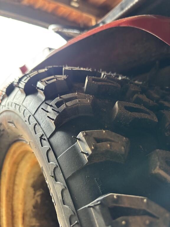

Bill D 3,101 #22783 Posted January 19, 2025 3 hours ago, TonyToro Jr. said: Between 5-10” of snow tommorow into Monday morning, this week got the c-145 mechanically ready. Replaced the belt, hydro fluid, hydro filter, pto bell and bearing got fully greased. And got some new tires for it. Also flipped the scraper blade on the 48” plow on my C-121(Which really needed it just see the picture ). Then today hooked the blower to the C-145. Lubed that. Fueled up. Then C-121 fired it up sprayed the blade as well as the blower with silicone lubricant. Fueled that up. And we are ready! Bring it on snow! We will see what we get. Excellent. I like those tires. Who makes them and where did you buy them 1 Share this post Link to post Share on other sites
TonyToro Jr. 2,523 #22784 Posted January 19, 2025 Just now, Bill D said: Excellent. I like those tires. Who makes them and where did you buy them They are made by WANDA 23/10.5/12. Right from Scamazon. $150 for both.https://www.amazon.com/WANDA-23X10-5-12-Tires-23x10-5x12-2-10143/dp/B0C1DGQH5V/ref=sr_1_1?crid=2KGXPCAJX09I3&dib=eyJ2IjoiMSJ9.iXj-XQWKBF6j5_Fc8Ghu6IQbudnKHN61tMl8AfxaqtDpfkY2js9zGtKex1fQ3Tv78tfbwWbqdYus6wvgzaWxL4MKjF1u3nLq9UhgtvK3F4Xfw2DluPvywlW9uGsIzP5MNaLe671tsOlAB57eDNTAbx9XVpfUNwYW7u_DiyDzYOcPCJLzZyy7vHPYoo6XBegXYVTE4Zn7WFsUnvZXJkcMY0UWtiBz8B3mati6UY-_j5FAUs3lqttZrhTxM52T-LnYM5biNrCzUI1QnZ6DgmeJvmmF2N0jPuFd7HWQljXnBl8.1o0Qn1FuFSsA2flcf5chSfvugrfJJYmu5538uN4pyZ0&dib_tag=se&keywords=Wanda+22%2F10.5%2F12+tires&qid=1737249186&sprefix=wanda+22%2F10.5%2F12+tores%2Caps%2C86&sr=8-1 2 Share this post Link to post Share on other sites
