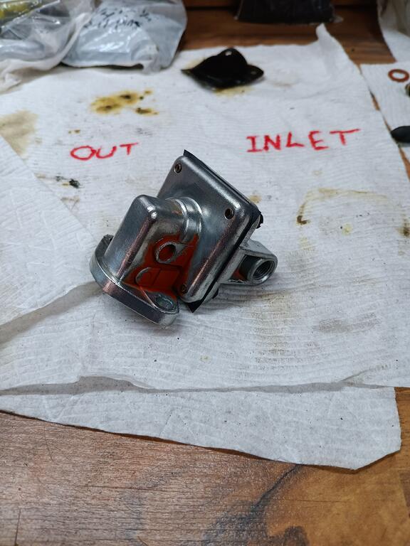

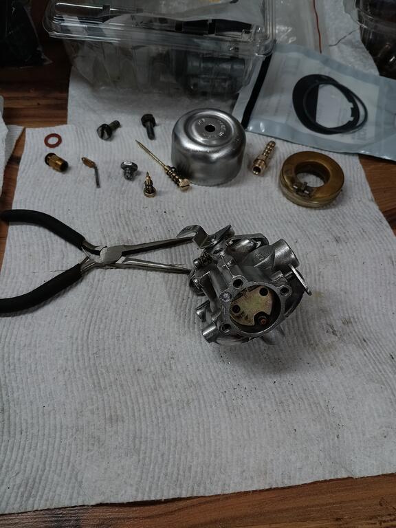

ebinmaine 81,282 #22214 Posted October 27, 2024 Two more carbs headed to their owners tomorrow. This one's off a Kohler 8 HP. Also got into the fuel pump for it. Disassemble. Clean out. Reassembly with new diaphragm. 2 11 2 Share this post Link to post Share on other sites

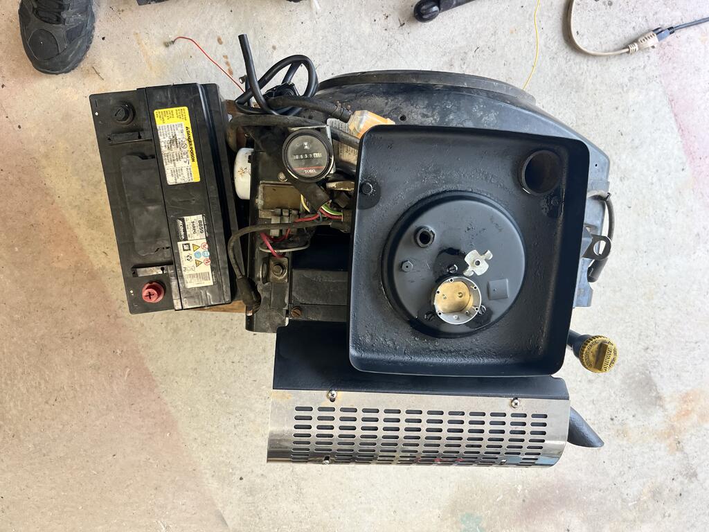

WNYPCRepair 1,924 #22215 Posted October 27, 2024 I finished putting this Onan P220 back together. It came out of my 520H, and had a slight surge. I bought a NOS Onan from a guy here and swapped them back in 2010. I bought a new hour meter for the new engine and stored the old one with the old engine. It has 537 hours on it. Now that I’m retired, I decided to get the old one running. New fuel pump, filter and carb and it runs nice and smooth. Now to decide if I want to sell it or use it to build a generator. I have a 10K generator head from Harbor Freight. Then I dig into a generator that was in my Mother In Law’s garage. We were cleaning her house out to sell it after she passed a year ago. I had fuel to the carb but nothing in the bowl. Took the carb off and it was full of varnish. I had to scrape it out of the bowl with a screwdriver. The needle valve was glued in from the varnish. It’s way past being old gas. Lol. Cleaned it all up and put it back together and it purrs like a kitten. I’m going to offer it to my brother. He lost power for a week from the hurricane in E TN and NC. Now I’m wondering what to tinker with next. IMG_5273.MOV IMG_5271.MOV 8 1 Share this post Link to post Share on other sites

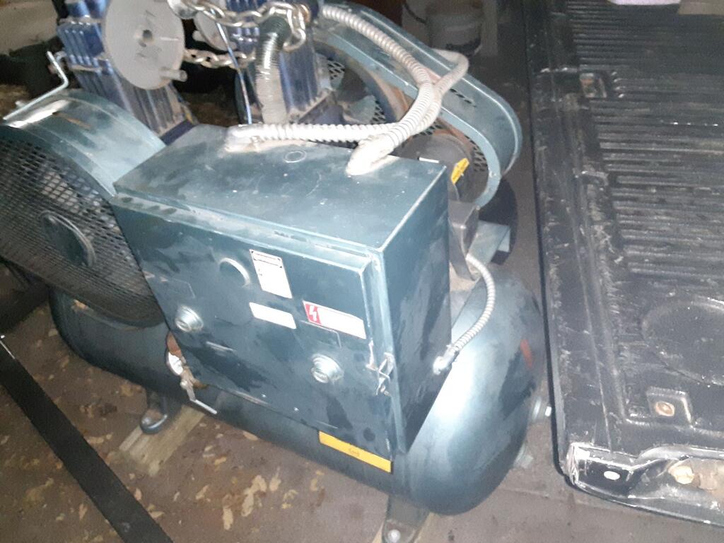

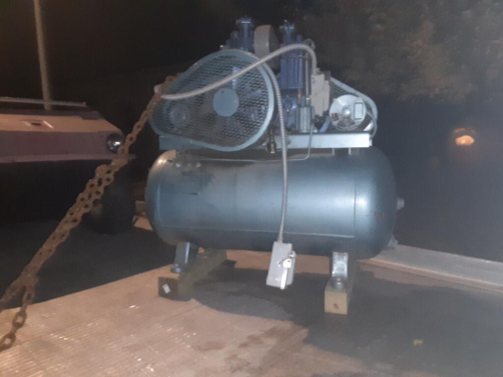

BBQVultureWings 160 #22216 Posted October 27, 2024 Yesterday the New to Moo-Wah C-145 had a flat. This wouldn't even be worth mentioning but today I had help from a friend ( who had a limitted amount of time ) & he was on his way over. So I needed to Move the C=145 out of the way so I couold get the engine hoist to the back of my truck to Unload My New to Moo-Wah Quincy Air Compressor I got for a Smokin' Deal So the shop is getting a Very Nice new Air Compressor. I will probably be able to do Some Light sandblasting with this set up as it is a Double Pumper. Check the Pictures. I coud NOT pass the deal on this thing. Anyway having better equipment always gives the enthusiasm a boost... for Moo-Wah anyway. Got the Beast out of the truck Now to get it into its new forevever home. The guy I got it from was really intimidated by the contents of the electrical enclosure so he let it go for $1.00 over his winning bid at the auction. It's a 3 phase unit but not to worry I did this for a living for 25+ years so nothing I can't conquer..... Woo Hoo Yayyyyy Moo-Wah!!! I am super stoked to get this going & then it can be Wheel Horse fun time.After un loading the beast last night, I sat down for a smoke n a coke & was looking at the Wheel Horses...... I decided to name the C-145 "Cyclops" as it came to me missing an eye. That will get fixed but I thiMk the name is gonna stick. I am running out of daylight so I better get moving here ... More later 2 3 Share this post Link to post Share on other sites

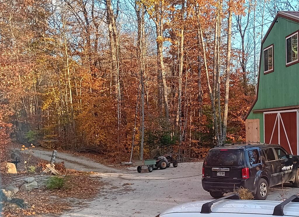

ebinmaine 81,282 #22217 Posted October 27, 2024 A year or three ago Trina bought a frame for a portable garage from our local Mennonite car repair shop. It was down by the garden because she was thinking about using it as a greenhouse. That idea has been dropped. Not practical for us at this time. This afternoon she and the momma started getting it set up so we can move the "future projects and parts pile" to a better location. They used the Pigpen 867 and Ohio Steel trailer to haul the pipes around. 8 1 Share this post Link to post Share on other sites
