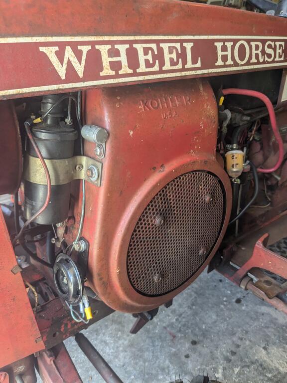

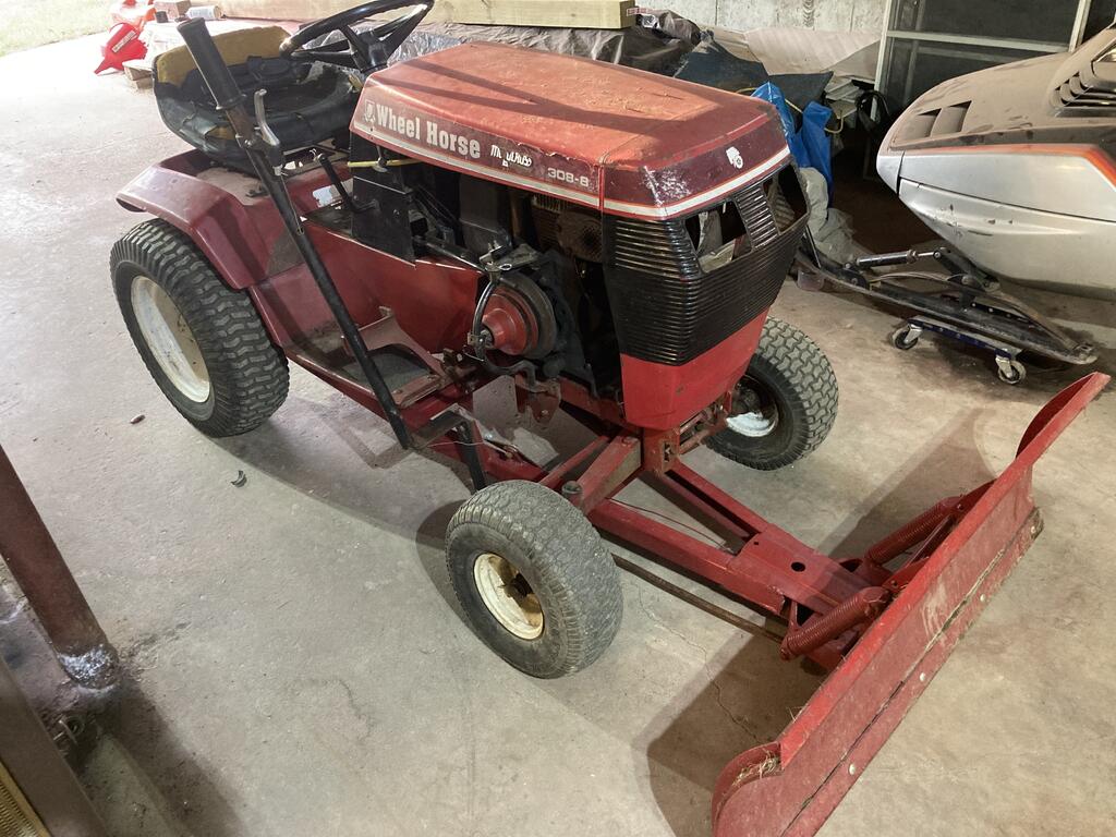

MainelyWheelhorse 3,145 #22077 Posted October 1, 2024 Today, I got my plow put on this pig, and swapped the right front tire as the one I swapped to, had a medium air leak. It gave you just enough time to start something then it goes flat. Besides that I’ve been running it steady to clean it out and the start issue seems to be a safety switch issue as you jiggle the PTO and it starts. Unfortunately, the rust that welds bolts and screws into their holes has been an issue. the two spots for safety switches have seized bolts over them but that’s tomorrow’s project. On a side note, I’ve become a big fan of Kohler after having my two tractors. 1 4 Share this post Link to post Share on other sites
ebinmaine 80,867 #22078 Posted October 1, 2024 1 hour ago, MainelyWheelhorse said: On a side note, I’ve become a big fan of Kohler after having my two tractors. Glad to hear!! That'll only get better as you work them. 1 1 Share this post Link to post Share on other sites

kpinnc 19,002 #22080 Posted October 2, 2024 4 hours ago, MainelyWheelhorse said: I’ve become a big fan of Kohler Just keep them full of clean oil, and they run forever. Good to see you’re enjoying that tractor. Welcome to the sickness! 2 1 Share this post Link to post Share on other sites

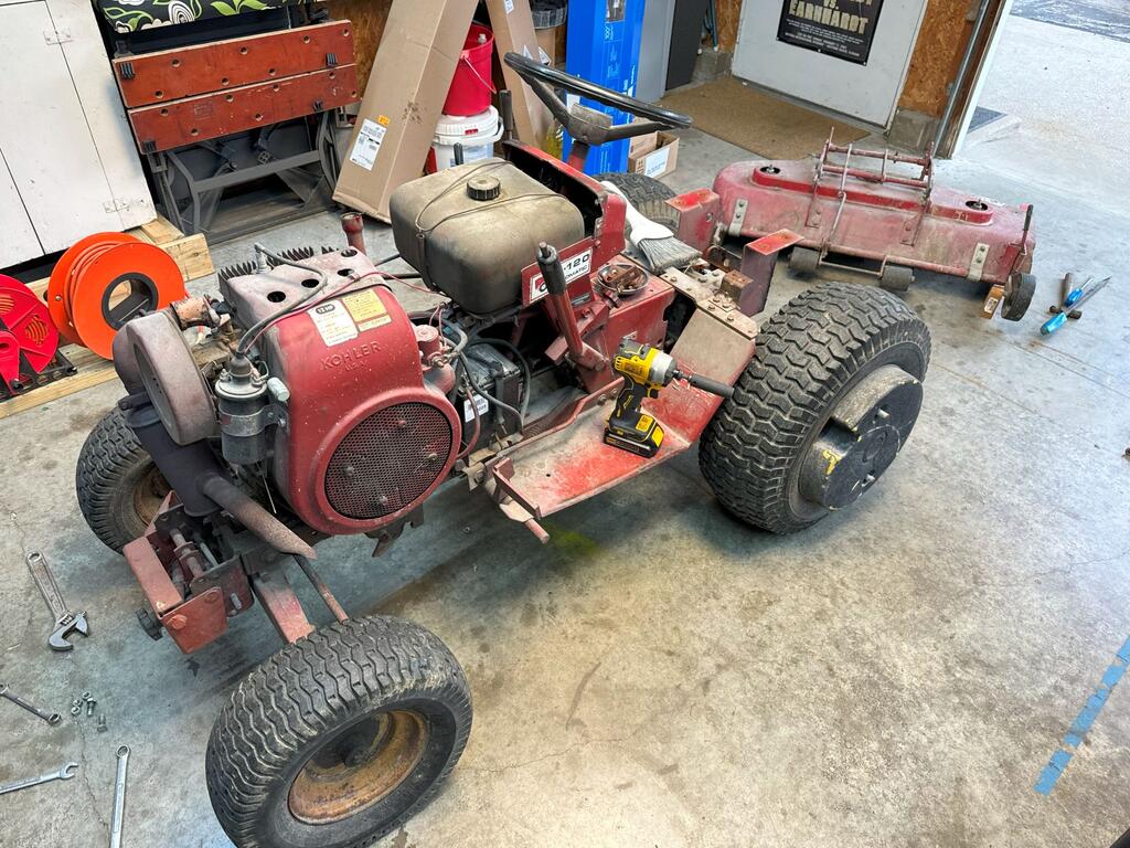

Bar Nuthin 3,339 #22083 Posted October 2, 2024 Just starting on my first Wheel Horse, a 1976 C-120 Automatic. I need to do better with focusing on one thing at a time. Today... Picked up used mower deck for $25 for potential donor parts. Pleasantly surprised to find it had like new blades on it! Replaced air filter Changed engine oil Changed hydraulic oil and filter Replaced an incorrect ignition switch and replaced a bunch of incorrect wiring. Shocked to find that everything worked, including the ammeter! Reinstalled fuel tank and test started Discovered that the outer PTO bearing was shot. Ordered one from NAPA 5 6 Share this post Link to post Share on other sites
