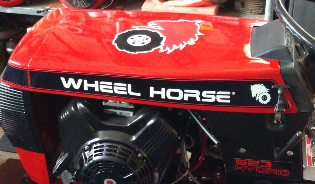

ebinmaine 80,878 #20926 Posted March 3, 2024 On 2/29/2024 at 7:14 PM, kpinnc said: Added a big sticker on the 523-H hood. Tried to talk the wife into putting one on her truck window, but she said "no thank you". ...Or might have been "I'll kill you"? I wasn't really paying attention. 1 hour ago, c-series don said: I snuck this Wheel Horse sticker on my wife’s Explorer and she wasn’t happy. She left it on for probably a year until one day I noticed it was gone. This year at the big show I’m going to buy several so I can put one on her car and then when she removes it another one will magically appear!! When BBT got her Pilot about a year ago I mentioned something about having a decal on it. Denied. Then a few months later @Sparky had a spare. THAT one was acceptable. 🤔 😅 5 1 Share this post Link to post Share on other sites

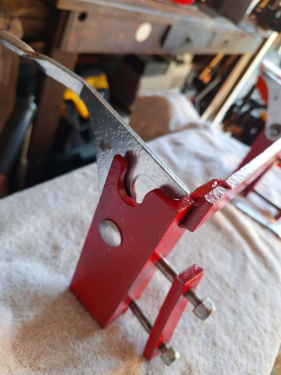

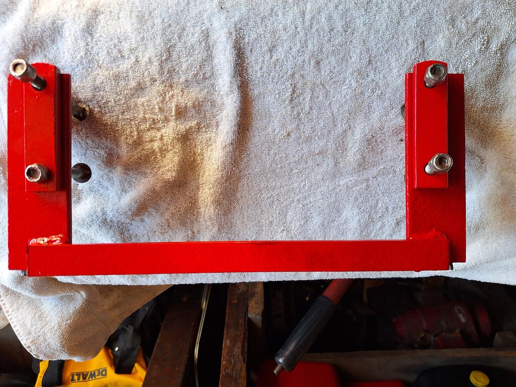

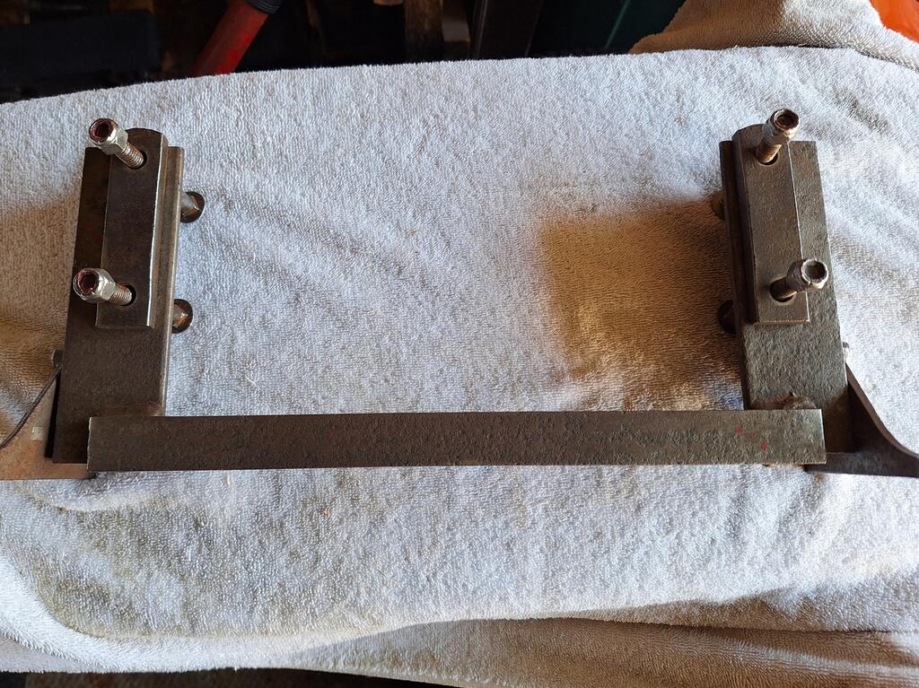

D_Mac 9,339 #20929 Posted March 4, 2024 (edited) Finished with the rear axle hitch. Stripped it all down and painted it. Silly question. This was on the 856 when I got it. I want to put it on the 310-8. Is it going to fit ? The 310 is buried in the back of the garage, I can't see the rear end. Before I go digging it out maybe I should ask. If not I will put it back on the 856. Edited March 4, 2024 by D_Mac 6 3 Share this post Link to post Share on other sites
Ed Kennell 47,552 #20930 Posted March 4, 2024 23 minutes ago, D_Mac said: I want to put it on the 310-8. Is it going to fit I think it will fit, but this old style with the rod notches in front of the axle will move the plow frame forward a couple inches. Your lift link may also be angled forward. 2 1 1 Share this post Link to post Share on other sites
Racinbob 13,210 #20931 Posted March 4, 2024 Let us know @D_Mac. The frame on the newer plows mount to the outside while the older frames mount to the inside. I don't know if it will work without mods but I'd like to know. 1 1 Share this post Link to post Share on other sites

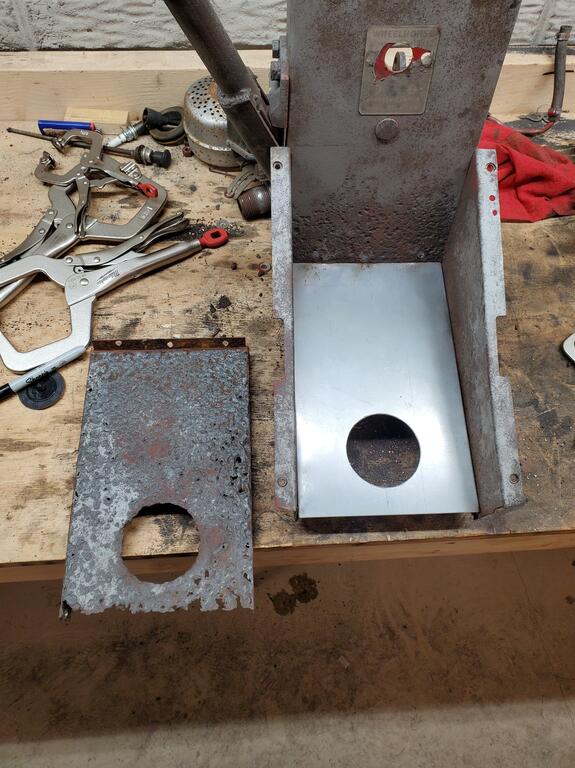

Cody 285 #20944 Posted March 6, 2024 Got time tonight to work on a 702 project I've been working on. It was in rough shape and needed one of everything but needed to be saved. Originally it was a 502 but its getting a 702 conversion. Anyway here's some small progress, drilled out the spot welds for the bottom if the rotted out dash and bent up a new peice out of 16ga. 2 9 Share this post Link to post Share on other sites
ebinmaine 80,878 #20945 Posted March 6, 2024 6 hours ago, Cody said: Got time tonight to work on a 702 project I've been working on. It was in rough shape and needed one of everything but needed to be saved. Originally it was a 502 but its getting a 702 conversion. Anyway here's some small progress, drilled out the spot welds for the bottom if the rotted out dash and bent up a new peice out of 16ga. Nice work on that! Do you have separate threads for your projects? I make a different one for every project for my own future documentation. Feel free to do so. 2 Share this post Link to post Share on other sites
