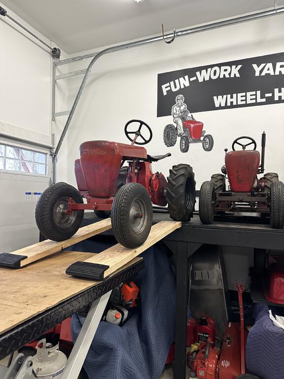

Pullstart 71,145 #20451 Posted December 19, 2023 5 minutes ago, ebinmaine said: BBT popped a tire and was mid task so she borrowed one from Millie. Did anyone ask Millie if she’d mind? 5 Share this post Link to post Share on other sites
ebinmaine 80,448 #20452 Posted December 19, 2023 2 minutes ago, Pullstart said: Did anyone ask Millie if she’d mind? Oh I'm sure it was fine. Millie likes being very helpful. 1 3 Share this post Link to post Share on other sites

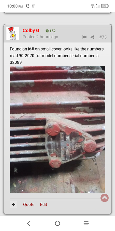

Colby G 248 #20453 Posted December 20, 2023 (edited) I found a tag on my hydro with a model and serial number on it. I don't know how to decide the numbers to tell what tractor it came off of tho. If someone knows anything about what tractor this hydro transmission comes off of, please tell me. All I know is that it's a sunstrand and it has a double d shaft off the hydro pump. The model number is 90-2070 Edited December 20, 2023 by Colby G Share this post Link to post Share on other sites
Ed Kennell 47,094 #20454 Posted December 20, 2023 GT-14 Transaxle Questions and Hello - Transmissions and transaxles - RedSquare Wheel Horse Forum Read the first post. Share this post Link to post Share on other sites
Colby G 248 #20455 Posted December 20, 2023 (edited) 12 minutes ago, Ed Kennell said: GT-14 Transaxle Questions and Hello - Transmissions and transaxles - RedSquare Wheel Horse Forum Read the first post. Way ahead of you, during my reaserch I came across that post. But i didn't know for sure if it was a gt-14 or not, I wanted others opinion on the matter, and if the pulley posted earlier in the conversation would fit it. Edited December 20, 2023 by Colby G Share this post Link to post Share on other sites
Ed Kennell 47,094 #20456 Posted December 20, 2023 1 minute ago, Colby G said: I came across that post. Well, at least we know more than one 90-2070 tranny exists. Just don't know what tractor it came from. As you probably discovered, it doesn't appear in the Wheel Horse data. Share this post Link to post Share on other sites
Colby G 248 #20457 Posted December 20, 2023 6 minutes ago, Ed Kennell said: Well, at least we know more than one 90-2070 tranny exists. Just don't know what tractor it came from. As you probably discovered, it doesn't appear in the Wheel Horse data. Yeah, I can't find any info on it anywhere! Share this post Link to post Share on other sites
Ed Kennell 47,094 #20458 Posted December 20, 2023 14 minutes ago, Colby G said: Yeah, I can't find any info on it anywhere! If Gary @gwest_ca can't find it, it doesn't exist. Maybe search some Sundstrand sites for info on what it may have been used for. 1 Share this post Link to post Share on other sites
Tractorhead 9,217 #20459 Posted December 21, 2023 5 hours ago, Ed Kennell said: If Gary @gwest_ca can't find it, it doesn't exist. Maybe search some Sundstrand sites for info on what it may have been used for. Maybe a reason it can‘t be found somewhere, a rarely use of this Sundstrand Gearbox for commercial application or special gear ratings ( lower or higher endpeeds i.eg) Just a thought 1 Share this post Link to post Share on other sites

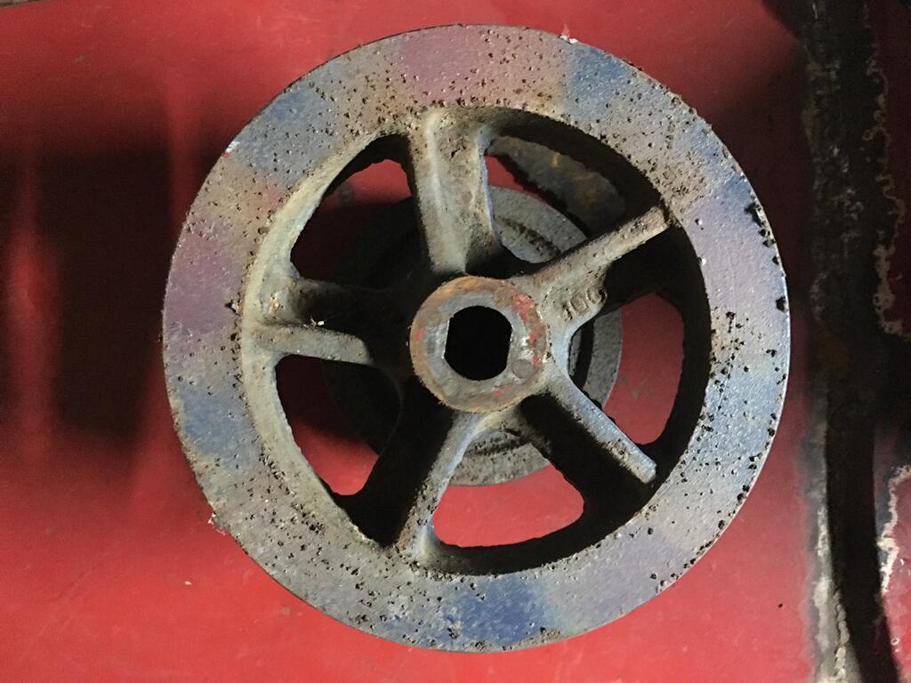

19richie66 17,932 #20460 Posted December 21, 2023 11 hours ago, Colby G said: Way ahead of you, during my reaserch I came across that post. But i didn't know for sure if it was a gt-14 or not, I wanted others opinion on the matter, and if the pulley posted earlier in the conversation would fit it. Shaft look like this? 1 Share this post Link to post Share on other sites
Colby G 248 #20461 Posted December 21, 2023 9 hours ago, 19richie66 said: Shaft look like this? Yep Share this post Link to post Share on other sites
19richie66 17,932 #20462 Posted December 21, 2023 This is the Double D pulley that came off my 1972 GT14. Transmission was toast. Share this post Link to post Share on other sites
Colby G 248 #20463 Posted December 21, 2023 (edited) 3 minutes ago, 19richie66 said: This is the Double D pulley that came off my 1972 GT14. Transmission was toast. What was the model number? Would it work on a model number 90-2070? Edited December 21, 2023 by Colby G Share this post Link to post Share on other sites
gt14rider 1,278 #20464 Posted December 21, 2023 You should ask Rich if he would measure the pulley double d hole, and you should measure your shaft, then see if rich wants to sell that pulley, please and thank you. Share this post Link to post Share on other sites
Colby G 248 #20465 Posted December 21, 2023 Well if he is willing to sell it, I'd like to know if I could use it for sure, My transmission seems to be pretty rare... Share this post Link to post Share on other sites
19richie66 17,932 #20466 Posted December 22, 2023 4 hours ago, Colby G said: Well if he is willing to sell it, I'd like to know if I could use it for sure, My transmission seems to be pretty rare... I would sell the pulley. Shoot me a pm and we’ll talk about it. As far as a tag, I do not have my transmission any more as I converted it to the Eaton 1100, even more rare in a GT14. 3 1 Share this post Link to post Share on other sites

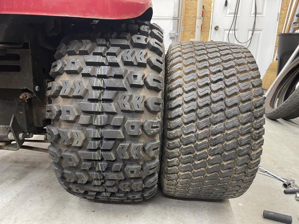

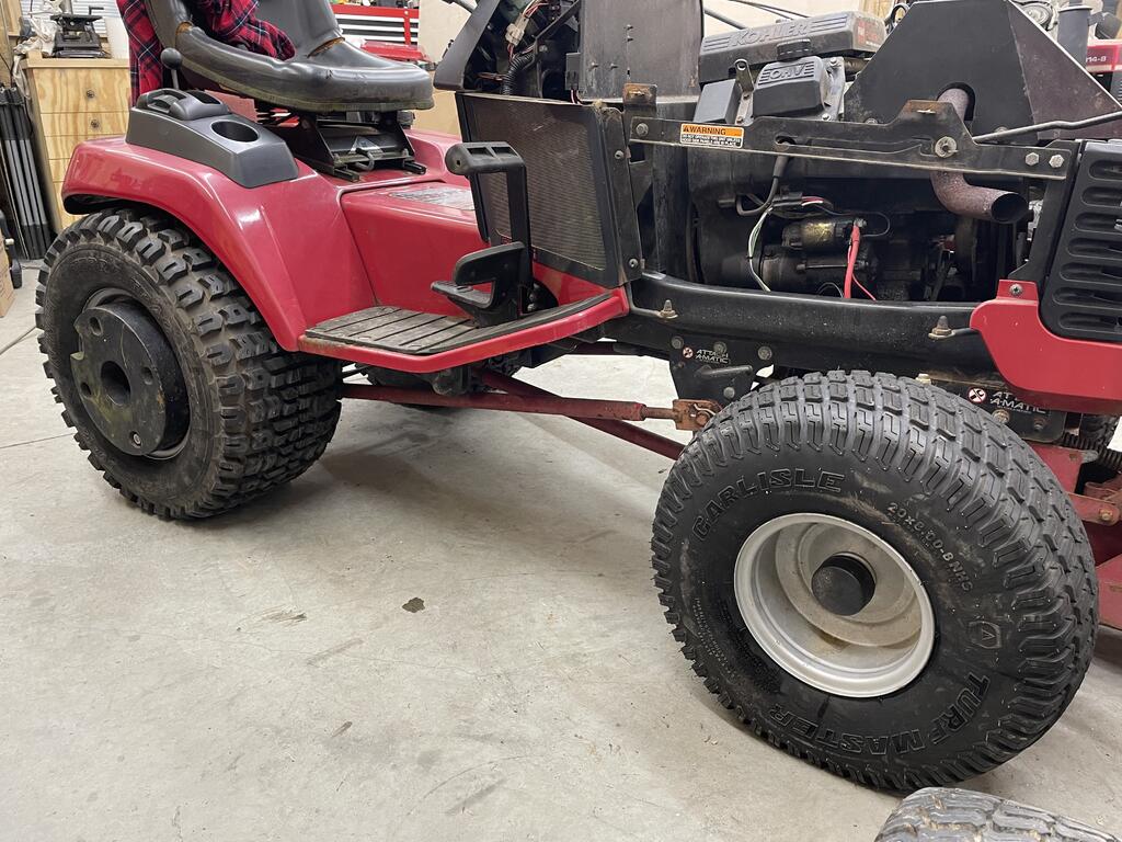

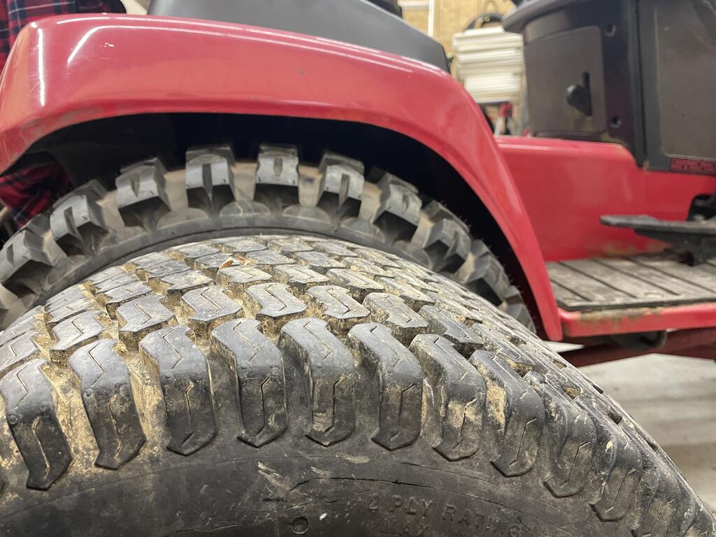

OoPEZoO 609 #20474 Posted December 24, 2023 Tire swapping time today for the 522xi. Out with the old stock dry rotted tires and on with the 26x12x12 Kenda Terra Tracs and a leftover set of 20x8x8 Carlisle Turf Masters for the front. They all fit great with no mods. I was a little worried about those Kendas fitting under the rear fender, but there is plenty of clearance without raising the tub. I still want to fill them with fluid, but that is not a December in PA project. Beyond that, here is a PSA.......if you ever decide it is a good idea to use tire slime and it is NOT a life or death emergency situation, there is a special place in hell for you. Patch it, plug it, tube it, but please don't slime it. Damn I hate that crap. It was in 3/4 of the tires I swapped today and it was everywhere by the time I was done. My garage looked like someone flung spoonfuls of neon green mayonnaise all over the place. I also took the time to swap from lug bolts over to studs and lug nuts. That is something I should have done 20yrs ago on my other tractor. I'm happy with the results. 4 8 Share this post Link to post Share on other sites
19richie66 17,932 #20475 Posted December 24, 2023 Lug studs are the first modification that should be done to a tractor. Should be a rule somewhere. 1 3 Share this post Link to post Share on other sites
