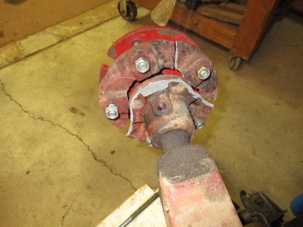

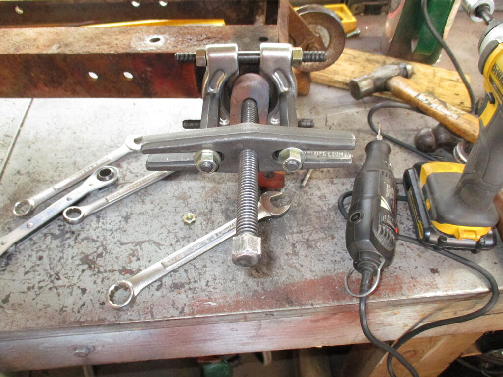

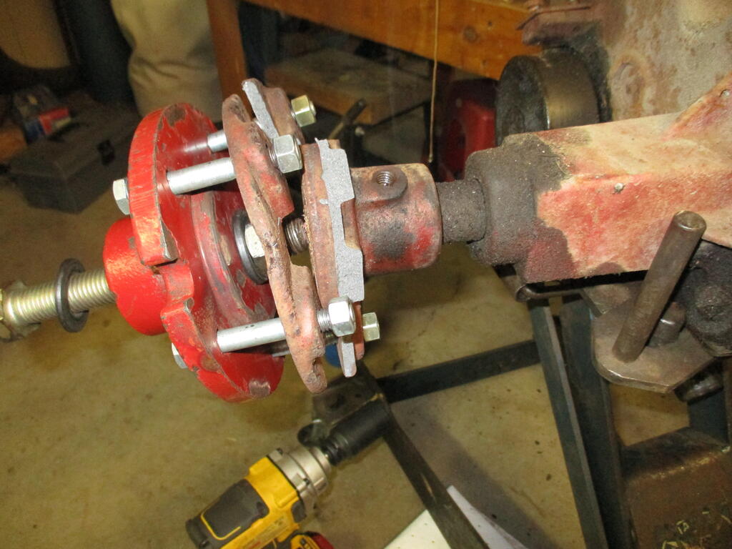

Lee1977 7,750 #20401 Posted December 15, 2023 (edited) On 12/13/2023 at 3:06 PM, pfrederi said: Tale of two hubs, The C-160 I am working on spent a lot of time outside and everything is resisting disassembly. Got one hub of after a good fight only to find it had been broken and welded. The other hub had oil on the axle from a leaky seal so I had hoped it would come off several days of Kroil and today heat ...have never broken one before with this puller... Steering wheel isn't cooperating neither is the roll pin in the clutch cross shaft... Hate to think about the hitch pin You got part of it off. My Raider one slid right off, the other I could even break until I saw almost to the axle on both sides, and it still resisted. Edited December 15, 2023 by Lee1977 Share this post Link to post Share on other sites
pfrederi 21,091 #20402 Posted December 15, 2023 Small but expensive steps forward. Cut off remains of the hub. Finally got the end off the clutch shaft but at the price of a a couple drill bits, a cobalt drill bit, roll pin punch and a Dremel Carbide burr. Propane heating kroil and roll pin punch got no where. Thought the roll pin is hollow if I drilled out the opening with a small drill bit Kroil would get in better. Was able to drill in from both sides but only to the shaft, then it wouldn't drill. A few more tries and drilling stopped when i got to the shaft. I know roll pins are tough so I got out the Oxy/acytelene rig heated the whole thing Cherry red and let it cool down thinking it would remove some of the temper. Broke a cobalt bit drilling Finally wore my way trough with a dremel carbide burr but..broke one of those. Still had to use puller to finish the job. No movement on the steering wheel I have 20 ton press but I really don't what to cut the frame of it to get the steering wheel into it . After all this I am rally not looking forward to the hitch pin 3 6 Share this post Link to post Share on other sites

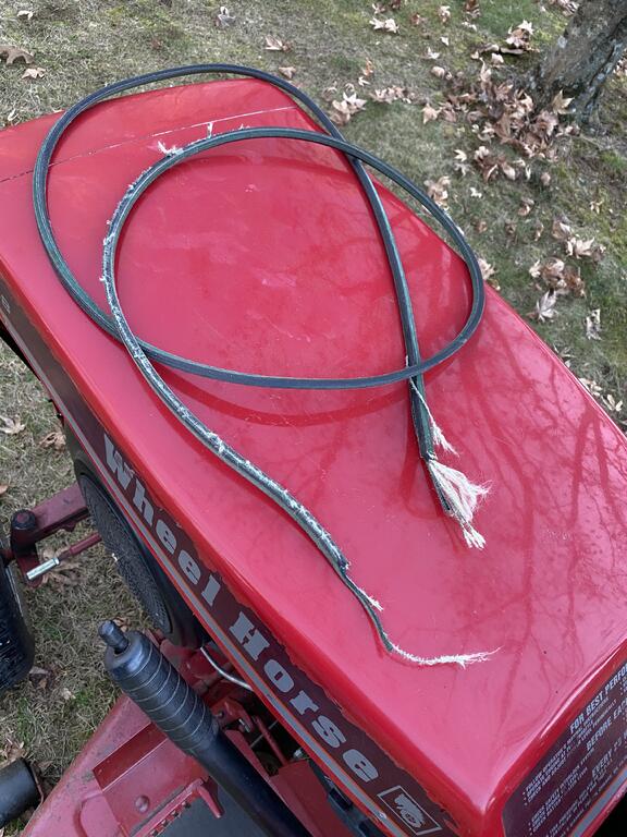

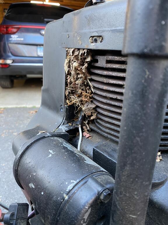

Sparky-(Admin) 26,244 #20404 Posted December 15, 2023 Decided to mulch up the last few leaves with the 414 and 42” RD deck… well the mice had moved in so spent quite a bit of time evicting them and all their house building materials. Then off to do some mulching only to have the PTO to deck belt snap after only 25’ of mulching. Guess mulching wasn’t meant to happen.. 14 Share this post Link to post Share on other sites

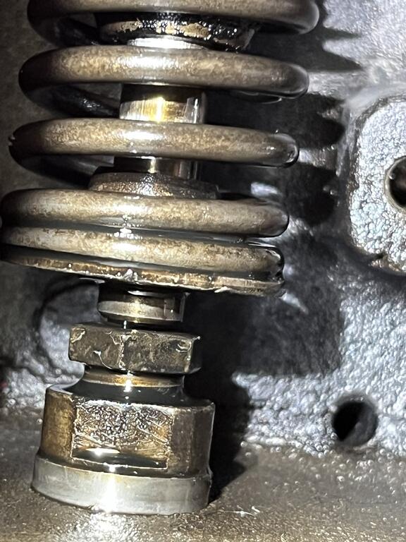

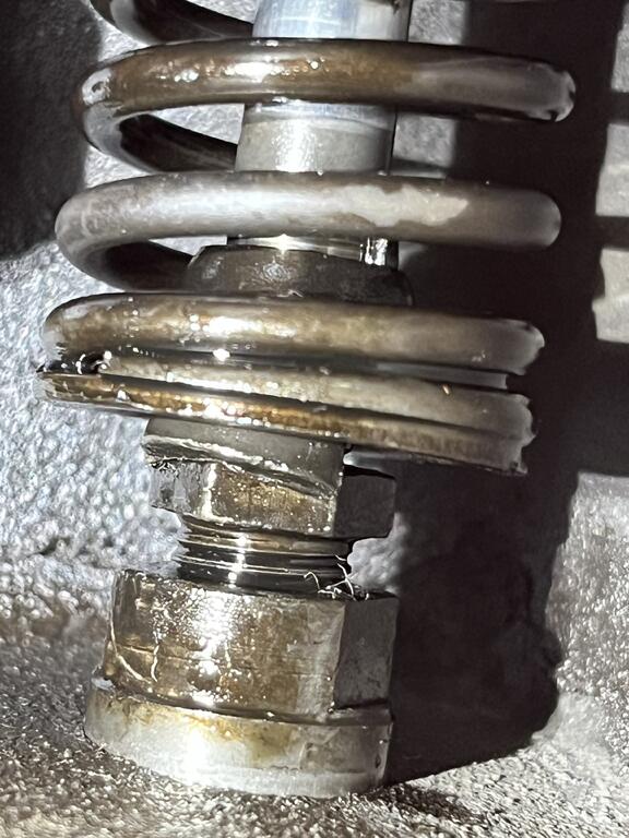

BrianKoch 370 #20405 Posted December 15, 2023 (edited) Gentlemen, Today I began to tear down my ‘69 Charger 12 and uncovered a “problem” with the intake valve. What’s happened here? Intake: Exhaust: Edited December 15, 2023 by BrianKoch 1 1 1 Share this post Link to post Share on other sites

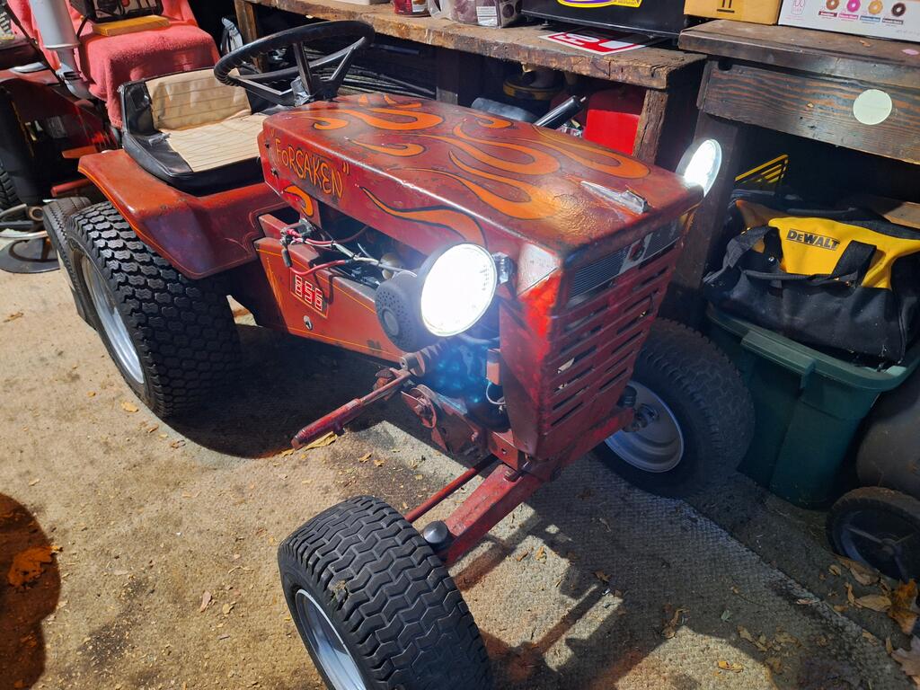

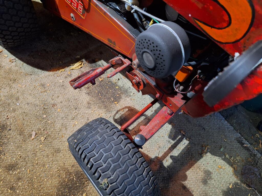

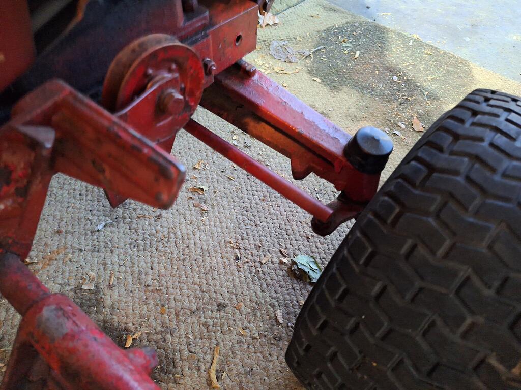

D_Mac 9,339 #20406 Posted December 15, 2023 Well my tie rod/ ball joint arrived today from @A-Z Tractor . Fast Shipping . I removed the old one and bolted on the replacement. Forsaken is back in action. Maybe in the spring I will replace both sides with new ones. For now I'm happy. 6 4 Share this post Link to post Share on other sites
D_Mac 9,339 #20407 Posted December 15, 2023 43 minutes ago, Sparky said: Decided to mulch up the last few leaves with the 414 and 42” RD deck… well the mice had moved in so spent quite a bit of time evicting them and all their house building materials. Then off to do some mulching only to have the PTO to deck belt snap after only 25’ of mulching. Guess mulching wasn’t meant to happen.. Find out what caused the belt to snap like that ? Share this post Link to post Share on other sites
Sparky-(Admin) 26,244 #20408 Posted December 15, 2023 1 hour ago, D_Mac said: Find out what caused the belt to snap like that ? I have no idea how old the belt was and never checked it for cracks. It might just have been its time. Didn’t investigate, just backed it into the shed and climbed onto another tractor with a deck 1 2 Share this post Link to post Share on other sites
pfrederi 21,091 #20409 Posted December 16, 2023 1 hour ago, BrianKoch said: Gentlemen, Today I began to tear down my ‘69 Charger 12 and uncovered a “problem” with the intake valve. What’s happened here? Intake: Exhaust: Valve keeper tried to escape. Note the metal shavings on the tappet nut. Issue to TBD did the keeper fail or is eh machined groove in the valve stem bad... 1 1 1 Share this post Link to post Share on other sites
BrianKoch 370 #20410 Posted December 16, 2023 43 minutes ago, pfrederi said: Valve keeper tried to escape. Note the metal shavings on the tappet nut. Issue to TBD did the keeper fail or is eh machined groove in the valve stem bad... Ah. Is the fix as simple as replacing with new valve? 1 Share this post Link to post Share on other sites
mrc 1,113 #20411 Posted December 16, 2023 (edited) hello pfrederi, for the hitch pin i use my snap-on ball joint press kit (BJP-1) works well regards mike Edited December 16, 2023 by mrc 1 Share this post Link to post Share on other sites
pfrederi 21,091 #20412 Posted December 16, 2023 Steering wheel victory. Previous owner had replaced roll pin with Gr8 bolt that was frozen in place. Finally got it drilled out (oversize now) but wheel would not budge. Have used this method in the past but had to use the torch and get her glowing then wail away with a BFH and impact socket.. Once it cools I will clean up the top end of the shaft and the wheel will come off. The arm plastic covering was missing probably burned off by PO when he worked on it. Next challenge the hitch pin...wish me luck.. 7 1 Share this post Link to post Share on other sites
Ed Kennell 47,094 #20413 Posted December 16, 2023 11 minutes ago, pfrederi said: Next challenge the hitch pin. I just use a cut-off wheel to cut the pin off on both sides of the tranny lug. Then drill out the part left in the lug from the right side. So the larger lug is taking the force from the drilling and pounding. I usually drill it open to 7/16" but not quite thru. Then use a long 3/8" drift and the BFH to drive it out. This way you are actually pulling and stretching instead of pushing and compressing the pin. The part left in the hitch goes to the vise, press, or drill press. 3 4 1 Share this post Link to post Share on other sites
