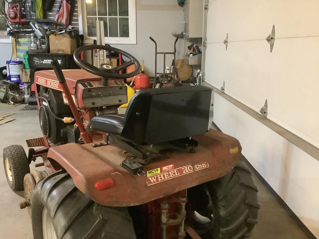

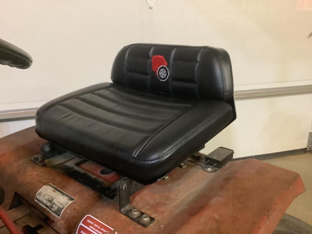

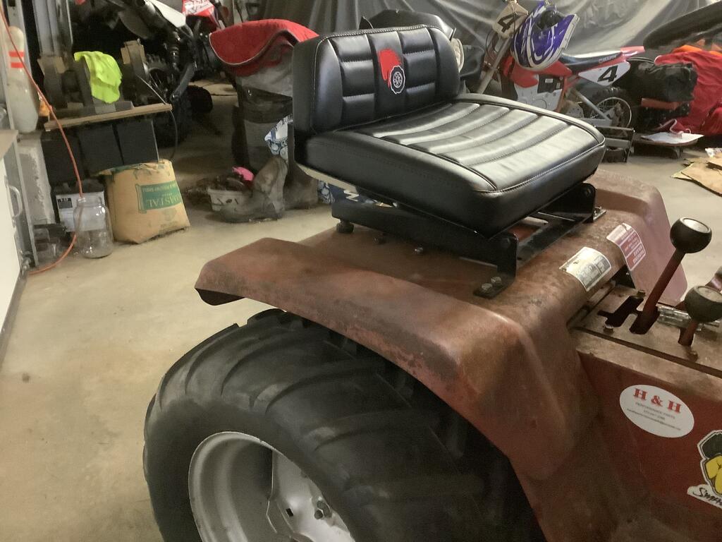

TonyToro Jr. 2,534 #19902 Posted September 7, 2023 Yesterday @TonyToro and I put this seat my on pulling tractor. We got it from Matt Castagno.it’s looks so much better then the old ripped seat! 4 7 Share this post Link to post Share on other sites

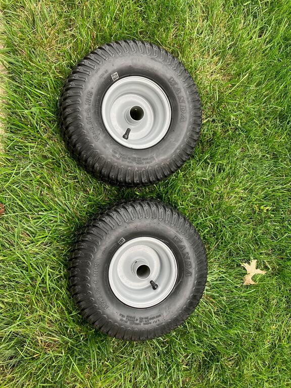

KAA 1973 71 #19903 Posted September 7, 2023 Blasted/powder coated front wheels, added new tires, valve stems and bearings. 1 6 Share this post Link to post Share on other sites

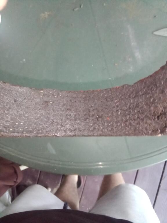

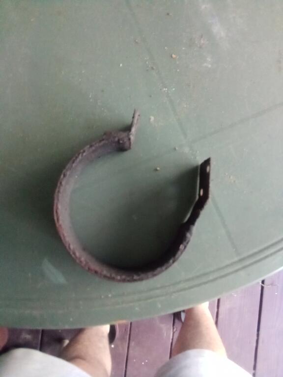

Colby G 248 #19904 Posted September 7, 2023 I think it's time for a new brake caliper... anyone know where I can get a new one for a 1973 no name 8? 1 Share this post Link to post Share on other sites

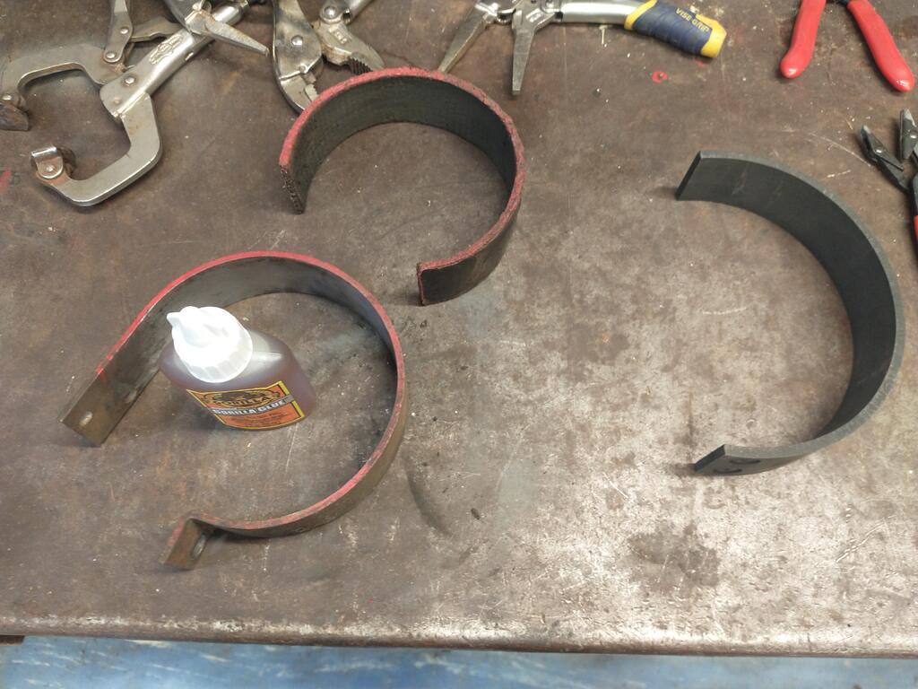

squonk 47,979 #19907 Posted September 7, 2023 (edited) All you need is the lining @Colby G @rmaynard Edited September 7, 2023 by squonk 2 Share this post Link to post Share on other sites
Colby G 248 #19908 Posted September 7, 2023 (edited) 37 minutes ago, squonk said: All you need is the lining @Colby G @rmaynard What tools do I need to put it on? And would I buy it on a-z tractor? Edited September 7, 2023 by Colby G Share this post Link to post Share on other sites

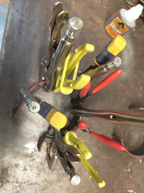

squonk 47,979 #19909 Posted September 7, 2023 Just now, Colby G said: What tools do I need to put it on? Peel the old one off and clean the metal band good to get the old glue off. Sandpaper works good to give the metal "tooth. Glue it on and use clamps, zip ties or put it back on and set the parking brake for a day. 1 Share this post Link to post Share on other sites
Colby G 248 #19910 Posted September 7, 2023 1 minute ago, squonk said: Peel the old one off and clean the metal band good to get the old glue off. Sandpaper works good to give the metal "tooth. Glue it on and use clamps, zip ties or put it back on and set the parking brake for a day. What if my tractor doesn't have a parking brake? 1 Share this post Link to post Share on other sites
squonk 47,979 #19911 Posted September 7, 2023 Just now, Colby G said: What if my tractor doesn't have a parking brake? Clamp it or zip tie it 3 Share this post Link to post Share on other sites

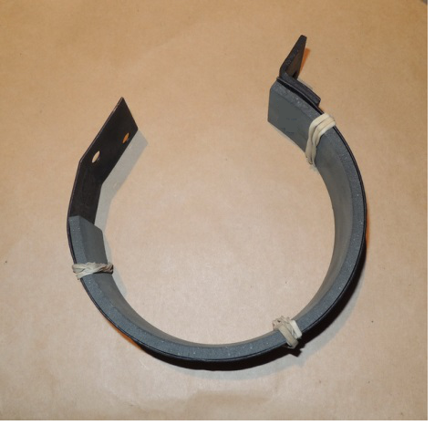

rmaynard 17,547 #19912 Posted September 7, 2023 Or use rubber bands 4 Share this post Link to post Share on other sites
Ed Kennell 47,084 #19913 Posted September 7, 2023 2 minutes ago, Colby G said: What if my tractor doesn't have a parking brake? Some of these s will suggest you use this as an excuse to sleep on your tractor all night with your foot on the brake. Or you could hold the brake down with a brick, rachet strap or stick. 3 1 Share this post Link to post Share on other sites

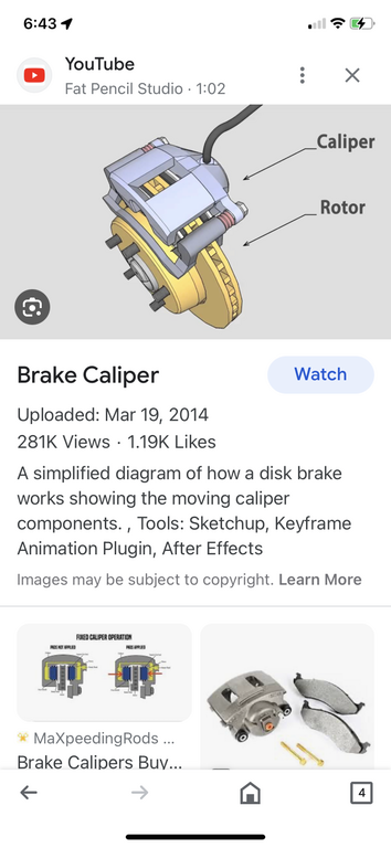

Horse Newbie 7,405 #19915 Posted September 7, 2023 (edited) 4 minutes ago, Colby G said: Yeah, Im dumb You ain’t dumb @Colby G… but that is a “brake band”, not a brake caliper… Edited September 7, 2023 by Horse Newbie Share this post Link to post Share on other sites
Colby G 248 #19916 Posted September 7, 2023 15 minutes ago, Horse Newbie said: You ain’t dumb @Colby G… but that is a “brake band”, not a brake caliper… 1 Share this post Link to post Share on other sites
Colby G 248 #19917 Posted September 7, 2023 Oh, ok. Thank you for telling me the difference! 2 Share this post Link to post Share on other sites

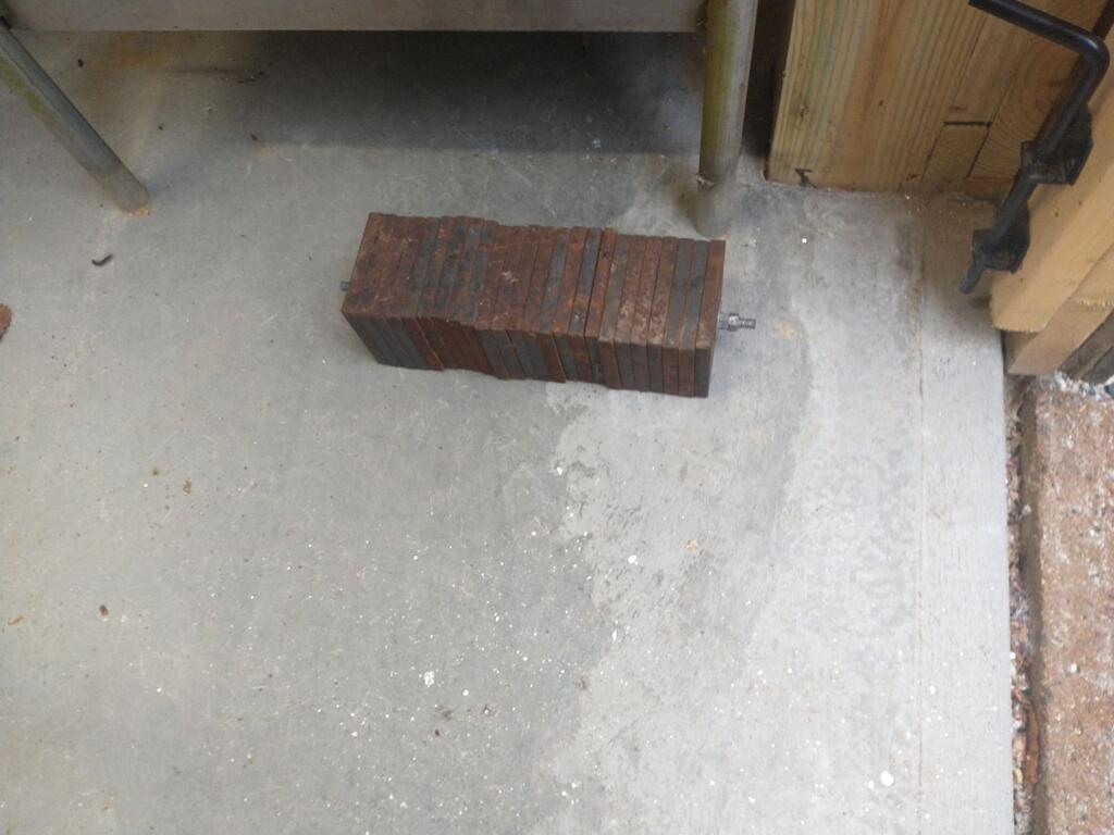

ebinmaine 80,445 #19919 Posted September 11, 2023 Found this neat pile of steel on @Sparky's truck. I figured it would make a great front weight for something. 12" x 4" x 4" Totals out about 52+ lbs. 3 Share this post Link to post Share on other sites
