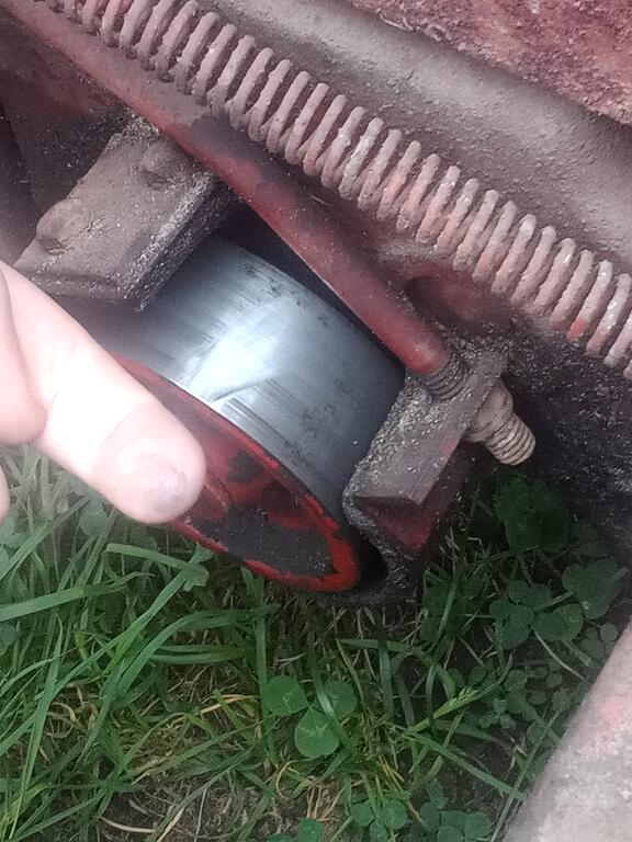

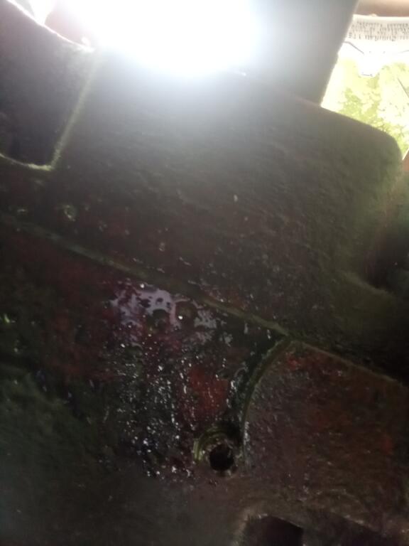

Colby G 248 #19883 Posted September 4, 2023 I put in a new seal a while back, but the brake drum still has gearbox oil on it... and there's oil on the outside of the rear end under the gearbox too. Can somebody tell me what I'm doing wrong? 1 Share this post Link to post Share on other sites

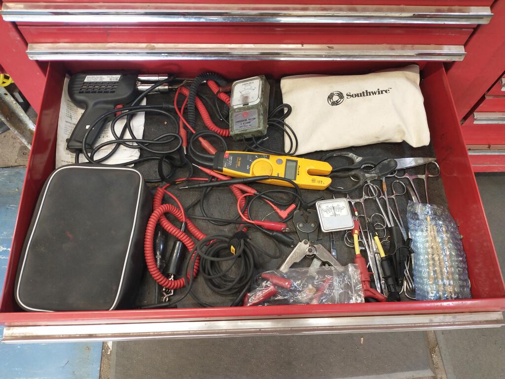

squonk 47,979 #19885 Posted September 4, 2023 This sorta belongs in here: cleaned up the electric drawer (s) 5 2 Share this post Link to post Share on other sites

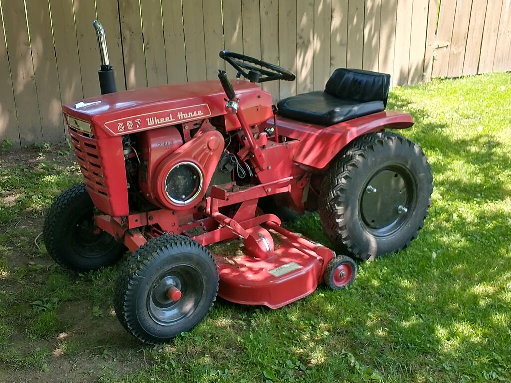

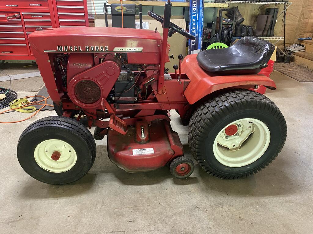

Sparky-(Admin) 26,244 #19886 Posted September 4, 2023 Mounted my “new to me” 32” deck on the 867 and did a bit of mowing. 7 5 Share this post Link to post Share on other sites

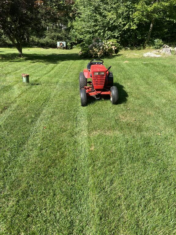

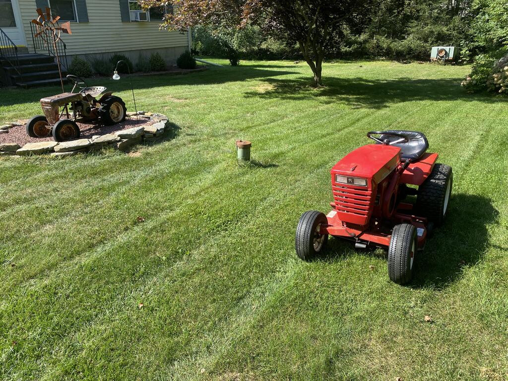

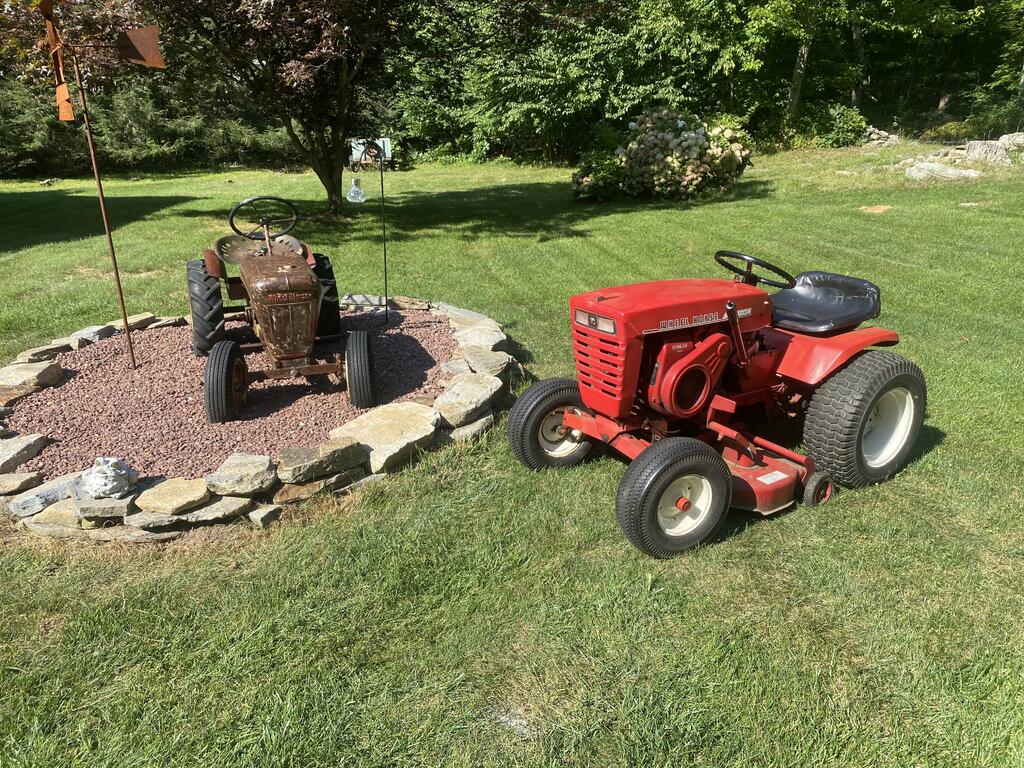

squonk 47,979 #19887 Posted September 4, 2023 (edited) Some old school mowing on a hot day Edited September 4, 2023 by squonk 5 6 Share this post Link to post Share on other sites
Sparky-(Admin) 26,244 #19888 Posted September 4, 2023 21 minutes ago, squonk said: Some old school mowing on a hot day Is that a 36” deck? 1 Share this post Link to post Share on other sites
squonk 47,979 #19889 Posted September 4, 2023 18 minutes ago, Sparky said: Is that a 36” deck? Yup. NOS shell. Jake Kuhn rebuilt it 2 Share this post Link to post Share on other sites

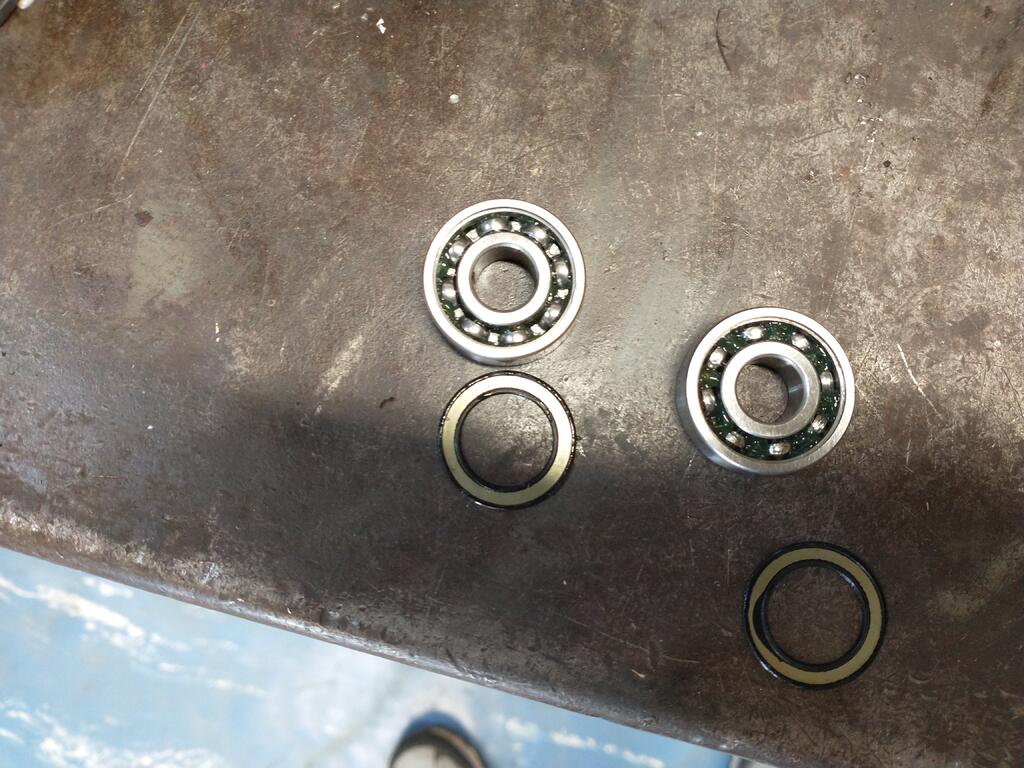

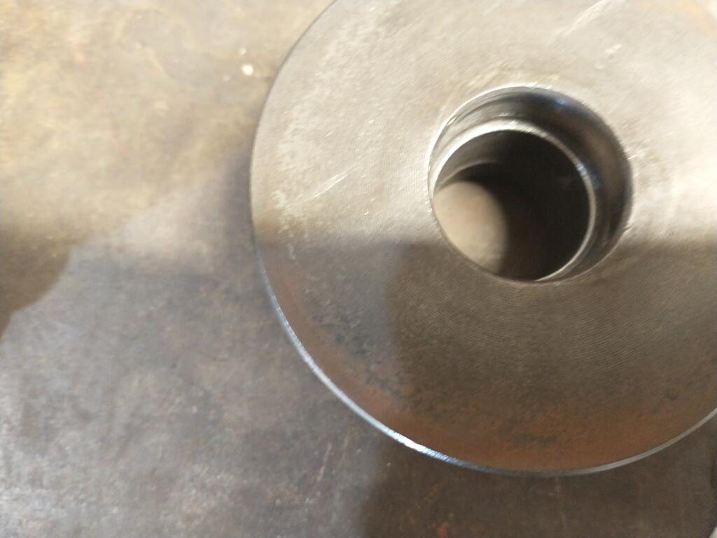

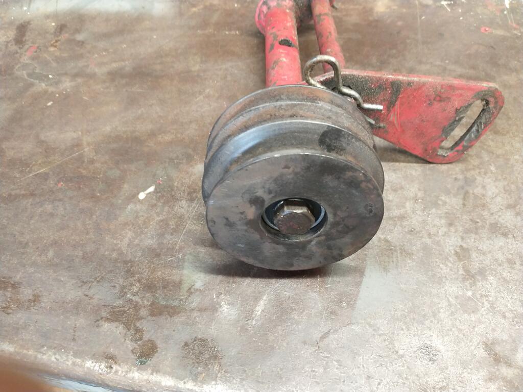

squonk 47,979 #19894 Posted September 5, 2023 Refurbed a gear drive deck Drive pulley for a spare. The old bearings were stuck and there are ridges on both ends so you can't just press them out. plus there is a spacer between them to make it tricky. Needed a little bit of the flame wrench and a hook on a slide hammer. New bearings from Bearings Direct. You can see how much grease they don't have from the factory. Added the green stuff. All back together and I'll prolly never need it! 5 7 Share this post Link to post Share on other sites
