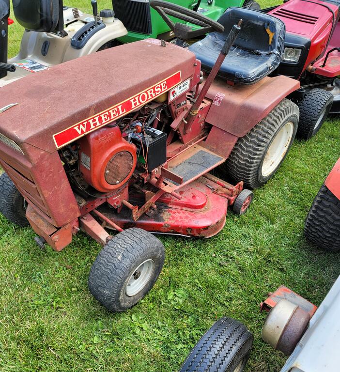

TonyToro 1,189 #19356 Posted June 28, 2023 Things were happening this afternoon with the B-60 and @TonyToro Jr. 4 3 Share this post Link to post Share on other sites
ineedanother 2,650 #19357 Posted June 28, 2023 18 minutes ago, TonyToro said: Things were happening this afternoon with the B-60 and @TonyToro Jr. That looks like a tap and die set. Did someone snap a bolt by chance??? 1 Share this post Link to post Share on other sites
TonyToro Jr. 2,512 #19358 Posted June 28, 2023 12 hours ago, ineedanother said: That looks like a tap and die set. Did someone snap a bolt by chance??? No the carb got replaced and the bolts wouldn’t go in for the air filter assembly. So we just re tapped them. 3 Share this post Link to post Share on other sites
Handy Don 17,039 #19359 Posted June 28, 2023 2 hours ago, TonyToro Jr. said: No the carb got replaced and the bolts wouldn’t go in for the air filter assembly. So we just re tapped them. Likely the new carb’s holes were metric threaded 3 Share this post Link to post Share on other sites
ebinmaine 79,786 #19360 Posted June 28, 2023 17 hours ago, TonyToro said: Things were happening this afternoon with the B-60 and @TonyToro Jr. 4 hours ago, TonyToro Jr. said: No the carb got replaced and the bolts wouldn’t go in for the air filter assembly. So we just re tapped them. Send me that carb and I'll rebuild it for you. 1 Share this post Link to post Share on other sites
TonyToro Jr. 2,512 #19361 Posted June 28, 2023 4 hours ago, Handy Don said: Likely the new carb’s holes were metric threaded Yeah that’s what we were thinking. 1 Share this post Link to post Share on other sites
TonyToro 1,189 #19362 Posted June 29, 2023 7 hours ago, ebinmaine said: Send me that carb and I'll rebuild it for you. Funny thing is the original owner gave us 2 or might be 3 carburetors. I just went with what was on the tractor to get it running. I haven’t opened any of the carburetors yet. We were talking last night about original equipment on this tractor. I agree that a factory original needs to be back on it. 1 Share this post Link to post Share on other sites

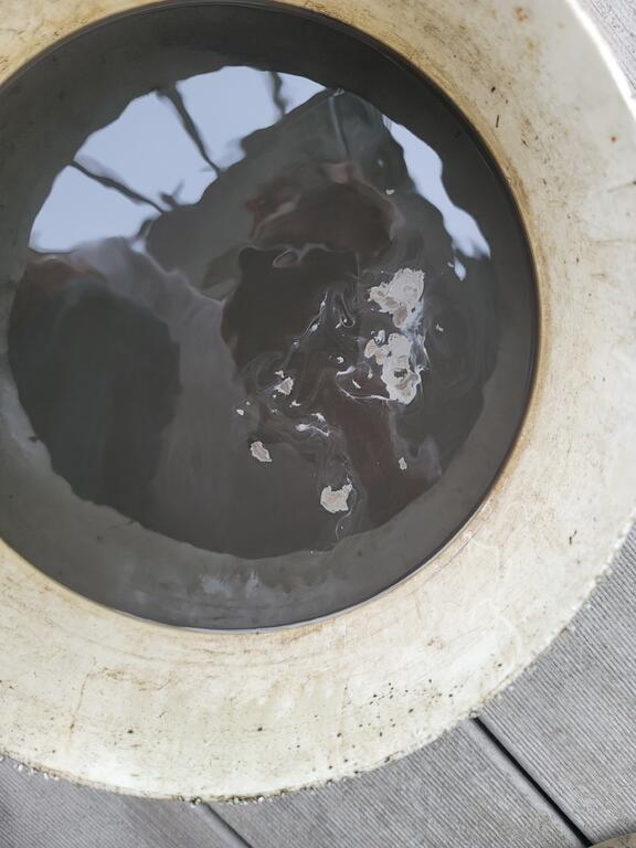

dotcomdz 49 #19365 Posted June 30, 2023 I finally got my B-80 back from a sour deal, this how it was returned, then something in my head said drain the gas and oil because both smelled like paint thinner and I knew when it left both were fine. Now does that look like Grey primer floating around or what🤷🤬 anyways cleaned it all up flushed everything real well and running like a dream, probably one of the best running old kohlers I've ever found in the wild. So anyways this gonna be my keeper 😁 1 3 1 Share this post Link to post Share on other sites
Sparky-(Admin) 26,001 #19366 Posted June 30, 2023 @dotcomdz Are you saying you think it was sabotaged? Done intentionally? 1 1 Share this post Link to post Share on other sites
peter lena 9,971 #19367 Posted June 30, 2023 @dotcomdz seen so many neglected , thrashed horses , just don,t know how anyone could do that . guy,s got issues . rotella 30 wt , glad you got it back . pete 1 Share this post Link to post Share on other sites

dotcomdz 49 #19370 Posted June 30, 2023 5 hours ago, Sparky said: @dotcomdz Are you saying you think it was sabotaged? Done intentionally? How else dirty paint thinner get in the gas and oil, when before it left my house I had been over it well removed the gas tank and cleaned it and changed the oil to make sure it was a solid machine first 🤷 1 Share this post Link to post Share on other sites

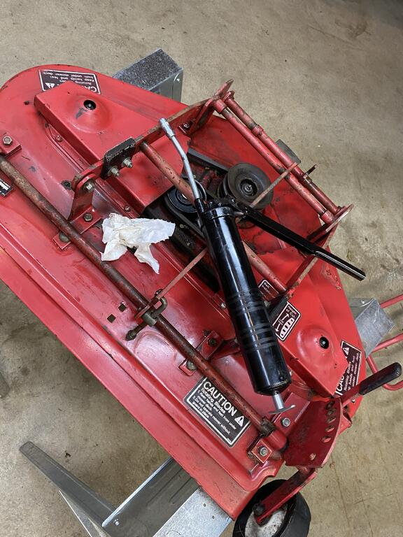

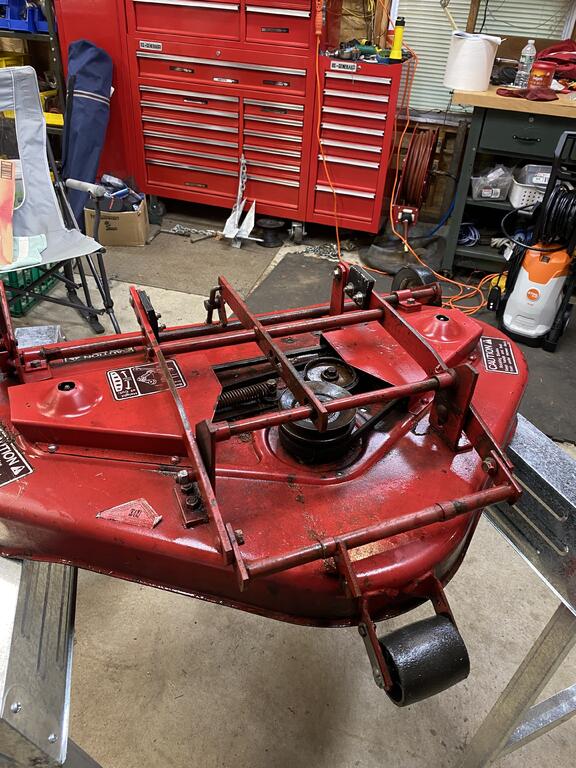

Sparky-(Admin) 26,001 #19373 Posted July 2, 2023 Good rainy day project while I look at my fishing boat sitting in the rain . My 36RD needed some attention. New idler pulley from K and B Wheel Horse Parts @76c12091520h as well as a good overall greasing. Just an FYI…I sent K and B a PM a month before the show with a list of parts I wanted. Wanted new and not used. I got back an email saying all were available and the pricing. Said great, I’ll pick it all up at the show. When I show up at the K and B vender spot at the WHS there were all my parts in a bag ready to go! Great service! Highly recommend Ken and Brian! 4 7 Share this post Link to post Share on other sites
squonk 47,476 #19374 Posted July 2, 2023 (edited) 1 hour ago, Sparky said: When I show up at the K and B vender spot at the WHS there were all my parts in a bag ready to go! Great service! Highly recommend Ken and Brian! Looks like you forgot to order deck wheels! Yes K & B are top notch! Chase TheBeagle on FB! Edited July 2, 2023 by squonk 2 Share this post Link to post Share on other sites
Sparky-(Admin) 26,001 #19375 Posted July 2, 2023 4 minutes ago, squonk said: Looks like you forgot to order deck wheels! These deck wheels look rough but spin just fine. Pulled em off today and greased them up. No zerks on these .. I swear my others have zerks. I have a few new ones on the shelf but I just can’t bring myself to install em yet. 1 3 Share this post Link to post Share on other sites
