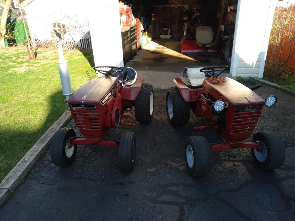

D_Mac 9,339 #18754 Posted April 13, 2023 (edited) Blew the dust off of the 1075 and the 856. 1075 Is going to need looking into. Runs great for a while the starts cutting out. I added a license plate and rubbed some boiled linseed oil on them both. Edited April 15, 2023 by D_Mac 5 2 Share this post Link to post Share on other sites

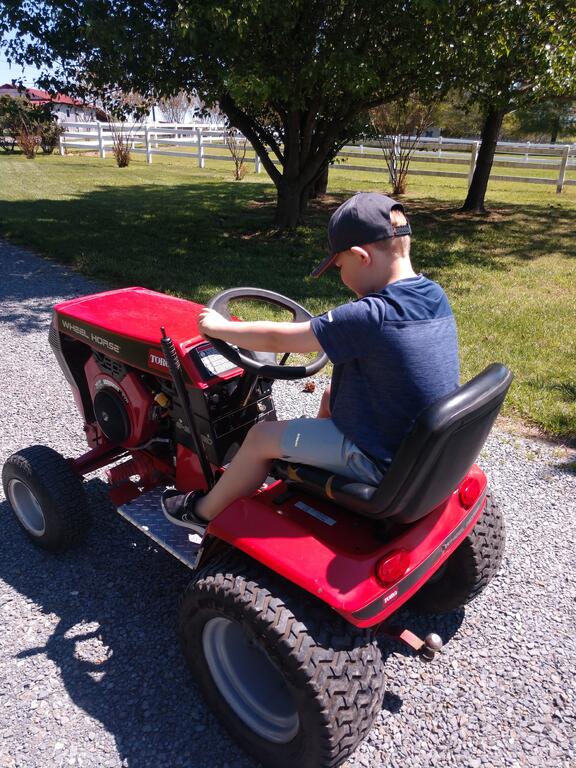

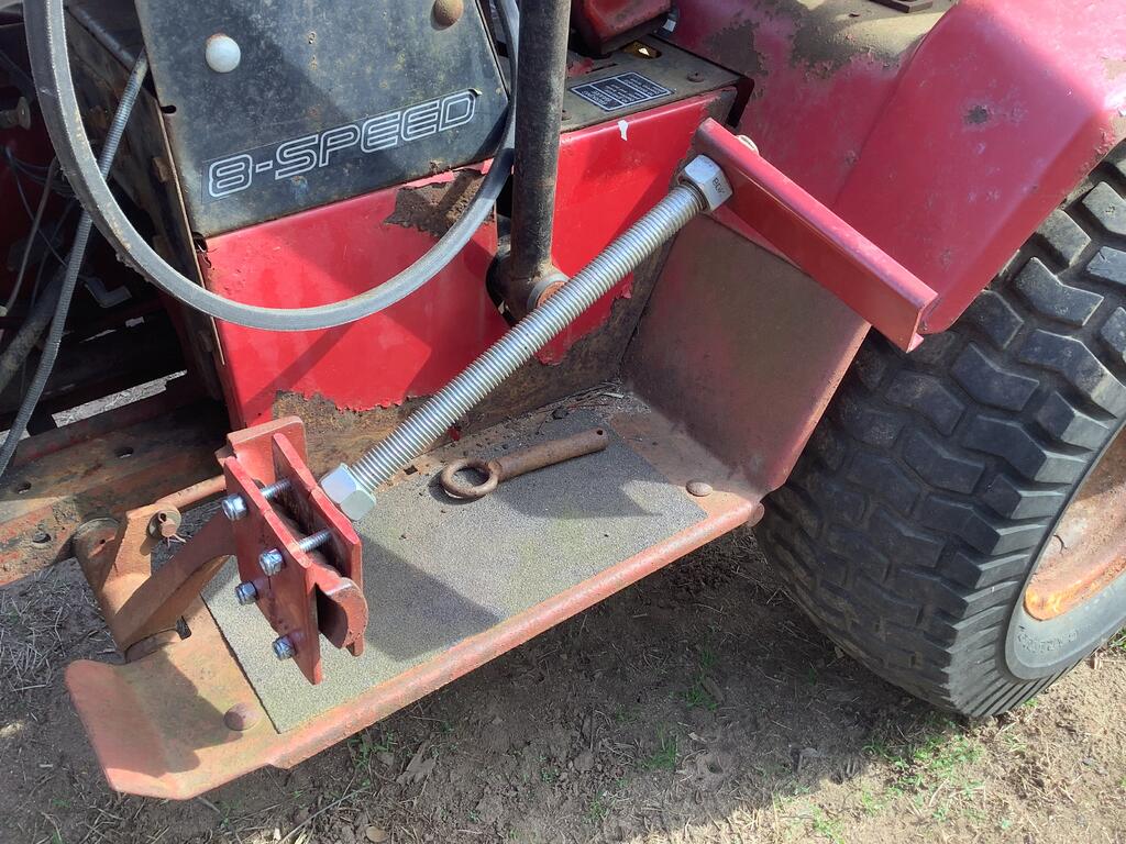

kpinnc 18,916 #18755 Posted April 14, 2023 Little man drove the 314-8 around today. I gotta get him some pedal extensions! The new engine is so smooth and quiet! Upgrading the transmission next to a 8-pinion. 8 8 Share this post Link to post Share on other sites
TonyToro 1,189 #18756 Posted April 14, 2023 24 minutes ago, kpinnc said: Little man drove the 314-8 around today. I gotta get him some pedal extensions! The new engine is so smooth and quiet! Upgrading the transmission next to a 8-pinion. I have a couple sets of extensions I made for @TonyToro Jr. I can send them to you or send pictures. 2 Share this post Link to post Share on other sites
SylvanLakeWH 32,250 #18757 Posted April 14, 2023 58 minutes ago, TonyToro said: I have a couple sets of extensions I made for @TonyToro Jr. I can send pictures. Could you post a pic or two here? Would be interested in seeing what you did... 2 Share this post Link to post Share on other sites
kpinnc 18,916 #18758 Posted April 14, 2023 1 hour ago, TonyToro said: I have a couple sets of extensions I made for @TonyToro Jr. I can send them to you or send pictures. I'm definitely curious how you made them. He does better with a hydro of course, until he speeds up... 1 Share this post Link to post Share on other sites

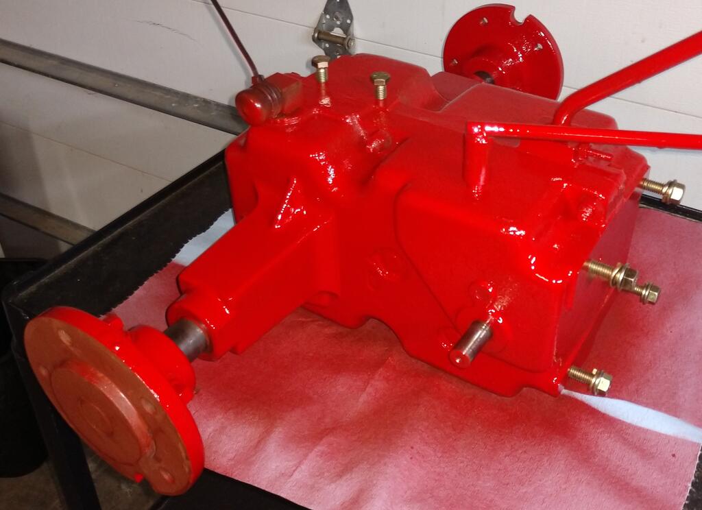

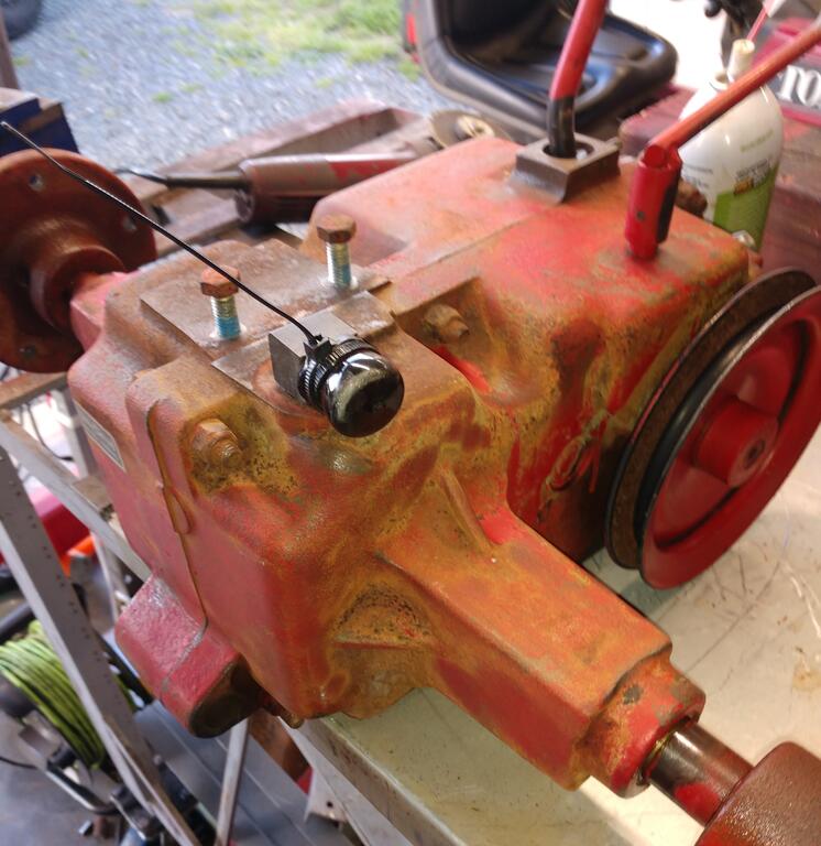

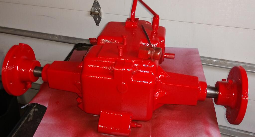

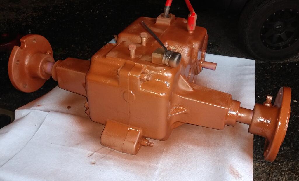

kpinnc 18,916 #18759 Posted April 14, 2023 I did something else today too. Since my 310-8 got upgraded to the 314-8, I decided to give it a heavier transmission while I'm upgrading. I have a couple spare 8-speeds, and the input shaft has been leaking on the original tranny for a while anyway. So I cleaned up one of my spares today. The gear oil was nasty, but had no water in it. I changed the axle seals as well. The hubs weren't horribly stuck, but it took a while to remove them. The hitch pin was a royal pain, but it finally came out. Only thing I didn't have was an input shaft seal. And it's gonna need one for this tranny as well. Degreased the whole thing and primed it, then sprayed two coats of Rust-Oleum regal red on it. The case had some pitting on it, so it doesn't have a smooth finish, but it's good enough for a worker. I'll chase the hub threads tomorrow and get her ready to swap into the 314-8. 5 14 Share this post Link to post Share on other sites

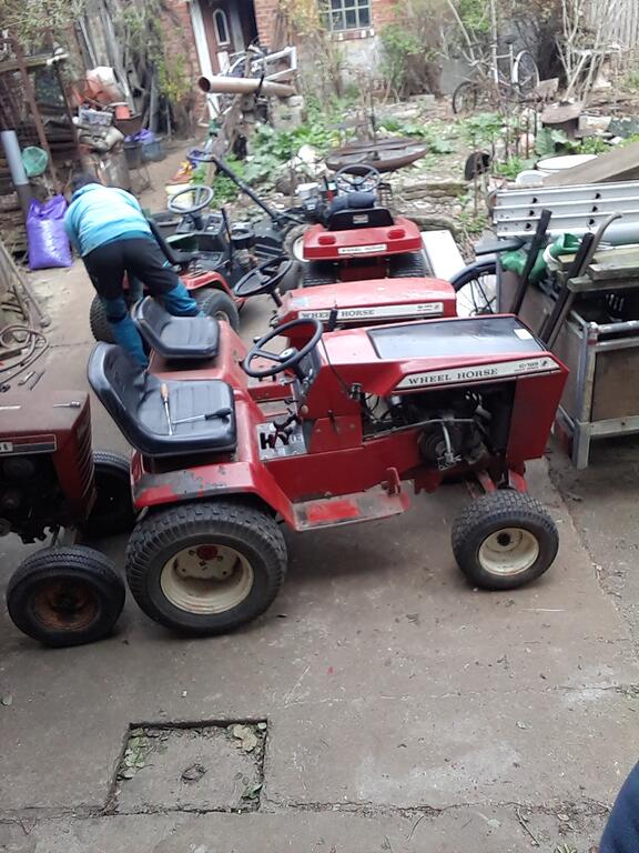

spitfire 176 #18760 Posted April 14, 2023 (edited) Yesterday we drove the b125 for the first time. He jumps out 3rd and reverse 😕 We changed the engine with a 12hp power build, repaired starter and brakes and all electrics. Edited April 14, 2023 by spitfire 3 1 Share this post Link to post Share on other sites

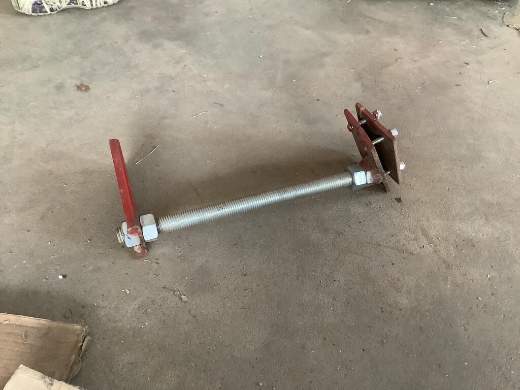

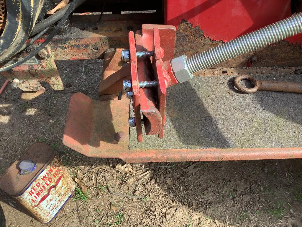

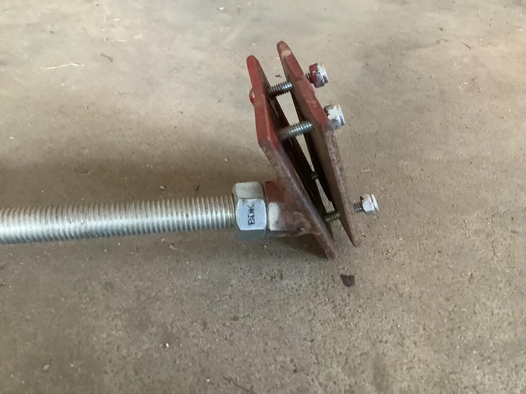

TonyToro Jr. 2,534 #18762 Posted April 14, 2023 @kpinnc @SylvanLakeWH This is the foot extension. and it’s adjustable for height. 10 2 2 Share this post Link to post Share on other sites
SylvanLakeWH 32,250 #18763 Posted April 14, 2023 @TonyToro Jr. thx! That is slick! 1 Share this post Link to post Share on other sites

Monstrosity 1,153 #18771 Posted April 15, 2023 5 hours ago, TonyToro Jr. said: @kpinnc @SylvanLakeWH This is the foot extension. and it’s adjustable for height. May have to steal this idea and design!! 1 1 Share this post Link to post Share on other sites

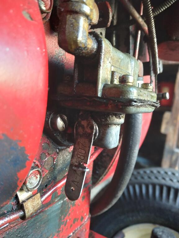

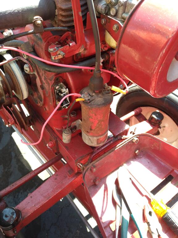

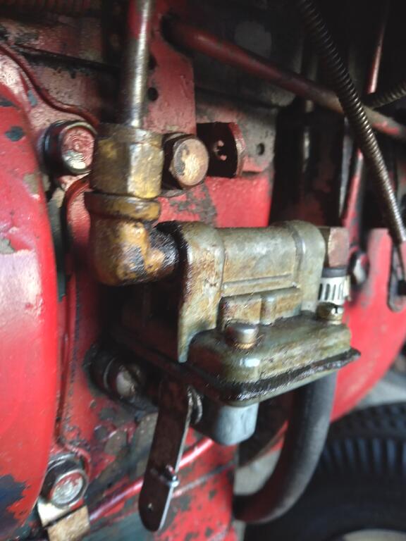

D_Mac 9,339 #18773 Posted April 15, 2023 Worked on all 3 of my Horses. The 1075 got an oil change. The 875 was losing spark intermittently. Wound up being the wire that goes from the points to the coil. The terminal end was broken off. After that adjusted the carb a little, back to running great. The 856 got a boiled linseed oil rub down and I monkeyed with the seat a little. Seat cover is all tore up and the padding is gone so I added a little pad under the cover. Will do till I find a new seat. I also would like to rebuild this fuel pump off the 1075. Has the primer lever on it. Having trouble finding a kit for it. Anyone have a link for one? Hate to put a plastic pump on it. This one leaks a little. 4 1 Share this post Link to post Share on other sites
ebinmaine 80,438 #18774 Posted April 15, 2023 1 hour ago, D_Mac said: I also would like to rebuild this fuel pump off the 1075. Has the primer lever on it. Having trouble finding a kit for it. Anyone have a link for one? Have you sent a PM to @buckrancher ? I'm not sure if the diaphragms he sells will work here..... (?) 1 1 Share this post Link to post Share on other sites
