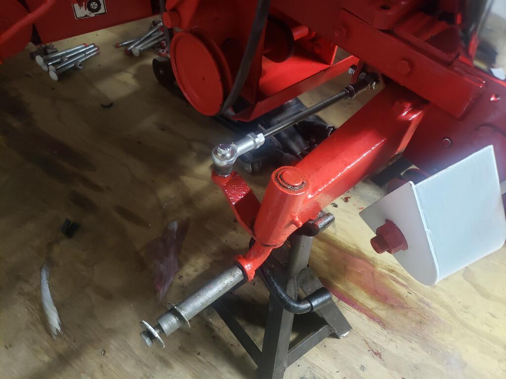

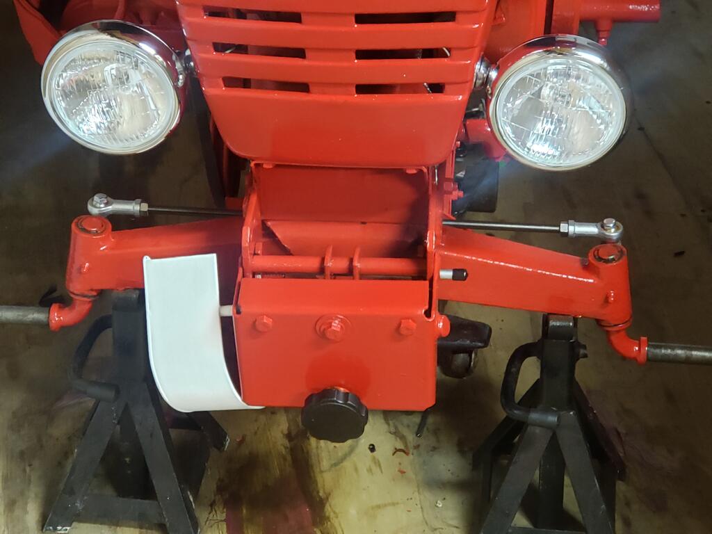

Thegearhead0324 1,850 #18502 Posted March 5, 2023 The ol 1257 got new home made tie rods today (greasable.) 5 11 Share this post Link to post Share on other sites
Handy Don 17,500 #18503 Posted March 6, 2023 57 minutes ago, Thegearhead0324 said: tie rods today What diameter rod did you use? 1 Share this post Link to post Share on other sites

Thegearhead0324 1,850 #18505 Posted March 6, 2023 6 hours ago, Handy Don said: What diameter rod did you use? 3/8-24 stainless rod and hardware, all from Amazon. 1 1 Share this post Link to post Share on other sites

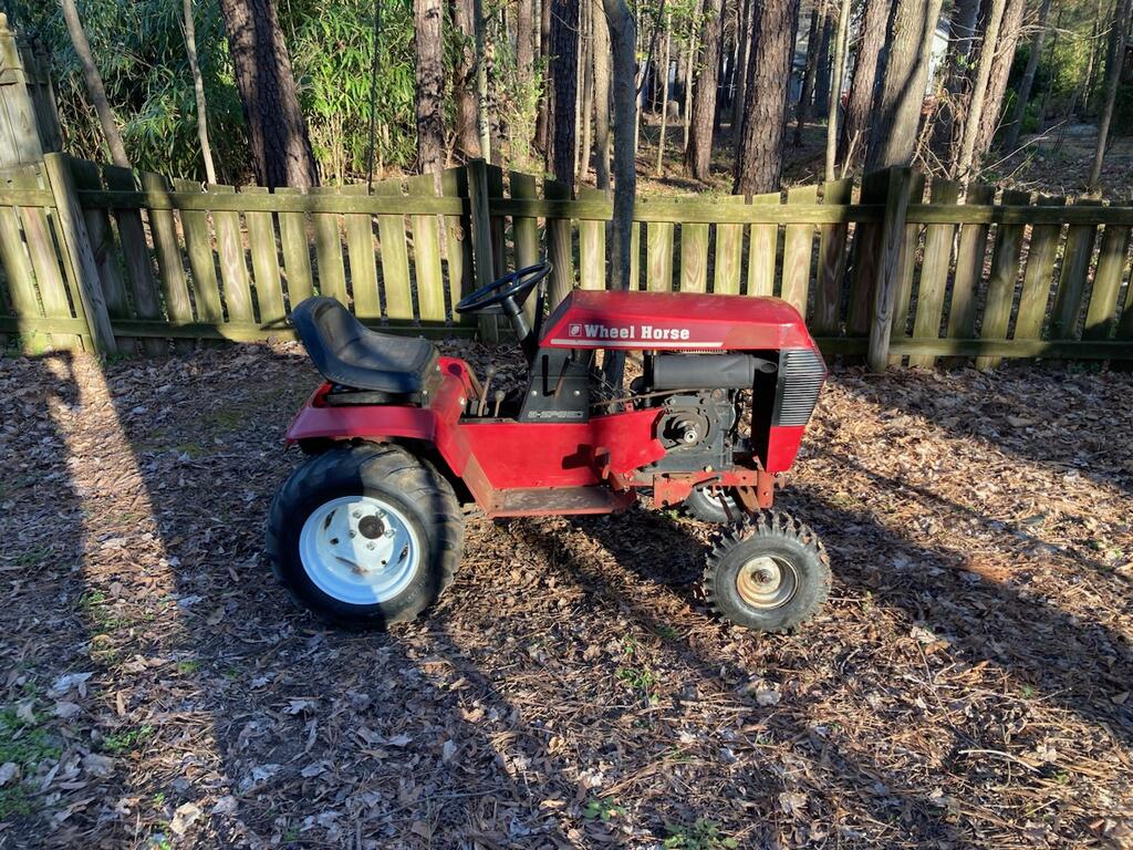

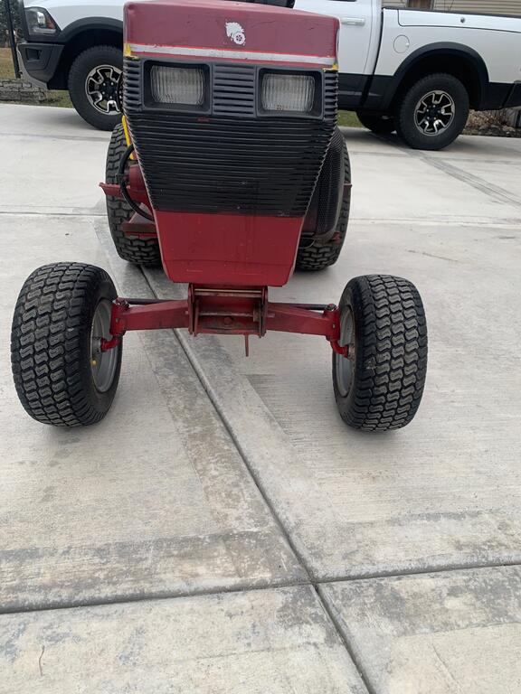

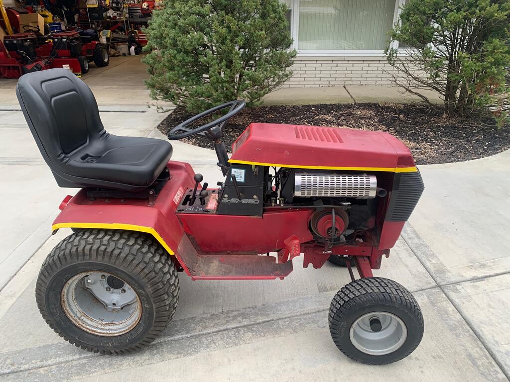

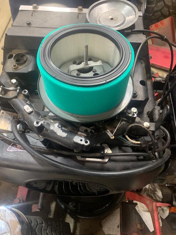

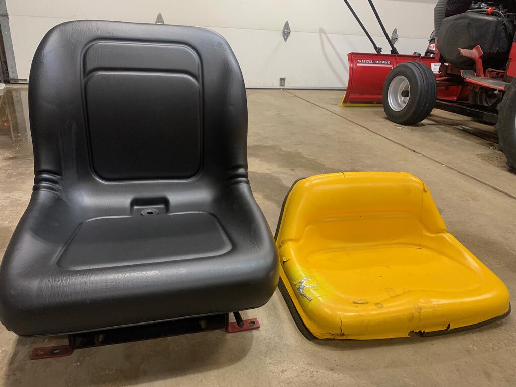

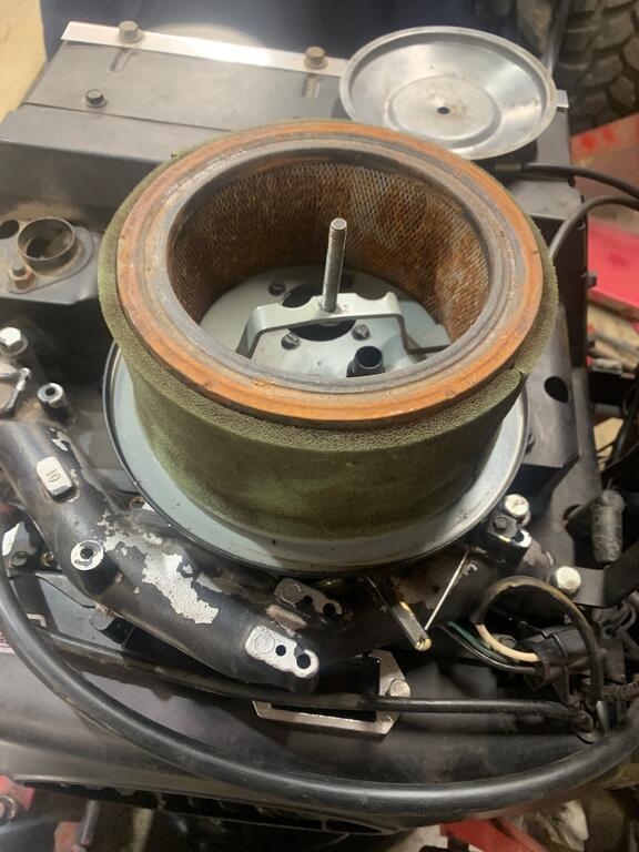

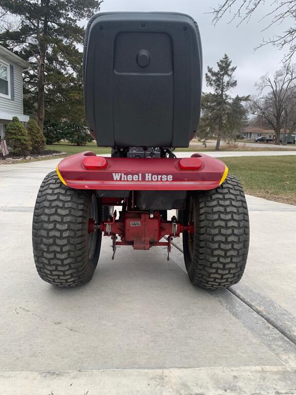

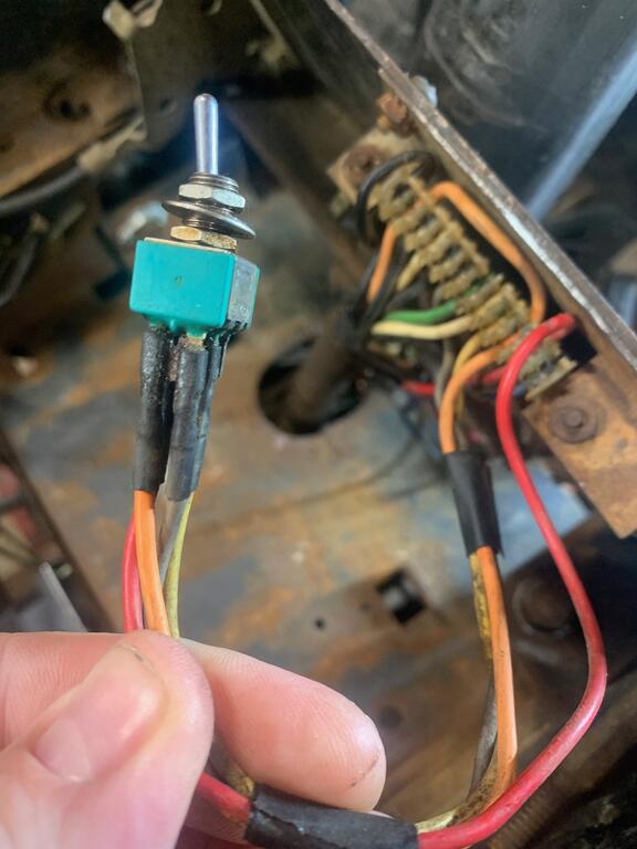

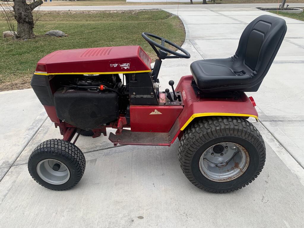

Andy N. 2,838 #18508 Posted March 6, 2023 Finally got the 418-8 running and ready to be a tiller tractor. I bought this back in November. It wasn't running and kept blowing the main 25 amp fuse when the key was turned to run from off. None of the tires held air for very long so I had an ok set sitting around that got installed. All the safety switches showed some kind of resistance when they shouldn't so I replaced them all as well as several electrical connections that were loose and/or broken from age. The test switch was shorted internally which is what was blowing the fuse. PO would jump the contactor in order to try to start the tractor so I replaced that and the starter. All of the transmission seals were leaking so I replaced them along with the oil that probably hasn't been changed since the '90's. New engine oil, air filter, spark plugs, fuel line and filter. Before: After: Got rid of that awful yellow seat and got one more suiting to a WH. I plan to paint the tins in the spring after the garden is tilled and weather is warmer. 015b87783f8ac110005f3500bf62f00c6fdf678ff8.mp4 6 6 Share this post Link to post Share on other sites
Handy Don 17,500 #18509 Posted March 6, 2023 1 hour ago, Andy N. said: Finally got the 418-8 running Wait! Aren’t there gullible JD fans that would pay big money for that seat!? 1 4 Share this post Link to post Share on other sites
Andy N. 2,838 #18510 Posted March 6, 2023 6 minutes ago, Handy Don said: Wait! Aren’t there gullible JD fans that would pay big money for that seat!? I'm sure there are, but I really wanted to just chuck it in the trash because I hate yellow seats on red tractors! 3 2 1 Share this post Link to post Share on other sites
SylvanLakeWH 32,618 #18511 Posted March 6, 2023 14 minutes ago, Handy Don said: Wait! Aren’t there gullible JD fans that would pay big money for that seat!? 5 minutes ago, Andy N. said: I'm sure there are, but I really wanted to just chuck it in the trash because I hate yellow seats on red tractors! The yellow painted over duct tape is an added bonus to dumpster dive that seat!!! 3 Share this post Link to post Share on other sites
kpinnc 18,980 #18512 Posted March 6, 2023 41 minutes ago, Andy N. said: I'm sure there are, but I really wanted to just chuck it in the trash because I hate yellow seats on red tractors! I love the pic of the seat in it's proper place! 1 2 Share this post Link to post Share on other sites

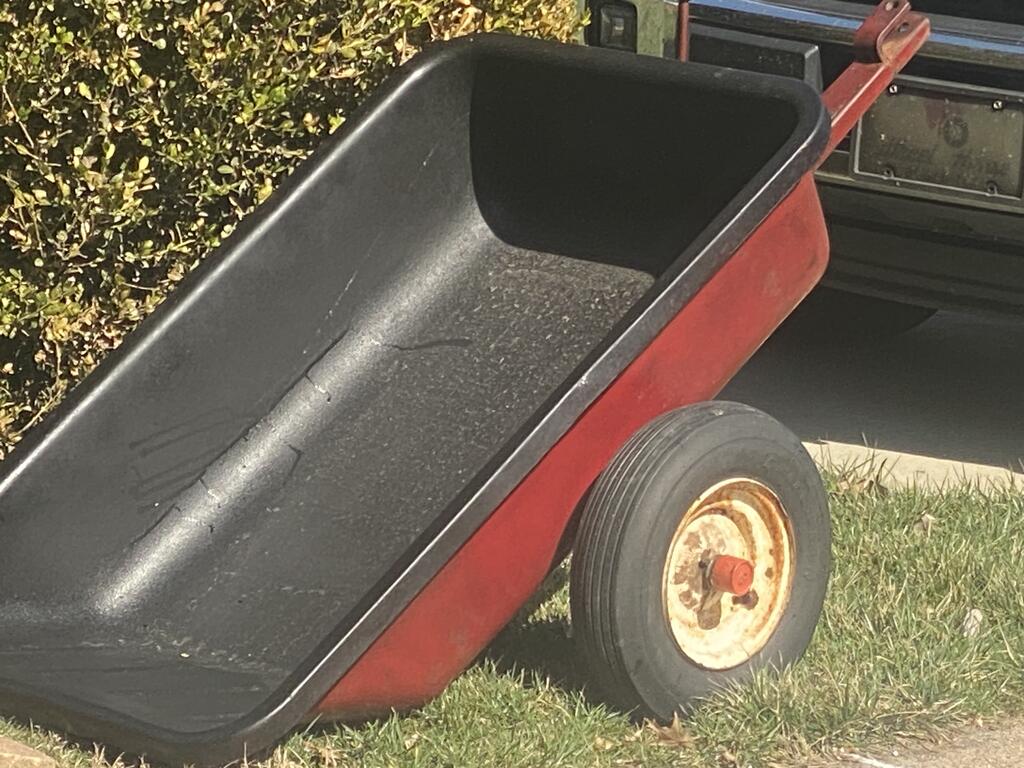

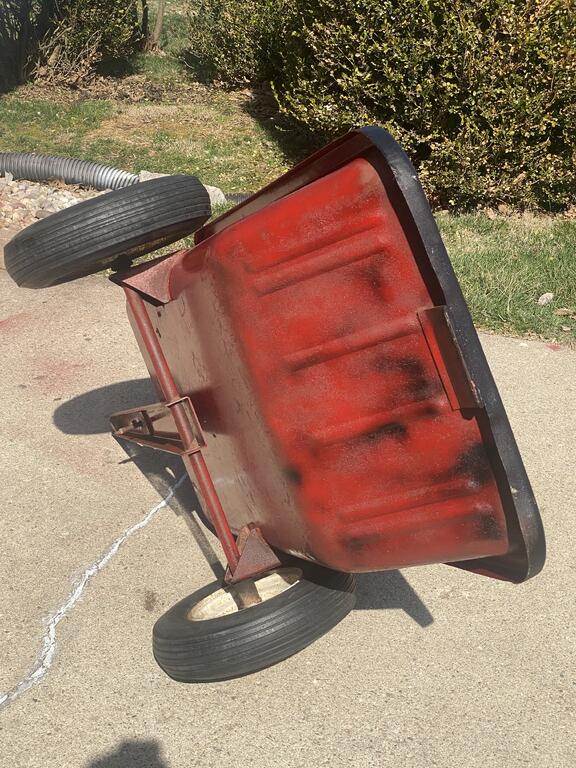

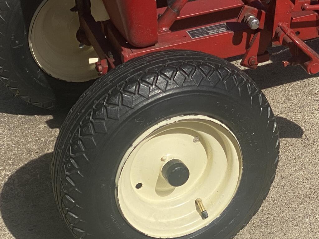

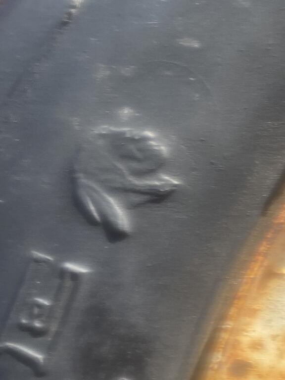

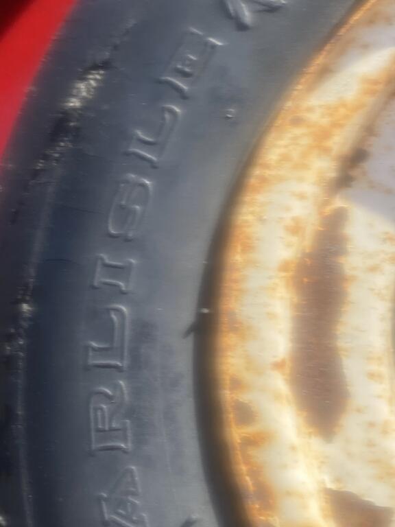

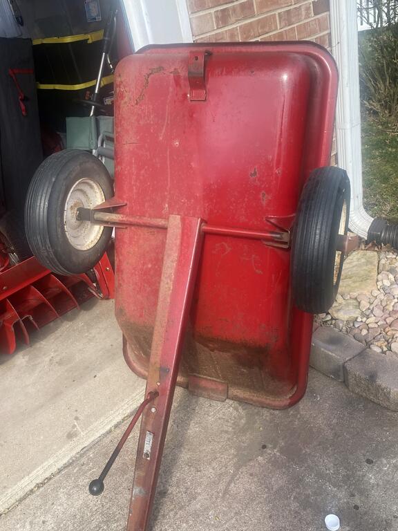

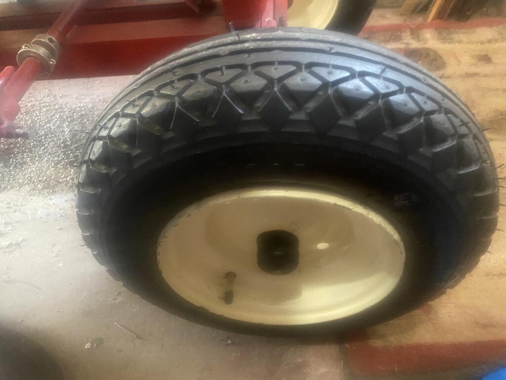

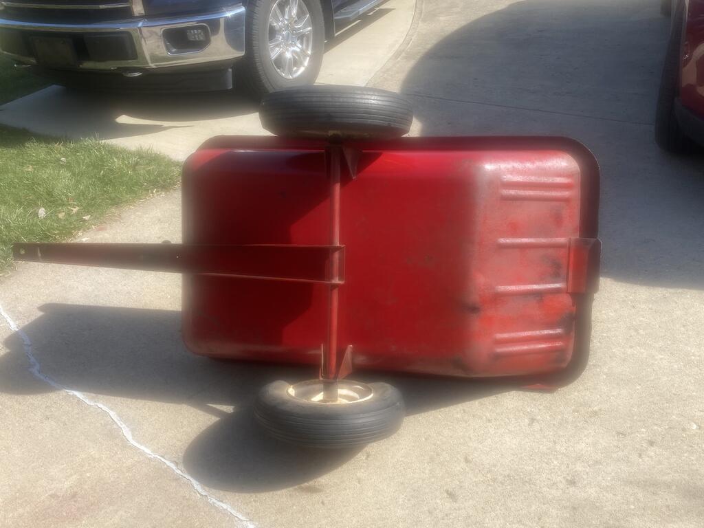

Lane Ranger 12,114 #18513 Posted March 6, 2023 I I bought a Wheel Horse dump cart from Rodney Burger in Florida last week. I sprayed bed with truck bed liner and the underside with boiled linseed oil that protects and brings out the color! This cart has the early Indian head Carlisle tires. Still hold air but several cuts and bruises! I also finally put my new old stock Goodyear tires on the from of my one of my RJs. These are rare tires. 7 3 Share this post Link to post Share on other sites

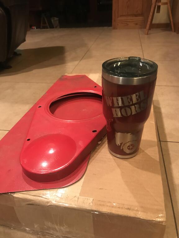

oliver2-44 11,758 #18514 Posted March 7, 2023 (edited) Had a package from waiting for me when I got home this evening. Cup looks great, Thanks @19richie66 I also acquired some of the 953 parts I'm missing @Horse Newbie Edited March 7, 2023 by oliver2-44 6 Share this post Link to post Share on other sites

peter lena 10,077 #18522 Posted March 7, 2023 @Thegearhead0324 have 3/8 heims on my steering joints for years , initially was a trial / test for durability , never had a problem / failure . if I were into heavy trail / rough stuff , 1/2" would be plenty . tried similar test on clutch linkage , pto lever rod end . nothing but solid / smooth . pete 1 Share this post Link to post Share on other sites
