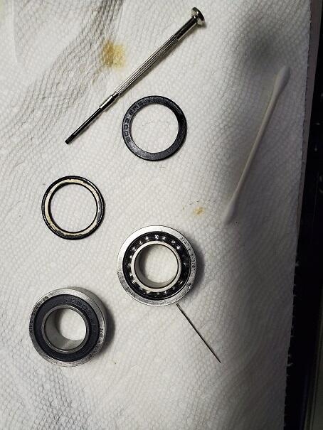

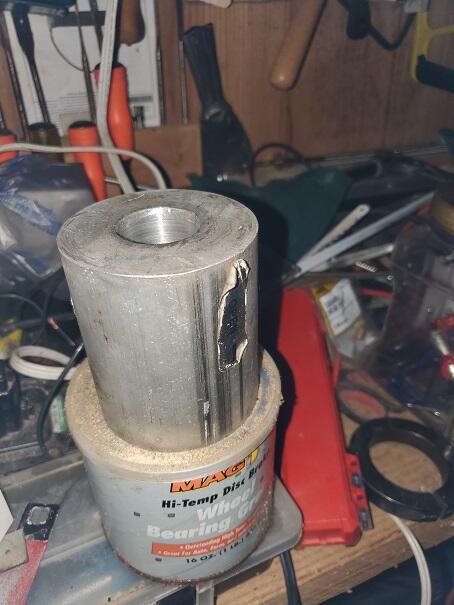

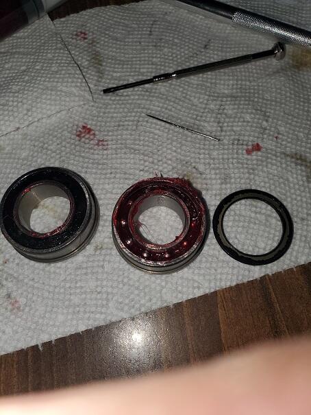

GAJoe 852 #18330 Posted January 22, 2023 (edited) I got my other tire mounted on Friday and went to put it back on but noticed a bad wheel bearing. I did a search and found the XiKe bearings that several use from Amazon and got a four pack on order. Yesterday when I checked the tracking they were due to arrive today on Sunday so I got prepared to remove and replace the seals to do a grease swap-out with Lucas Red that I had in a gun. (Saving the green for mower deck spindles and mule bearings.) This was my first time removing the seals and cleaning the cheap grease out. It wasn't difficult just time consuming; but should pay off in the long run. Everything was going well on schedule until I went to put the new bearings in. The outboard went in about half way with just a tap or two to have it set in the hub but the inboard was loose in the hub. I don't know if the original was large of if I didn't progress in small enough increments when I knocked it out. Regardless I needed to find a way to reduce the hub diameter so that the outer race would snug up and stop spinning freely. I could see the hub around the shoulder of the bearing on this side by a few thousandths. I measured and it was around 1.508" outer diameter. I needed a swaging tool that would squeeze it to something close to 1.500". Then I remembered that the main rear axle shaft roller bearing was about what I needed. I located my old bad bearing and found that one inside diameter was champhered at a 45 and the other was rounded nicely. But how would I maintain the axle bearing centered around the shoulder of the new bearing to swage the hub evenly and not make a mess of it. I cut up an aluminum soft drink can into a few 1/4" strips that fit nicely inside the axle bearing inside diameter and around the new wheel bearing shoulder. It took three layers to get rid of the slop and hold things in place. I rested the opposite bearing outer shoulder on my big aluminum cylinder (Resting on plywood on the basement floor not the can of grease.) so that the inner race wouldn't take any of the force to swage the hub. I laid a heavy plate of steel on the old axle bearing and smacked it sharply with a two pound hammer. When I lifted the plate to my delight the axle bearing was driven down onto the wheel hub. I got the axle bearing removed and the wheel bearing still had a little play in it so I repeated the process but now didn't need the shimming to keep the axle bearing centered. This time the wheel hub was swaged firmly around the wheel bearing. The old axle bearing will go into my growing collection of special improvised WH tools. Edited January 22, 2023 by GAJoe 9 Share this post Link to post Share on other sites

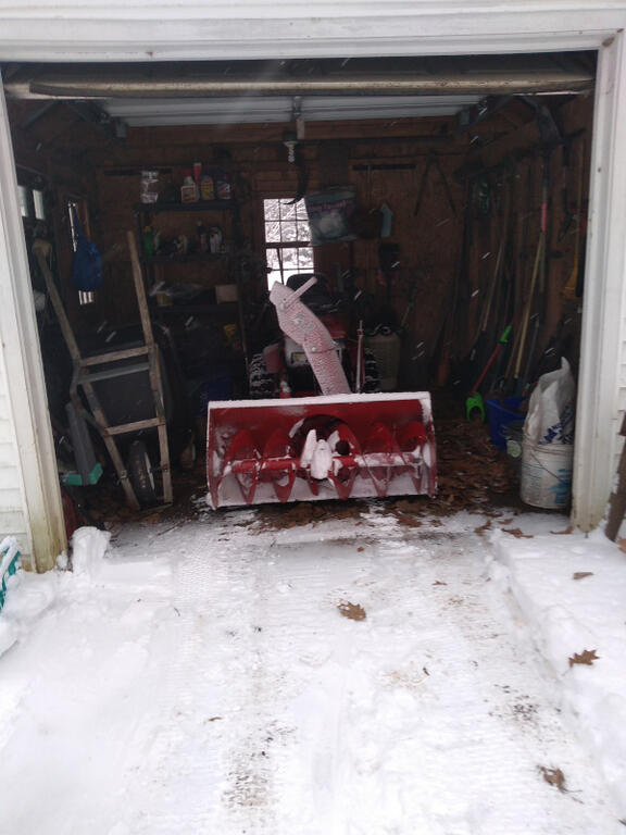

Pullstart 71,333 #18333 Posted January 23, 2023 Moving some stuff around for a visitor today… 5 4 1 Share this post Link to post Share on other sites
19richie66 17,936 #18334 Posted January 23, 2023 39 minutes ago, Pullstart said: Moving some stuff around for a visitor today… Assisted living for Seniors? 1 1 9 Share this post Link to post Share on other sites

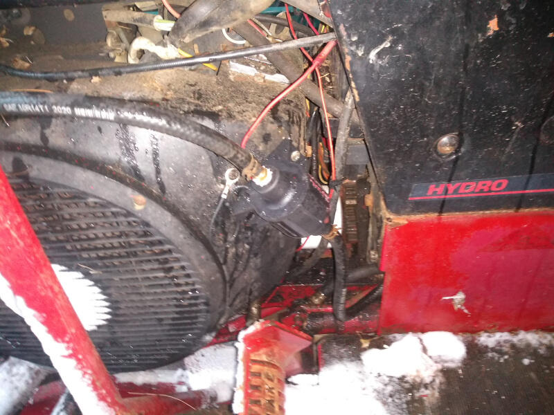

Chestnut 315 #18335 Posted January 24, 2023 Winter has finally arrived in this part of Maine. We had a few storms earlier but I wasn't able to get the WH out to blow snow. I thought I was ready when I moved it into winter shed, but when I went to start it in December I got a handful of gas from the two year old Chinese primer bulb.Then the nipple snapped off the plastic fuel pump (same origin, same vintage). Maybe someday I'll learn. Anyway, the new Facet electric pump was ready to go for the most recent couple of storms. Wiring is still kind of temporary. I wired the pump through a rocker switch the PO installed for headlights. I want to wire through the key/ignition switch but hesitated to hack into the already sketchy wiring. Facet suggested wiring through the oil pressure switch. I was thinking of wiring it through the unused terminal on the 520-H key switch. The wiring diagram shows it should be life in the "run" position. Any suggestions? Also got out for several walks. About time for snowshoes, but my friend is impatient as I fumble with the camera. 6 2 Share this post Link to post Share on other sites
Lee1977 7,786 #18336 Posted January 24, 2023 I wired my 520 through the unused R Terminal on the key switch for the hot wire. The ground wire to a toggle switch then to ground. I can used the toggle to run the carb. dry. 2 Share this post Link to post Share on other sites

Chestnut 315 #18339 Posted January 25, 2023 21 hours ago, Lee1977 said: The ground wire to a toggle switch then to ground. I can used the toggle to run the carb. dry. Thanks. I like the idea of the toggle on the ground to let the bowl run dry. 2 Share this post Link to post Share on other sites

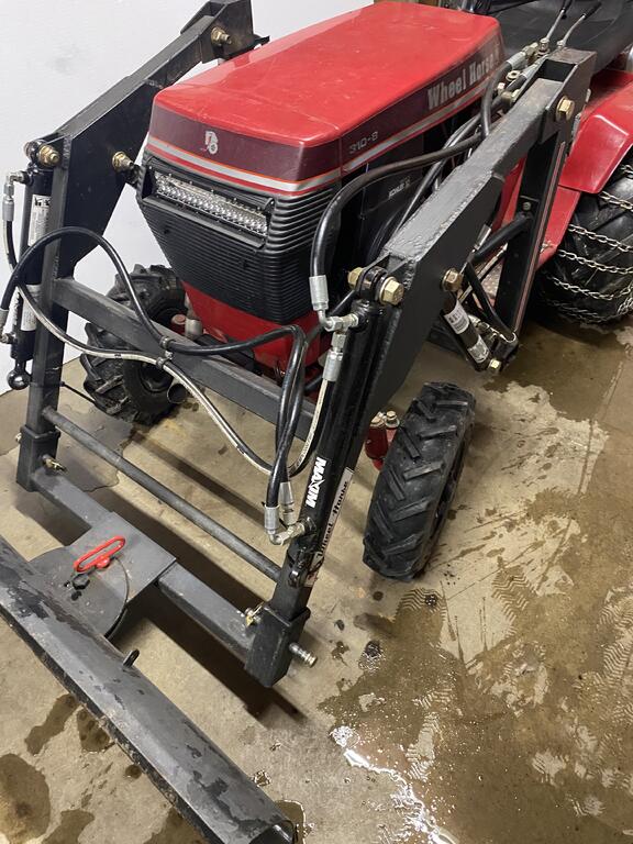

KrazeyOlDave 860 #18340 Posted January 26, 2023 Oops 2 Share this post Link to post Share on other sites
pfrederi 21,190 #18341 Posted January 26, 2023 4 minutes ago, KrazeyOlDave said: Oops That tire looks a bit narrow for that wheel. 1 Share this post Link to post Share on other sites
Blasterdad 3,168 #18342 Posted January 26, 2023 (edited) 2 hours ago, KrazeyOlDave said: Oops That loader is way too heavy for that tire, you can just sell the loader to me, easy fix! Edited January 26, 2023 by Blasterdad 7 Share this post Link to post Share on other sites

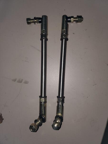

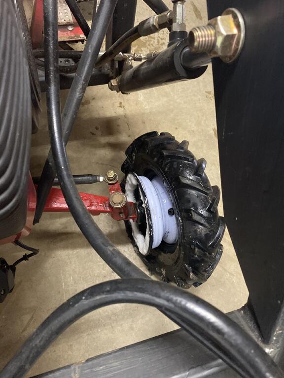

GAJoe 852 #18343 Posted January 27, 2023 (edited) I hope that I have found all the worn out parts. I first told my friend that "they make these things to last forever". But I revised that to "They make these things to be able to repair forever." That's better than what you buy today that are designed to wear out so that you have to buy a new one. I made some new tie rods with grade 7B all-thread in stainless tubing that I had horded. @peter lena Should I put Lucas Red in those ball joints as best I can? Here's the access to the ball. I'm not sure how much grease can get into it. Edited January 27, 2023 by GAJoe added details. 2 8 Share this post Link to post Share on other sites
peter lena 10,077 #18344 Posted January 27, 2023 @GAJoe been using heim joints for years , no failures , like super lube hydraulic oil , for a size to size fit / swivel , also another detail on front wheel bearings , is to washer up the fit for no sloppy side play in use , that sloppy side thrust is what tears up those bearings . have heim joint on my pto lever in place of wobbly trunnion , steering arms , clutch linkage , plow lever pull rod , solid / smooth . don,t be afraid to make an improvement at any point , once you get over that phase . its easy to make things very solid / reliable in operation . also like your bearing regrease , stress related grease failure is common / heat build up , thats why I hype hi temp grease, you are on the right track . pete 2 1 Share this post Link to post Share on other sites
KrazeyOlDave 860 #18345 Posted January 27, 2023 On 1/26/2023 at 9:32 AM, pfrederi said: That tire looks a bit narrow for that wheel. Nah, it’s perfect 2 1 Share this post Link to post Share on other sites
kpinnc 18,982 #18346 Posted January 27, 2023 3 hours ago, KrazeyOlDave said: Nah, it’s perfect I'd like to see more on that headlight assembly you got there... Share this post Link to post Share on other sites
GAJoe 852 #18347 Posted January 27, 2023 (edited) 22 hours ago, GAJoe said: I made some new tie rods with grade 7B all-thread in stainless tubing that I had horded. I got the tie rods mounted and torqued. Did the greasing of the spindles while up in the air. Greased the steering shaft and the front end pivot. Hopefully my input seal and belt will get here from Wheel Horse Parts and More so I can get everything back together finally. Got my bearings and seals for the mower deck spindles on order. Edited January 28, 2023 by GAJoe 1 1 Share this post Link to post Share on other sites
peter lena 10,077 #18348 Posted January 28, 2023 @KrazeyOlDave think the smaller tires are the way to go with potential front end loading / tire bite , as any of us build up , make a change , you are the guy doing the work , so your thoughts are what is going in , made many myself , often tweaked as I check it for function , usually just a finishing adjustment , would not dare to give away any experimental stuff I have done , in enough trouble , pete 1 Share this post Link to post Share on other sites
peter lena 10,077 #18349 Posted January 28, 2023 @GAJoe stay at it , thoroughly verify any changes you make , also related connection points , amazing to me , the functional moving ease that comes to a trouble spot . done this so often , its like a no brainer , to just do it . heim joints , cable lubrication and spring pull, secure grounding , fuel check valve , on and on . just wonder how anyone can think that consistent difficult issues , is ok and cannot be eliminated . make it better , pete 2 Share this post Link to post Share on other sites
