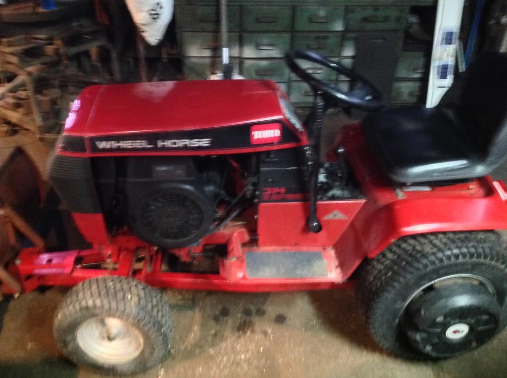

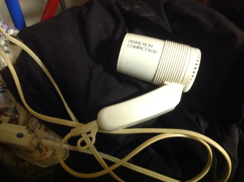

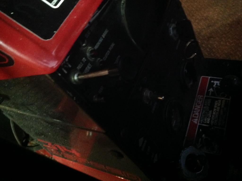

Lane Ranger 12,043 #1759 Posted January 11, 2019 (edited) Went out this am at my brother David's place to see if the 314 Wheel Horse was all ready for removing snow in the drive . We are expected to receive a good bit of snow tonight and Saturday. As I got ready to start the tractor I found out the choke cable was frozen and would not move. So I used a technique that I have used before. Brought out a hair dryer and set it on the handle, cable and motor linkage for a few minutes. Loosened up and I then sanded the choke handle end and lubed with grease. Works great now! So should start right away. Edited January 11, 2019 by Lane Ranger 6 Share this post Link to post Share on other sites
ebinmaine 79,769 #1760 Posted January 11, 2019 4 minutes ago, Lane Ranger said: Went out this am at my brother David's place to see if the 314 Wheel Horse was all ready for removing snow in the drive . We are expected to receive a good bit of snow tonight and Saturday. As I got ready to start the tractor I found out the choke cable was frozen and would not move. So I used a technique that I have used before. Brought out a hair dryer and set it on the handle, cable and motor linkage for a few minutes. Loosened up and I then sanded the choke handle end and lubed with grease. Works great now! So should start right away.bn That's good info n an awesome trick right there 1 Share this post Link to post Share on other sites

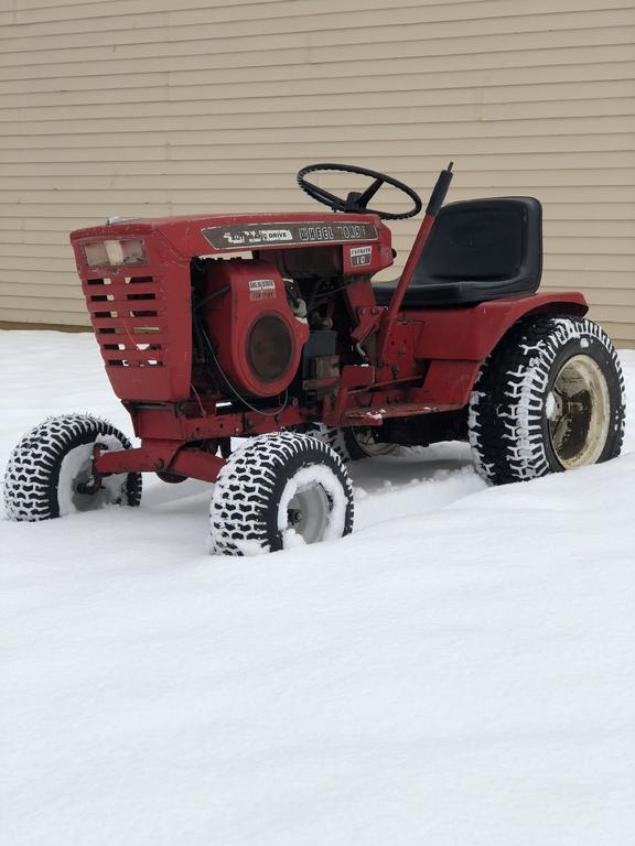

LengerichKA88 1,885 #1764 Posted January 12, 2019 (edited) I finally got to play in the snow!! I only did one pass for the sake of saying I did... that one pass taught me that I need more weight, and more traction. But dang it, I got to push! 😂😂 Figured you’d rather see my wife’s pretty face rather than my old mug 😂 After working, I took the Charger 10 out to play for a bit. Everyone else was shoveling and I was playing Edited January 12, 2019 by KyleLengerich 3 7 Share this post Link to post Share on other sites

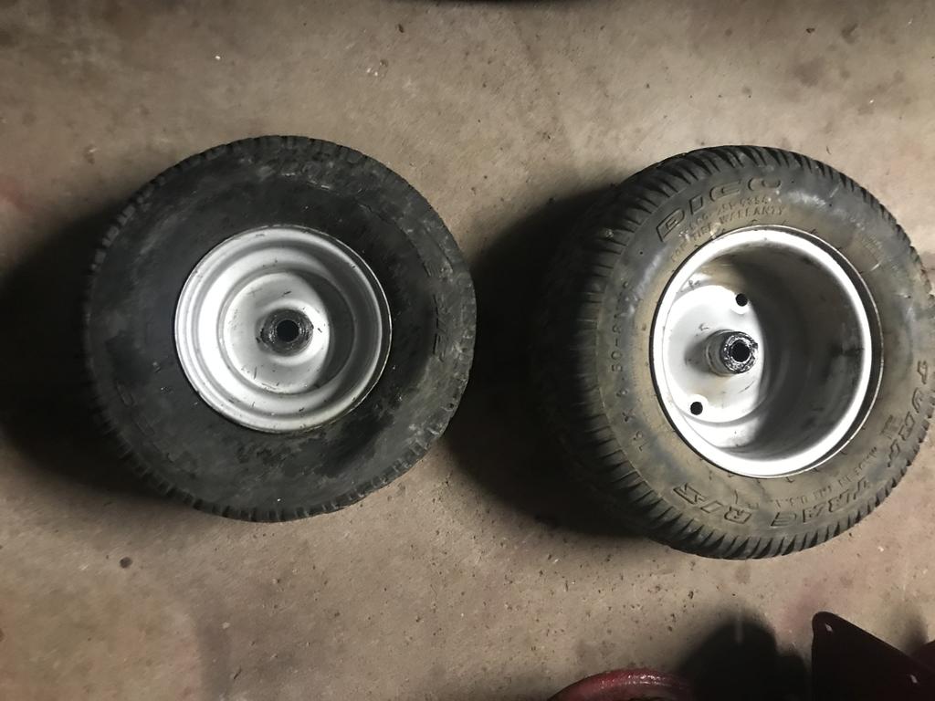

pfrederi 20,923 #1765 Posted January 12, 2019 Breaking down some tires so I can sand blast the wheels. Dummy me forgot to bring them into the heated part of the shop last night It was 11 degrees this morning.. Cold stiff old tires are harder to deal with. 1 1 Share this post Link to post Share on other sites
peter lena 9,965 #1766 Posted January 12, 2019 never liked the 6" wheel , always thought it made the tractor look cheaper, always changed over to the 8" wheel , retaining the old school look. pete 3 Share this post Link to post Share on other sites
LengerichKA88 1,885 #1767 Posted January 12, 2019 29 minutes ago, peter lena said: never liked the 6" wheel , always thought it made the tractor look cheaper, always changed over to the 8" wheel , retaining the old school look. pete Eventually I’m going to put a nice set of Tri Ribs on the front and AGs on the back, I prefer the old school look too. I do have a birthday coming up, I might ask for em 😂 2 Share this post Link to post Share on other sites
WVHillbilly520H 10,378 #1768 Posted January 12, 2019 3 hours ago, KyleLengerich said: I finally got to play in the snow!! I only did one pass for the sake of saying I did... that one pass taught me that I need more weight, and more traction. But dang it, I got to push! 😂😂 Figured you’d rather see my wife’s pretty face rather than my old mug 😂 After working, I took the Charger 10 out to play for a bit. Everyone else was shoveling and I was playing Was never a fan of the "chevron" tread pattern prefered the "peanut" tread pattern turf tires, but I am down for some AG bar tires. 2 Share this post Link to post Share on other sites
LengerichKA88 1,885 #1769 Posted January 12, 2019 8 minutes ago, WVHillbilly520H said: Was never a fan of the "chevron" tread pattern prefered the "peanut" tread pattern turf tires, but I am down for some AG bar tires. The ones on there are the set I picked up from Lowe’s to use as a floating set. I have plans for them in the future, but for the time being they’re way safer than the ones that were on there. its going to be some time before it looks like I picture in my head, but that Charger 10 is going to look like a Farmall H one of these days. 3 Share this post Link to post Share on other sites

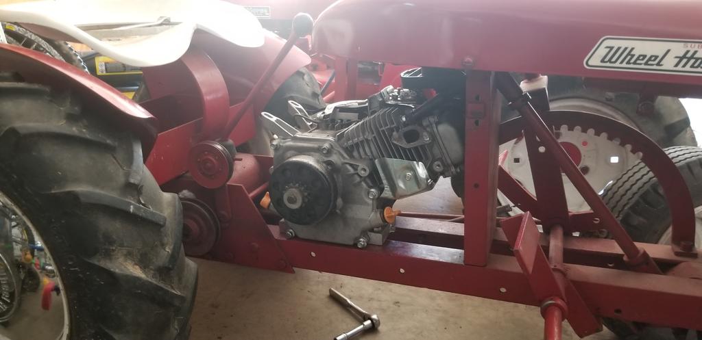

Shed 377 #1775 Posted January 14, 2019 Well I got a great deal on a predator 212 6.5 hp motor. I was not a fan of the briggs that was on my suburban it was to big to much stuff and didnt allow me to run the factory wheel horse fuel tank. So as I was unable to find the original motor I wanted something else. These motors have a huge aftermarket following too. I also am running a cintrfical gokart clutch and chain so all you need to do is incress rpm and it moves it will be better for my kid to run. It will still have a cover I'll need to make and they even make an electric start kit which my suburban had originally (I believe) either way it be cool 3 2 Share this post Link to post Share on other sites
