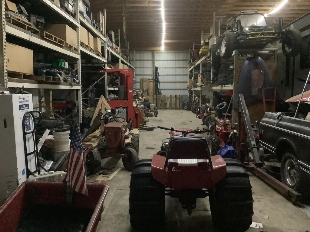

Pullstart 70,645 #17651 Posted November 12, 2022 I made some room for more indoor storage today…. Took up 40’ of space for the camper and found an entire hallway from back wall to door practically! 4 4 1 Share this post Link to post Share on other sites

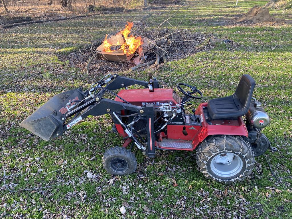

KrazeyOlDave 860 #17654 Posted November 12, 2022 Almost time to switch out the bucket for the blade 😢 9 1 Share this post Link to post Share on other sites

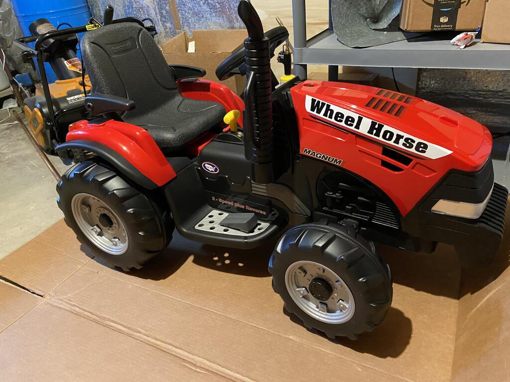

Reddart 213 #17660 Posted November 13, 2022 Snuck this into the basement, assembled and put on the decals. I can’t wait until Christmas for my five year old daughter to see this. 3 4 10 Share this post Link to post Share on other sites
sjoemie himself 3,117 #17661 Posted November 13, 2022 16 minutes ago, Reddart said: Even has a Kohler in it 1 3 Share this post Link to post Share on other sites

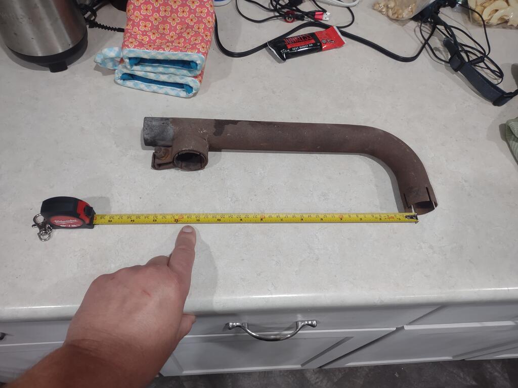

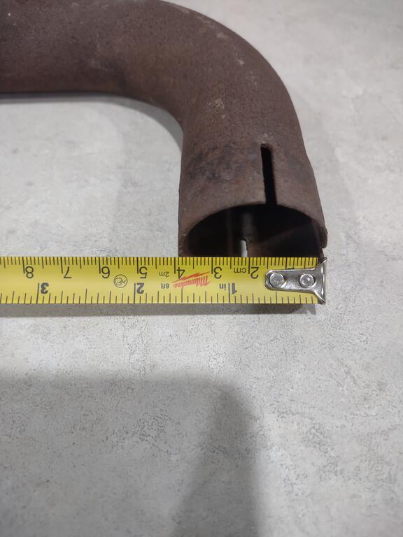

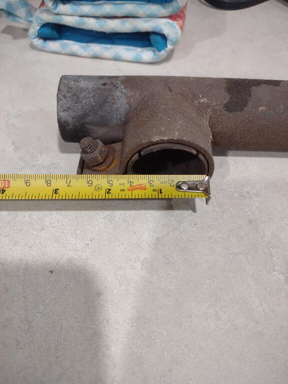

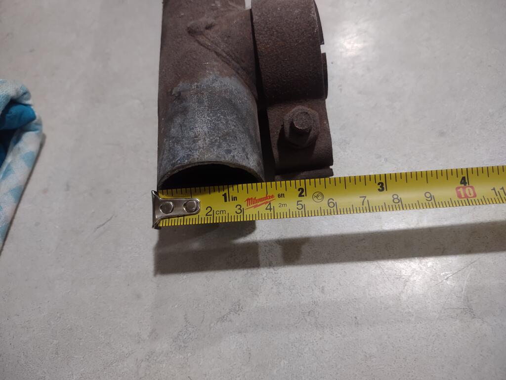

ebinmaine 79,633 #17664 Posted November 13, 2022 On 11/10/2022 at 6:01 PM, 8ntruck said: - Finally got around to measuring this afternoon. The port to port spacing looks to be 11 1/2", with about a 3" offset parallel to the crank, with the rear cylinder being closer to the tractor centerline Bill you s'pose this pipe would help you? 1 Share this post Link to post Share on other sites

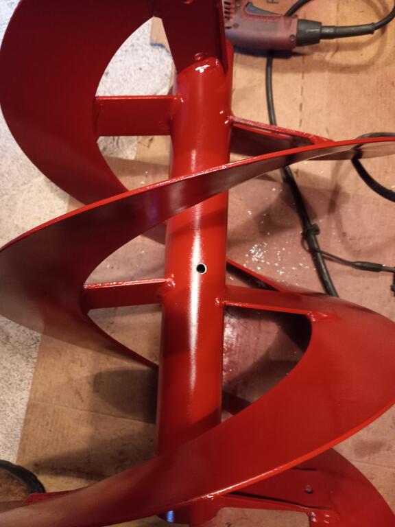

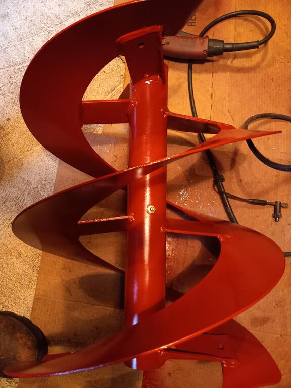

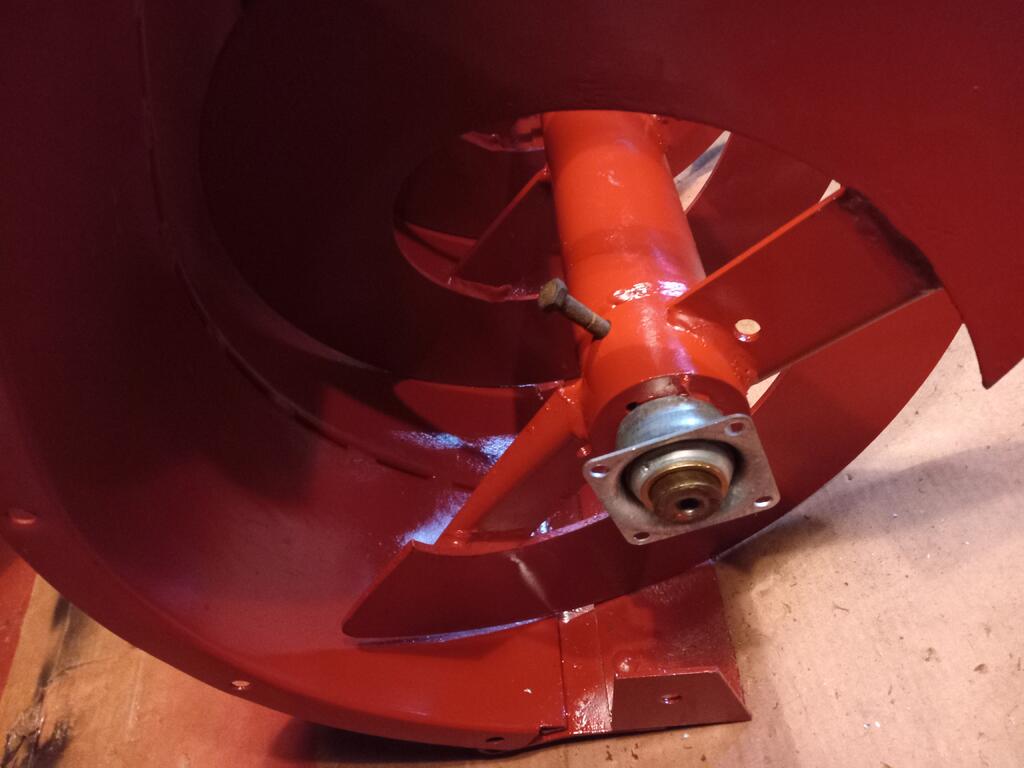

Panther416-8 342 #17665 Posted November 13, 2022 Drilled and tapped the snowblower augers for grease fittings. 8 Share this post Link to post Share on other sites

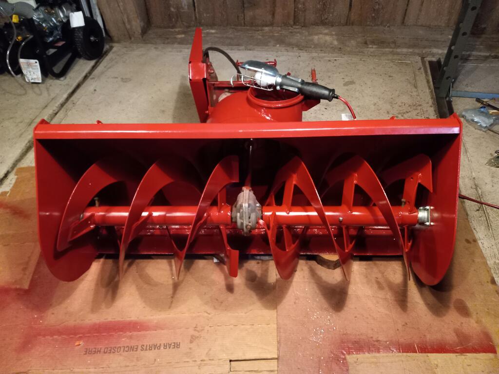

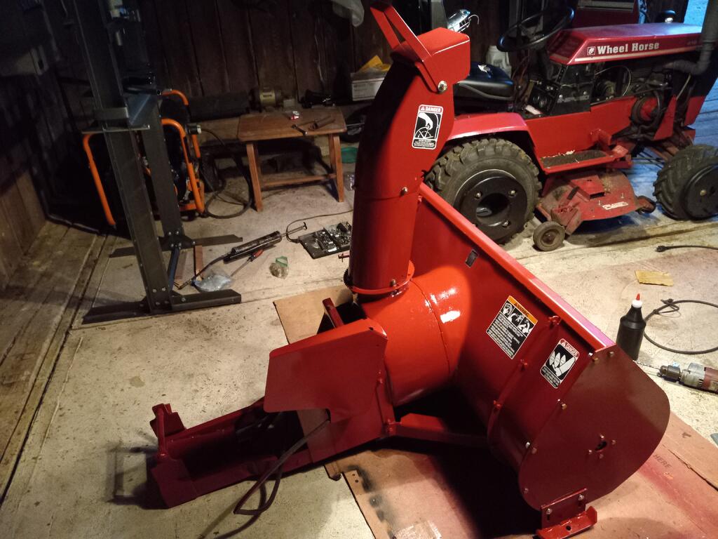

Panther416-8 342 #17666 Posted November 13, 2022 Almost finished with the snowblower I picked up in August. Re-assembled after stripping, sanding, priming and top coating with Rustoleum regal red. Replaced the auger shaft bushings and inside bushing support flange that were ruined when removing the old bushings. Filled auger gearbox with 00 grease and greased impeller bearing. Soaked chain with open chain/cable lubricant but need to replace the nylon tensioner block. The block has very little wear but one of the bolts must have have stripped out the inside as the nut never tightens up. Need to order a new one from aztractor tomorrow. None too soon as it's snowing pretty good out there. 2 7 Share this post Link to post Share on other sites
Panther416-8 342 #17667 Posted November 14, 2022 Chute pieces back on. Need to swap in the new belt next and use a needle adapter to grease the pulley bearings and then I'll be ready to begin hooking it up to the 416. 3 1 Share this post Link to post Share on other sites

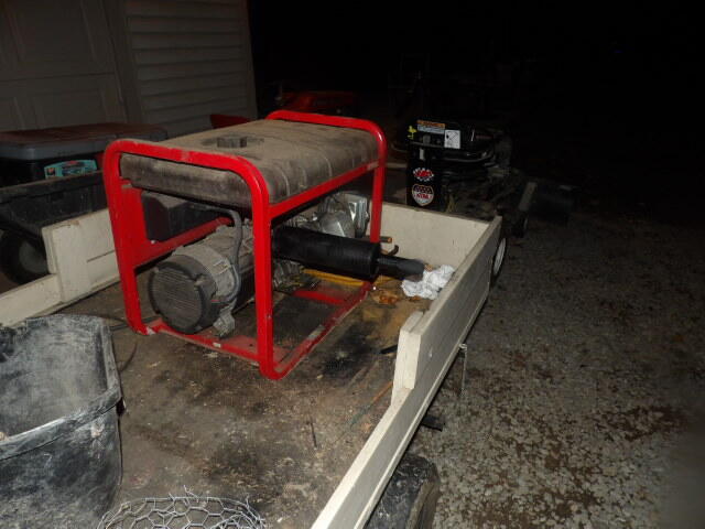

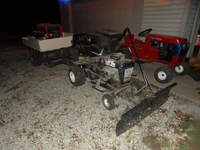

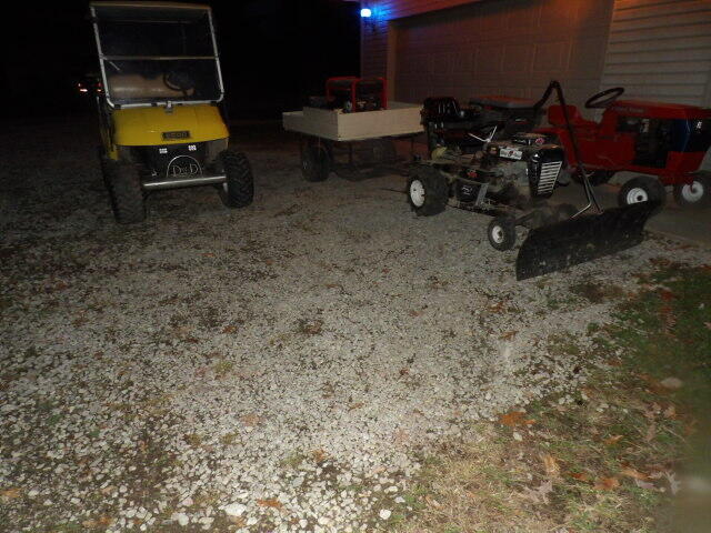

Snoopy11 5,731 #17670 Posted November 14, 2022 @8ntruck... I had a day of "might as wells" ...you don't think it's catching, do you? I needed to do some work on the chicken coop today, so I hooked up the trailer with the generator to haul out to the coop area. BUT... the fuel system was leaking... so you know what that meant... I'll just put it this way, everything on the generator now works perfectly... the muffler has been replaced with the old one from the 416-8 @davem1111... you should recognize it... new spark plug, changed the oil... etc. And the trailer is fixed... (it had various issues) including a bad valve stem on one of the tires. All I really needed to do was replace a cracked fuel filter... all the other stuff was "might as well" L-157 performed excellently, as expected. I made some slight modifications to it recently, so the weight from the trailer was a great test drive! No matter what I pull with the L-157, I can't get the engine to bog down... just absolute bossy power. (sorry it's a little dirty, it's been sitting for a while in the shop)... That muffler is a lot quieter than the old one. I ended up fixing that muffler and welding it on... so it's permanent. (paint is drying in the photo). The old muffler was ROTTONE... Don 3 1 Share this post Link to post Share on other sites

8ntruck 9,039 #17672 Posted November 14, 2022 (edited) @Snoopy11 'might as wells' could possibly be contagious. Be interesting to see if anybody else posts about them. @ebinmaine I need the next piece downstream from that pipe. However, if that piece is in your way, I won't mind putting it in my inventory, as KT parts are rather rare. @Pullstart I was thinking of a c clamp to help the the tire bead into the drop center of the rim. The only problem is that the largest ones I have in stock here are 4" clamps. Edited November 14, 2022 by 8ntruck 1 Share this post Link to post Share on other sites

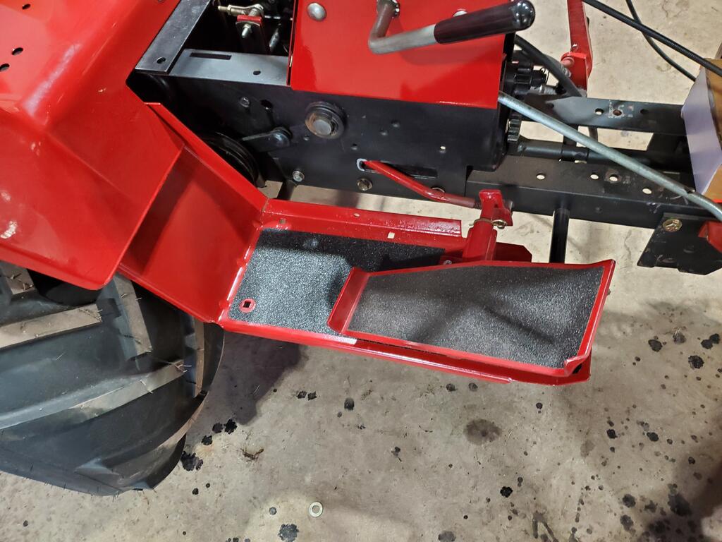

Thor27 891 #17673 Posted November 14, 2022 (edited) So, today I installed a 8-3900 foot control. I have an original, and one of the re productions. Noticed the linkage was bent a bit "off" so I dug out the original to compare, having both together I figured how to correct. clamped it in the vice, hit it with the rosebud and made it look just like the other. Problem was I bent the wrong one..... Ooooops. Result was I spent a good portion of the day making sure both would fit again. Edited November 14, 2022 by Thor27 Add pics from phone 6 2 Share this post Link to post Share on other sites
Thor27 891 #17674 Posted November 14, 2022 BTW, to who ever made these repops did a great job. 1 Share this post Link to post Share on other sites
