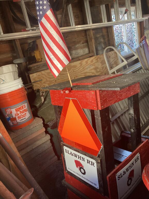

Mounted a slow moving vehicle triangle on my caboose for the SL&WHN RR. It's in addition to the blinking red led lights...
Lousy pic - forgot to take it before I put it in storage... :hide:

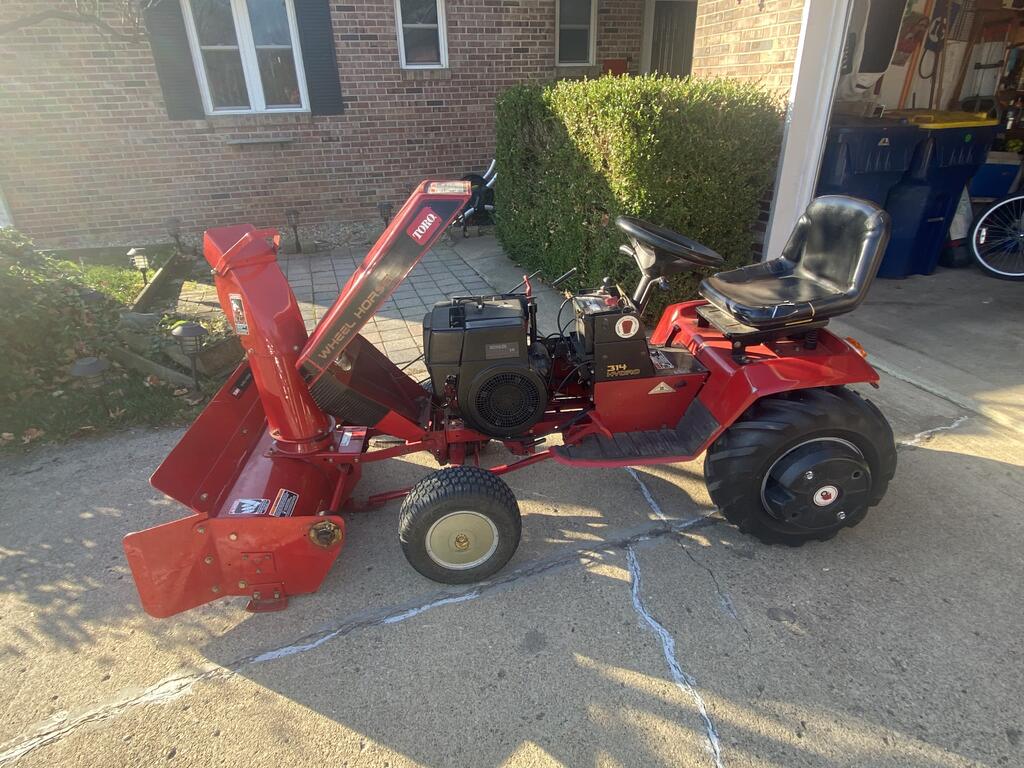

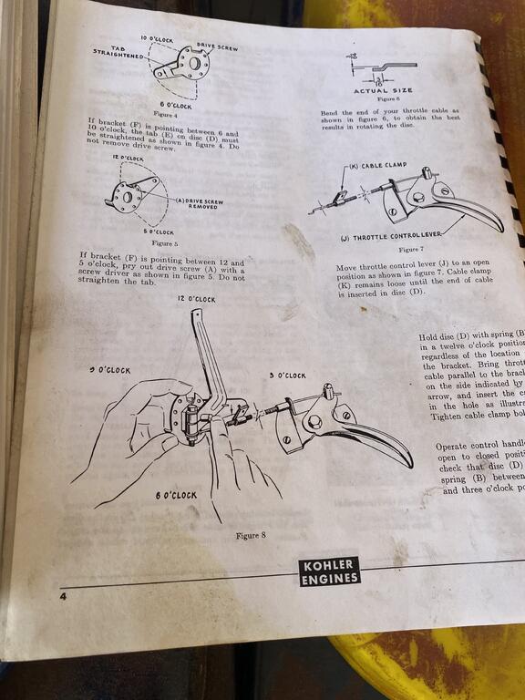

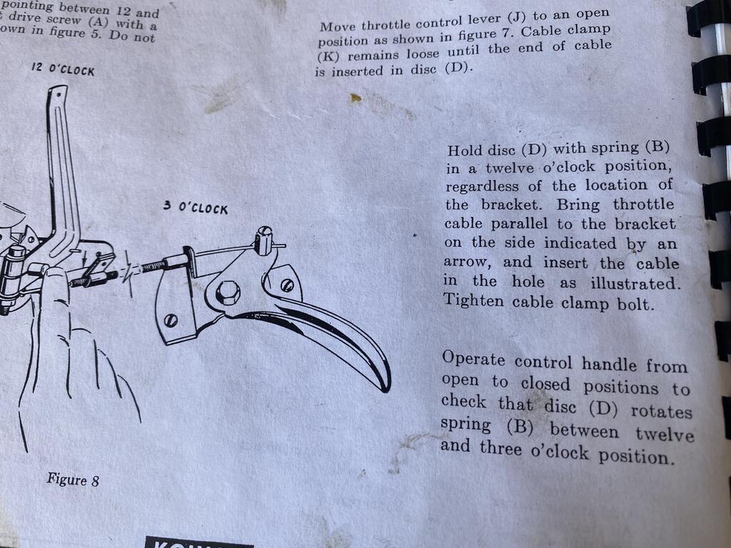

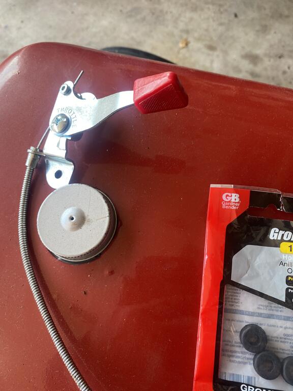

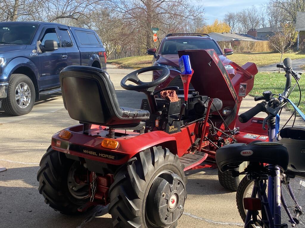

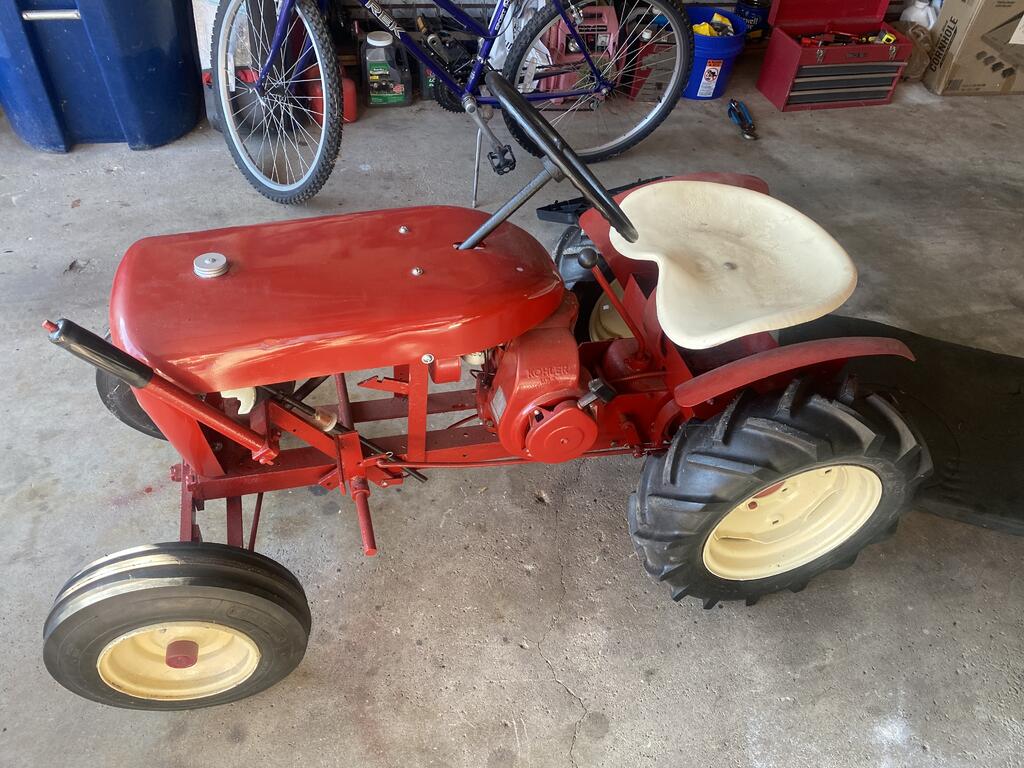

Doing a bunch of Wheel Horse work today!   Oil and gas in the 314 hydro with snowblower!  Getting ready for who knows what!

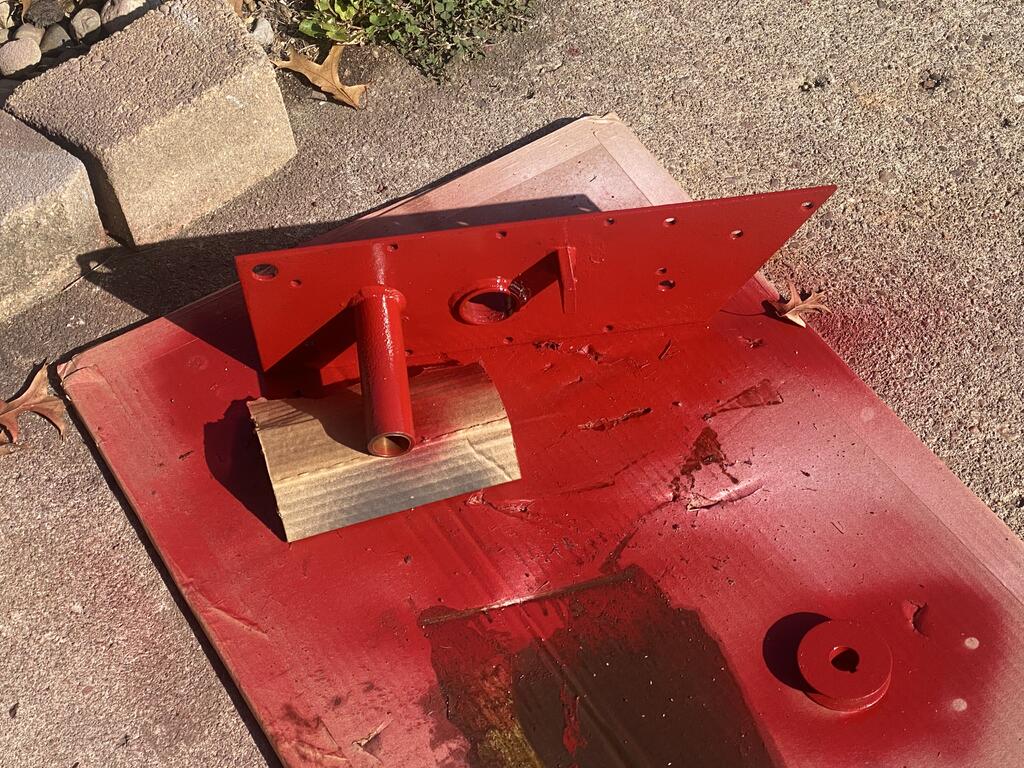

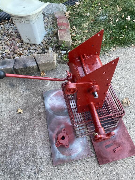

Also painting a couple RJ transmissions I have.  Going to switch one on my RJ I am doing for my brother ( been an off again on again project since late 2020) !   The transmission in it was rebuilt but tight in differential.  When wheels are on ground the axles tighten up.   I think the brass axle bushings were not honed enough but I will remove and work on it off the tractor. I have two others that are ready work and to install!

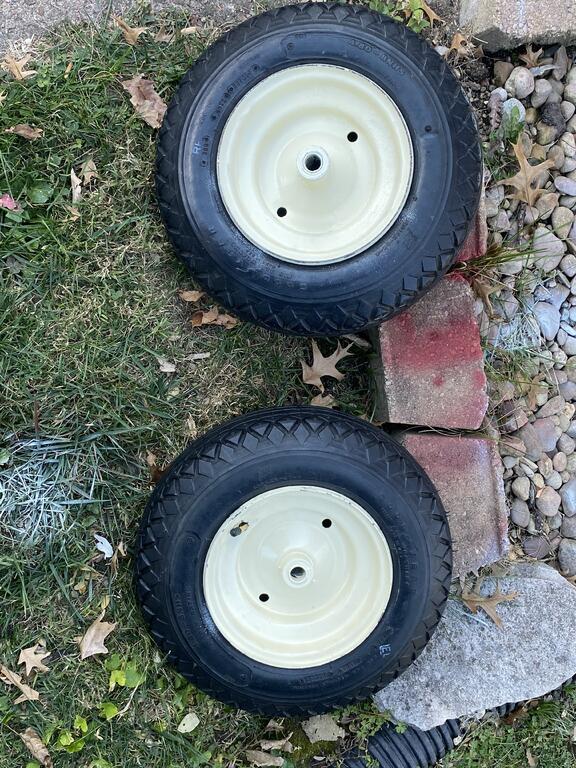

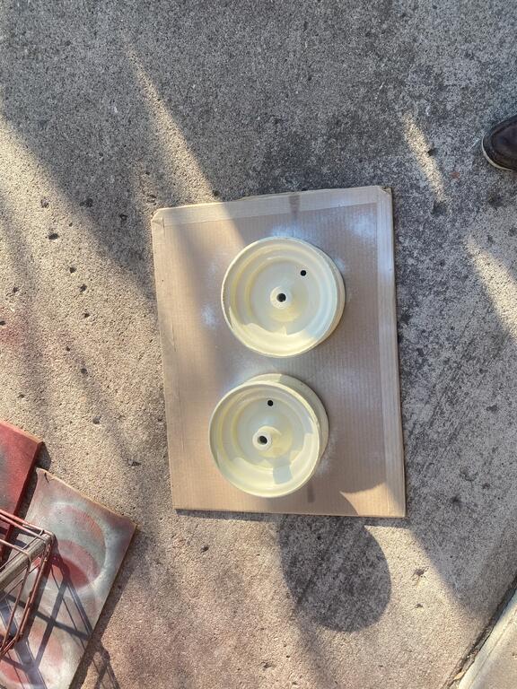

Also painted some wheels and took a pair of NOS early RJ tires to get installed this am.

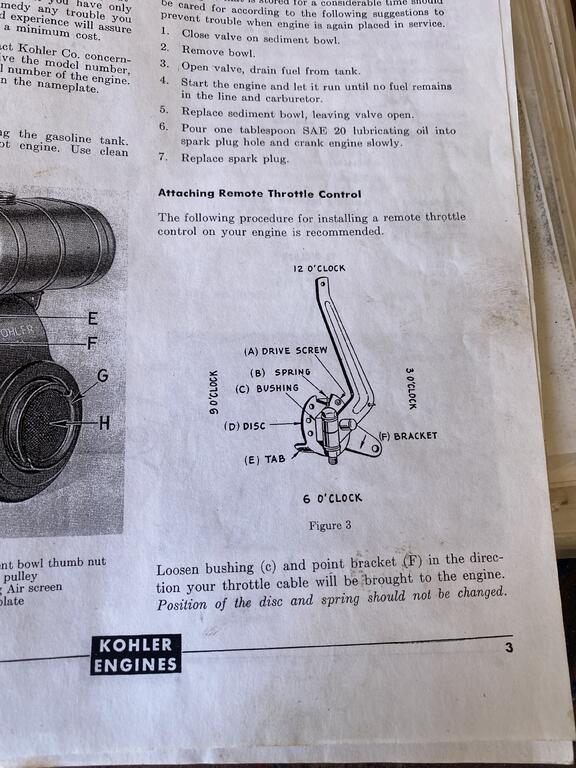

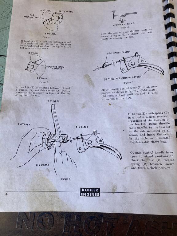

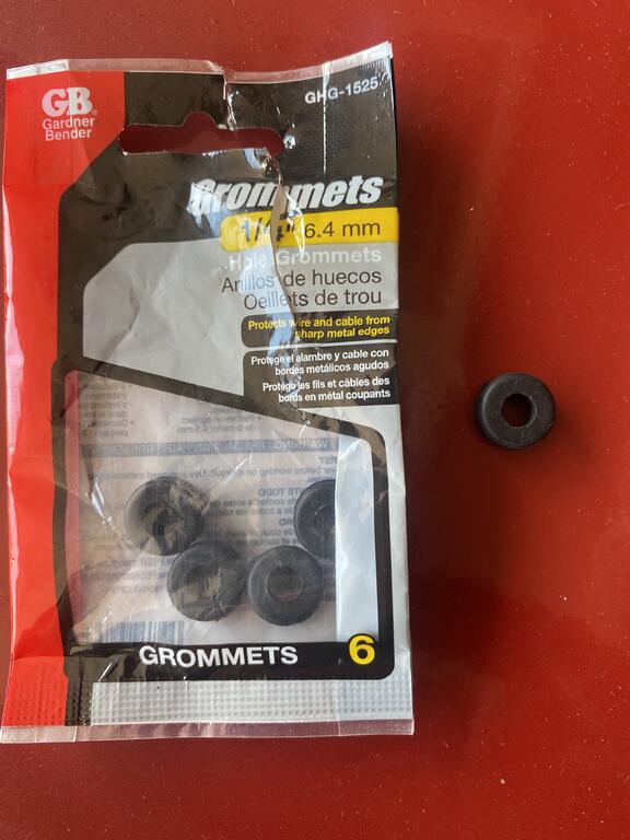

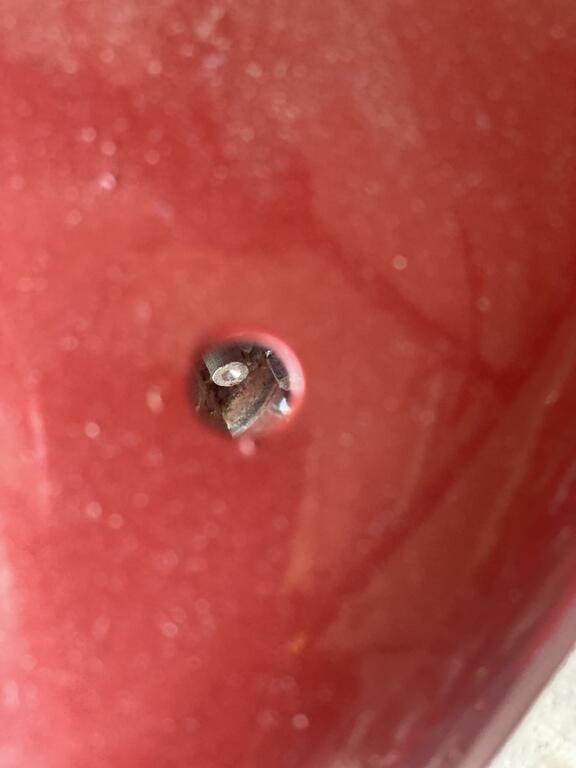

Going to hook up the RJ throttle on the RJ for my brother David too!  The 1/4 inch rubber grommet is a must in the hood throttle hole.
I still have two backup K91s for this RJ redo if I am not satisfied with my K91 I have on the tractor!

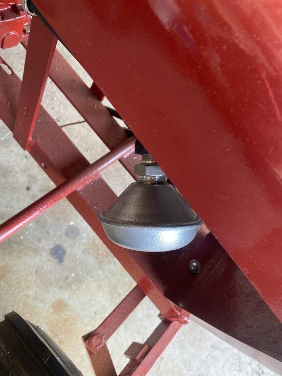

I do have a showerhead muffler on the redo RJ but it is a one inch snd I had to place a bushing on it!  Might have to put that muffler on my 701 as it would be correct for that tractor too!

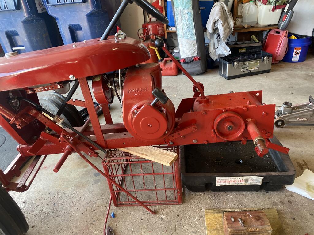

Lane Ranger

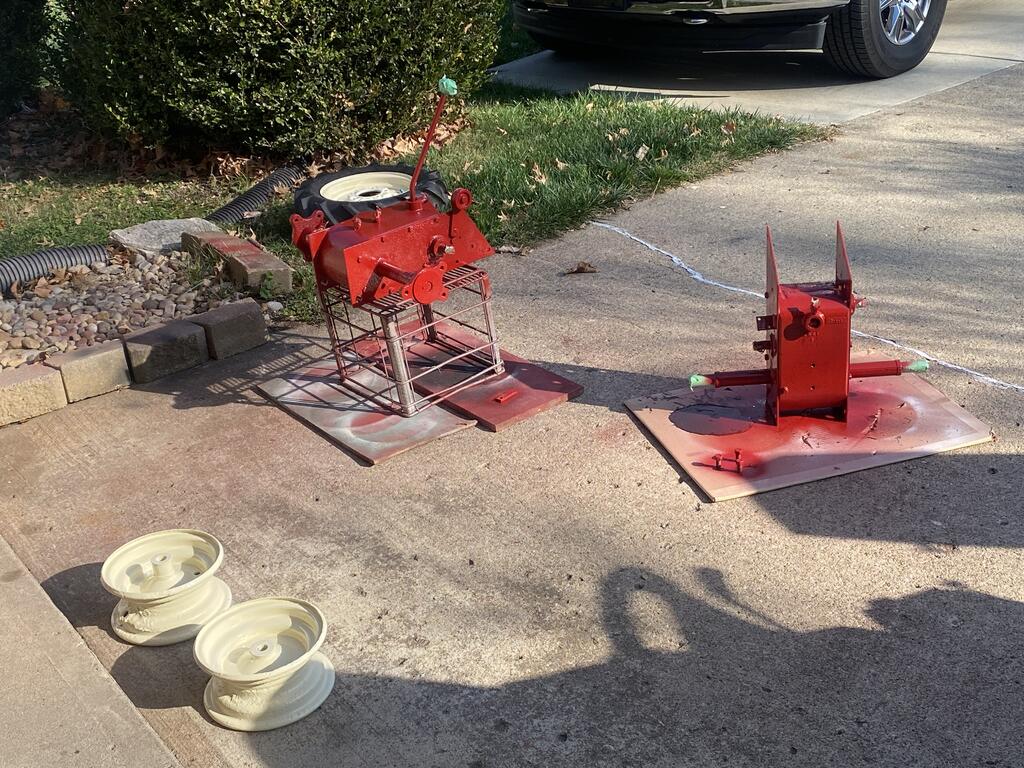

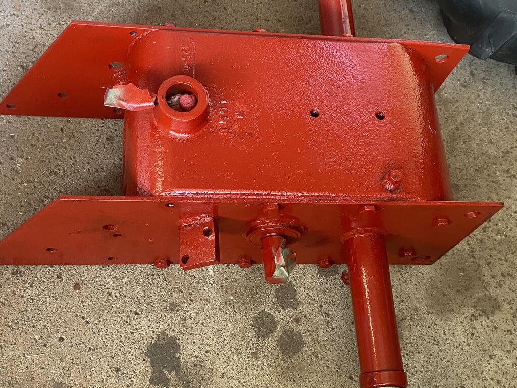

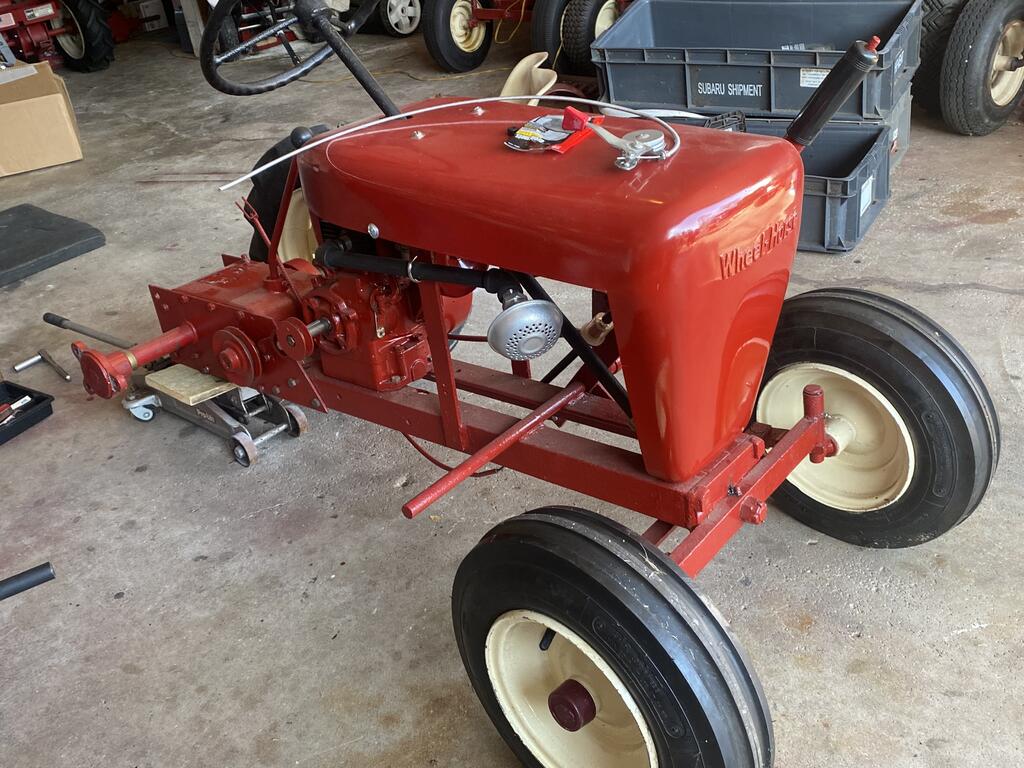

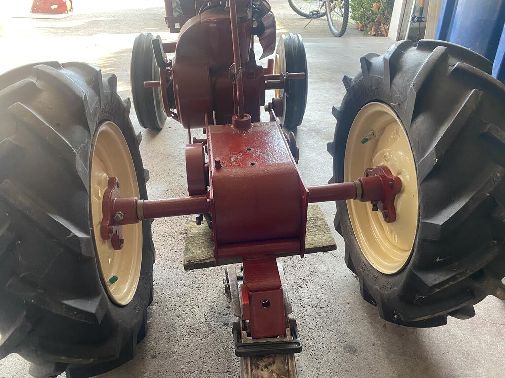

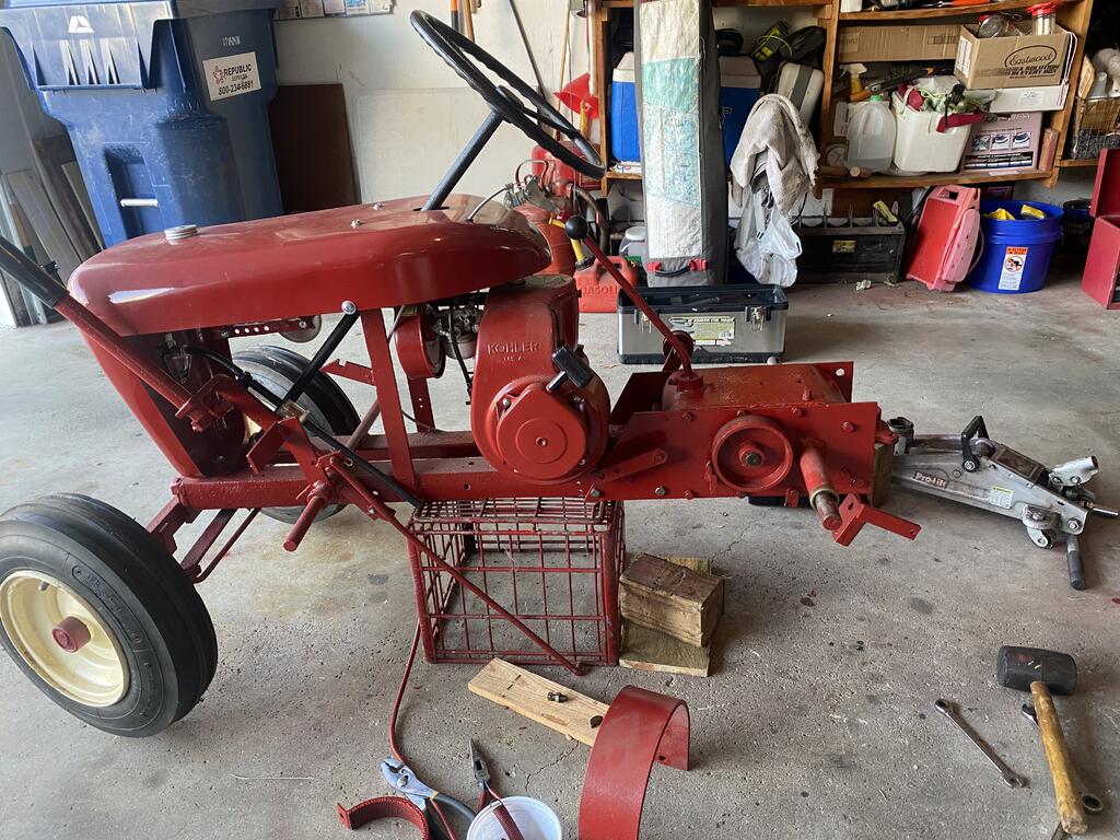

Down to this at 3:30 !
Quitting time for today!
The newly painted RJ transmission will be going on the tractor frame tomorrow!

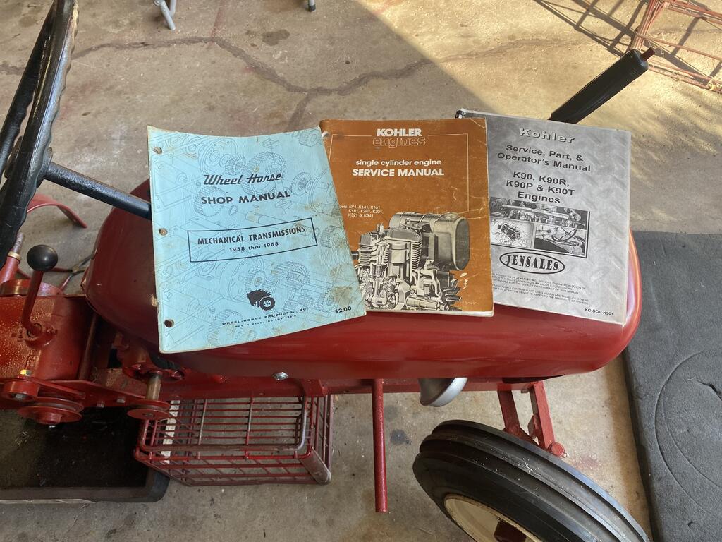

i brought out all the references for this one!  I think I know but want to be sure!
I decided this am to keep the tight transmission on the RJ and run the motor with transmission in first gear to wear in the tight bushings!  It should work!

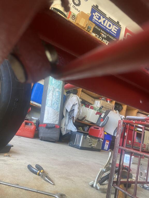

Lane Ranger

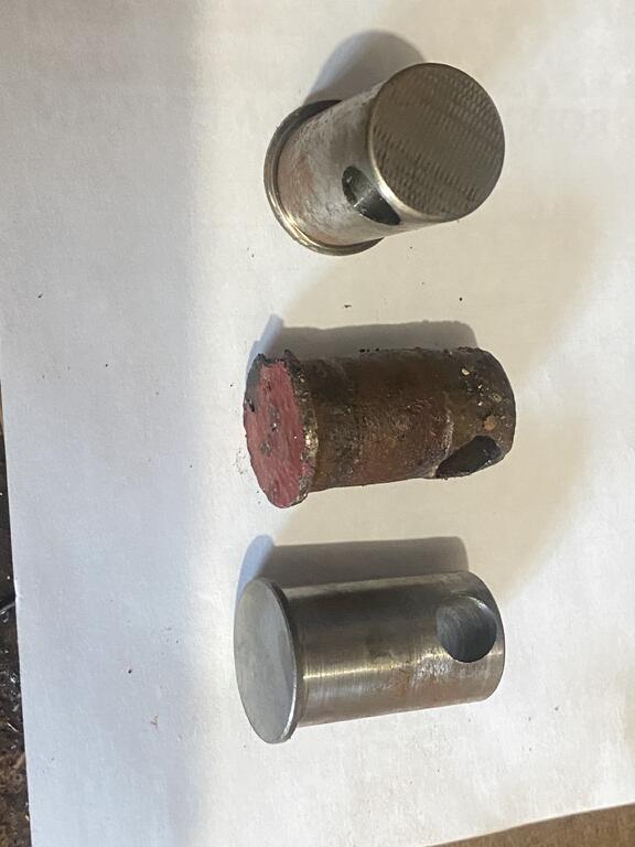

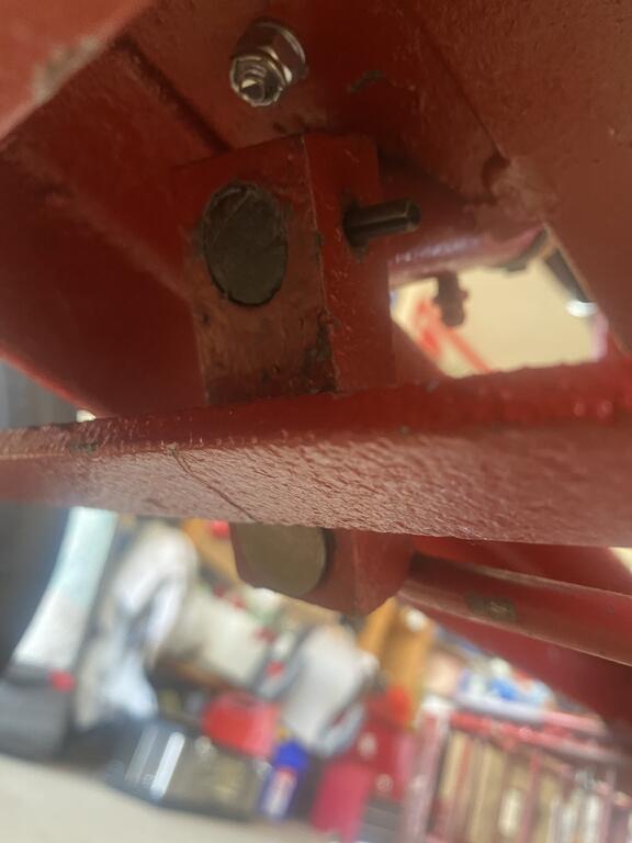

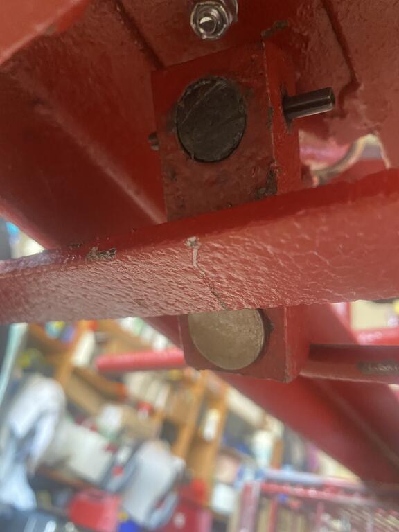

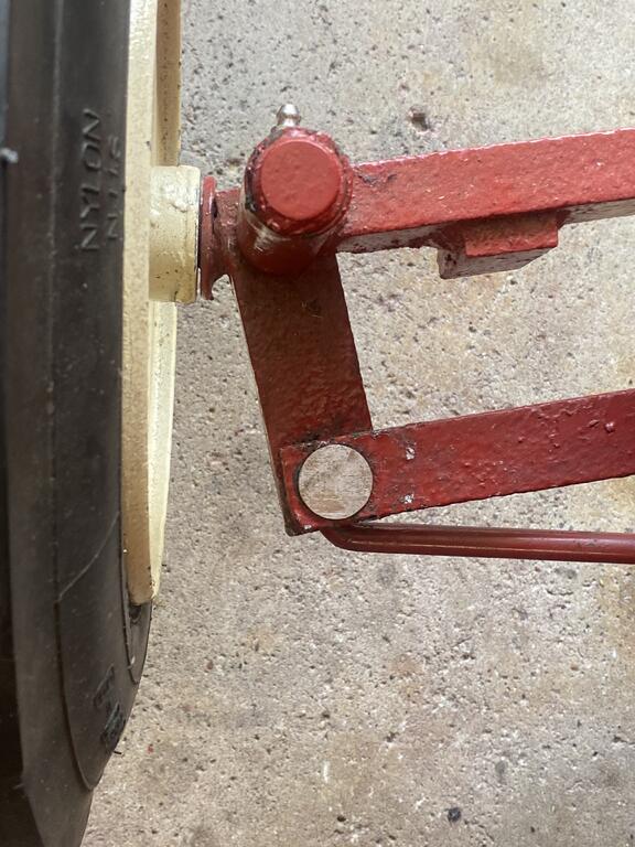

Since the RJ is the designated tractor for next years 25th Anniversary Collectors Club Show and a lot of RJs are coming out of the woodwork and lots of first time buyers I thought this is worthy of mention.
I usually replace these steering clevis pins on every tractor!
Replacing the clevis pins in the RJ steering is most often necessary!  Sometimes even a bushing in the steering link is needed!
several vendors on Red Square and EBay make these clevis pins new for rejuvenation of your RJ steering!
Spindles
You can also get some excellent new RJ spindles made to order for your tractor if needed by a great collector and restorer on EBay.

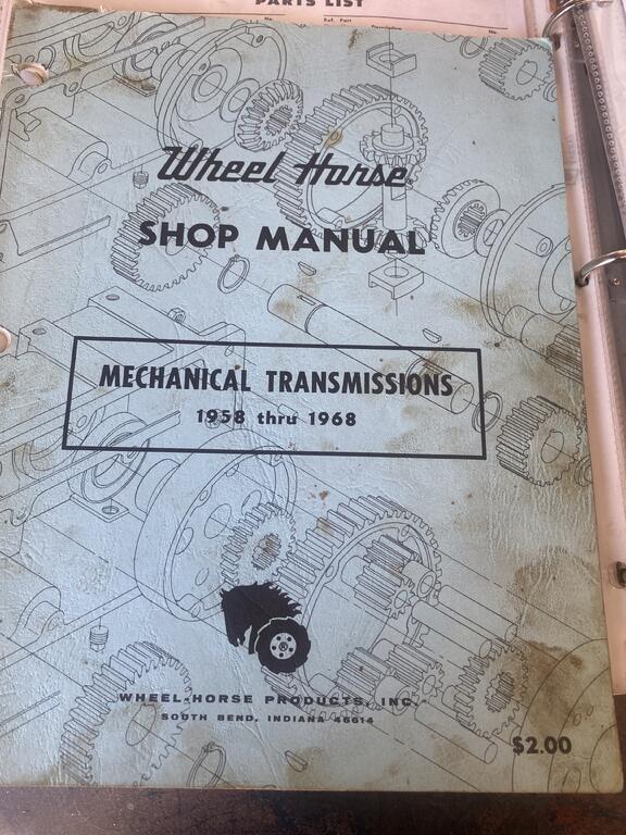

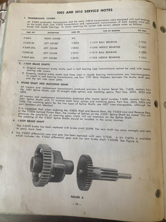

Trsnsmissions
Also remember that a Suburban and RJ transmission can be interchangeable with a couple modifications!   The brake side plate on RJ and Suburban are different!   But the can be changed to accommodate your tractor!
 Make sure to read the transmission service manual (and or Stevasaurus’ video tutorial on redoing a Three Piece Transmission in the Instructional section of Red Square) .   I include one important page here for your reference.

What size is that roll pin because mine keep falling out and it’s probably because they’re too small
roll pin for what application The Freightliner guy?
The RJ steering block roll pin is a 3/16 by 1 1/4.  You can run another smaller roll pin inside to tighten it up!

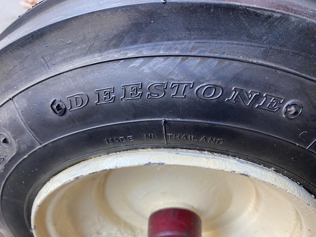

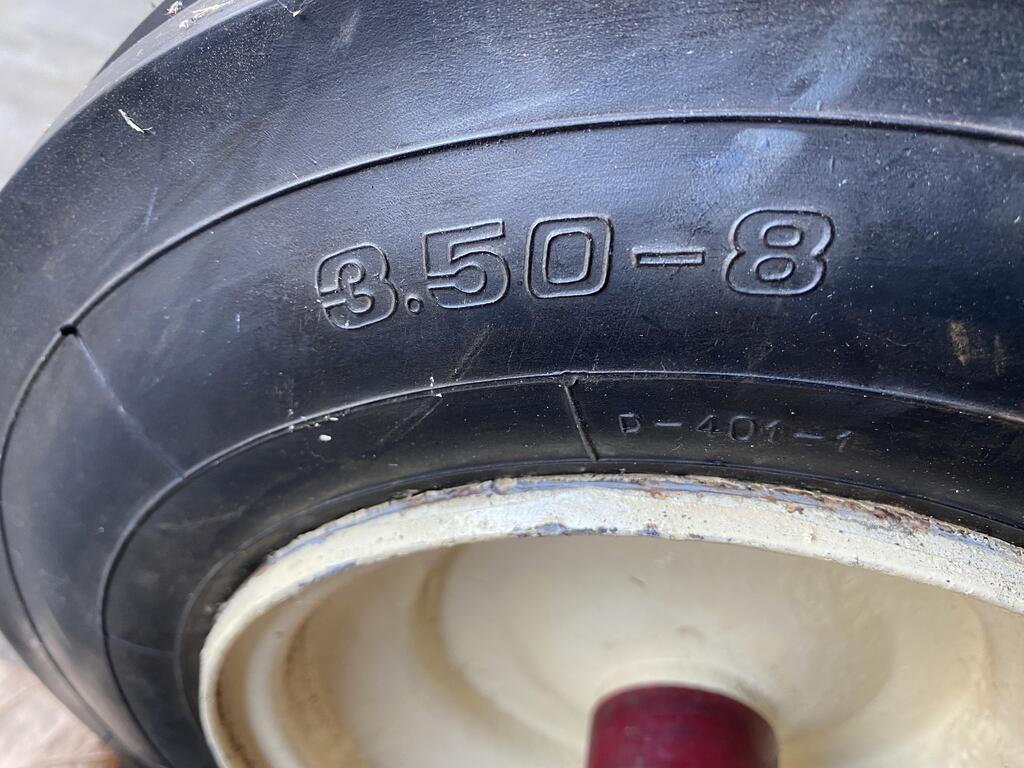

I have two options for front tires on the RJ I am finishing up on.  I now have a set of 3.50 Deestone tri-ribs and they look good. I think the 3.50s look better on the smaller tractor than the 4.00 tri-ribs and they fit fine on the same wheels.
My other option is a set of new old stock Goodyears I bought that are much like early Wheel Horse equipment.
I may just have to try them both out!

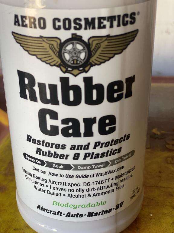

plus I am using this Rubber Care product  Craig Hearne mentioned to me last year.  This softens old tire rubber and reconditions for continued use.

@Lane Ranger  lane , recently got some of that  , rubber care , really freshens up the look of a tire , thanks for the tip,  seeing anything today , that is made in USA  is  strange ,  the world continues to get smaller ,  we can all remember  when it was very different .  pete

For that steering box part
