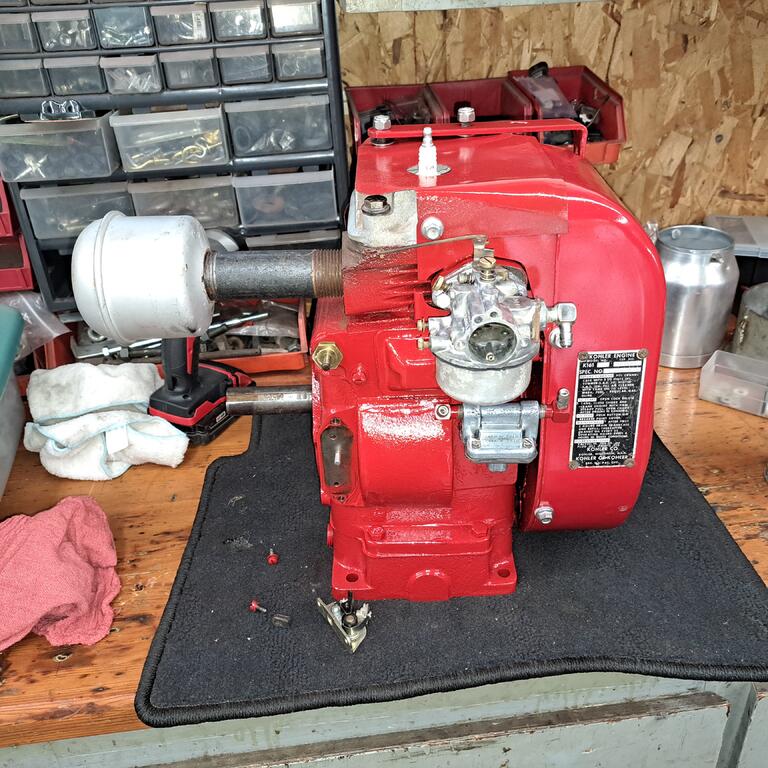

WHX?? 58,254 #17127 Posted September 23, 2022 (edited) Some assembly required... Tip fellas... do it on an old car floor mat. Makes spinning the motor on the bench easy. Edited September 24, 2022 by WHX?? 7 4 Share this post Link to post Share on other sites

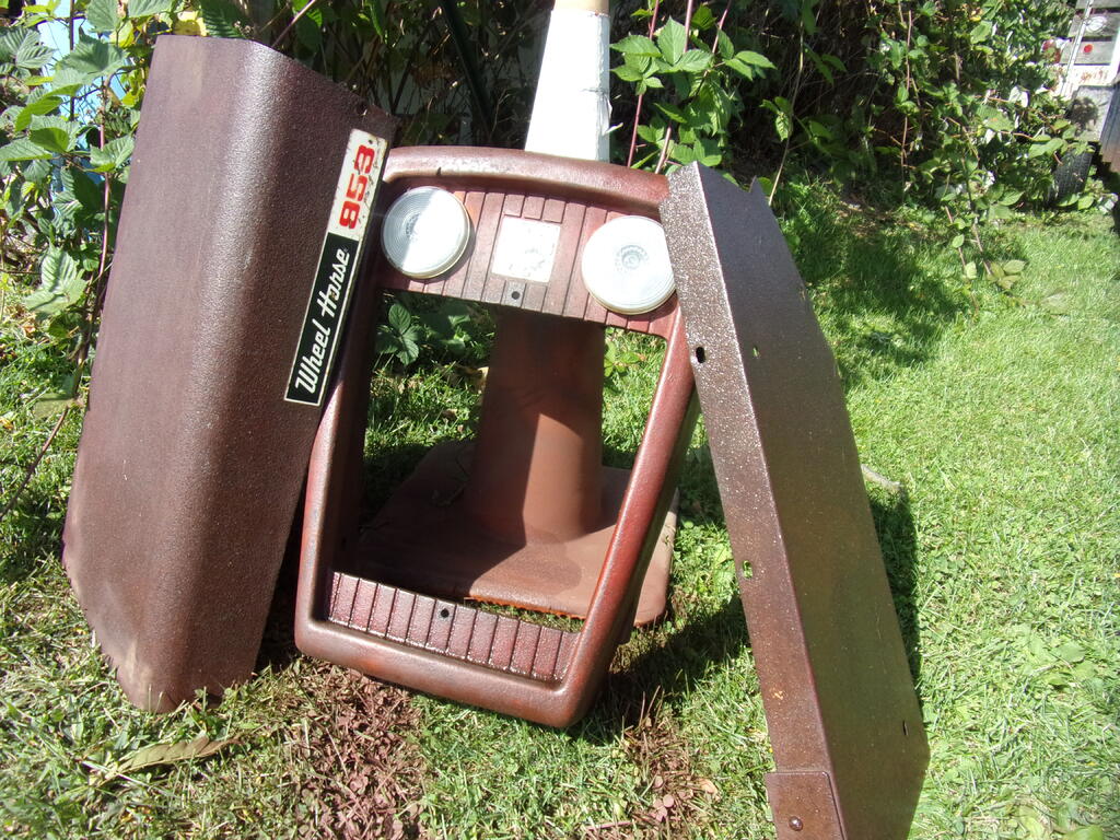

Ed Kennell 47,480 #17128 Posted September 24, 2022 Cleaned up a couple of freds parts. Scotch brite and rub down with some old ATF. 5 7 Share this post Link to post Share on other sites

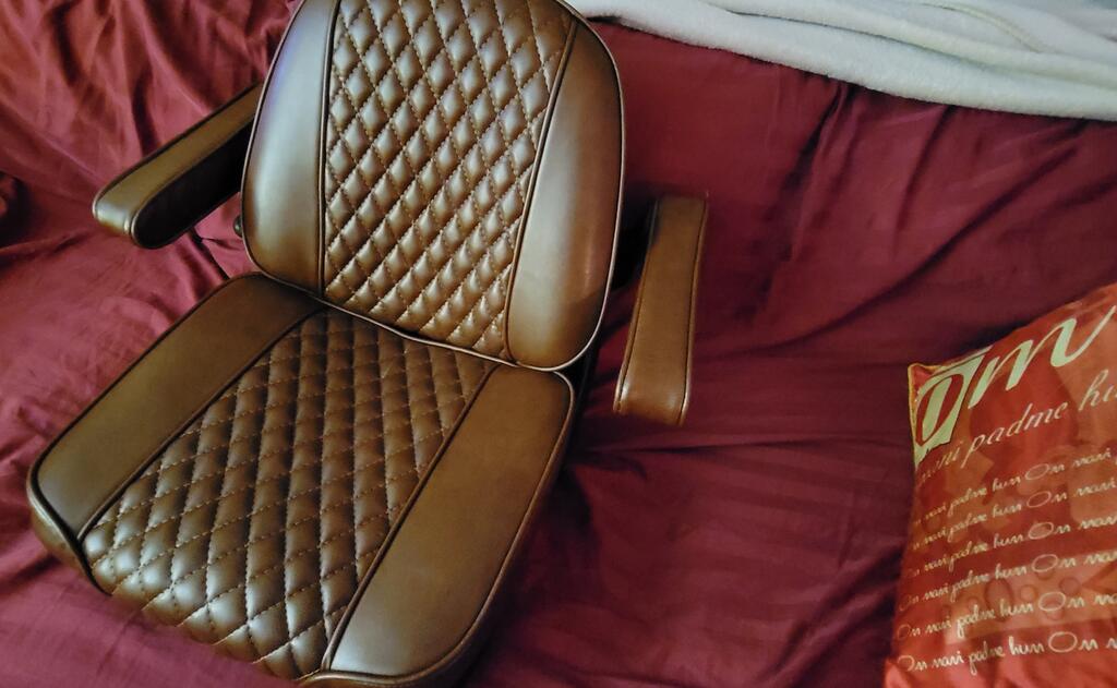

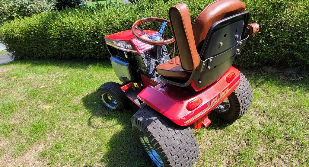

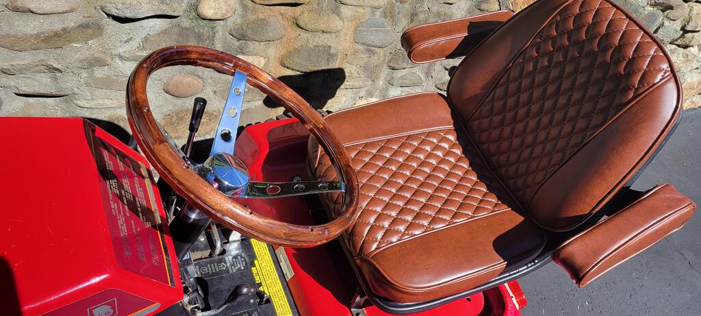

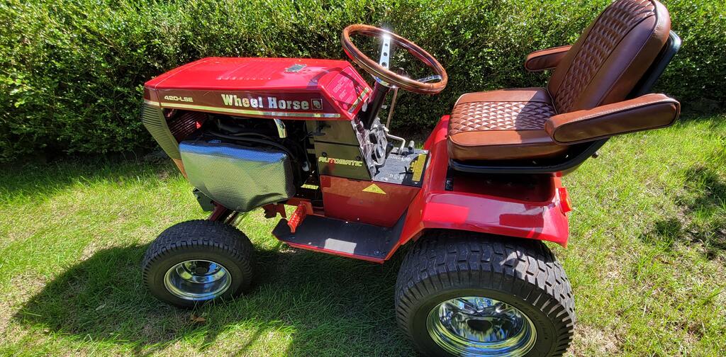

AMC RULES 37,259 #17129 Posted September 24, 2022 Finished up the reassembly last night and the seat was installed this morning. 10 5 5 Share this post Link to post Share on other sites
elcamino/wheelhorse 9,363 #17130 Posted September 24, 2022 @AMC RULES That is excellent , do you do car seats Ha ha 2 Share this post Link to post Share on other sites

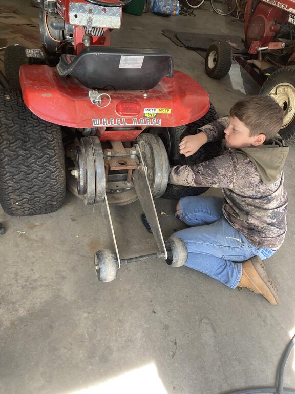

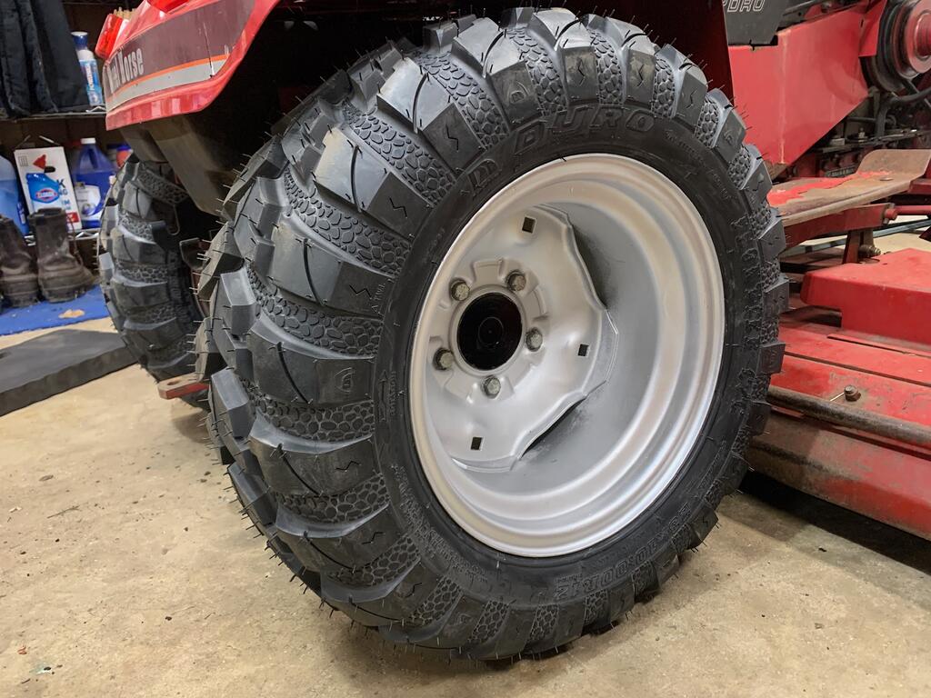

TonyToro Jr. 2,541 #17132 Posted September 24, 2022 Me and @TonyToro Just put on a new set of Dog Bone tires on Lunch Money (my pulling tractor). We had a pull yesterday and I didn’t have much traction so this morning we put on the new set. Hopefully at the next pull in 2 weeks I get more traction. 4 7 4 Share this post Link to post Share on other sites
19richie66 17,936 #17133 Posted September 24, 2022 40 minutes ago, elcamino/wheelhorse said: @AMC RULES That is excellent Agreed…… beautiful seat. 2 Share this post Link to post Share on other sites
squonk 48,184 #17134 Posted September 24, 2022 1 hour ago, Ed Kennell said: Cleaned up a couple of freds parts. Scotch brite and rub down with some old ATF. Those open grilles make nice yard art for Halloween! 1 7 Share this post Link to post Share on other sites

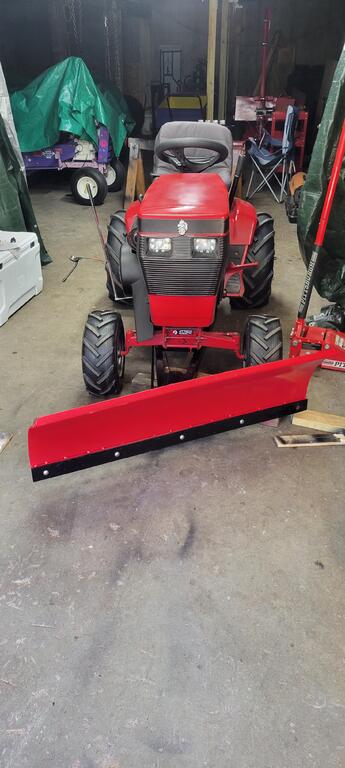

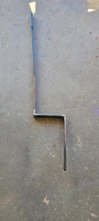

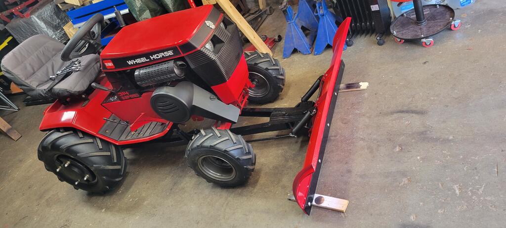

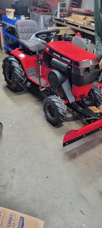

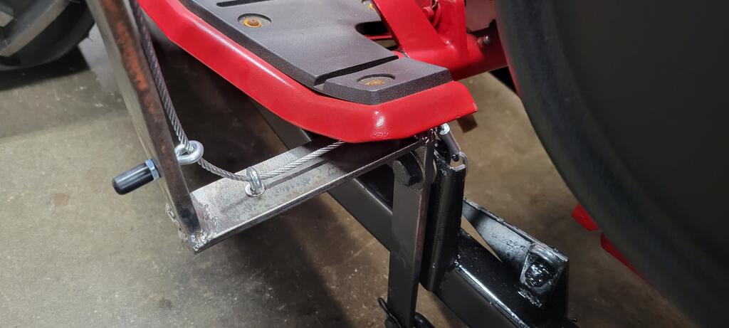

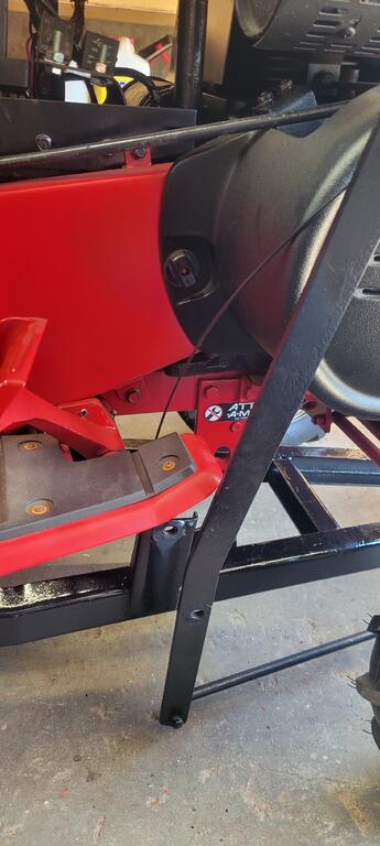

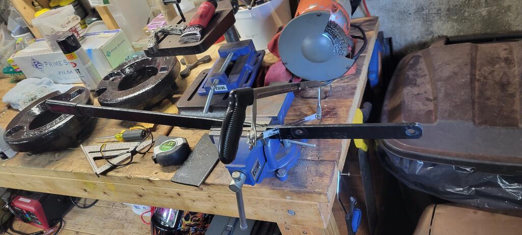

OldWorkHorse 3,156 #17135 Posted September 24, 2022 (edited) Worked a bit more on my new to me plow. Also learned somthing today, newer 300 style wheel horses need a differnt style plow angle lever then the straight ones I seem to only find. So simple solution, cut up the straight lever and widen it to fit and work. Seems to do the job probably going to weld some reinforcement angles on it and my only problem I have left is making the plow pin squeeze release work. Can't seem to find any good photos of a newer 300 series plow set up to get a good idea. Was thinking eye bolts and steel cable? Thoughts ideas and photos welcome. Edited September 24, 2022 by OldWorkHorse 5 4 Share this post Link to post Share on other sites
Ed Kennell 47,480 #17136 Posted September 24, 2022 1 hour ago, OldWorkHorse said: Thoughts ideas and photos welcome. I used eye bolts and cable and turnbuckle to route mine inside the cab. 2 5 Share this post Link to post Share on other sites

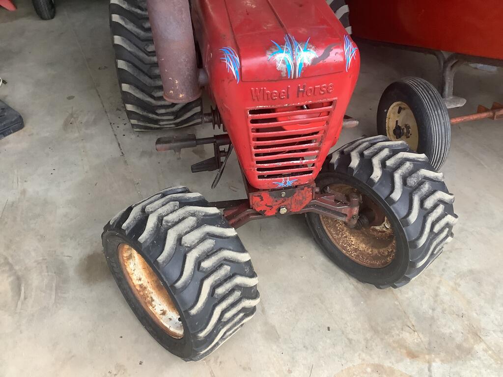

Pullstart 71,336 #17137 Posted September 24, 2022 @OldWorkHorse that thing looks slick! Have you run those tires in the snow before? You may find yourself wanting to spin the front tires around backwards for improved steering in the slick stuff. 3 1 1 Share this post Link to post Share on other sites
Horse Newbie 7,405 #17138 Posted September 24, 2022 6 hours ago, AMC RULES said: Finished up the reassembly last night and the seat was installed this morning. There’s a Bugatti missing a seat somewhere… my goodness man ! 1 5 Share this post Link to post Share on other sites
OldWorkHorse 3,156 #17139 Posted September 24, 2022 54 minutes ago, Pullstart said: @OldWorkHorse You may find yourself wanting to spin the front tires around backwards for improved steering in the slick stuff. I have run it in the snow a few years now, only difference is i have a blower on it so front is cemented to the ground with the loaded tires and weights. 1st time running a plow tho so I might end up trying this idea out! Never knew if was added benefit of it or just people liked the look. Thanks for the input! 3 Share this post Link to post Share on other sites
Pullstart 71,336 #17140 Posted September 24, 2022 17 minutes ago, OldWorkHorse said: I have run it in the snow a few years now, only difference is i have a blower on it so front is cemented to the ground with the loaded tires and weights. 1st time running a plow tho so I might end up trying this idea out! Never knew if was added benefit of it or just people liked the look. Thanks for the input! I don’t like the look at all. It made a huge difference my first winter playing around with Poppy the big tired 552 2 1 Share this post Link to post Share on other sites
OldWorkHorse 3,156 #17141 Posted September 24, 2022 (edited) 1 hour ago, Pullstart said: I don’t like the look at all. It made a huge difference my first winter playing around with Poppy the big tired 552 Haha I'm not a huge fan of the look myself when I see it makes me feel like somthing is off. But I do like usefulness so I think this winter I'll swap them around and see how they do! Edited September 25, 2022 by OldWorkHorse 1 Share this post Link to post Share on other sites
Heatingman 977 #17142 Posted September 25, 2022 5 hours ago, OldWorkHorse said: Worked a bit more on my new to me plow. Also learned somthing today, newer 300 style wheel horses need a differnt style plow angle lever then the straight ones I seem to only find. So simple solution, cut up the straight lever and widen it to fit and work. Seems to do the job probably going to weld some reinforcement angles on it and my only problem I have left is making the plow pin squeeze release work. Can't seem to find any good photos of a newer 300 series plow set up to get a good idea. Was thinking eye bolts and steel cable? Thoughts ideas and photos welcome. There is a little spring that rifles the bolt forward. That spring needs a little roll pin to apply pressure. The roll pin over time will shear off. 1 1 Share this post Link to post Share on other sites
ebinmaine 80,811 #17143 Posted September 25, 2022 16 hours ago, OldWorkHorse said: I think this winter I'll swap them 16 hours ago, Pullstart said: It made a huge difference Steve you DEFINITELY want to flip those tires. I tried both directions on Cinnamon Horse C160 when I first mounted up a set of 6-12s for usage with the Mackissic chipper. The difference in turning capability was HUGE. YMMV. 1 Share this post Link to post Share on other sites

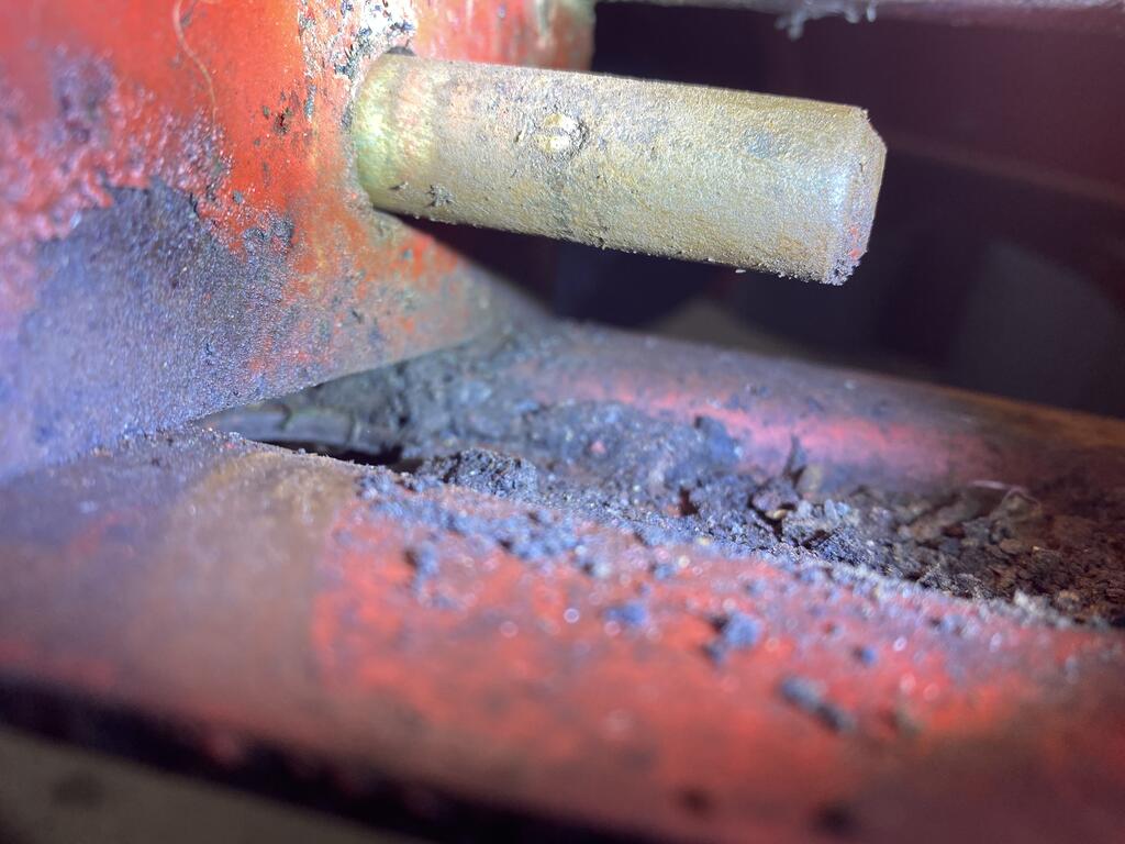

elcamino/wheelhorse 9,363 #17144 Posted September 25, 2022 After tapping the roll pin on the high/low shifter on the 8 speed trans spray some primer on parts of the Waldomobile , hooked up the angle grinder with the wire wheel and ground on some panels and foot rests . Too much brown weld every where. @squonk I don't know where you picked up the Waldomobile but the PO spray all kinds of CR*P everywhere and may coats in some places. Must have been emptying raddle cans . Forgot how a angle grinder with a wire wheel throws brown weld all over the operator. 5 Share this post Link to post Share on other sites

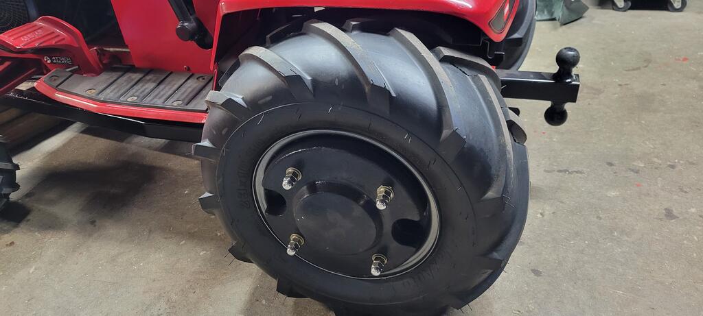

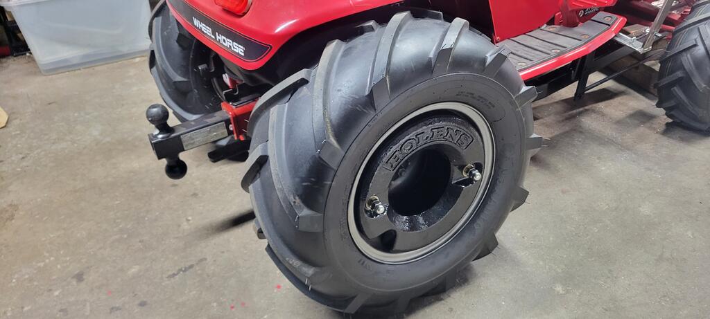

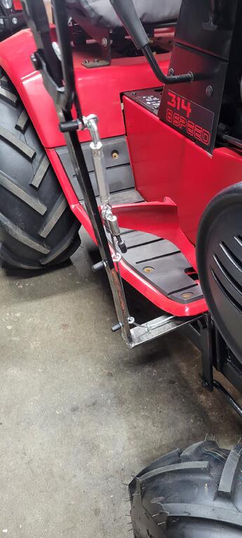

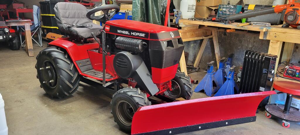

OldWorkHorse 3,156 #17145 Posted September 25, 2022 Finished up my 314-8 plow project and fixed the angle pin release so it works with the new lever. Also swapped out my solid wheel weights for a open bolens set I picked up not to long ago. Going to put the solid ones on FLOWAHPOWAH so my other half will have some more traction for her to haul stuff around with. Now just got to touch up the paint and wait for USPS to ship my package back to to me since they sent it to the other side of the state and it happens to be my downforce lever for this plow, BUT then and only then will I finally be able to drive a wheel horse with a plow on it, and can check that off the bucket list . 6 4 Share this post Link to post Share on other sites

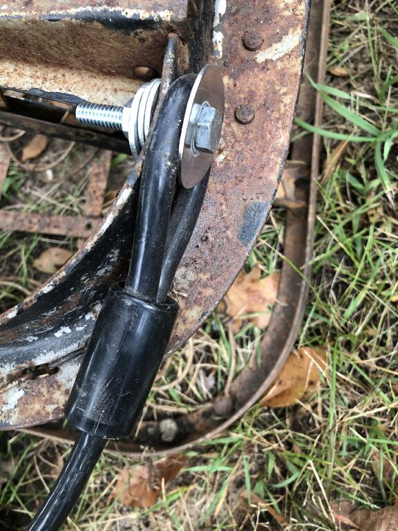

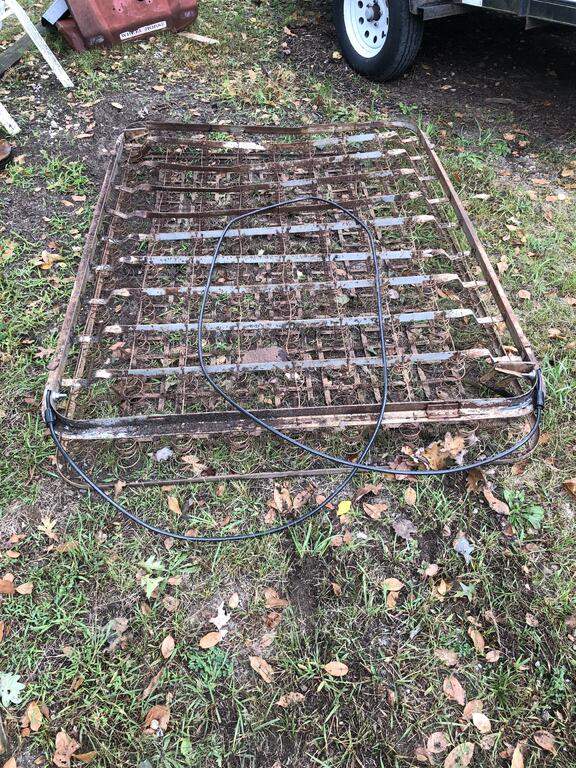

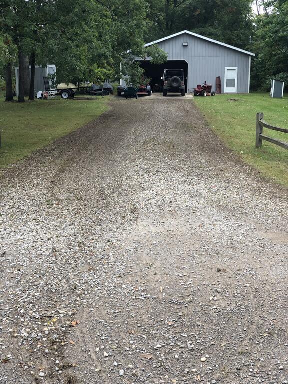

Rob J. 1,944 #17146 Posted September 25, 2022 I made a drag out of an old bed spring. Attached a plastic coated cable to it and WA-LA! Cost, whatever the cable cost 20 years ago. I roughed up the driveway with the grader blade (I swapped it from the 1045 to my C-100) first as it was badly overgrown with grass. Spent about an hour on that. Then hit it with the bed spring for about 15 minutes and it looks really nice. Still some work to be done on the stubborn grassy parts but it’s coming rather nicely. 10 3 Share this post Link to post Share on other sites

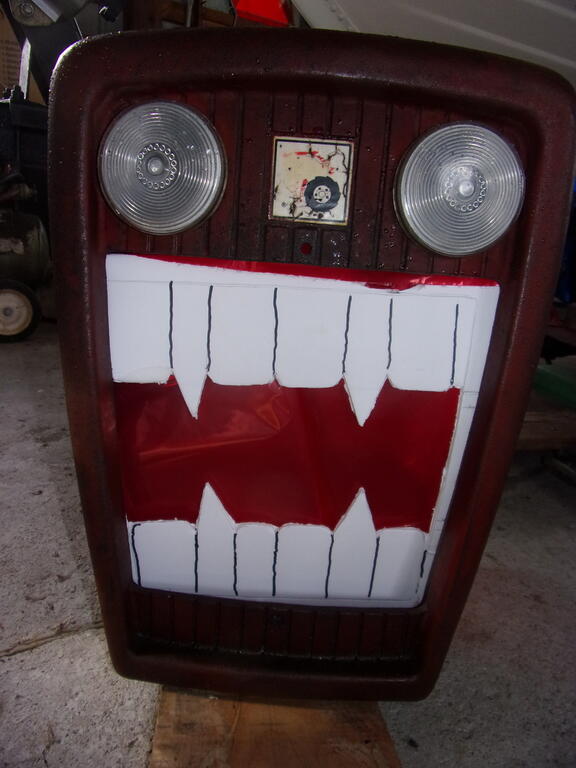

Ed Kennell 47,480 #17147 Posted September 25, 2022 On 9/24/2022 at 2:15 PM, squonk said: Those open grilles make nice yard art for Halloween! Ya mean like this Mike? 1 12 3 Share this post Link to post Share on other sites
cafoose 3,870 #17148 Posted September 25, 2022 6 minutes ago, Ed Kennell said: Ya mean like this Mike? That would look great on a rat rod 1 Share this post Link to post Share on other sites

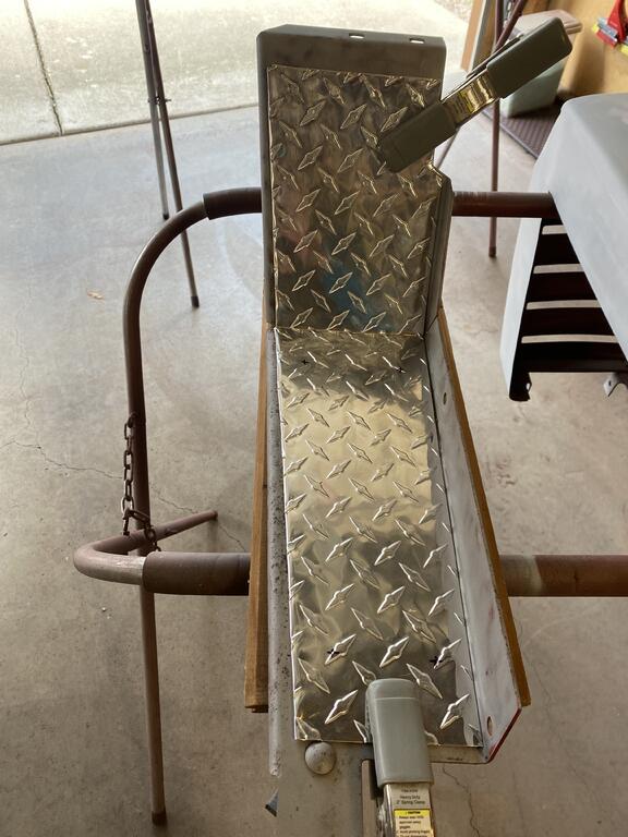

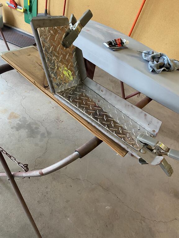

Heatingman 977 #17149 Posted September 25, 2022 Decided to add diamond plate onto the foot boards, and get them mocked up before painting. 8 1 Share this post Link to post Share on other sites
