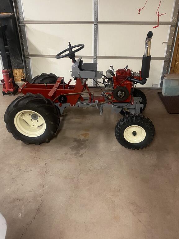

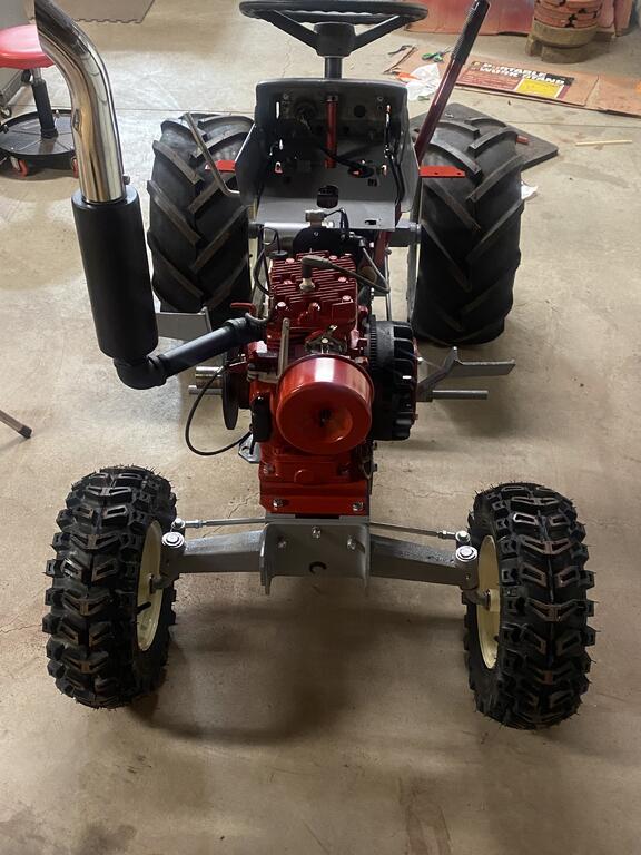

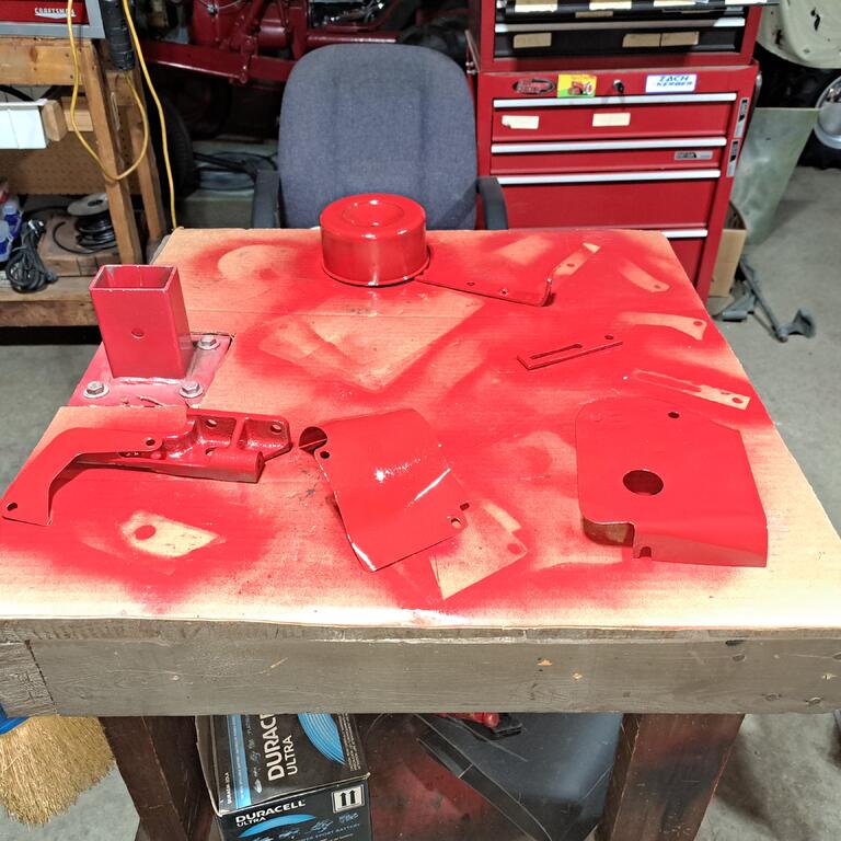

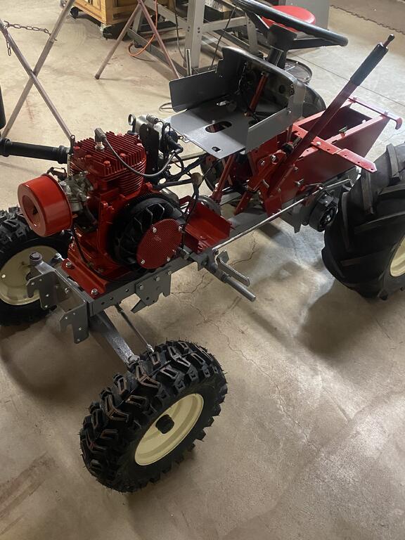

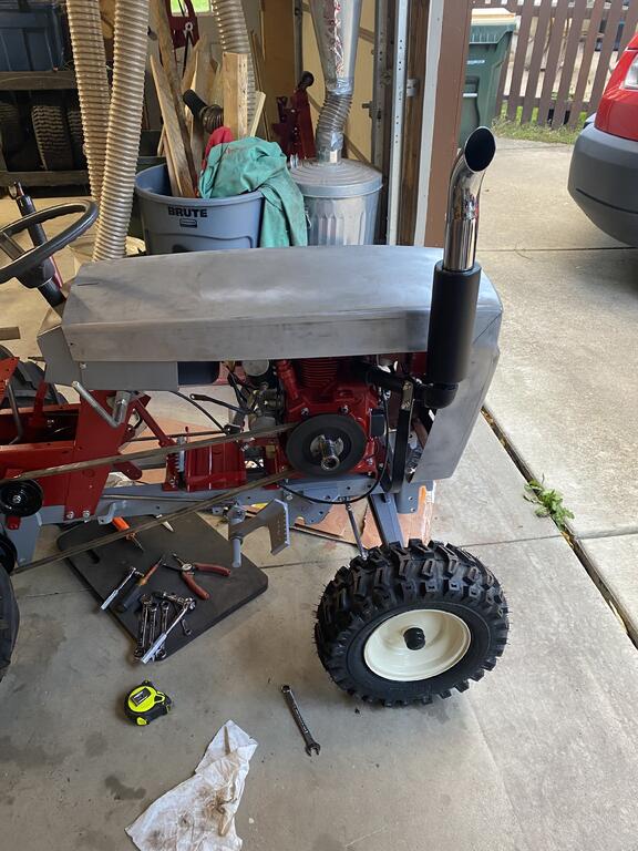

Heatingman 977 #17104 Posted September 22, 2022 Getting pretty close to a running tractor. I guess with just a couple more wire connections I could physically run it, but would not be able to drive it anyways. Still have to paint the motor tins, belt guard, seat pan, fenders, and the foot boards. Hope to be to that point by the weekend. 5 13 Share this post Link to post Share on other sites
ebinmaine 79,016 #17105 Posted September 22, 2022 4 hours ago, Heatingman said: Getting pretty close Looking fantastic! You may want to consider fabbing up a brace for the exhaust. That's a fair amount of leverage weight pulling down n out on the cast iron (brittle) block. 4 2 Share this post Link to post Share on other sites
Heatingman 977 #17106 Posted September 22, 2022 4 hours ago, ebinmaine said: Looking fantastic! You may want to consider fabbing up a brace for the exhaust. That's a fair amount of leverage weight pulling down n out on the cast iron (brittle) block. Excellent point. Think I will look into this today. 2 Share this post Link to post Share on other sites

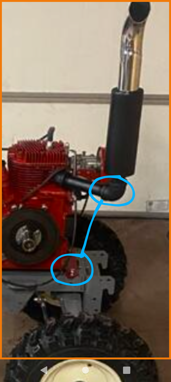

ebinmaine 79,016 #17107 Posted September 22, 2022 Just now, Heatingman said: Excellent point. Think I will look into this today. I used a piece of flat stock on my Cinnamon Horse C160 and just bolted it to a clamp that was surrounding that horizontal pipe. 2 Share this post Link to post Share on other sites

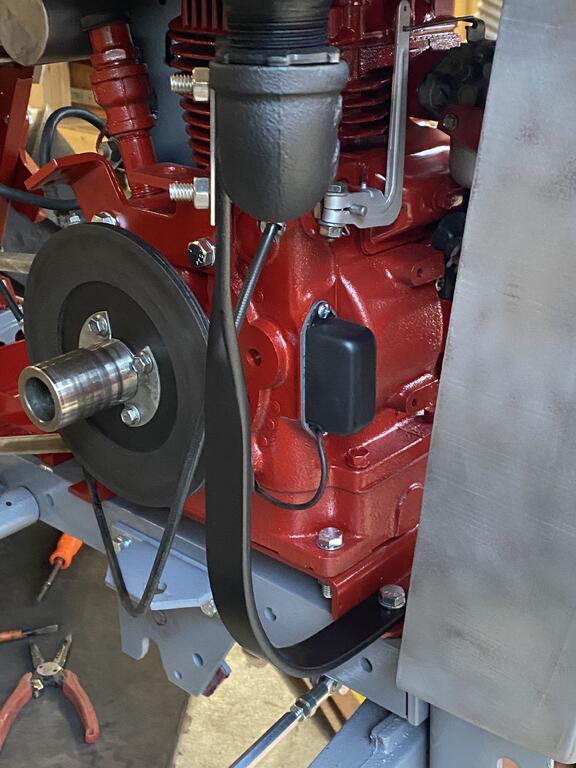

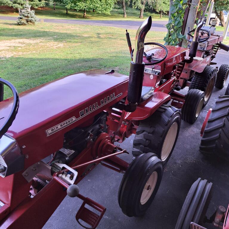

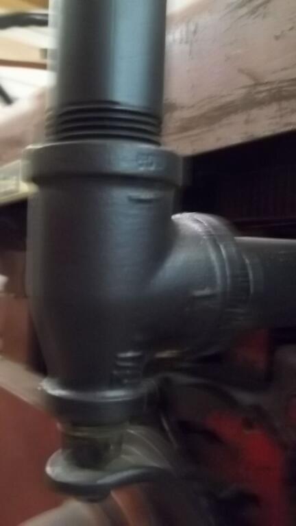

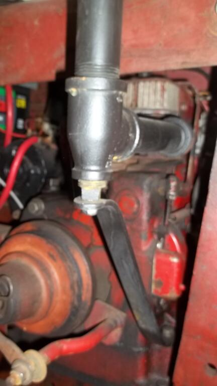

953 nut 66,315 #17108 Posted September 22, 2022 4 hours ago, Heatingman said: Excellent point. Think I will look into this today. Here is the type brace I used on my stack. The one inch ninety degree elbow is replaced by a 1'X1/2"X1" black iron "T" with the 1/2" outlet pointing down. A 1/2" plug was drilled and taped for a 1/4-20 bolt that attaches the bracket, other end goes to a motor mount bolt. 8 13 Share this post Link to post Share on other sites

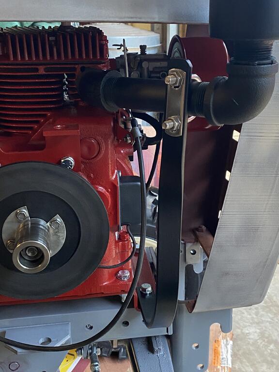

Heatingman 977 #17109 Posted September 22, 2022 14 hours ago, ebinmaine said: Looking fantastic! You may want to consider fabbing up a brace for the exhaust. That's a fair amount of leverage weight pulling down n out on the cast iron (brittle) block. Ask and you shall receive. Side note: that hood looks pretty good in grey, but Im pretty sure Im painting it red. 4 6 Share this post Link to post Share on other sites
ebinmaine 79,016 #17110 Posted September 22, 2022 39 minutes ago, Heatingman said: Ask and you shall receive. Side note: that hood looks pretty good in grey, but Im pretty sure Im painting it red. I like it! Agree with the hood being red too. 3 Share this post Link to post Share on other sites

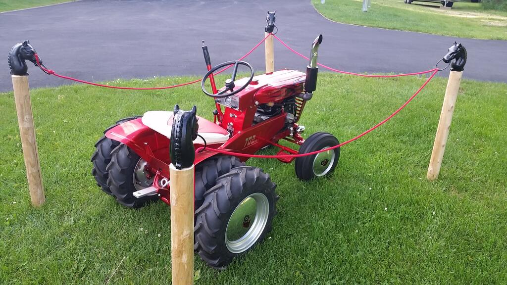

WHX?? 56,652 #17111 Posted September 23, 2022 (edited) Can't say it won't help but can't hurt fellas. I been running JK stacks for years now and never a problem with having to add a support. Worse problem was using BS 1" alloy electrical conduit lock nuts where desired. They melted. Use real steel ones. That and runner like ya stole her.. the carbon and rust will hold it in place. Crap I suppose you want pics... OK but but only this once and since you asked nicely... Edited September 23, 2022 by WHX?? 2 9 Share this post Link to post Share on other sites

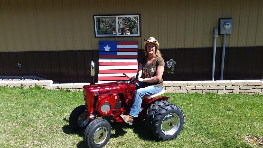

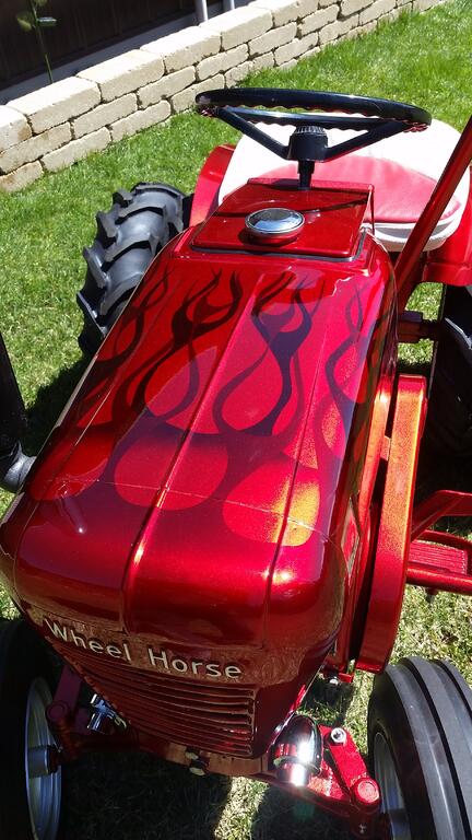

Heatingman 977 #17112 Posted September 23, 2022 (edited) Thats a fine looking herd there @WHX?? That Dually in the bottom pic, is that just used for yard art? Seems way too nice a machine for that. Edited September 23, 2022 by Heatingman 1 Share this post Link to post Share on other sites

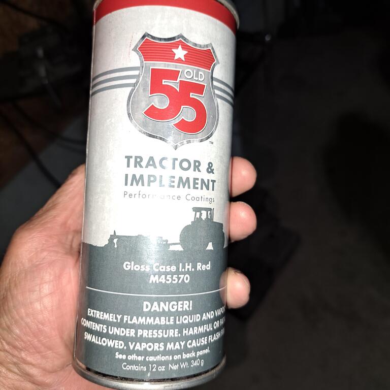

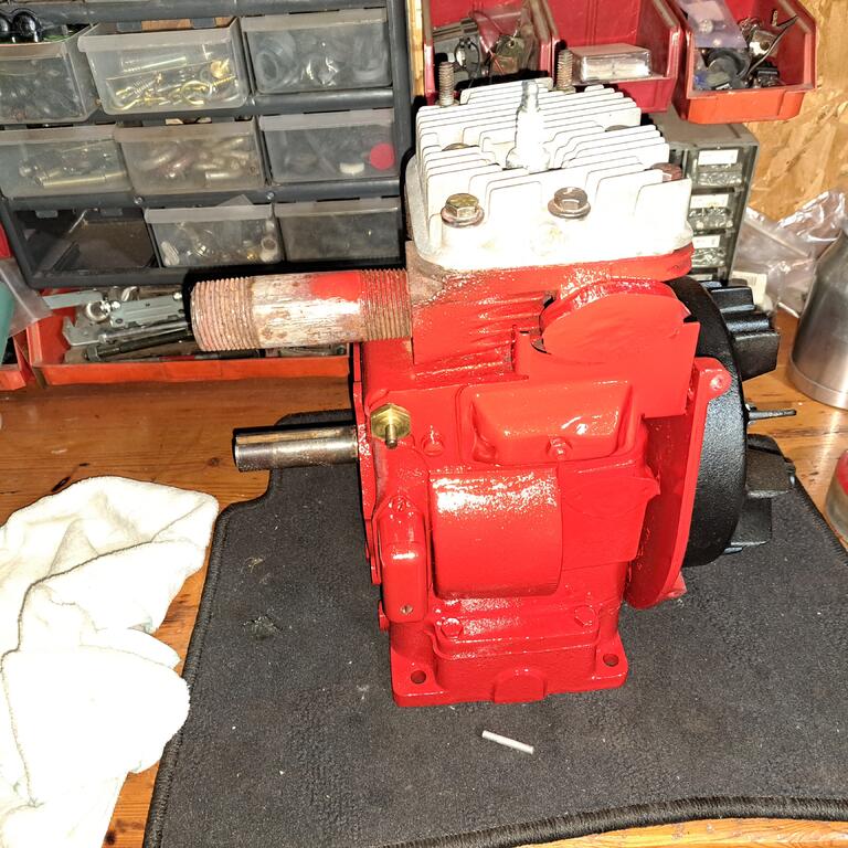

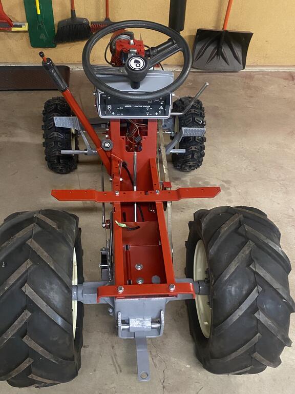

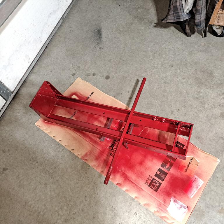

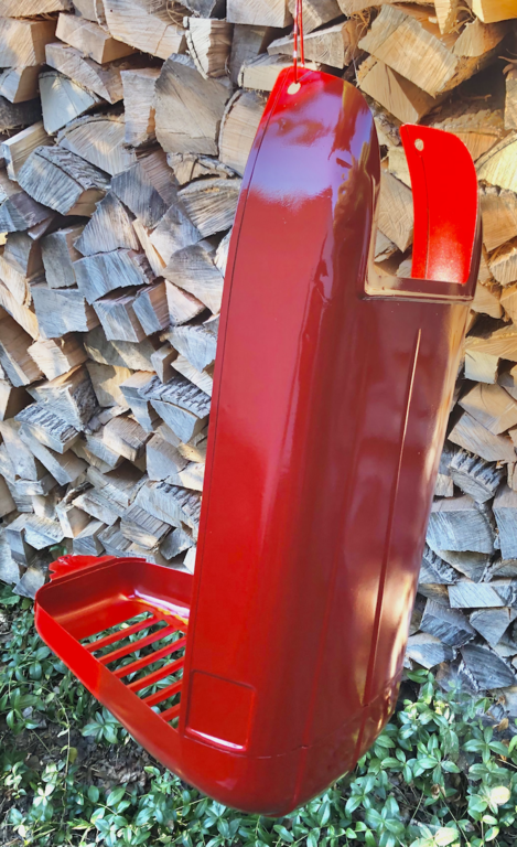

WHX?? 56,652 #17113 Posted September 23, 2022 (edited) I also got tired of @Achto to crap or git off the pot on shooting a 701. Sorry bro but this project is takin up some real estate we need for PD and I need a roller. I used Old 55 in a rattle Dan and I like it. Covers like crap but with small consistent coats shines like...you know. We'll still do the sheet metal out of a gun but for the gals we go out with.... good enough and once we stick it in the dirt it's fisticuffs anyone whines. I'll get out a BFH and see how chip resistance it is once it cures. Me thinks this is an underrated paint comparing to the $$ of Van Sickle. I used the same paint in IH off white for the rims and seat on the Amigo and was happy. Edited September 23, 2022 by WHX?? 1 7 Share this post Link to post Share on other sites
Achto 31,866 #17114 Posted September 23, 2022 18 minutes ago, WHX?? said: Me thinks this is an underrated paint comparing to the $$ of Van Sickle. True story - Old 55 is Vansickle enamel. Not their acrylic enamel like I use on my tractors but their strait enamel. Just to prove it, compare the part number on your can to the Vansickle part number. Only diff is the Old 55 has an "M" in front of the number. https://vansicklepaint.com/products/tractor-equipment-industrial-enamel?page=1 1 1 Share this post Link to post Share on other sites
Heatingman 977 #17115 Posted September 23, 2022 14 minutes ago, Achto said: True story - Old 55 is Vansickle enamel. Not their acrylic enamel like I use on my tractors but their strait enamel. Just to prove it, compare the part number on your can to the Vansickle part number. Only diff is the Old 55 has an "M" in front of the number. https://vansicklepaint.com/products/tractor-equipment-industrial-enamel?page=1 You buy that factory direct, or off the shelf somewhere? Might try them on the next one, but Id have to order direct. 1 Share this post Link to post Share on other sites
WHX?? 56,652 #17116 Posted September 23, 2022 1 hour ago, Heatingman said: Thats a fine looking herd there @WHX?? That Dually in the bottom pic, is that just used for yard art? Thank you sir but yard art my A$$ heatingdude...702 custom built for the missus. Paint by @Achto and assembly by me. 1 8 Share this post Link to post Share on other sites
WHX?? 56,652 #17117 Posted September 23, 2022 (edited) 16 minutes ago, Heatingman said: You buy that factory direct, or off the shelf somewhere? Might try them on the next one, but Id have to order direct. Off the shelf guy... if they have it at our local farm & barn. These days everything is out of stock. Thing I liked about this paint is out of the can ease compared to no rust noleum come out the can oleum . Very comparable to their sunrise red in color but maybe a tad more brighter. Edited September 23, 2022 by WHX?? 1 Share this post Link to post Share on other sites

Achto 31,866 #17119 Posted September 23, 2022 8 hours ago, Heatingman said: You buy that factory direct, or off the shelf somewhere? Might try them on the next one, but Id have to order direct. You can buy Vansickle factory direct or see if there is a dealer in your area. Old 55 is an exclusive brand name for Fleet Farm, apparently they won't sell paint on line. Looks like the closest Fleet Farm to you is in Delavan WI. 1 1 Share this post Link to post Share on other sites

WHX?? 56,652 #17121 Posted September 23, 2022 (edited) 11 hours ago, Achto said: True story - Old 55 is Vansickle enamel. Not their acrylic enamel like I use on my tractors but their strait enamel. So what or how does the acrylic improve the paint. What are the benefits? Curious @Shynon do they have the Old 55 at your Fleets? Edited September 23, 2022 by WHX?? Share this post Link to post Share on other sites
Achto 31,866 #17122 Posted September 23, 2022 2 hours ago, WHX?? said: So what or how does the acrylic improve the paint. What are the benefits? Acrylics have a harder surface once cured and better gloss retention. Urethane's would be the next step up, followed by epoxy's. 1 Share this post Link to post Share on other sites

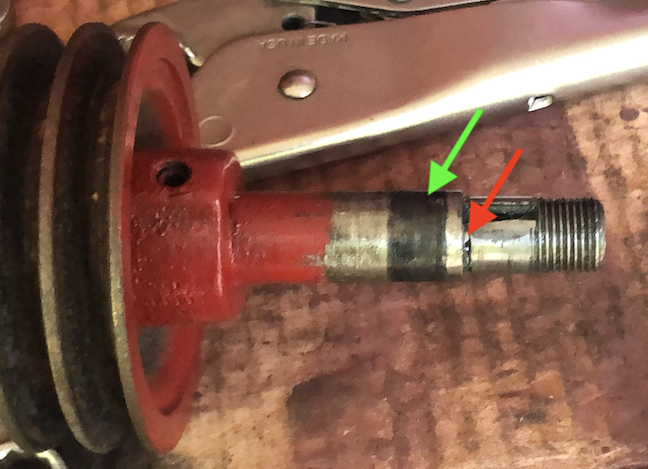

Handy Don 16,689 #17123 Posted September 23, 2022 (edited) My RM-366 deck had a lot of vibration and noise. Last week I found that one of the face gears was not turning evenly against the spur gear around its full revolution. The face-to-spur variation was over ⅛"--not conducive to smooth gear meshing! At first I though it was the gear itself, but after tearing it down today the gear measures good and the bore is true. Hmmm. @ri702bill suggested checking for a bent cross shaft. It woulda taken me a while to get there but that was it--there's no runout where it goes through the flange bearing support (dark band at green arrow) but it bends at the red arrow. Thankfully the parts pile has a straight one which got cleaned up, primed, and painted today. Reassembly tomorrow, the grass awaits! Also finally got the last of the prep done on the 854 hood I picked up at the Big Show and painted it. I'll let this one cure for a week before putting it on. Gotta look good for @stevebo's M&G. Edited September 23, 2022 by Handy Don 7 5 Share this post Link to post Share on other sites

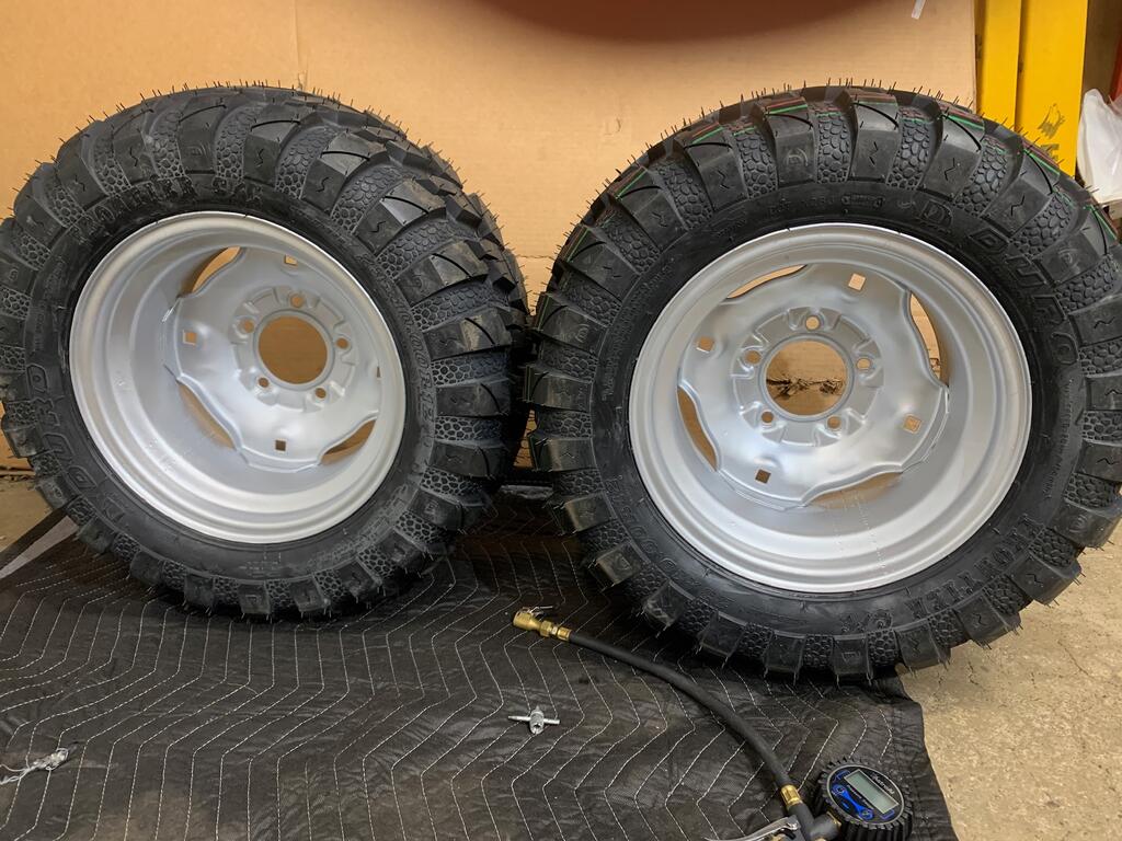

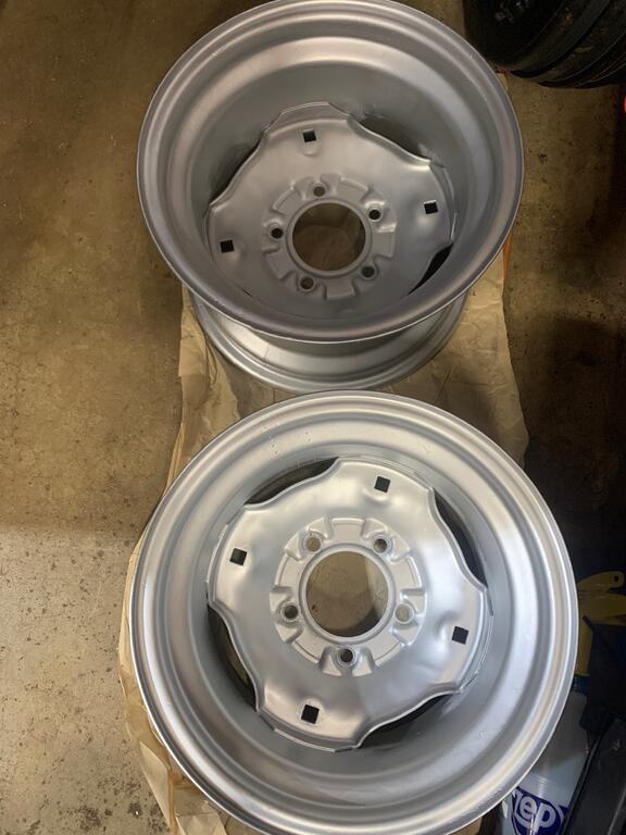

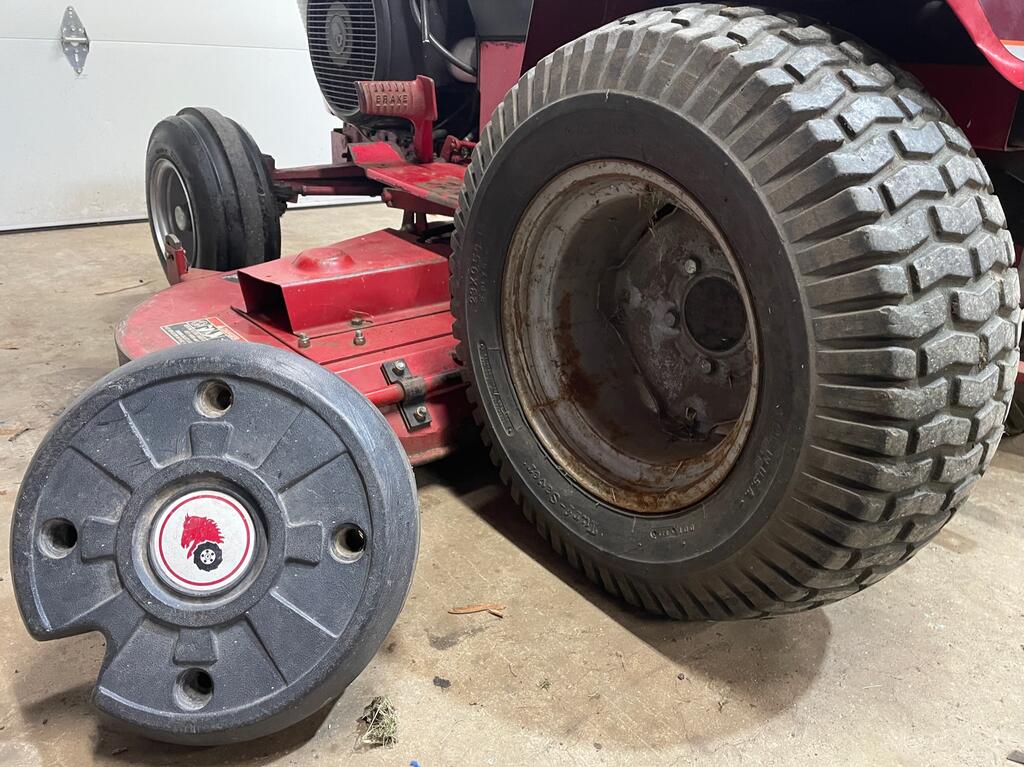

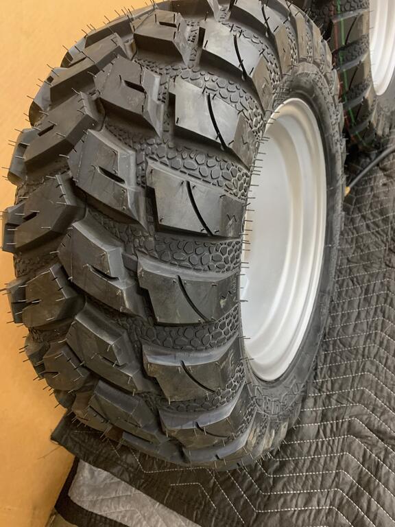

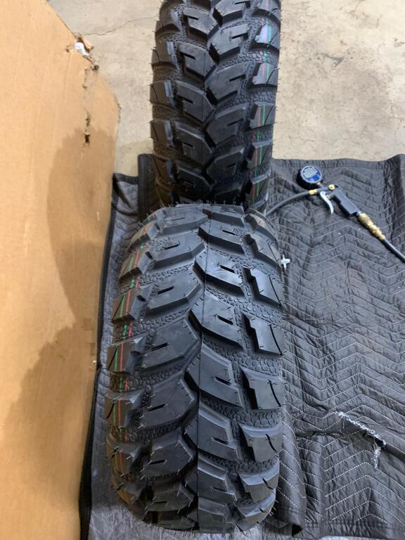

Andy N. 2,778 #17124 Posted September 23, 2022 Mounted these bad boys on some newly cleaned up and painted wheels and got them installed on the 520-H. This will be my winter snowblower duty WH. I will fluid fill later in the fall and plan on running with no weights or chains on the new driveway. Before: After: 6 8 1 Share this post Link to post Share on other sites
