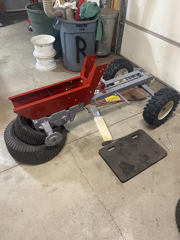

Heatingman 977 #17006 Posted September 16, 2022 1/2 way to a roller. Would have had the back tires mounted on the rims, and in fact did have one mounted, and bead set, but the bead still leaked. So, I ordered some tubes which I should have tomorrow. So far reassembly is going well. 5 4 Share this post Link to post Share on other sites
ebinmaine 80,811 #17007 Posted September 16, 2022 4 hours ago, Heatingman said: bead still leaked That and ease of installation is why all my newly mounted tires are getting tubes. The added expense for the tube is well worth the aggravation reduction. 4 Share this post Link to post Share on other sites
953 nut 69,642 #17008 Posted September 16, 2022 2 hours ago, ebinmaine said: That and ease of installation is why all my newly mounted tires are getting tubes. The added expense for the tube is well worth the aggravation reduction. Also, if you plan to liquid fill the tires I think it is best to use tubes rather than having the liquid directly against the rims. 5 1 Share this post Link to post Share on other sites

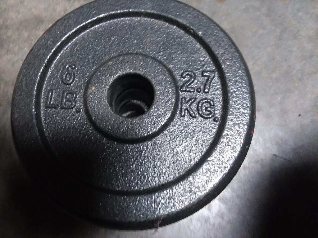

TJ5208 1,841 #17009 Posted September 16, 2022 Do you guys think 24 pounds would make a difference? 3 Share this post Link to post Share on other sites
ebinmaine 80,811 #17010 Posted September 16, 2022 1 minute ago, TJ Salyers said: Do you guys think 24 pounds would make a difference? Every little bit helps of course but 24 lb is not very much. 1 Share this post Link to post Share on other sites
Ed Kennell 47,474 #17011 Posted September 16, 2022 (edited) 31 minutes ago, TJ Salyers said: Do you guys think 24 pounds would make a difference? Yes, weight (down force) increases the grip directly. Will you notice the difference? Probably not, 240 lbs would be noticable. Grip=Fz×μ where Grip is the maximum force the tire can transmit to the vehicle, Fz is vertical downforce on the tire, and μ is the coefficient of friction of the tire with the surface. Edited September 16, 2022 by Ed Kennell 1 Share this post Link to post Share on other sites

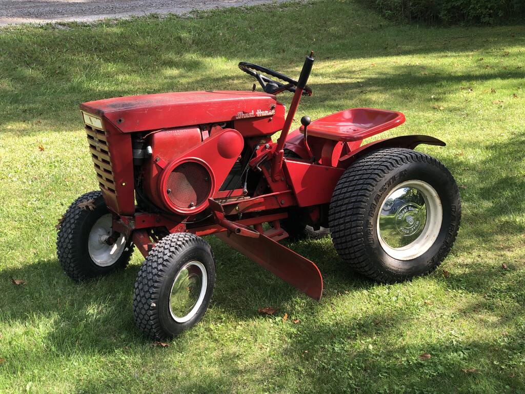

Rob J. 1,944 #17018 Posted September 16, 2022 Put a grader blade on Boss Man. Little by little. It’s a reproduction but I didn’t get the blade to collect, I got it to use. 3 5 Share this post Link to post Share on other sites

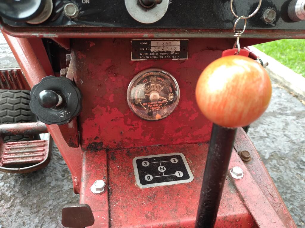

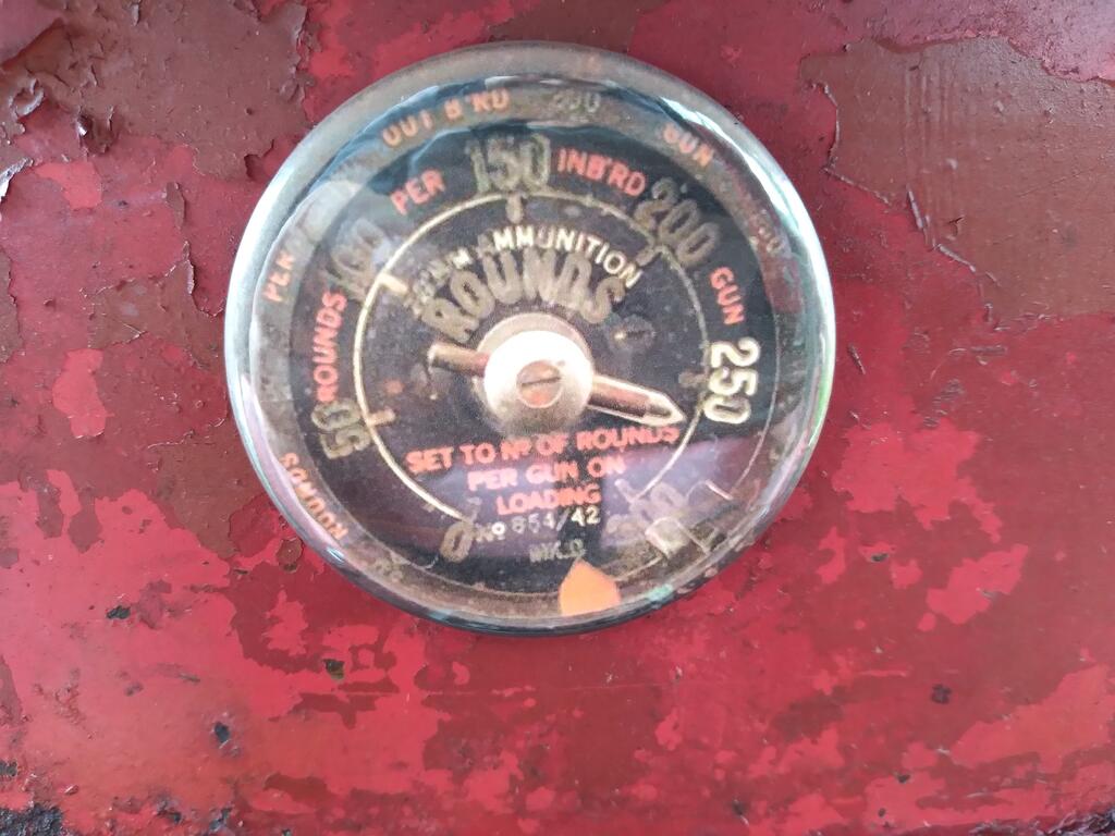

D_Mac 9,339 #17019 Posted September 16, 2022 So my 856 had a hole in its dash. Don't ask me how it got there, it was there when I got it. Didn't like looking at it every time I got behind the wheel so...... I got me a WWII ammunition gauge to put in its place !! Not really.... it's just a refrigerator magnet but way cooler to look at then a hole !! 2 5 2 Share this post Link to post Share on other sites
ebinmaine 80,811 #17020 Posted September 16, 2022 1 hour ago, D_Mac said: refrigerator magnet You have O-fish-yally just improved that tractor approximately 642%. Very cool. 1 Share this post Link to post Share on other sites
D_Mac 9,339 #17021 Posted September 16, 2022 Thanks EB. I just never know when enough is enough. 1 Share this post Link to post Share on other sites
ebinmaine 80,811 #17022 Posted September 16, 2022 32 minutes ago, D_Mac said: Thanks EB. I just never know when enough is enough. Sometimes that's a tough call. That magnet is Share this post Link to post Share on other sites
