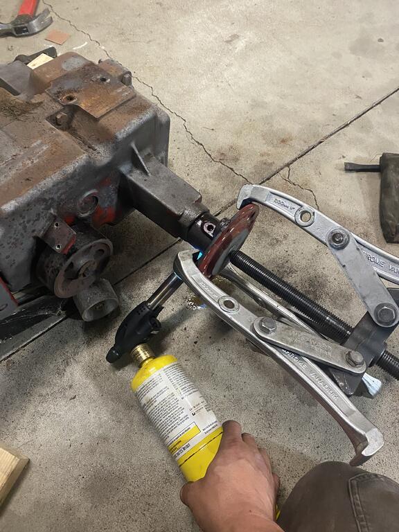

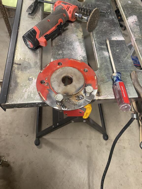

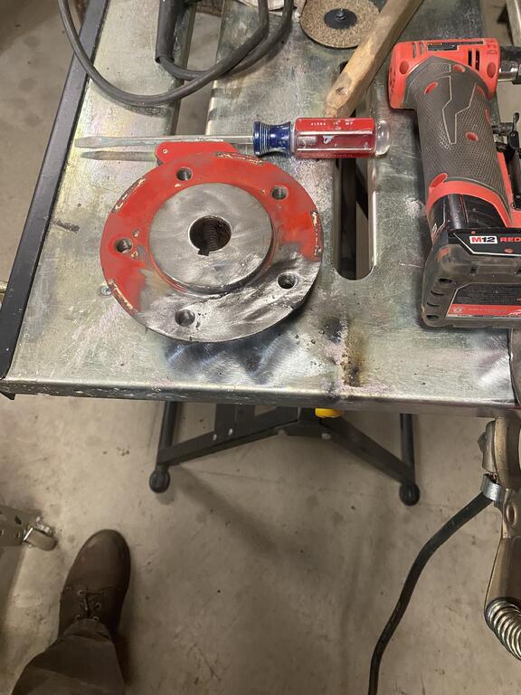

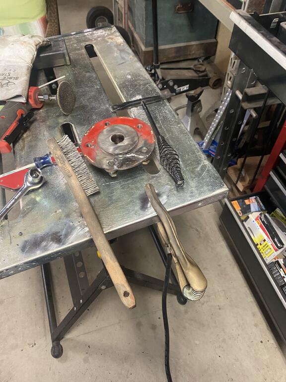

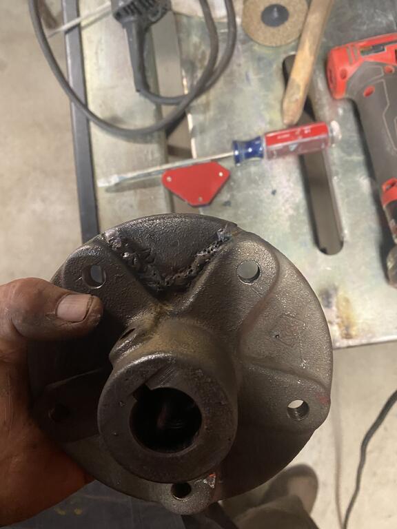

Heatingman 977 #16827 Posted September 1, 2022 Had a minor setback removing the rear hubs on the B80. Lesson learned - go for the torch straight away. First hub I snapped a section of the hub between the lug screws. Probably would have been functionally fine, I was not too pleased about it and I still needed to remove it. So I got the torch out, heated the hub, reset the puller, and now it came off. The other came off smooth - went straight to the torch right away on that one. After a cursing session, and a quick looksie on the web for a replacement hub, I realized Id better just fix it. So, I grabbed some 7018, cleaned pieces, and welded the parts back together. Definitely not a perfect weld job, but its serviceable. Cast iron is just a dirty metal filled with imperfections, so porosity is par for the course. And plently strong for the application. In all reality the hub probably would have worked fine even without re-attaching the missing section. So long story short, just grab the torch first thing. 3 2 Share this post Link to post Share on other sites

ebinmaine 80,811 #16830 Posted September 1, 2022 6 hours ago, Heatingman said: hub I snapped It's a common theme that these hubs a real bugger to remove. It's VERY important to use a different style puller next time you're "graced" with a removal. Set up a puller that puts the pressure preferably at the back of the hub... Or at minimum, through the 5 stud holes. There are threads showing how. @953 nut has a good pic somewhere. Excellent job welding that by the way! 6 hours ago, Heatingman said: Then like all my projects I go all in. So what was supposed to be a quick paint refresh and mower blade sharpening, has become essentially a full blown restoration of the tractor This is a syndrome I understand all too well. I'll just fix this. It's attached to that. I'll just fix that. It's attached to those. I'll just fix those. It's attached to them. I'll just fix them. Ehhhhhh. Nope. But seriously. It's all good. I've learned over the years that nothing takes the "few minutes" it should and that's genuinely OK. You're FAR better off to do it right. Once. 2 3 Share this post Link to post Share on other sites
953 nut 69,641 #16831 Posted September 1, 2022 2 hours ago, ebinmaine said: Set up a puller that puts the pressure preferably at the back of the hub... Or at minimum, through the 5 stud holes. There are threads showing how. @953 nut has a good pic somewhere. If you apply maximum pressure first and then use a needle gun to vibrate the hub under pressure and then add pressure again and repeat the process it seems to work very well. 3 3 Share this post Link to post Share on other sites
