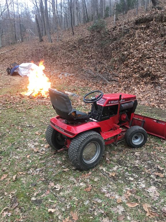

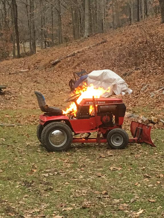

The Tuul Crib 7,354 #1577 Posted December 8, 2018 Cleaned out the wood shop today burned all my scraps got my tractor out. Waiting for snow they said possible couple inches by Monday. I know it's not a lot but here it could be some fun. Oh and by the way no my tractor is not on fire !! 3 1 Share this post Link to post Share on other sites
953 nut 68,656 #1578 Posted December 8, 2018 5 minutes ago, The Tool Crib said: burned all my scraps Find a friend with a wood stove, he will appreciate it and much safer than burning near a woodland covered in dry leaves. 1 Share this post Link to post Share on other sites
The Tuul Crib 7,354 #1579 Posted December 8, 2018 It's never left on attended and always a garden hose nearby ! Share this post Link to post Share on other sites
Tractorhead 9,217 #1580 Posted December 8, 2018 The Tractor Firepic looks "hot" like that campfire romance! Here at my side it was actual to windy to do. Got an old Dryer drum reworked in wich i burned most of my leaves or wood down. Few rocks under the drum, a few seats, maybe a guitar and some friends or family arround can you finish nicer a day? 1 Share this post Link to post Share on other sites
The Tuul Crib 7,354 #1581 Posted December 9, 2018 16 hours ago, Tractorhead said: The Tractor Firepic looks "hot" like that campfire romance! Here at my side it was actual to windy to do. Got an old Dryer drum reworked in wich i burned most of my leaves or wood down. Few rocks under the drum, a few seats, maybe a guitar and some friends or family arround can you finish nicer a day? Well I could try but I don't have a guitar and I don't think the neighborhood would like loud drums ! 1 Share this post Link to post Share on other sites

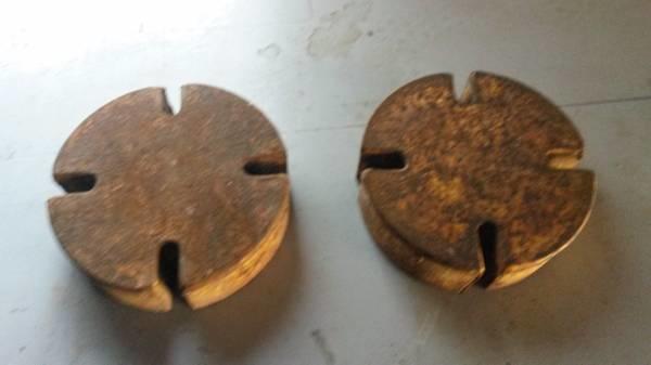

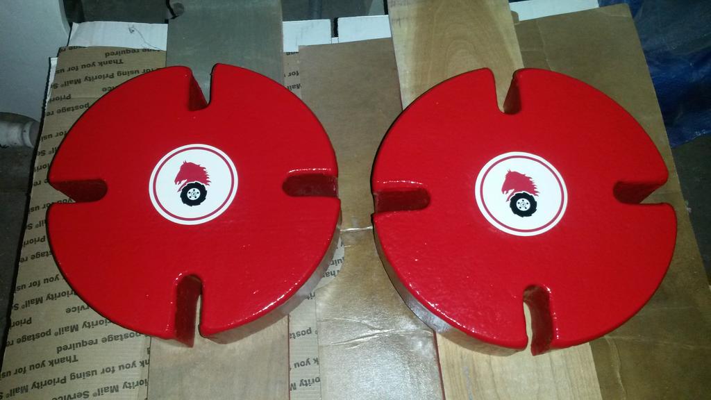

Chris G 3,385 #1584 Posted December 10, 2018 I finished up some wheel weights today with some of @Vinylguy decals. 4 8 1 Share this post Link to post Share on other sites
19richie66 17,932 #1585 Posted December 10, 2018 Those look great! 1 Share this post Link to post Share on other sites

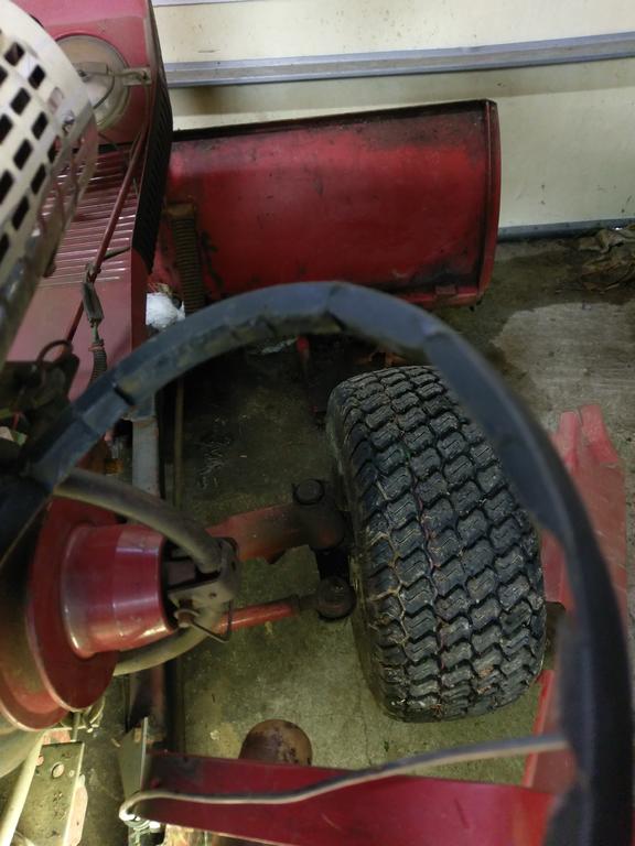

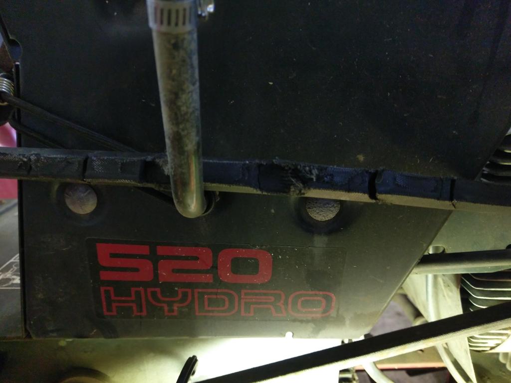

WVHillbilly520H 10,379 #1594 Posted December 14, 2018 I have noticed for a while a rubber burning smell coming from the "Good Friday 520" while moving, I tore into it today to change out rear tires and found the super cheap eBay drive belt I put on it 3 years ago was falling apart, stole the new TORO belt from the 312-8 (I'll get a blue TSC belt to replace that 1) and fixed my issue. 4 Share this post Link to post Share on other sites
ericj 1,580 #1595 Posted December 14, 2018 34 minutes ago, WVHillbilly520H said: stole the new TORO belt from the 312-8 I didn't think they would interchange between a hydro and an 8 speed eric j 1 Share this post Link to post Share on other sites
WVHillbilly520H 10,379 #1596 Posted December 14, 2018 3 minutes ago, ericj said: I didn't think they would interchange between a hydro and an 8 speed eric j Same belt 5/8"x 83", Toro # 114895, they do route differently the 8spd you need to actually remove the foot rest where of course the hydro the cooling fan, but yes I swapped it no issues. 1 Share this post Link to post Share on other sites
gwest_ca-(File Mod) 12,472 #1597 Posted December 15, 2018 14 hours ago, WVHillbilly520H said: Same belt 5/8"x 83", Toro # 114895, they do route differently the 8spd you need to actually remove the foot rest where of course the hydro the cooling fan, but yes I swapped it no issues. The 312-8 uses a 5/8" x 82" belt. Without looking the twin-cylinder models use a 5/8" x 83" belt in some applications. Garry Share this post Link to post Share on other sites
WVHillbilly520H 10,379 #1598 Posted December 15, 2018 33 minutes ago, gwest_ca said: The 312-8 uses a 5/8" x 82" belt. Without looking the twin-cylinder models use a 5/8" x 83" belt in some applications. Garry Either way it fit perfectly from the 312-8 to the 520H... Share this post Link to post Share on other sites
